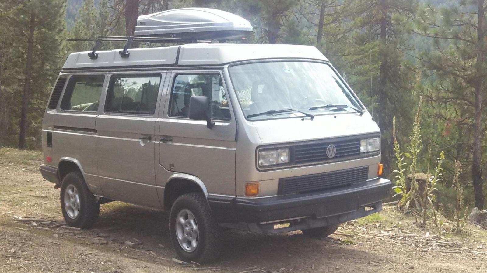

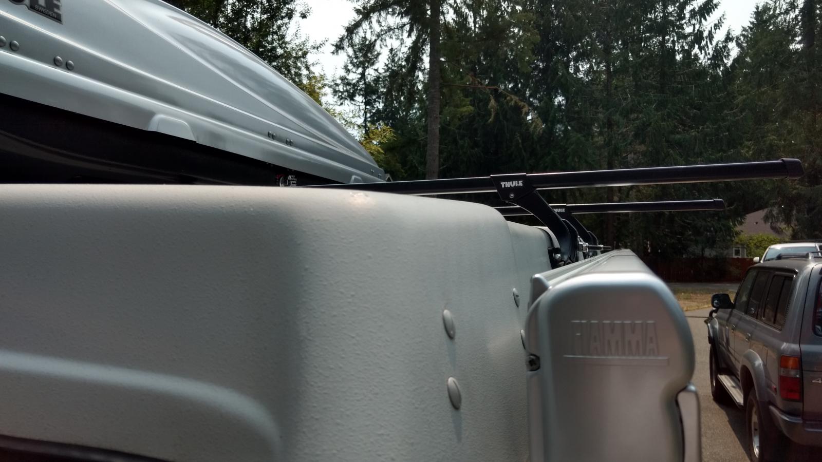

I have had both the Thule 300 and 387 on. I have been meaning to post your exact question. I can not remember which I originally went with but I am having trouble deciding which ones to keep on. The 387s allow me to open the skylight/vent about halfway with the Thule box on. The 300s do not but the 300s do clear the skylight with the box on.
The 387s sit a little on the high side for me on an already tall westfalia. I have screens on the cabin side windows and a 3 window canvas I feel I can live without opening the roof vent to bring the racks down.
I like how the 300s fit the roofline tighter and when I have time I will put them back on and lay my surfboards up there. I was a little concerned that the rocker on the boards would not work with the 300s I don't feel and hope that will not be an issue. I also need to check that the canoe works with the height of the 300s. I definitely would prefer to use the 300s if the boards and canoe clear I can be content not opening the vent.
If the gear hits the roof I will stick with the 387s the picture is of them.

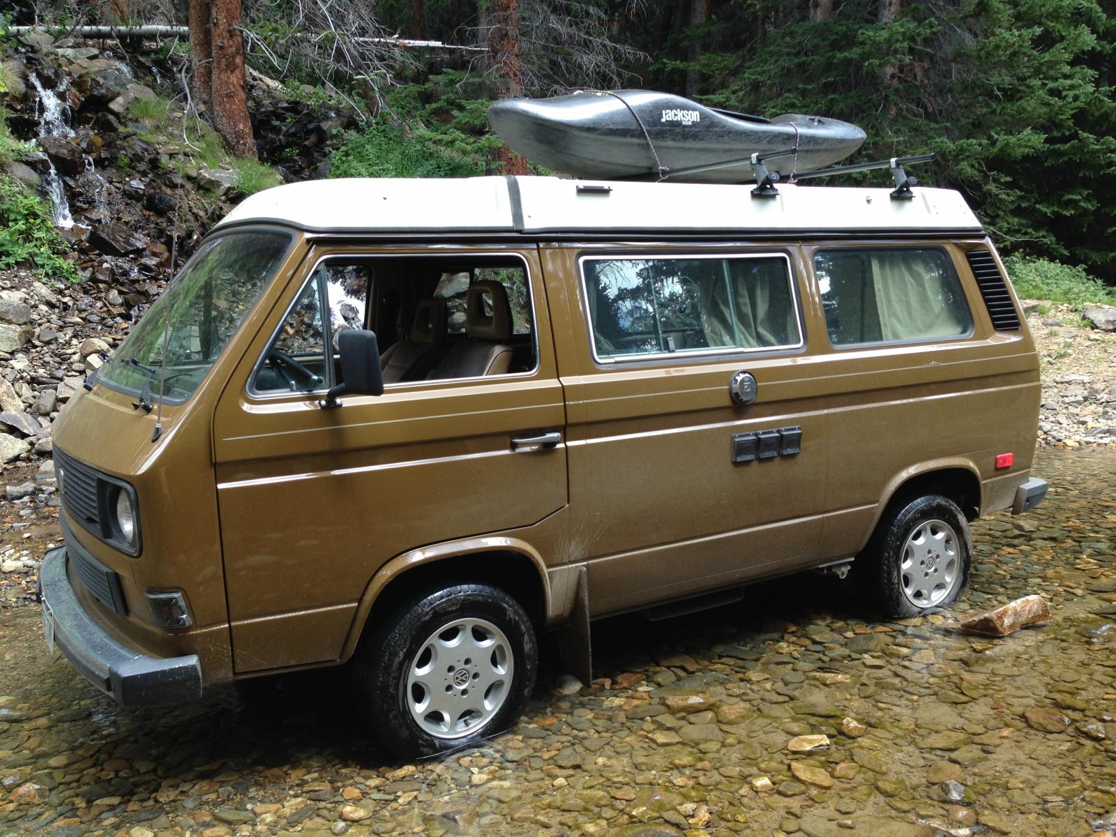

Vnyd Dog wrote:

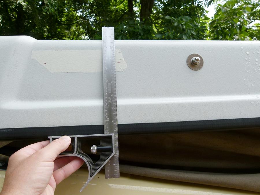

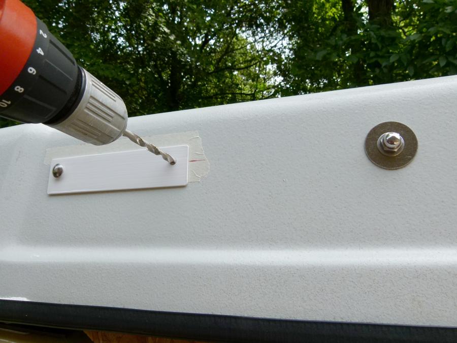

Does anyone have any tips and tricks on how best to "align" ARGs side to side and front to back? Seems like it would be really tricky to get all 4 ARGS "square" on the top. How concerned about precision do i need to be? I don't want any cockeyed bars mounted on my roof!
Assuming your popup roof is square on the vehicle, just transfer your ARG locations from one side of the van to the other.
Start by working out your geometry for best weight balance, and whether or not you want the bracket holes to coincide with the lift-strut bolts, etc., then mark one side of the van. Measure the locations of those marks relative to the factory roof hardware bolt heads (rear hinges and front braces), then just carry them over to the other side of the van.
FYI, if you don't already know, the Jack Bombay lift struts (and probably all others) must be pretty precisely located in order to function properly, without a lot of leeway. So measure/install those first, then locate your other components in relation to them.
I love both my Thule rack system (with Gutter Foot Pack 300's) and the Jack Bombay lift struts, for carrying a pair of sea kayaks. I got a pair of Regular struts for everyday use, and a pair of Heavy-duty struts for use with kayaks.
Camp Westfalia
Camping Tips • Newsletter • Cool Campervan Apparel
www.CampWestfalia.com
Vnyd Dog
Joined: August 25, 2015
Posts: 384
Location: Napa
Vnyd Dog is offline
PostPosted: Fri Aug 04, 2017 12:01 pm    Post subject: Re: Which height Thule gutter foot pack are you using? Reply with quote
Hey yeah thanks that's good info. That helps explain where my reference points will be. I notice you didn't co-locate your strut and ARG.
'87 Westy 1.8T Conversion, Orignal Owner, European Delivery @ Westfalia factory in Weidenbrueck.
The Story:
https://www.thesamba.com/vw/forum/viewtopic.php?t=713391&highlight=life
Jeffrey Lee
Joined: February 04, 2014
Posts: 1516
Location: Wisconsin
Jeffrey Lee is offline
PostPosted: Fri Aug 04, 2017 1:24 pm    Post subject: Re: Which height Thule gutter foot pack are you using? Reply with quote

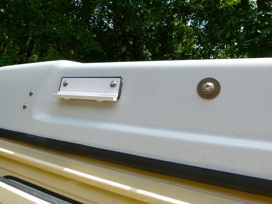

No, I often carry two expedition-weight sea kayaks, so I wanted to shift the entire load rearward as much as practical, in order to reduce lifted weight and strain on the forward locking struts. Be careful though, that your ARG bolt locations don't interfere with the lift-struts when the roof is retracted. As I recall, I had to shorten one bolt on each side in order to clear.
A carpenters square helps keep your lines straight when measuring from the bottom edge of the Westy roof.
Drill your first hole, with a piece of scrap wood behind the roof so you don’t drill your canvas Embarassed
Knowing that the best template for a part is often the part itself, dry-fit the ARG or backing plate with a bolt in your first hole, then go through the remaining hole to drill your second.
I painted my ARGs white to match the roof, cuz I was feeling schmancy …
BTW, besides being a quality product, the instructions included with the Jack Bombay lift struts are perhaps the best I’ve ever seen from a small any vendor, far better than many I’ve seen even for products costing 5 times as much.
Here are a few threads about the relative issues with co-locating or not:
https://www.thesamba.com/vw/forum/viewtopic.php?t=659863
https://www.thesamba.com/vw/forum/viewtopic.php?t=613652

PostPosted: Sun Aug 06, 2017 4:45 am    Post subject: Re: Which height Thule gutter foot pack are you using? Reply with quote
I got the 387s as I planned to put kayaks or canoes on the top and wanted clearance so it would be easy to reach under and around the boat to loop straps on. Very happy with my choice. My van does not fit in my garage with a rack on no matter the size of the rack so I like the 387s fine.
