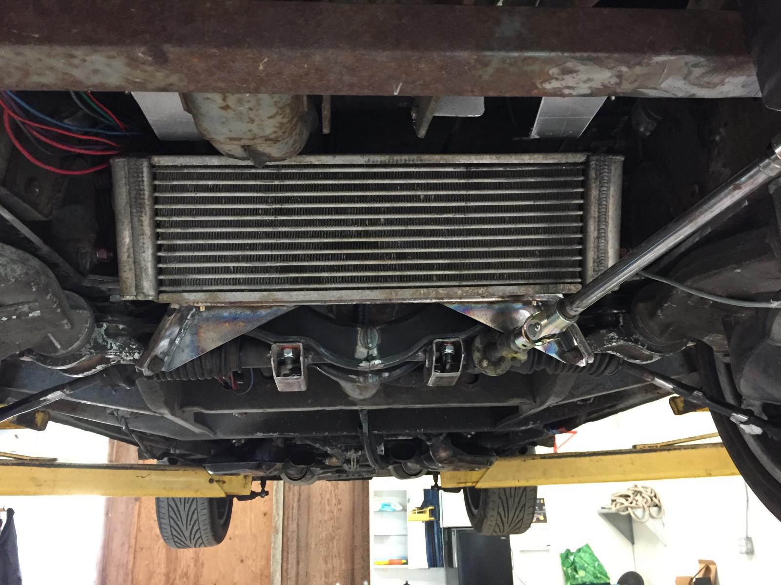

PostPosted: Wed May 31, 2017 7:59 pm    Post subject: Re: Porsche Powered Mid-Engine Double Cab Build Reply with quote
Thanks slow learner for checking in.
Hopefully more track time in the future, the goal is to get it worthy of open track testing and D.E. events.
I re-located the oil cooler to the spot I was planning on after the A-arm suspension swap, with the beam gone it should get sufficient flow (still need to add ducts).
Porsche powered mid-engine double cab build
http://www.thesamba.com/vw/forum/viewtopic.php?t=3...highlight=

PostPosted: Thu Jun 01, 2017 5:55 am    Post subject: Re: Porsche Powered Mid-Engine Double Cab Build Reply with quote
Going to go back to the stock front bumper now?

PostPosted: Sun Jun 04, 2017 10:17 am    Post subject: Re: Porsche Powered Mid-Engine Double Cab Build Reply with quote
The bumper center vent is staying but will get further modified for the new layout. I am planning on closing in the air path for better flow with some abs sheeting.
The new spot will help take some weight off the nose and be less vulnerable so that is a win.
I know the bumper is a bit abrupt visually, but the final version will be a bit cleaner.
