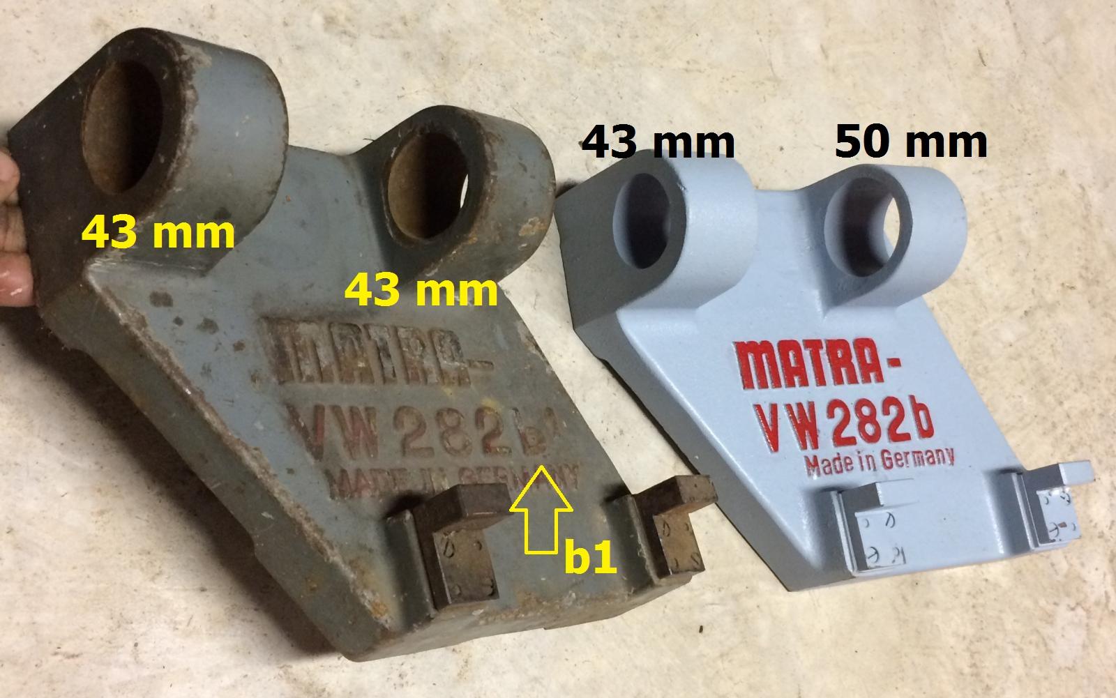

The 282b has two holes: (1) 43mm dia. and (1) 50 mm dia.
The 282b1 has (2) 43 mm dia. holes.
An early trailing arm is 43 mm at both bushing locations. (Barndoor, I'm not sure about)

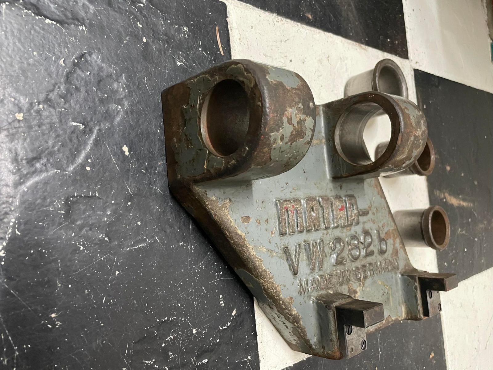

This pic shows the 282b (one small hole on left... big hole on the right)... and uses collets / sleeves.

I think it's a b1 because all the trailing arms are same dia. at both bushing contact locations and the "M" of "MADE" text lines up under the "V" in VW (more on that below). But, late trailing arm races could have been removed.

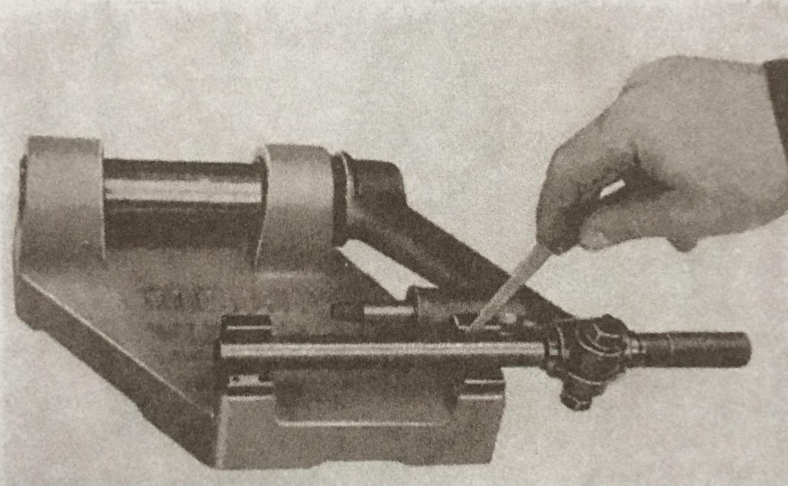

63-67 Bentley shows short rod being used on the lower trailing arm... and apparently a collet over on the right side.
Here's a "b1" and a "b" side by side (you can see how the "M" of "MADE IN" is either under the "V" or "W":

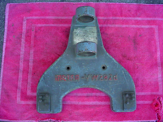

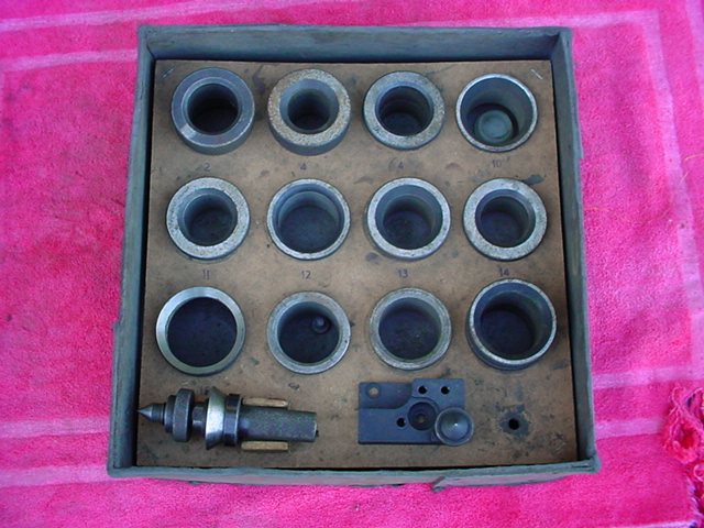

I got on to this topic because I have a couple of the black boxes of sleeves... and was trying to determine what ones should go with the 282d... and what ones I could pair with my 282b's (to try to make them more complete).
The black box of sleeves, part of 282d kit.
282d
Here's a close up of the sticker on the 282d:
I had a couple loose sleeves that were 37 ID x 43 OD.
Apparently these could be used in the "b1" tool... to measure beetle arms.
Note in the decal photo that the Type 1 sleeves are mostly 37mm... so makes sense.
The OD of all the 282d sleeves are 50mm.
This would make them usable in the "b" bigger hole.
What's odd is the 282d sticker says Type 1, 2 and 3 (and has all the corresponding sleeves) but, the binder sheet doesn't list Type 2 with an "x."
And... the 282b only lists Type 2 but, apparently can work for Type 1 when using the 37x43 sleeve.
(left hole 43 mm.... right hole 50 mm)
Maybe sleeve sizes in the pic are:
43 x 37 (for left side, Type 1)
50 x 37 (for right side, Type 1)
50 x 43 (for right side, Type 2, or to act like sleeve #10 on the 282d sticker)
fourth sleeve = ?

The two pictures you have, of the sleeves and locating sketch for the decal, are both part of the 282d kit.
This confuses me a little... because you mention having a smaller type "b" tool.
All of those sleeves in the box (except the #21 one in the lower right) have an O.D. of 50 mm and can't be used in your "b" tool with 43 mm I.D. holes. The #21 has an I.D. of 50 mm... it must fit on one of the sleeves.
Early & mid bus trailing arm is 43 mm O.D. at the inner & outer bushing locations.
Bus trailing arm, if late (needle bearing style), would have an outer 48 mm O.D. bearing race on the 43 mm shaft. Basically, a 5 mm thick piece of precision pipe is slid on the trailing arm (to be a needle bearing race).
For a 282b tool (43 mm hole on the left & 50 mm hole on the right).... the left side apparently does not need a collar. I think the right side would use a 50x43 collar and maybe also use the thin #21 collar (in the lower right of your pic) to center the late style bus trailing arm. But, not exactly sure.

this is my 282b with two arms and a single set of sleeves

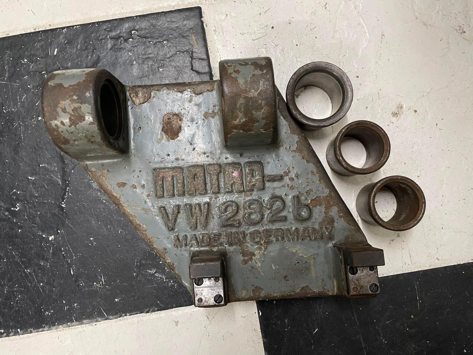

Hello Guys,
Here is my 282b that I bought recently
Holes of 43mm on the left and 50 mm on the right. It was provided with a 43-50 mm sleeves for the right hole and with two 37-43 mm sleeves for type 1.
But the 2 rods are missing... I'm looking for a set of these.
