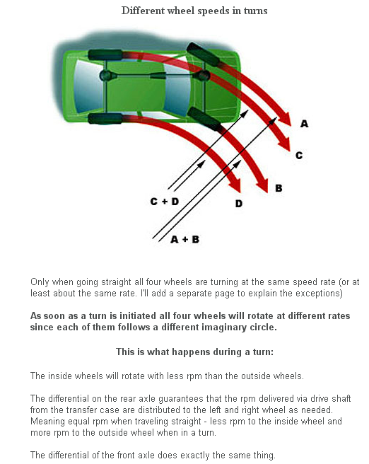

in its ability to lockup yes, a VC simulates an auto Locking Center Diff (4WD mode)
but not in the ability to send forward traction to the front wheels in a turn, when not locked. (AWD mode)
look at these pictures
try to understand that there is a separate power shaft to the front diff, that rotates independent of the speed of the rear diff
a VC can NEVER rotate the front diff faster than the rear
a Center Diff can spin the front diff faster than the rear diff.. Try to understand that..
look closely at the photos:
visuals:
Viscous Coupling: one input, one output at the same speed, or slower than the input. Not possible for front diff to spin faster than rear diff.
https://shufti.blog/2010/04/02/viscous-coupling-hump-condition/
Center Diff: one input, TWO outputs capable of different speeds from each other, and front diff can spin faster than rear diff.

The man in the video equates the vct to the epicyclical differential saying that it is a "simplistic" epicyclical differential.
So here we are:
(Or how the front differential is spinning with more rpms in a curve).
