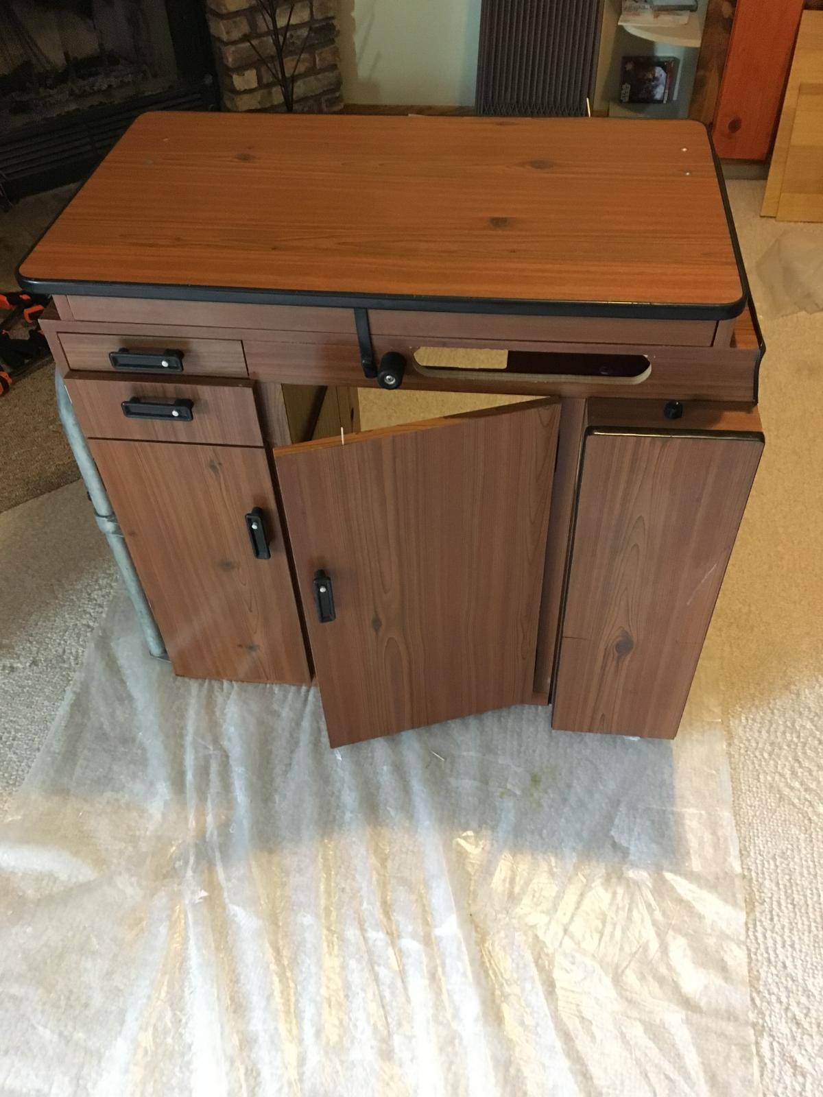

Time to get the Kitchen Block out of the garage and into an area with better temps, tunes and lighting.
The sink is pretty crusty and needs a cleaning and polish. The mounting seal is aged out and takes some adhesive remover and it come clean too. That's going on in the dining room table.
I think I'll start with the piece thats behind the stove controls. It's hanging by a thread but not cracked, so lets bake it off with the hot iron.
The glue underneath is really dry and thinly coated, sands smooth pretty easy. I get some spray and brushable rubber cement depending on the size of the area and after it flashes, I get it stuck back in place. My whole regiment of clamps jumps in to help.
That's about all I do in a day with this, I get an area prepped and glued then left clamped for the day and pop them off in the morning. Repeat in series on another piece the next day. Only takes anywhere from 20 min to an hour depending on the spot.
Same as the next spot. Remove or pull back, clean, glue, clamp---repeat.
Before I get the clamps on, I get most of the glue that squishes out wipped up so it doesn't quirt all over the outside of the laminate. I don't think the glue would forever bond on the side, but its easier to clean up with acetone before it dries. I really like the painters tape to help hold and protect the surfaces and I go through plenty. On some edges, only about a half inch is sprung and I learned on the eche_bus thread to use toothpicks as wedges to allow you to get some glue in there. As a toothpick is removed the excess glue gets wipped and the painters tape applied to get it held down. A few less sprung areas and it's getting tighter every day.

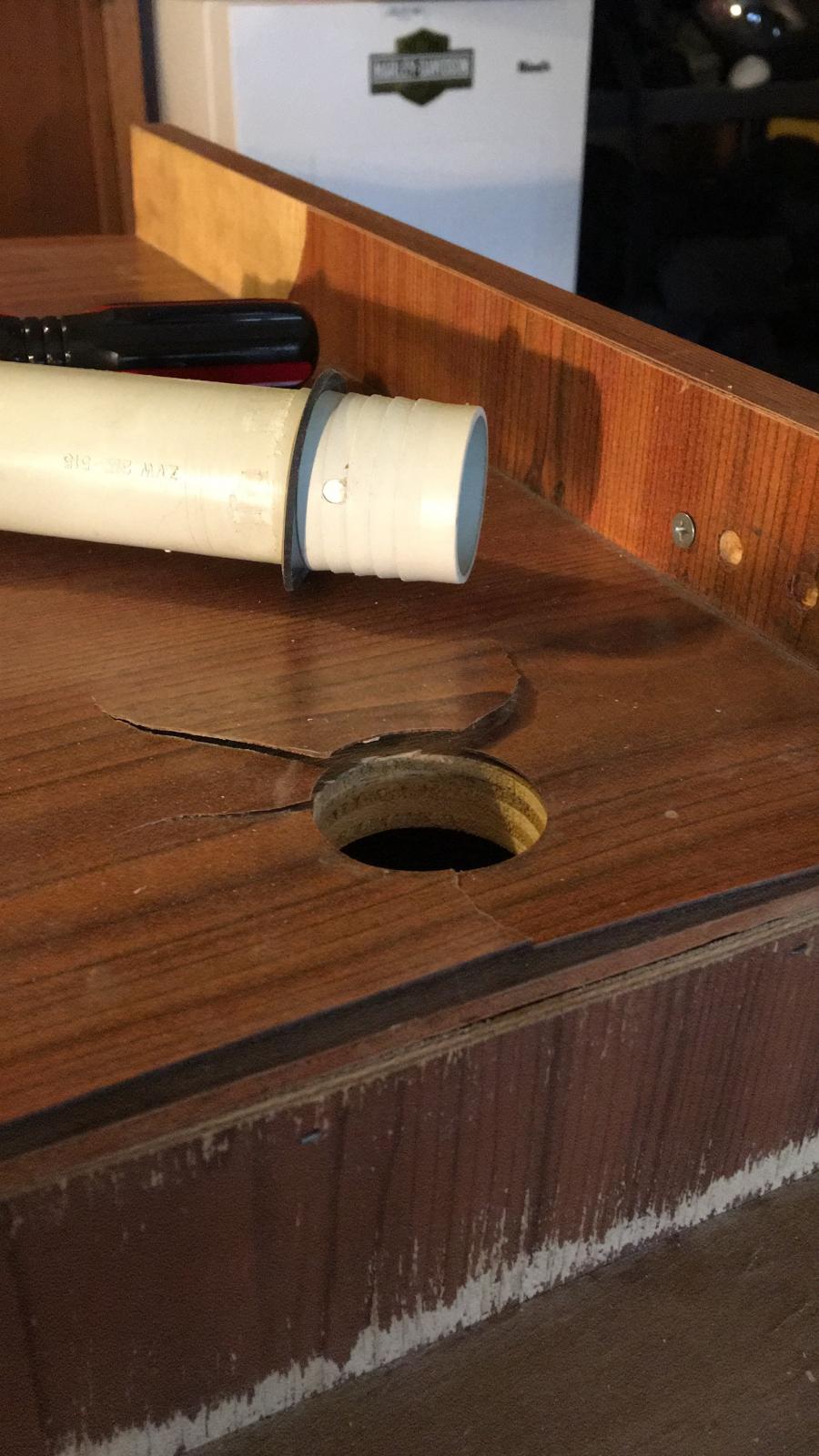

Things are going ever so slow and tedious with the Kitchen Block, but it's better than some of the other tasks I've had to address with the bus. Still, lots of glueing and clamping and rolling the beast over a few dozen times.
I'm looking at the very top surface of the piece and it has issues. Its delaminating in several places and cracked right down the middle. On top of that, it appears that the two short rails that support the lid are screwed down from below and no clear way to get a wrench on them to remove. I've seen some folks drill through the wood thats covering the screws from below to gain access, but I'm not comfortable drilling holes in this piece. I decide that I will try to make my repairs here with the laminate in place.
The first area to patch up is around the water tank filler neck. It's cracked in several places. I get some glue worked in there the best I can. This is where the spray rubber cement comes in handy. Lift up the laminate and spray some in there and squish the glue down deep into the recesses and lift it back up to "flash", then flake the laminate so it rests in its original state. Clamp and tape it overnight to bond.
The worst crack is at the very top of the surface that goes from one lid rail to the edge of the sink. My plan is to get one side of the split worked at a time. Then the second night the other side gets glued and clamped. I felt that trying to do both at once would get glue spread out all over and I wouldn't be able to control that.
There was a hairline crack that was left and it was filled slightly with a really thin super glue that ran in the crease and was built up over several nights and it flowed in pretty flush without sanding. It's commercial name is called Paleo Bond and it's used for prepping fossils. One comes so thin it can pass through limestone. There is a generic version sold locally in 8 different viscosities and I have several as its pretty cheap. I'm not using it to bond the laminate to the wood but works great for filling a thin void with something solid. A watercolor paint with a tiny brush to take the glint off and it basically disappeared.
See those reader glasses? thats why I blow up my text, dang birthdays Laughing
With that done, the rest is pretty much down hill, still just investing my time and energy and execute the steps.

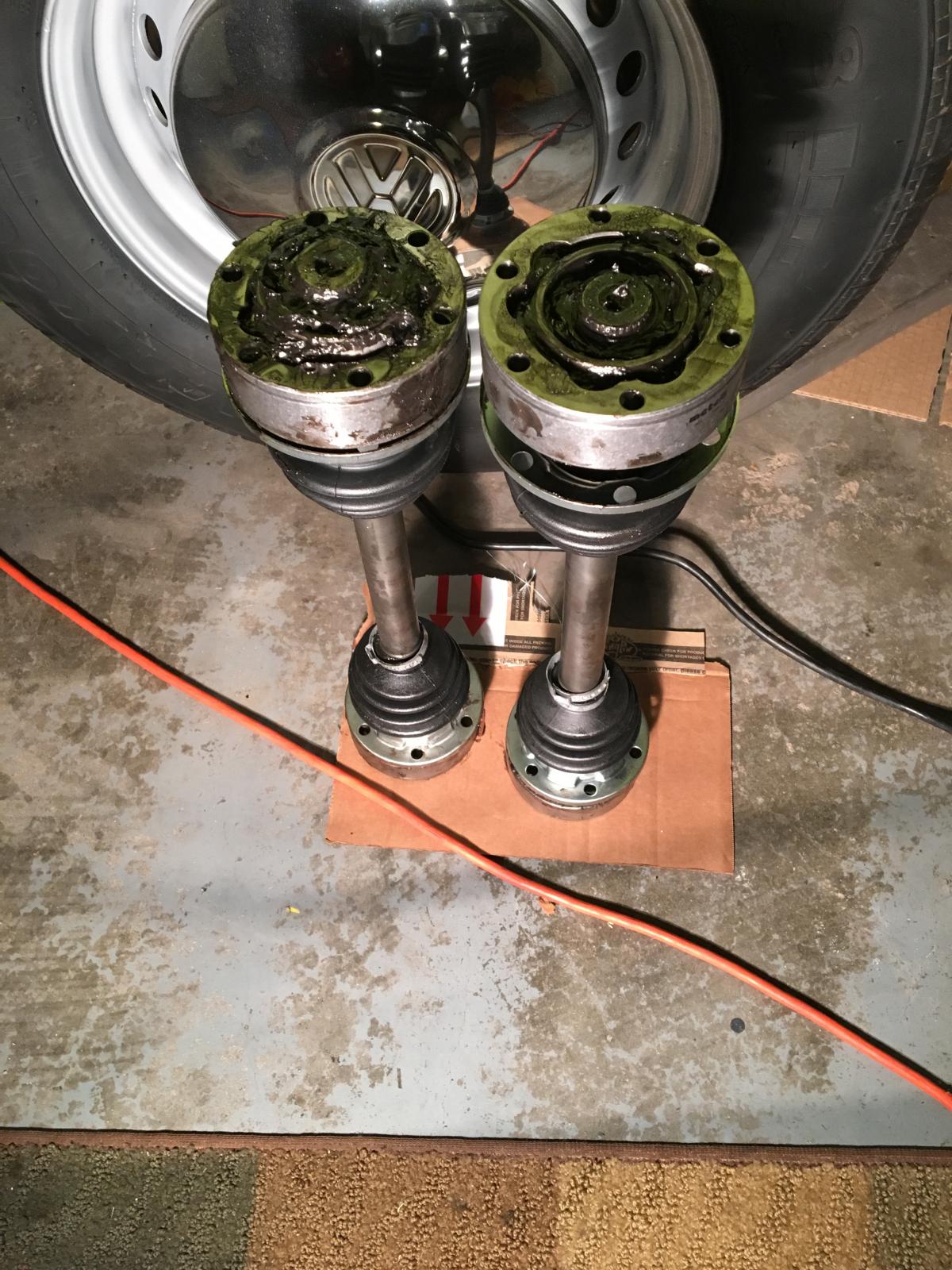

Back to the parts box to get after the shifting linkage. Get up underneath is always a blast, but it's not so bad when you break it up with not so terrible tasks. Who doesn't want to shift like butter?
The replacement lineage coupler isn't made very well. Typical. The screw that passes through the shaft never tightens up and keeps slipping on the pressed threads. I get it back off and toss it in the "hopefully it never gets so bad I'll need to run this" box.
I'll clean up and replace my OG one with new plastic ends.
The first time I installed this it took at least an hour getting versed in what tools to use and how, then putting my OG back in took about 10 min. Hey, I'm slow at first but once I learn the system, click right through it.

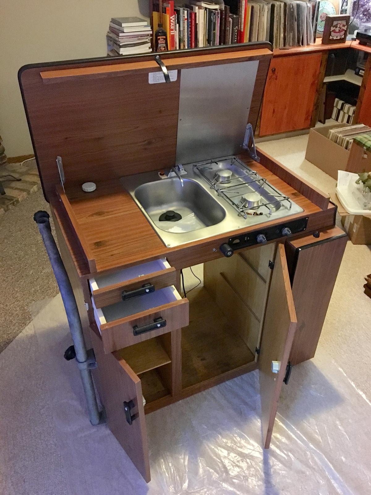

Once all the loose, sprung laminate is finally all reattached I get the area straightened up and start installing the drawers, doors and the hardware. This is a neat step as its such a high point for the project. The pieces have been sitting around just waiting their tun to go on and now the proper time has come and it feels great.
I have to give Kevin credit here. I wouldn't be this far if he hadn't swapped out a few pieces and let me high-grade some proper hardware so it would be complete.
I got my new water pump in a BusDepot order a while back and I'm looking at the last few things that need attention here. With all the cleaning products, glue and paint, there just isn't anything that can reverse the candle dye that has soaked into my water tank. I get all the wax off and bleach the inside out and say a quick prayer poem about accepting flaws and gratitude it won't show and just let that go. The tank gets reinstalled and locked in with the rubber stoppers and filler neck.
I get the water pump screwed on and the wires all routed and attached. Soldered them. I added an O ring to the outside of the connection, hoping it will add some protection, but I'm not thinking I'll ever put water in this tank. Maybe, but this piece is more of a collectable to me now and I'm pretty protective of it. I can always throw some water jugs in the bus. The thought of the block getting water damage from a leaky tank makes me cringe.
While I'm back there I'm looking at the piece with the decaying wooden print. I know it doesn't show in the bus, but it bugs me its lifting.
I spent the better part of an evening session getting it stabilized and repainted and replacing the masonite backing board with thin finish nails in the old staple holes, in case it ever needs to come off again.
The completion of this has really lifted my spirits. I'm feeling Volksminded. Its not perfect. It has some blemishes. I've reversed 90% of them and fought for the other 10%. They seem to me to work with the believable originality of the bus and I'm ok with them. The shelves get placed and this piece sitting noble and proud in my den getting shown off to anyone who comes over. I like looking at it when I watch my TV. I never would have thought this interior could clean up like this and besides needing to be done to use the bus, I liked doing it. Now it's just another piece sitting there waiting to go in the bus. I think I'll leave it out a while so I can have the room to work the bus and not hurt it climbing all over it.

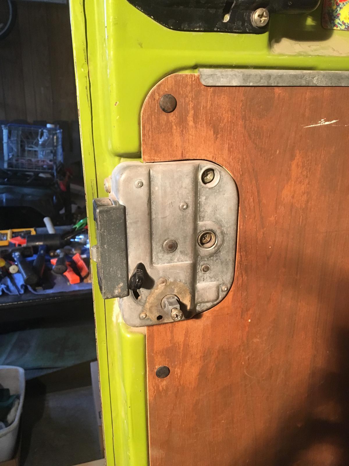

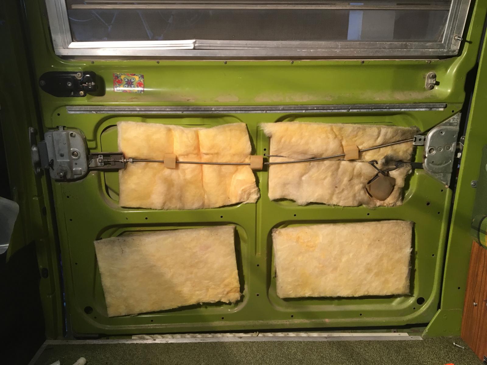

With most of my Berlin Interior worked over, I decide to sign up for Sliding Door 101 in the fall semester. Very Happy Mine is acting up and needs some hard pushes and a shoulder check to get it closed. I've just left it open the last year and think I could get it closed a few times without breaking it more, but having it in this semi working order just isn't cool.
I had helped Kev put a slider door back on his bus a while ago so knew how to get mine off. Time to take the plunge here. It took me a bit, but I got the belt line cover off without ruining it. Was dirty in between the seal and needed detailed.
I follow that by getting in the bus and working the snaps off the inner panel. I get some fencing players to scoop them and a knife to work around them evenly without breaking them. I get all but 3 saved. Its pretty neat to pull off that panel and see some factory insulation hanging out looking fresh as the day it was installed.
My initial assessment photos show that there seems to be just a thick layer of crust and lacquered grease and oils. I'll start by slowly cleaning each and get familiar with them.
I get the door pulled and set on a table next to the bus. Crazy how that looks missing from the bus.
After that I start by cleaning the bus side of things, jumping on the bottom rail. This thing was packed with debris. I found a penny that was domed from being hit repeatedly by the rear slider wheel. I'm sure that didn't help things being in there. Should have taken a photo of that. I sprayed the gunk with purple power degreaser and scrapped out he rail with a non marring chisel. Pretty simple design. I thought it would be more complicated, it's just the dirt that made it so dark and weird looking and hard to see what was going on. Wiping it clean after that was a cinch.
The body side door latch was quite dirty, but a quick bath and doll up with some oil and grease and it was good to go. The body needed some paint stabilizer and some attention and I put it back on.
Turning my attention to the door itself now. Kevin advised me to not under any circumstances, loosen or remove the bearing wheel mounts. He said it's a bear trying to get them adjusted and they did that at the factory and just leave them. Sound good to me.
In fact, I don't want to change any of the factory adjustments on the door if I can help it and take some pictures of the cable mechanism to make sure I can get it back to the way it was down the road. The door handle mechanism comes off and gets a look see. Its crusty. I have been looking at eche_bus thread to review and it outlines a way to clean the part. I follow it here. Its all pressed together, so taking it apart would likely ruin it. I give it an ultrasonic bath and let dry, then cover it in motor oil and allow that to drain out over a night. Compressed air blows out any remaining drips. All set to go back on.
Before it goes back on I prep the handle passthrough hole to hopefully help paint from pealing and get the lock seal replaced and hand wax the paint around the area.
So far so good. I'm itching to get that new inner panel on and see how this all works, but that'll have to wait. Still more steps to go.......

With day one in the books for the slider and still with a day free in my pocket I just couldn't help but suit up and get back after the door and wrap it up as best I could. With my nylon rail bushing cracked in half I got a few coming this way. It's a piece thats critical to the door closing at the end of the closing throw.
I didn't remove the roller mounts and cleaned them with hot water and compressed air until clear water came out off behind the mount. The roller come off and I figured a little lithium grease wouldn't hurt in there on their return.
The inside closing handle didn't need much but a new coat of paint and a little lube.
Now getting the spring rail mechanism detailed took a little fumbling. I started with getting the nylon bushing off. I couldn't tell what was holding it on and Brian said its a big rivet. I used a counter sink bit to slowly grind off the back of the rivet stopping just shy of the mounting arm.
Brian said he was near me and I went in to meet him in a parking lot and we swapped the piece window to window and with some pleasantries and went our way. My life is pretty basic these days.
On his way home from work he meets me in the same place with the new piece. It's an internally threaded mounting stud. Being these bushings seem to wear and crack it seems to be a solid upgrade. I'm impressed. He said making one of something is easy, it's making 100 perfectly match is another. Well, thanks man!! Back to the garage.
The wheel that rides in the track got pulled, cleaned and oiled. Its all going back together pretty nice. Time to get after that window. My screen was bent from it likely coming lose and catching upon a opening. It's looking to get replaced. The windows gets a few hours of detailing, flipping the door and doing the outside a while. Its not something I feel needs to be removed to clean. I'm betting disturbing the body seal would be unwise.

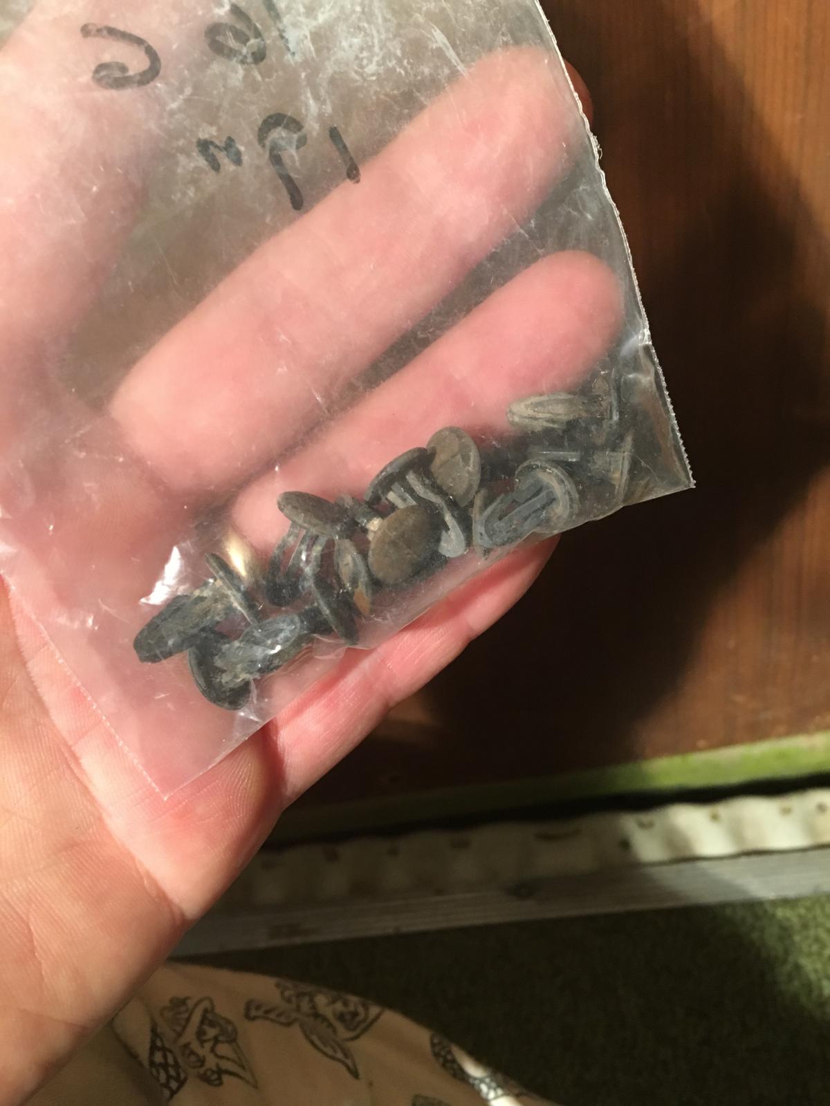

Everything is looking clean and functional so it starts going back on. I'm still waiting for the bushings, but that's not stopping me from progressing to the wooden panel. Again, it's edge shows the whitish blond of the wood its mounted on, so I sand and stain the edge so it matched the laminate better. My OG clips snap it right on. Pretty nice alignment with the pre drilled holes. Props to whoever made this. I had it downstairs on the floor for months with books laying on it hoping to train it flat. It still wanted to curl, but it was fine once it was installed.
I was missing a few clips, but found some on eBay from a person in England and although a reproduction, they looked real nice and snapped in strong. I put them on the back corner where they won't show as often. I had found a reproduction decal, but it doesn't look like my door mechanism, so that's not going on. Must be for an earlier bus. The psychedelic magnet was right there in the bus when I got it, so I left it there.
This sits a few days into the week and I get this little envelope with three bushings in it. I give one to Kevin and throw my extra in the glove box possibles bag. Brian's internally threaded stud is perfect and in a flash the door goes on.
It takes me another bit to get the slider rail cover installed. The door works flawlessly in every feature. Super nice to have a buttery slider. Really up levels the bus and didn't cost any bug bucks to do this refresh accept the new panel, which is optional. A weekend well invested.

riverside66 wrote:
Well crap! I thought my bus sliding door opened and closed just fine, but after seeing yours and it's oh-so-smooth action, now I'm jealous!
Thanks! I found that most of what was holding it up was dirt. Actually, that's usually pretty much the first step and all it takes to get this stuff working again.

asiab3 wrote:
Dunno how I missed this thread, but wow! Mind if I send some cabinets your way?????? Cool
Nice slider work, too! I find those ergonomic improvements to be most excellent.

A little catch all update for the morning. Some of this larger projects that take days to complete are happening simultaneously with several other little distracting ones.
One of which was my city water hookup. Again, yellowed, so I prepped and painted. At the time I couldn't seem to find one as a repo so just conditioned mine. Now I think I found one online from a few different overseas companies. I'll keep that in mind.
Kevin came back over and with the help of my Dad, we installed the transaxle. That's my Dads face under there. Getting after it at 70 years old. Me, I'm just holding the light and taking pictures Smile. My old clutch cable flexible guide tube was impacted with grime and just in horrible shape, so I bought a new one and got it on this day.
Then we took the opportunity with 6 arms to pack and rebuild the CV joints and boots. The boot clamps need a specific crimp tool I don't have so that will have to wait until I locate them.
Always something going on under the bus. It's always nice to get some time in there and when I'm done banging my head for a while, get out and do something a little more enjoyable.
