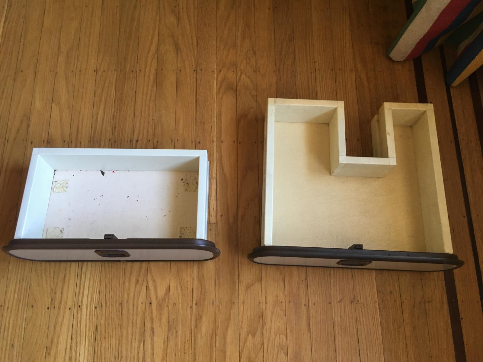

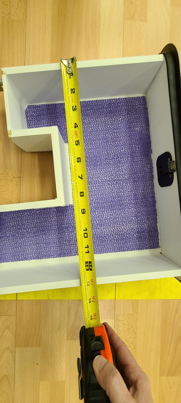

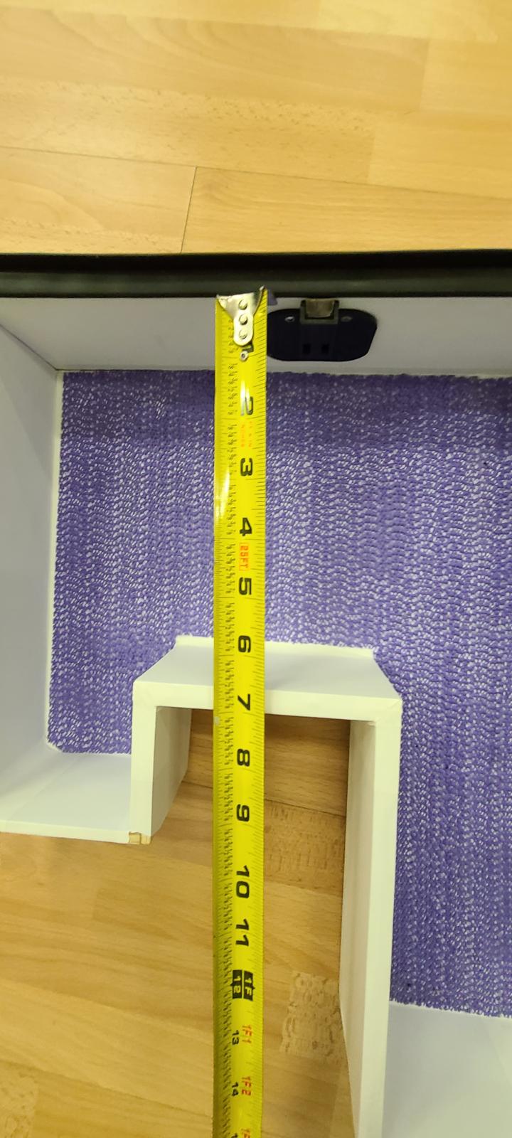

I thought I would wrap up this post with my findings. I was able to buy a later-model drawer that matches the colours of my early van. It slid in just fine but the latch did not work. I measured it a bit and the latch is installed an 1/8 of an inch higher on the new drawer. There is also a noticeable recess in the rubber trim on the old one. I ended up cutting back the trim on the new drawer to match the old, and unscrewed, slightly bent and then re-installed the metal catch to make up the 1/8 of an inch. It's almost perfect but then the old drawer was always a bit finnicky anyways. My one thought is that I expect the slides installed on the inside of the cabinet probably extend back much farther in the late vans -- but since i store my anvils in the luggage rack and not in my cutlery drawer I doubt this will be a problem.
Comparison of the two styles -- look at that extra space for losing things!
The new later-model drawer
The earlier one with the recess cut into it.

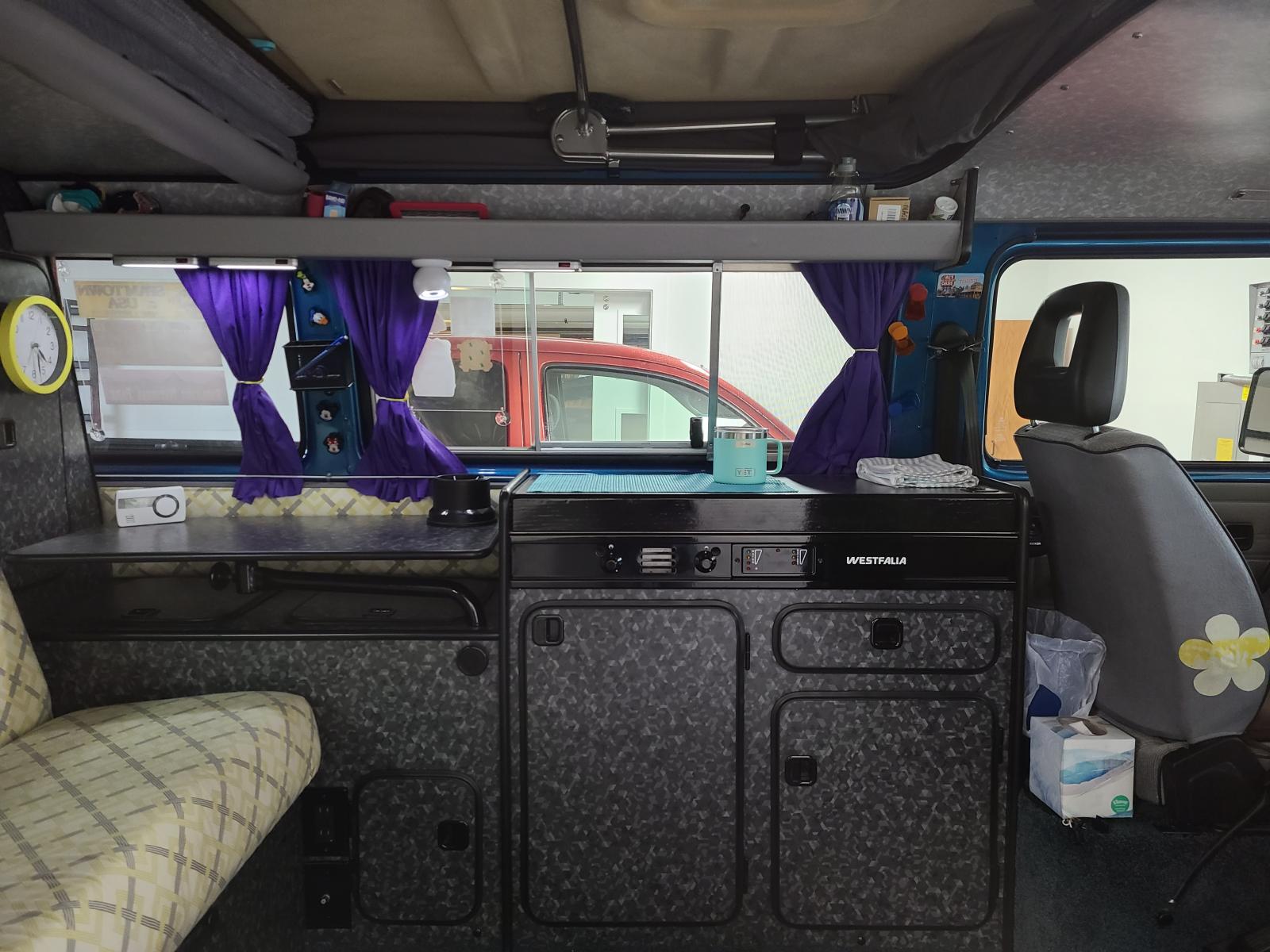

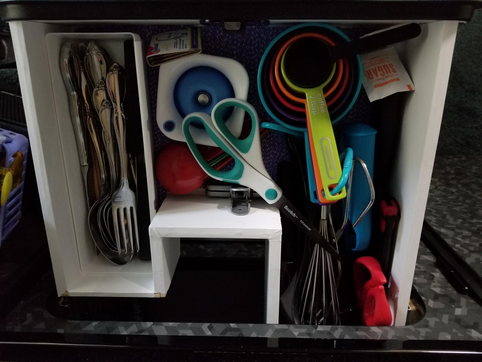

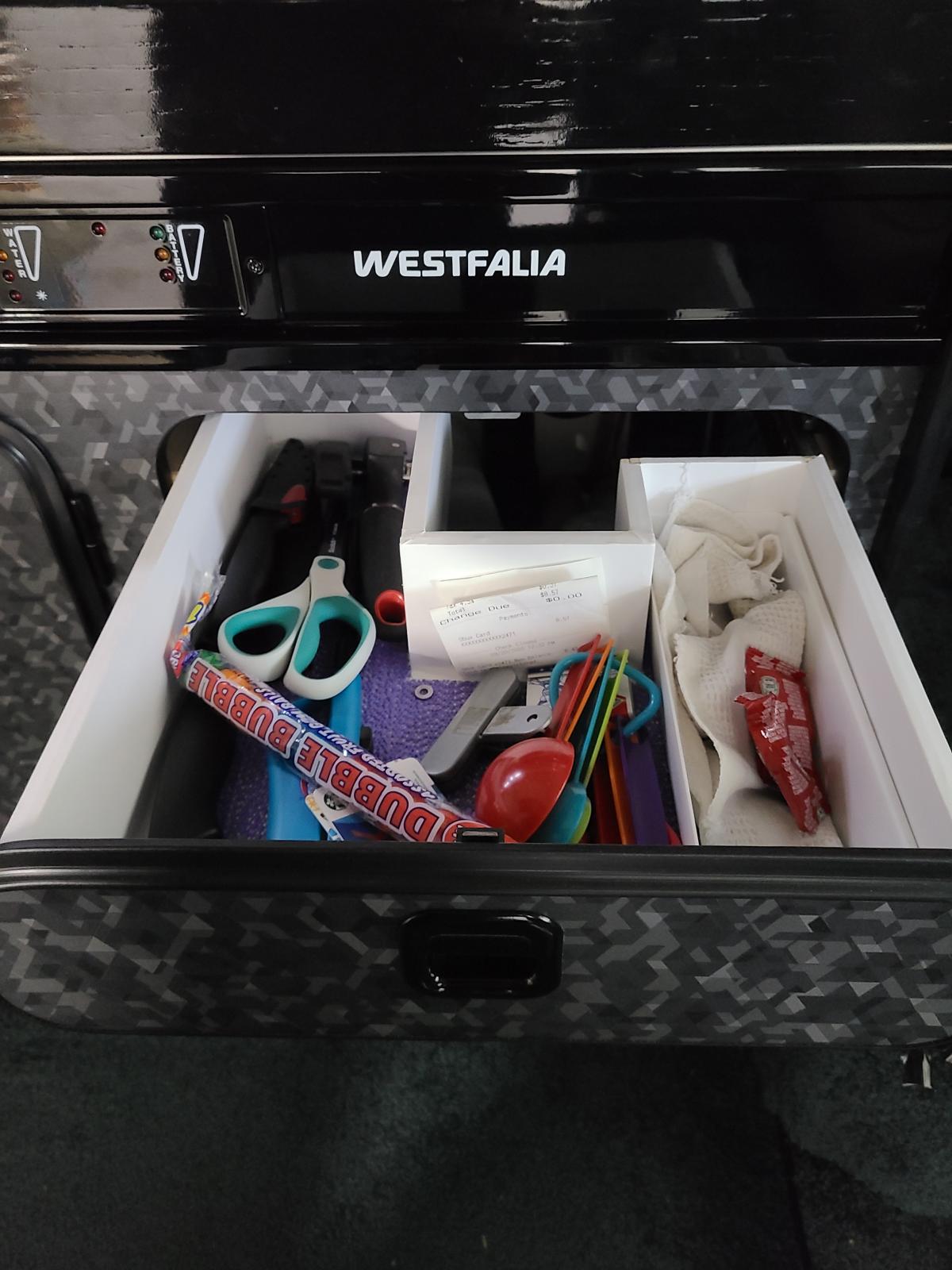

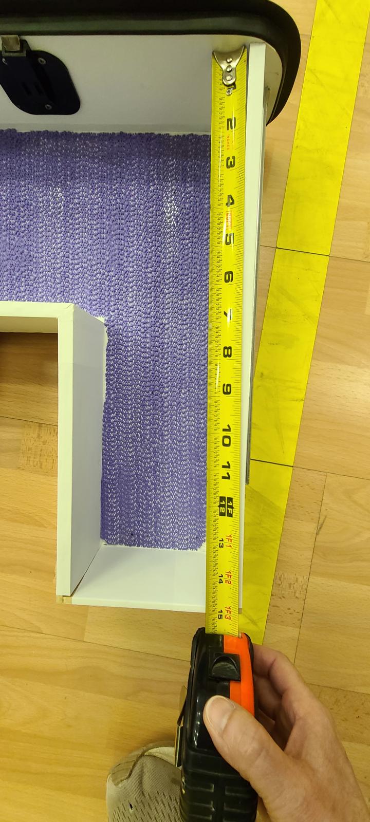

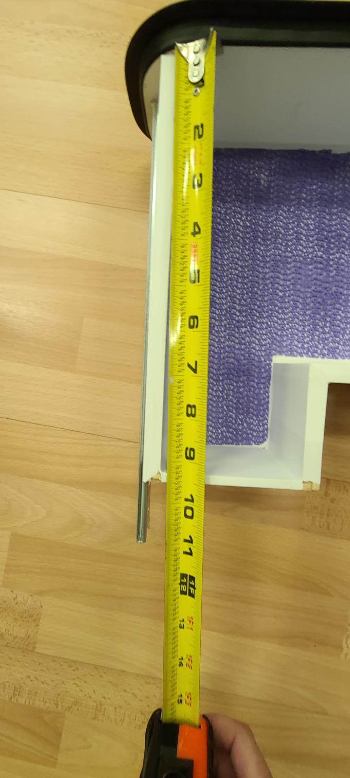

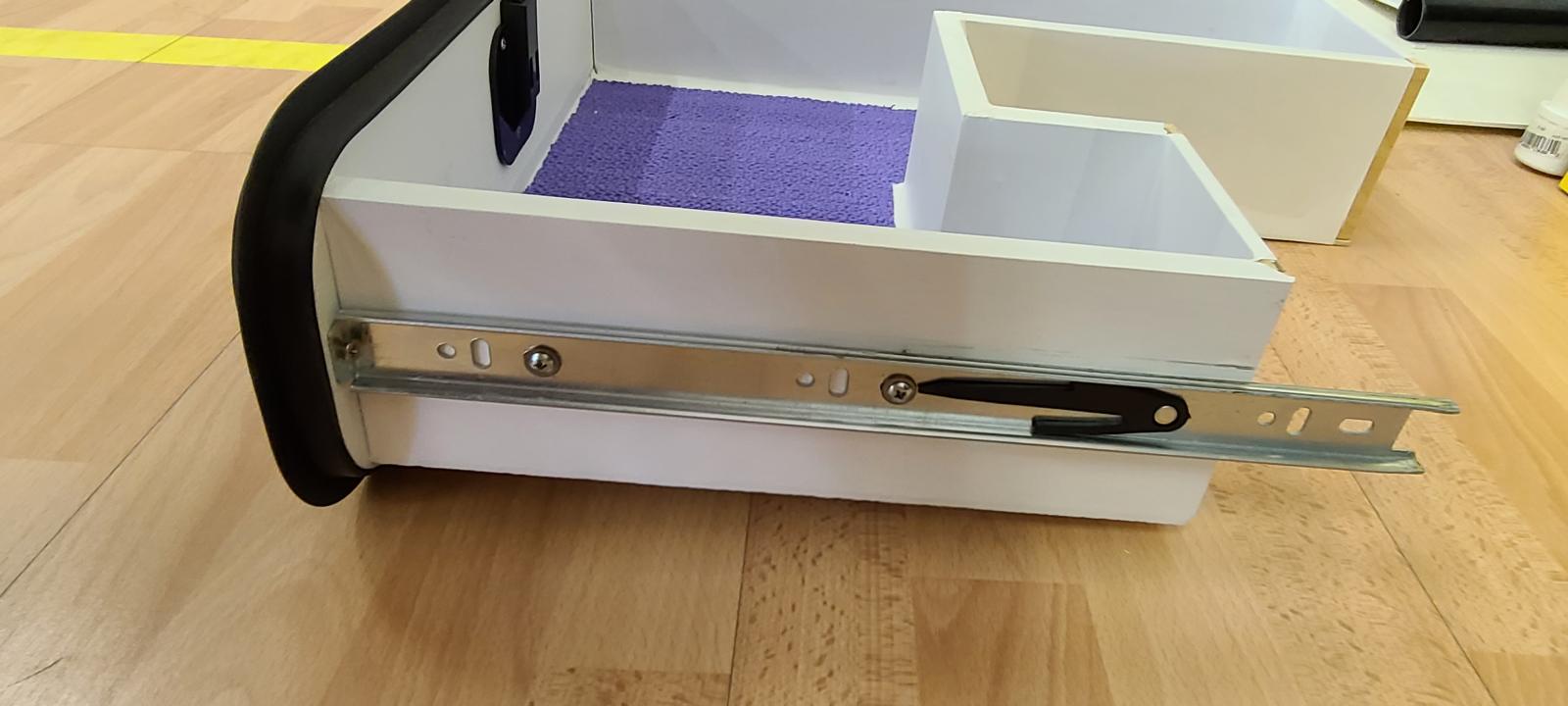

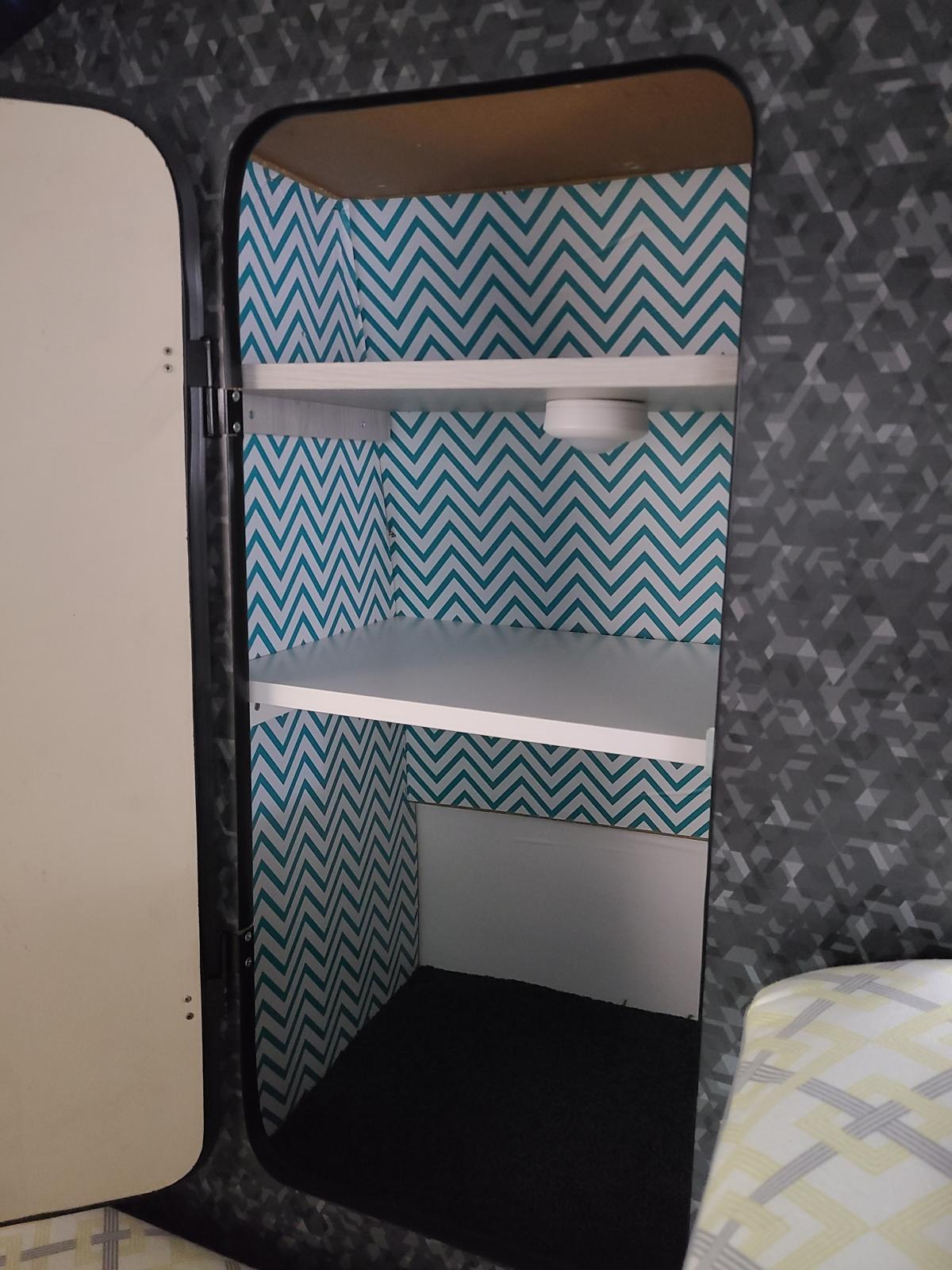

1980 Westy - we modified our silverware drawer; added drawer slides too.

PostPosted: Mon Apr 18, 2022 9:14 am    Post subject: Re: Newer, larger kitchen drawer in older van? Reply with quote
VeeDubn wrote:
Any other pictures of your interior? I'm intrigued...

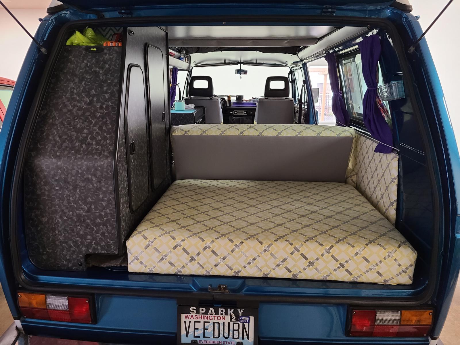

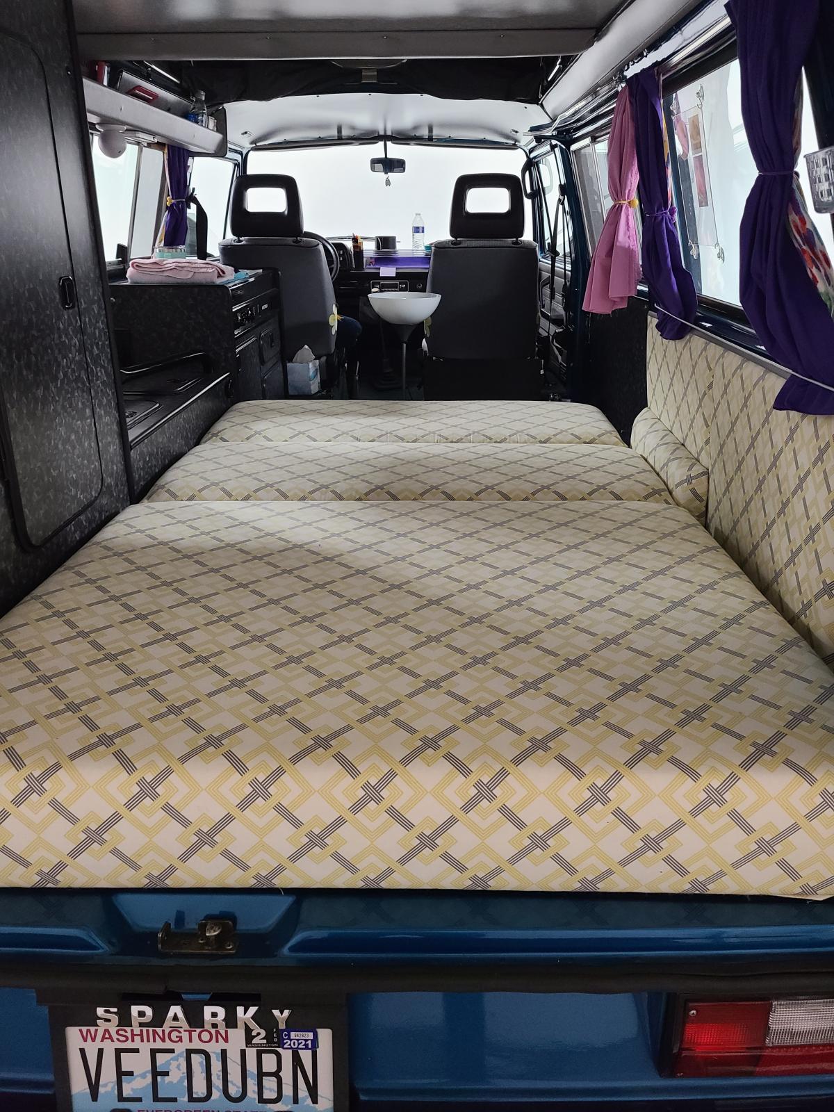

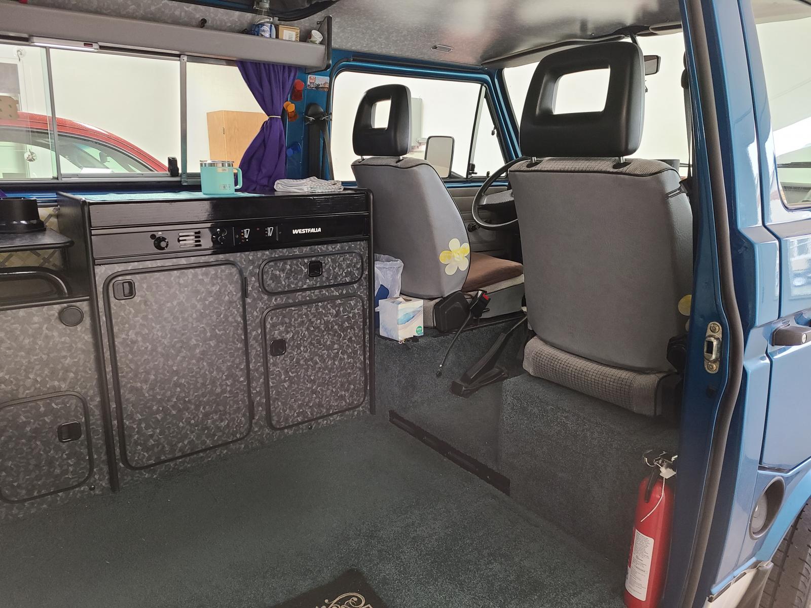

PostPosted: Mon Apr 18, 2022 8:43 pm    Post subject: Re: Newer, larger kitchen drawer in older van? Reply with quote
Pchill2 - Additional pictures of our interior . . .

PostPosted: Tue Apr 19, 2022 5:26 am    Post subject: Re: Newer, larger kitchen drawer in older van? Reply with quote
Love it!
PM'd you (I don't want to railroad this thread with questions)
