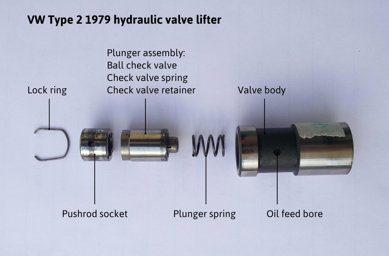

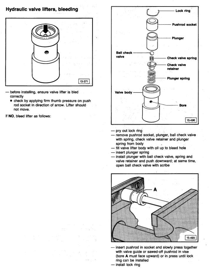

stwesty wrote:
The lifter priming instructions in Bentley are incorrect, at least for my lifters, so I'm not sure they'll add a lot to my confidence in making the adjustments.
I can't recall where it was, but someone else said that the Bay Window Bentley bleeding instructions were a bit awkward to follow, as they require the use of a press while the lifter is submerged in oil.
They suggested to follow the Vanagon WBX procedure instead, which instructs you to use a simple bench vise, a scribe and something to push the lifter with (valve guide/sawn-off pushrod/hardwood dowel?):
What I found out by looking at some different hydraulic lifters is that while they might look the same from the outside, the parts inside do vary in how they are constructed and assembled. That might make the instructions for bleeding the OEM ones either not apply directly.
The Febi lifters from ratwell's hydro page for instance look quite different to mine when I took them apart (I don't know who manufactured the OEM ones, though). Interestingly, the instructions for the Febi 07762 lifters describe only the in-vehicle bleeding procedure:
I cannot find the pictures of my lifters right now, but I'll add them later if I do.

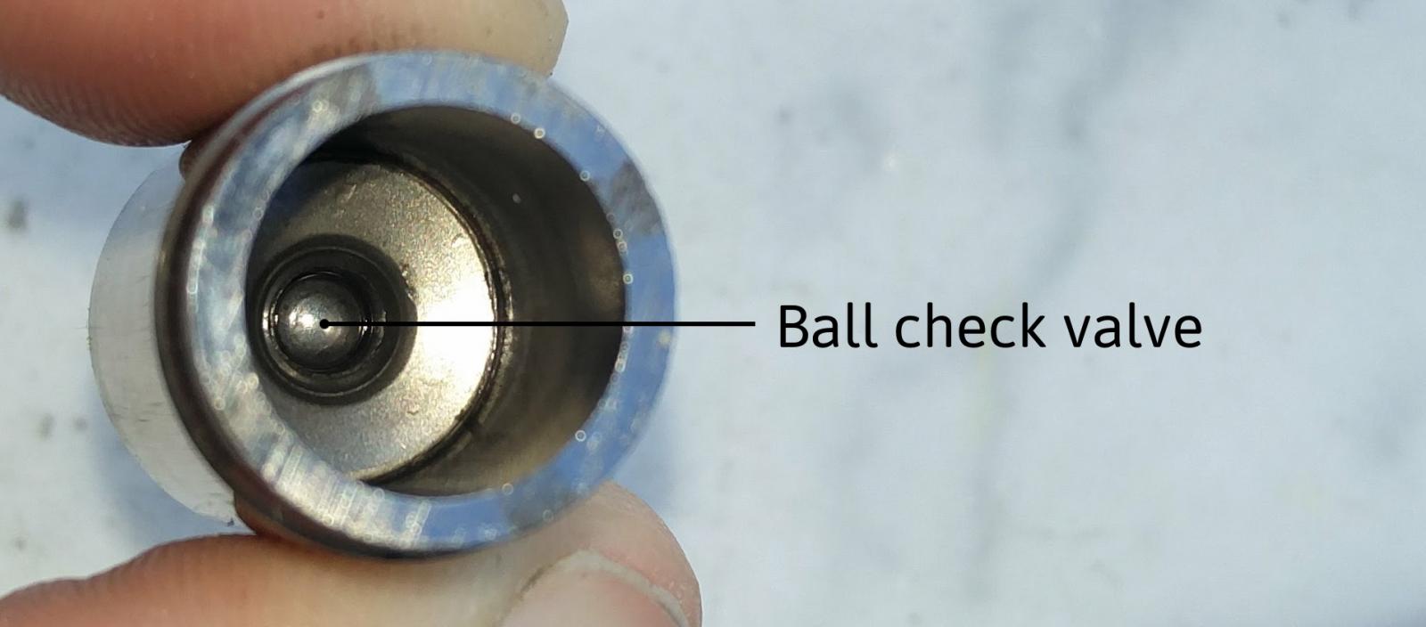

I found the pictures of my OEM lifters and I just added some part descriptions:
Do yours looke like this one?
Note the slight differences in the plunger construction comparing them to ratwell's aftermarket hydro lifters in his excellent article. That initially confused me a bit when trying to understand the Bentley bleeding instructions before I took one of the lifters apart and finally saw that they matched the Bentley diagram.
And here's a picture from Samba member gil in the Vanagon forum, which shows the differences in plunger construction from different makes. It shows the check valve taken apart too, which is nice, but I didn't feel the need to disassemble it myself.
More examples of different hydro lifter internals on this 914 world forum post. I'm mentioning all this as the manual bleeding procedure might vary between them.

Oh, I'm not making any statements on quality or tolerances between brands. I don't have an accumulated experience with different types of hydro lifters to give any advice on that.
As the OP stated that the bench bleeding instructions on Bentley were incorrect for his lifters, I was simply making an observation that the socket/plunge assembly design does seem to vary between makes. That's something that puzzled me at first too, and it could have been the reason why the instructions didn't work for him.
For instance, on the Vanagon forum they describe an alternative procedure that relies on aligning the oil feed holes of the body and plunger to hold them down with a drift punch.
https://www.thesamba.com/vw/forum/viewtopic.php?t=331065
I had tried it on my lifters back then, and noticed that that procedure could have never worked. The socket and plunger are separate on mine, and the oil refill is not done through a hole in the plunger, but through the four metering grooves in the socket. Thus there were no holes to align.

Go argue with VW. Here is the 1979 manual. That is hydraulic isn't it?
“Most people don’t know what they’re doing, and a lot of them are really good at it.” - George Carlin
