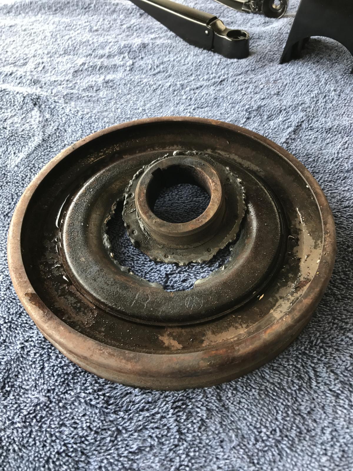

This could be helpful to some of you resourceful owners. I recently made this puller out of an old C-clamp and the hub of a bent pulley. The hub fits and works great!
Hope this helps!

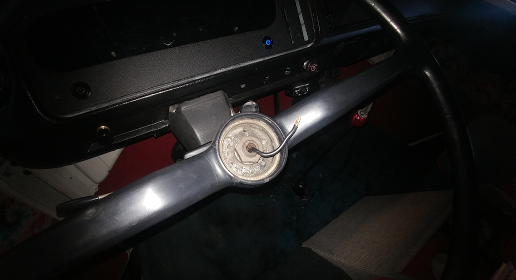

Anyone have a horn button and ring for this steering wheel for sale? Cant seem to find one anywhere and am in desperate need. I can be emailed at
[email protected]
I think this is a 74-78 wheel?
busdaddy
Joined: February 12, 2004
Posts: 52797
busdaddy is online now
PostPosted: Wed Jun 06, 2018 5:17 pm    Post subject: Re: Steering wheel removal - tutorial (1971 bus) Reply with quote
