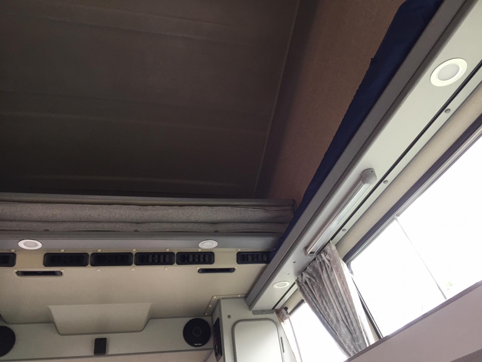

PostPosted: Fri Jul 06, 2018 8:47 am    Post subject: Re: Aux Battery & Accessory Setups: Pictures & Diagrams Reply with quote
lucianosanchez wrote:
What lights did you install there? Have a link and a closeup picture of what they look like and maybe a night picture? Do they sit flush? They look nice from this picture.
Here are some night shots of the house LED's including the location of the switch:
Galley Light
House Lights (galley light off)
Rocker Switch
Additional questions/comments are welcomed.

Really nice setup, looks great! How hard was it to route wiring to that switch location?

Alaskaberrys wrote:
Not at all difficult. That factory ceiling trim panel was 'made' for these lights and the wiring - after removing the trim piece (four screws) I cut out the two 2.17" holes for each light wired these and the two galley lights towards the rocker switch location and then wired the power (from the switch panel) through the closet, to the curtain tray, under the trim panel to the rocker switch location. There is lots of clearance under the panel for both the wiring and the lights.
I then used a step bit to drill a 3/4" hole for the rocker switch and pulled the wires through, made the connections and installed the rocker switch. There was no real problem threading the wires to the rocker location other than there was some foam insulation to work around which was only a minor issue.
To install the galley house lights, you have to remove the curtain tray and then disassemble it to cut the holes. While a router would have worked best to cut into the 3/4" plywood, some careful jigsaw cutting and drilling sufficed. In all, the factory trim fitment actually helps to hide the wiring and make for a clean install.

PostPosted: Fri Jul 06, 2018 6:18 pm    Post subject: Re: Aux Battery & Accessory Setups: Pictures & Diagrams Reply with quote
Looks really good. Nice job and thanks for the night pictures.
