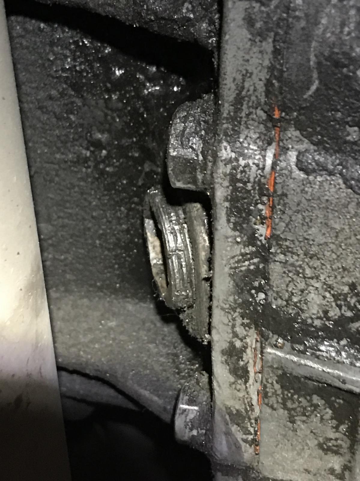

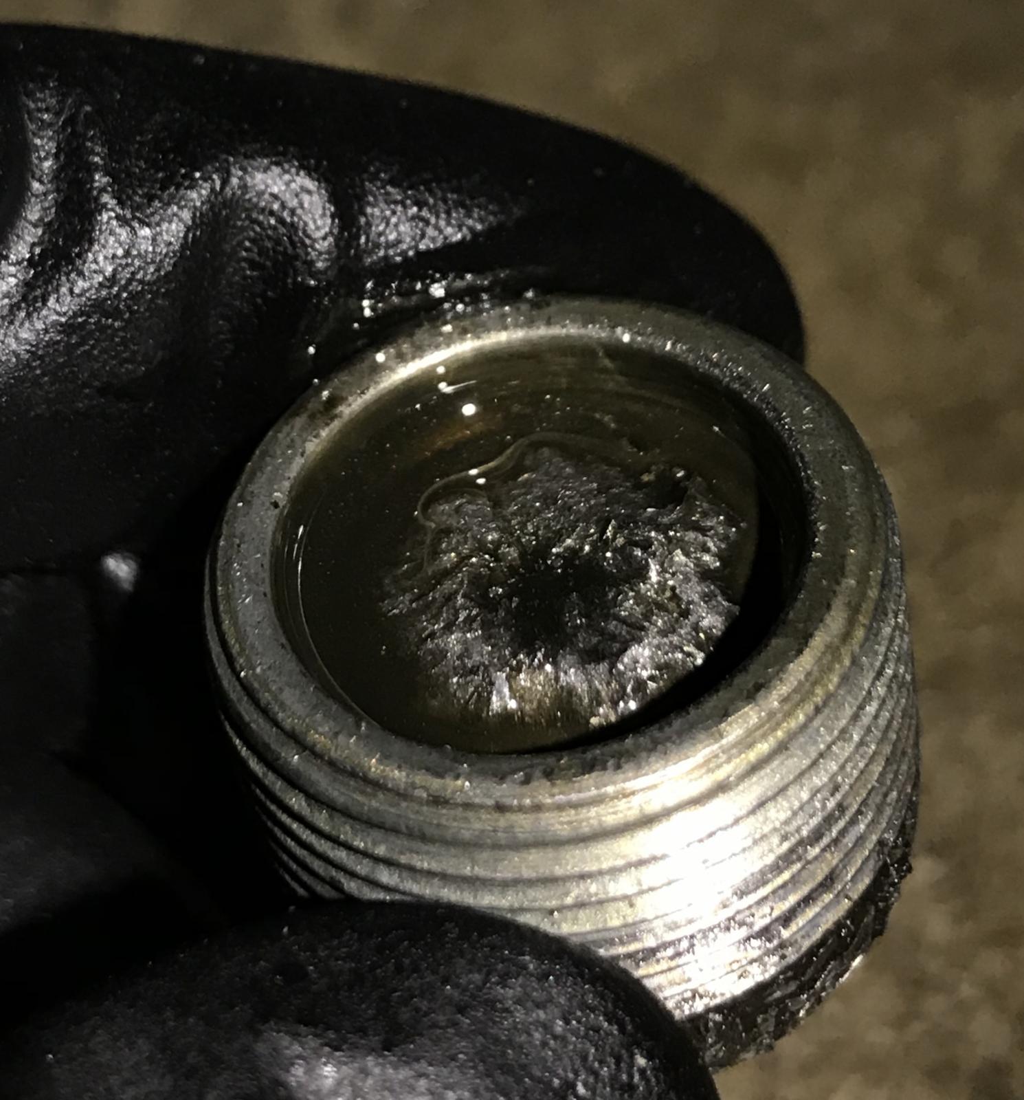

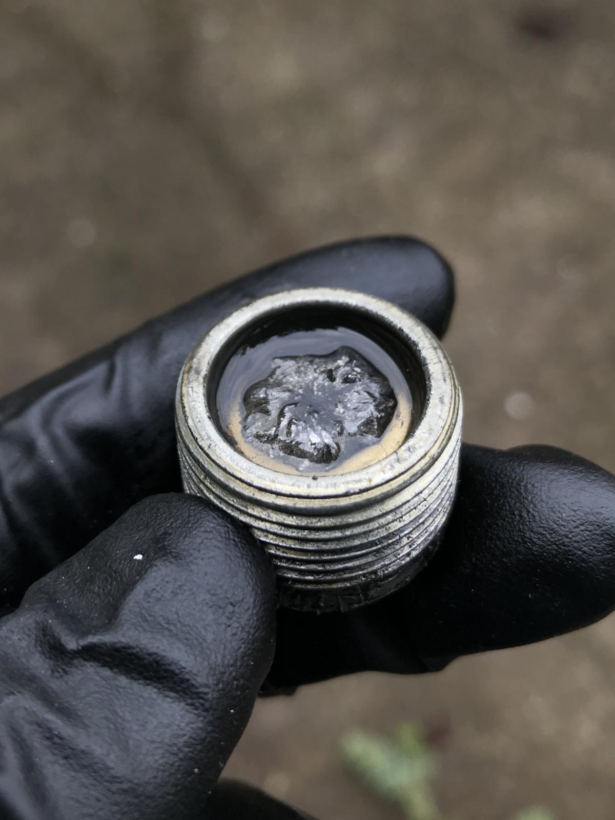

Well, I finally got around to draining the oil and I have no idea what to think about it.
The first thing that was odd was seeing how the drain plug was sticking out (notice the tool marks too). In the photo below, I had not tried loosening the plug yet (it was very tight).
The space between the exhaust manifold (of our EJ22) and the drain plug made it impossible to use a 17mm allen socket. After trying to weld an M10 nut to a piece of metal and findout out I'm no good at welding, I found a 7/16 rod coupling nut and cut it to 3/4". It fit perfectly inside the drain plug and removal was a breeze (I had already made sure I could remove the fill plug).

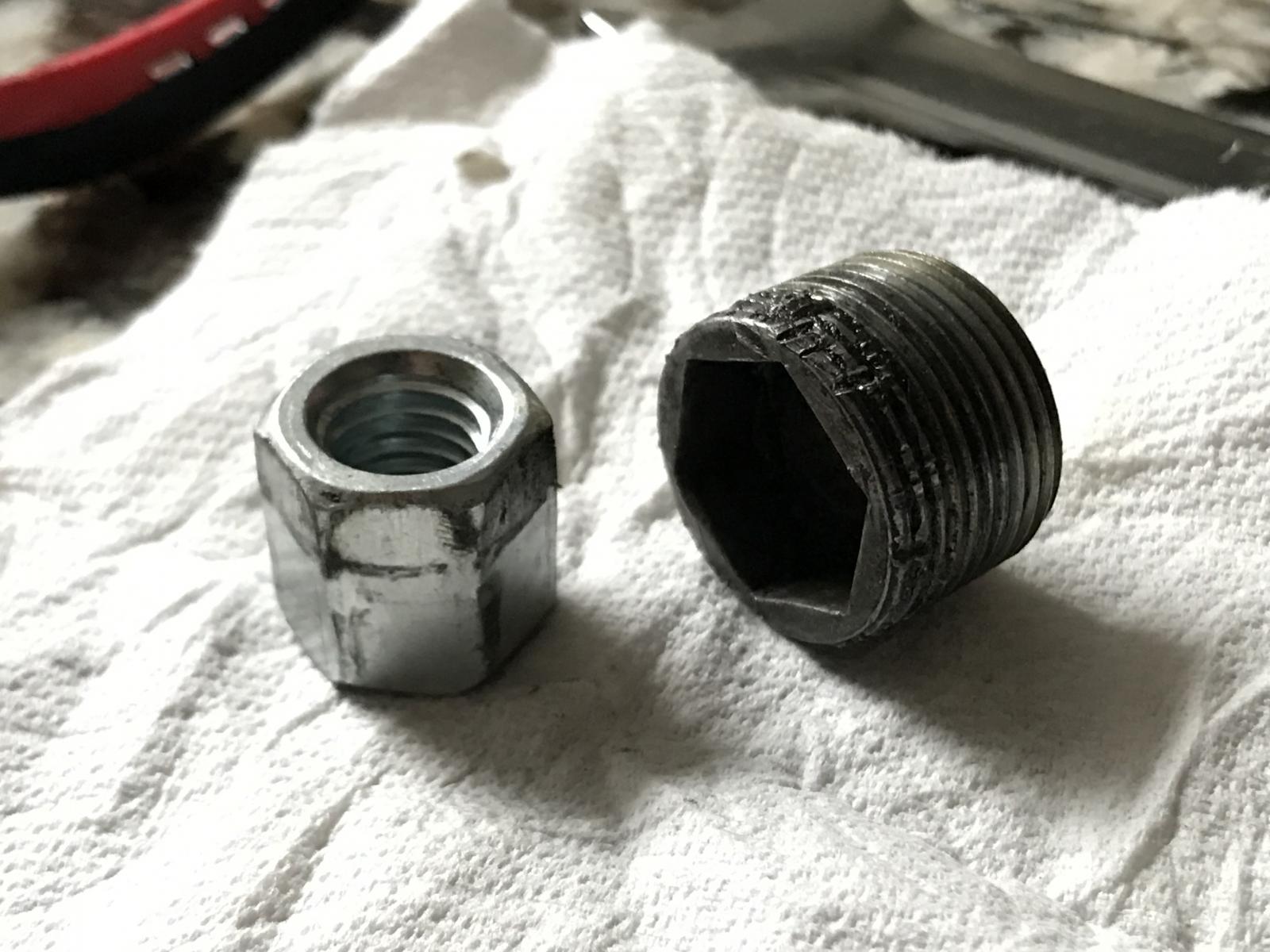

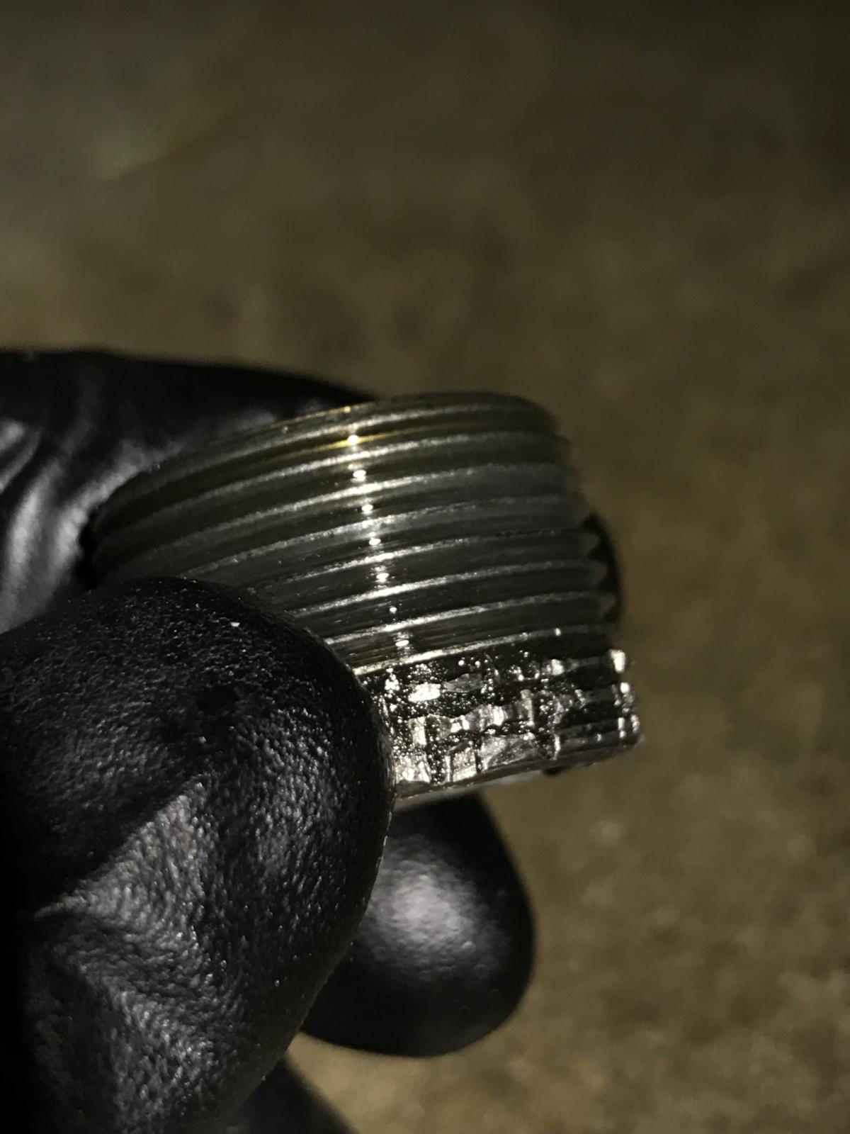

Once loosened, I pulled the drain plug out and found out that there is no long magnet on this drain plug as I expected from this syncro transmission. Is this normal?
Therefore I have no idea if we had metal chunks floating around in there. I didn't think about sifting through the oil until it was all drained. I might try to pour it through a strainer to see if anything obvious gets stuck. The oil poured out somewhat golden and shiny. It was hard to capture in a photo, but it looked like metallic paint.
I'm not too sure what to make of this. I have 5 quarts of Valvoline Synthetic 75W80 I'm getting ready to pour back in but I might want to chase a magnetic drain plug first. Ideally I'd put Swepco 210 but couldn't get any in time before this weekend (we have a short trip we're trying to make with the van).
Anyhow, here's another shot of the tool marks on the drain plug.
dobryan
Joined: March 24, 2006
Posts: 15866
Location: Brookeville, MD
dobryan is offline
PostPosted: Wed Feb 13, 2019 6:15 pm    Post subject: Re: Syncro rattle grinding whine noise. Bad VC, transaxle, diff? Reply with quote
Looks like someone removed it with vice grips or a pipe wrench at one time in the past.
That gear oil is very nasty. Bad things have been happening in that trans... Sad

MarkWard
Joined: February 09, 2005
Posts: 15911
MarkWard is offline
PostPosted: Wed Feb 13, 2019 6:20 pm    Post subject: Re: Syncro rattle grinding whine noise. Bad VC, transaxle, diff? Reply with quote
Vice grips when someone did not have the correct tool. I see red silicone on the bell housing seam. That is not factory. Metal Dustin the oil is signs of something coming apart. I'd not drive it if you are home. Clean lube isn't going to save anything. These are very expensive transaxles to chance a big failure. A simple refresh might get you back on the road. The red silicone and a drain plug with no magnet make me suspect of the unit.

PostPosted: Wed Feb 13, 2019 6:35 pm    Post subject: Re: Syncro rattle grinding whine noise. Bad VC, transaxle, diff? Reply with quote
Have that trans rebuilt, do not pass go, don't collect $200. That fluid says something is quite wrong.
The tranny drain is supposed to sit proud like that but it is supposed to have a magnet and not have vise grip marks on it from a bad PO or bad mechanic.
Prob has vise grip marks on it because of the EJ22 exhaust blocking hex access.
That someone elected to change trans lubricant even though they didn't have a special tool to fit a converted
van with exhaust blocking access, doesn't automatically mean they are bad PO/mechanic.
It could suggest they value clean lubricant ahead of an insulted drain plug.
At least they changed the oil.
Many Vanagon owners (prob 95% don't change their oil at all.
Vise grip marks could be a feather in his cap, actually putting this person in the upper echelon. Shocked
Perhaps over-optimism. More likely is what Syncrodoka wrote... Rolling Eyes
OK now the pessimism.
This person put a drain plug back in that had the magnet broken off.
Or I wonder if that magnet broke off inside and is stuck somewhere inside that trans.
Or chewed up ----> and stuck ALL OVER inside that trans.
Maybe they needed to just get a plug in, get oil in, and intended to renew the plug (soon) and forgot.
Maybe the fluid was so full of metal they just decided to sell the van.
Maybe the plug was covered with shattered/chewed magnet.
Sorry for the doom and gloom.
If that magnet looked like everyone else's (completely covered with metal) I would still offer doom and gloom.
Only "clear space" on a magnet is good.
A fully covered magnet signifies this trans has been un-maintained for anywhere from 5,000 to 90,000 miles or more.
But yours doesn't even have a magnet to show if there was "clear space".
Your trans has to be rebuilt, for sure. But does it make any noise? If it happens to be "quiet", and your checkbook is not ready for a whippin'.....maybe give it one more chance. Fill it with $16 flaps oil. Put a new drain plug magnet in and drive it around, like 500 miles, getting it good and hot like an hour at freeway speeds. Then dump it out hot. This is a "flush" because that trans is certanily polluted. Then do $16 again as soon as you can tolerate. If the magnet comes out clean..... you can make some decisions to run it longer or get out the checkbook.
There is no lubricant that will heal your worn out bearings, but getting any abrasives out sooner will let it run some more miles. Be careful putting in $70 oil,
you're better off using 4 batches of clean FLAPS oil for $64.
Keep aware that the longer you run this old trans, the old parts are letting loose metal trash, polluting the lubricant, more and more all the time, and sooner all the time. Your oil change intervals need to be shorter each time. Oil with metal dust in it deletes future miles from very expensive parts. No rocket scientology here, this is all obvious (but not very popular).
If going under the van is not difficult (for you) this might be a doable option for this tranny's last gasp.

Thanks for the detailed tips! Honestly we were aware that we'd probably be due for a transmission rebuild sooner than later... we just wished it was a wee-bit more on the "later" side than the "sooner" one! At this point the van is home, the transmission was drained while it was still driving (more or less) fine, the drained oil shows signs of serious wear, our VC is shot and the weather is dreary... Even if we weren't planning for this $$$ expense to happen so soon, it might be worth just giving the van a break and dropping that transmission/front differential for some well deserved TLC.
