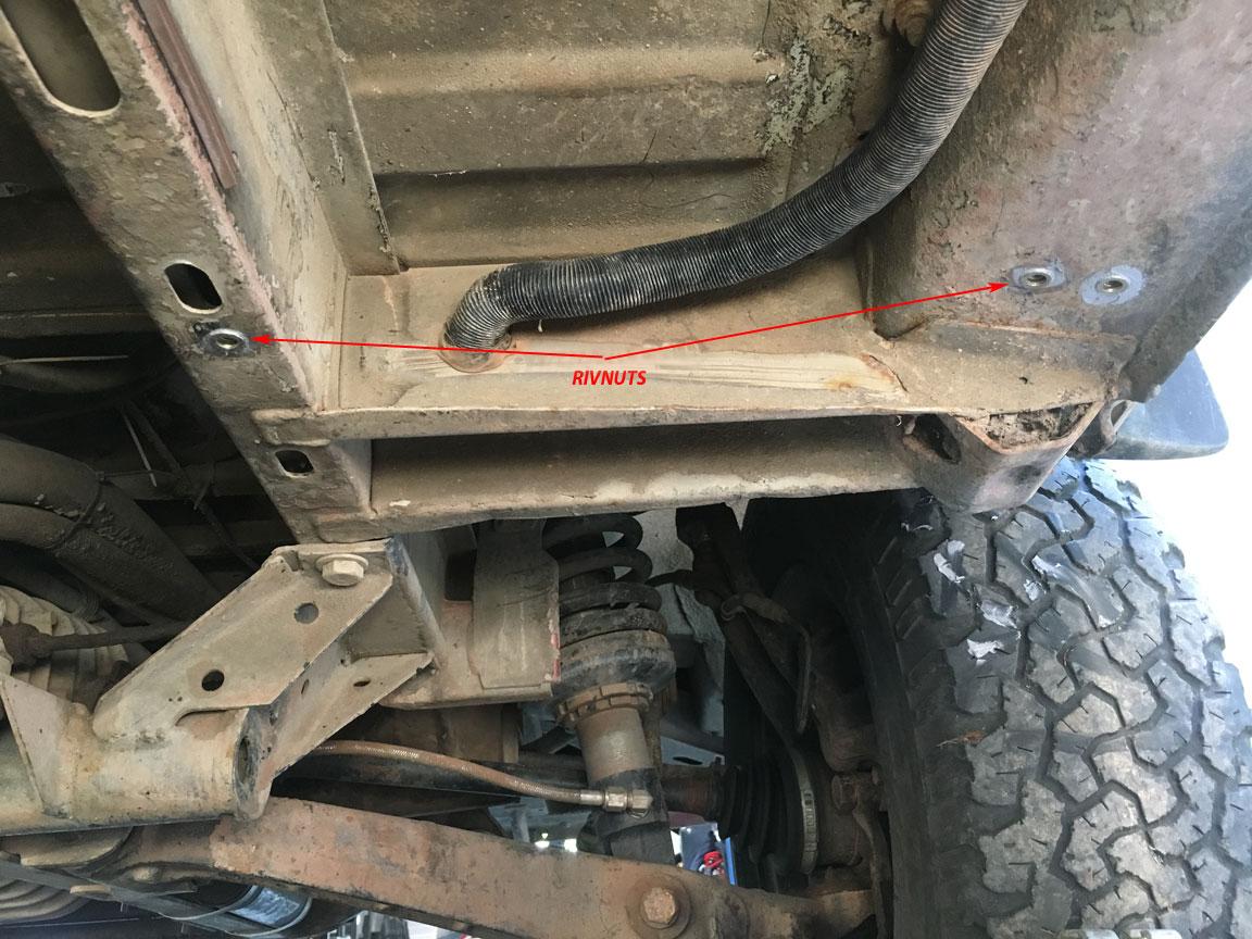

I've finally mounted the 2-gallon tank.
Tank is not bolted to the mounts. It just 'slips in' and nests tightly. And lifts out, no tools. I'll probably add more security when I think of a good way.
Here's the mounts. 1 x 1/8" angle steel with adhesive EPDM rubber pads.
I used rivnuts, wetted first with Permatex Ultra-gray
Here's the forward mount.
Now all that's left to do is run outta gas....

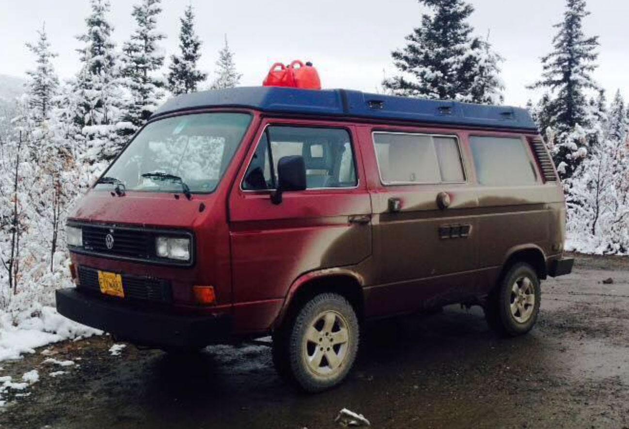

Heres a pic I found somewhere of the classic 'red cans ontop'. Westy VW buses often had the red-can.
My 2-gallon aluminum tank hides better in the westy cargo rack.

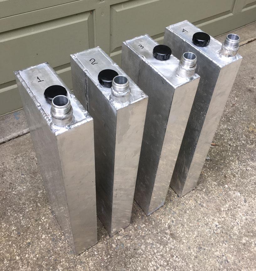

Well I got 4 tanks done.
Here's what they look like inside.
They are extruded aluminum tubing.
Testing them for leaks, I could never get them to weld tight, there was always a pinhole.
So I sealed them with "fuel tank sealer".
Then looking at the pic sitting in the cargo area I had a thought.
These things are effin' strong.
If I made them like wedges they could be my leveling ramps, with adhesive "sanded" grip tape on them.
Actually I can use the one as a 3" leveling block.
