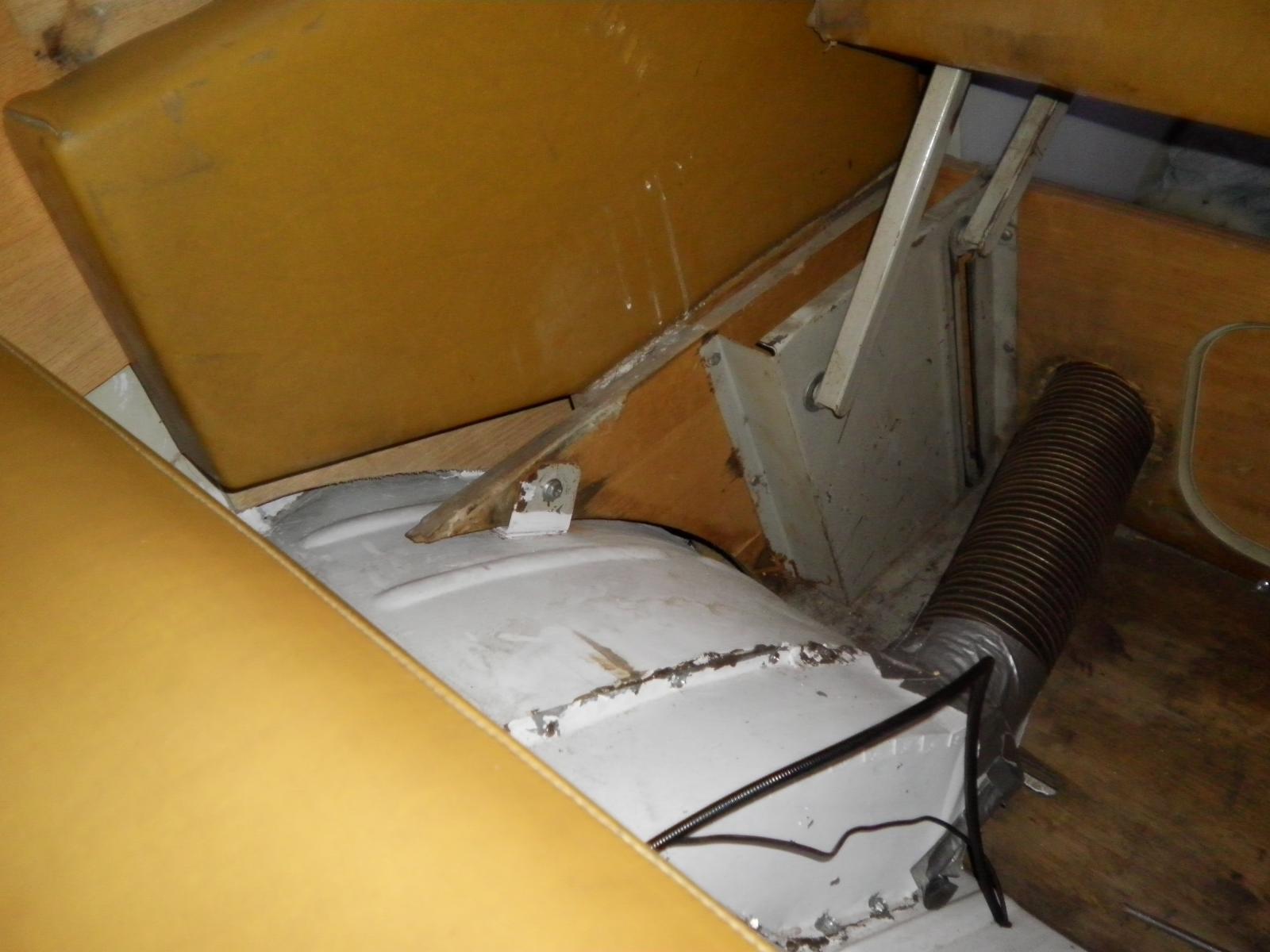

Mine is inside the bus under the water tank in the cabinet. Once it gets the interior up to temp, the speed slows down and you won't hear anything from the heater its self, even less if it's in the engine bay. The only noise you will hear will be the tick of the fuel pump (and this can be reduced and should be outside the bus anyway). You do want to recirculate the heated air or the unit will be working much harder to heat the air. Keep that in mind if you mount it outside. Also the electronics are not water resistant at all

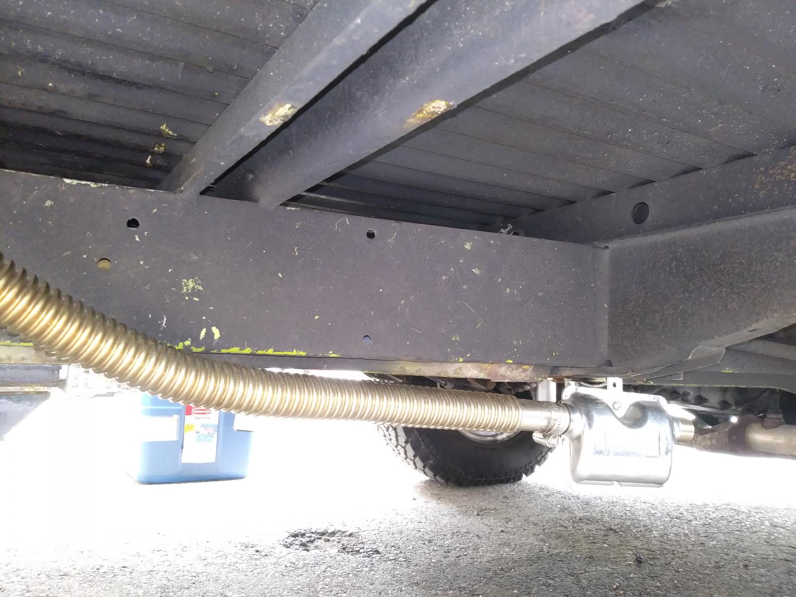

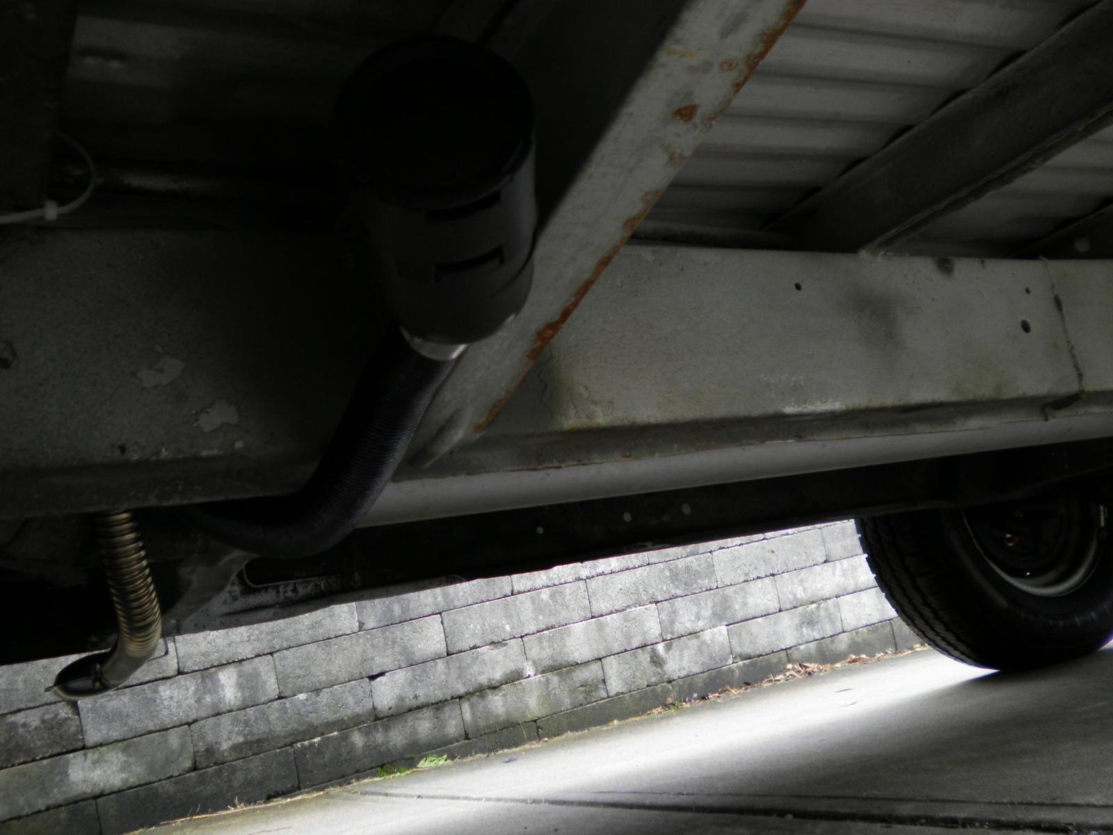

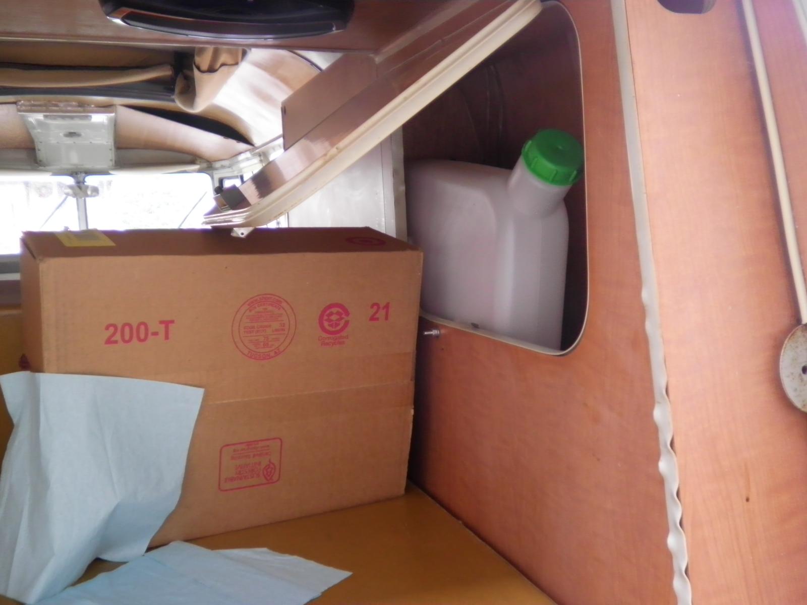

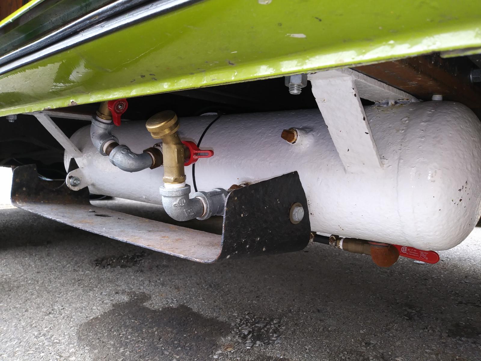

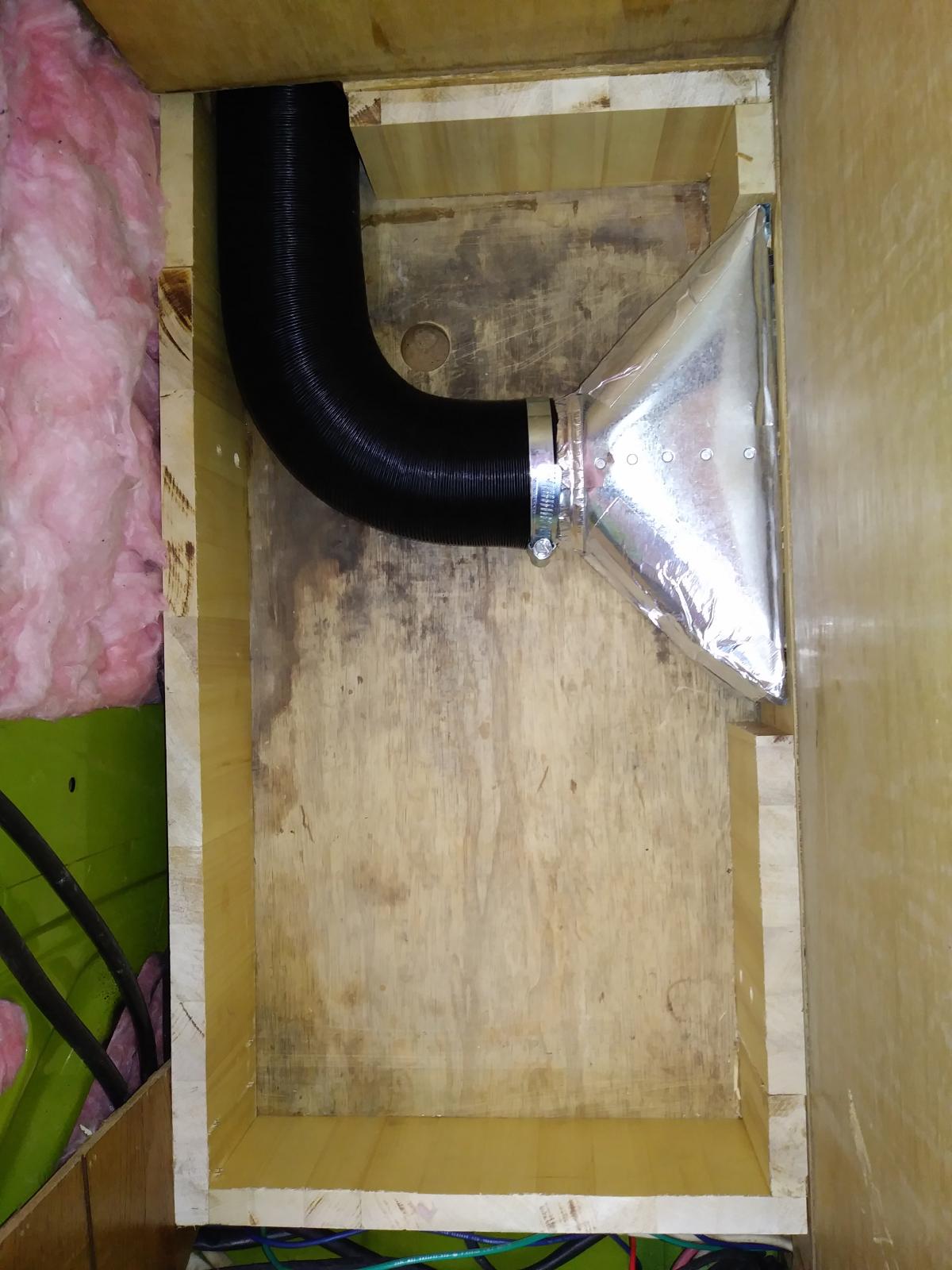

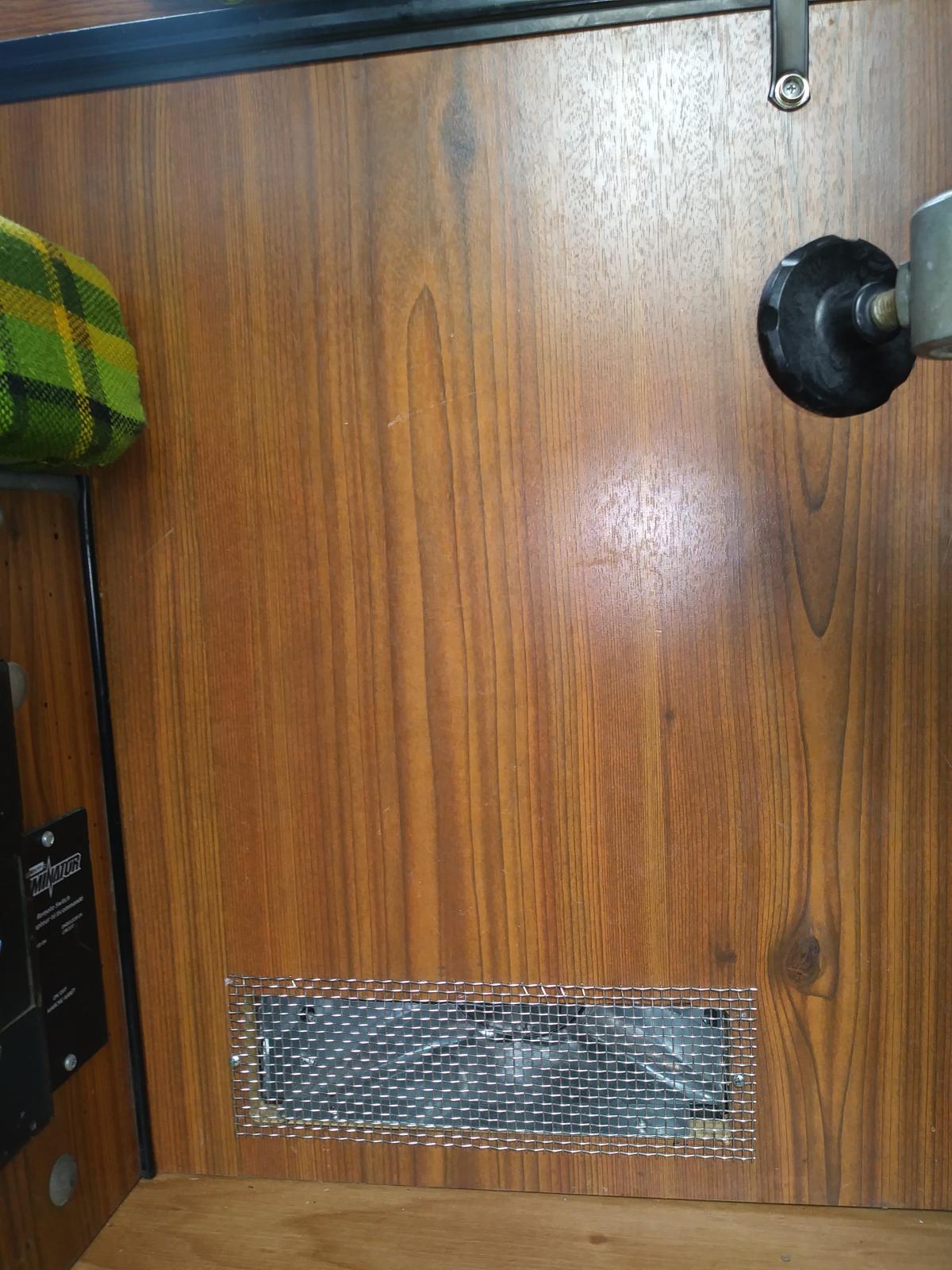

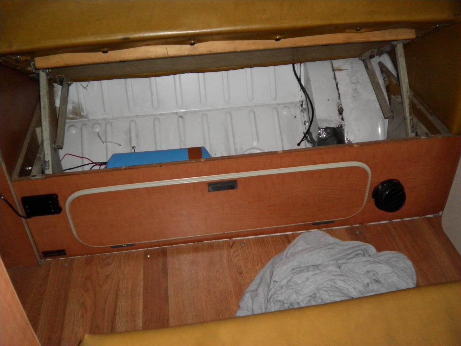

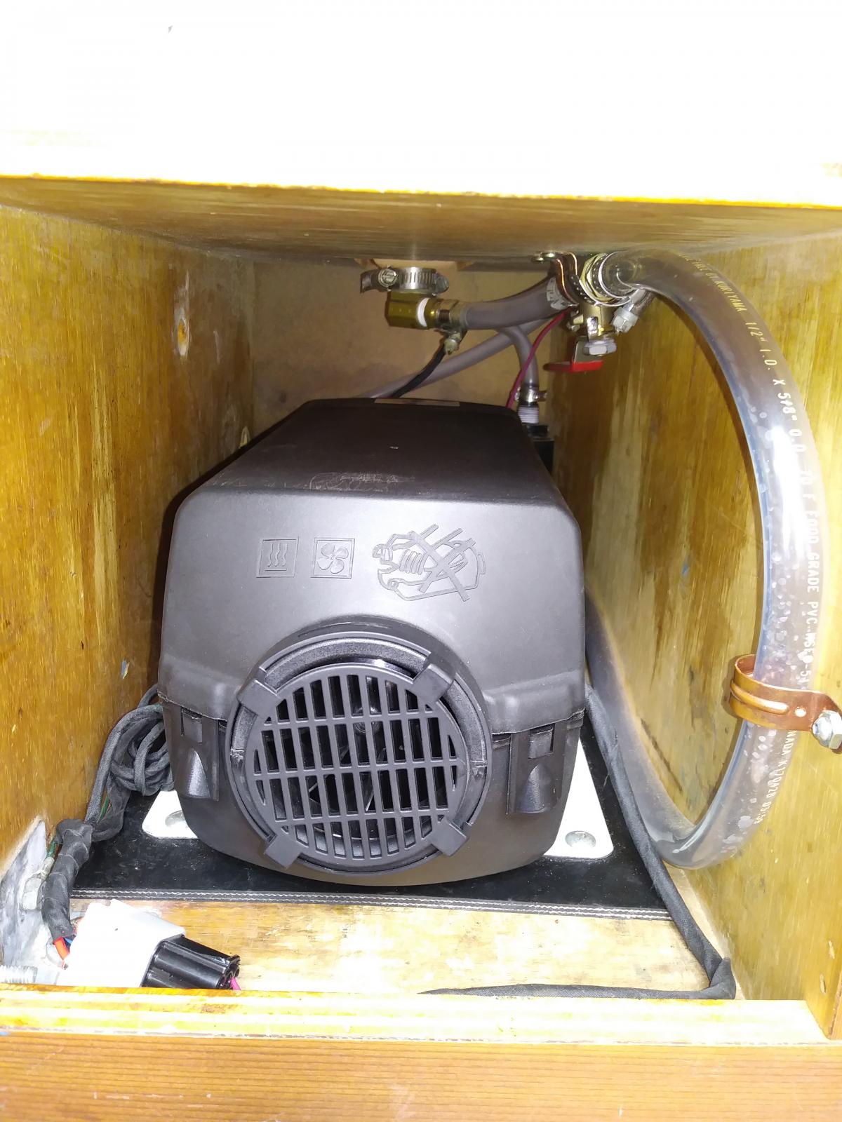

Some install picks
DIY mounting plate
Heat outlet running under the fridge
Propane tank converted into diesel tank
1979 Westfalia "FireFly" Subaru 2.2 with Subaru gears 5spd.
Build Thread: http://www.thesamba.com/vw/forum/viewtopic.php?t=634777&postdays=0&postorder=asc&start=0

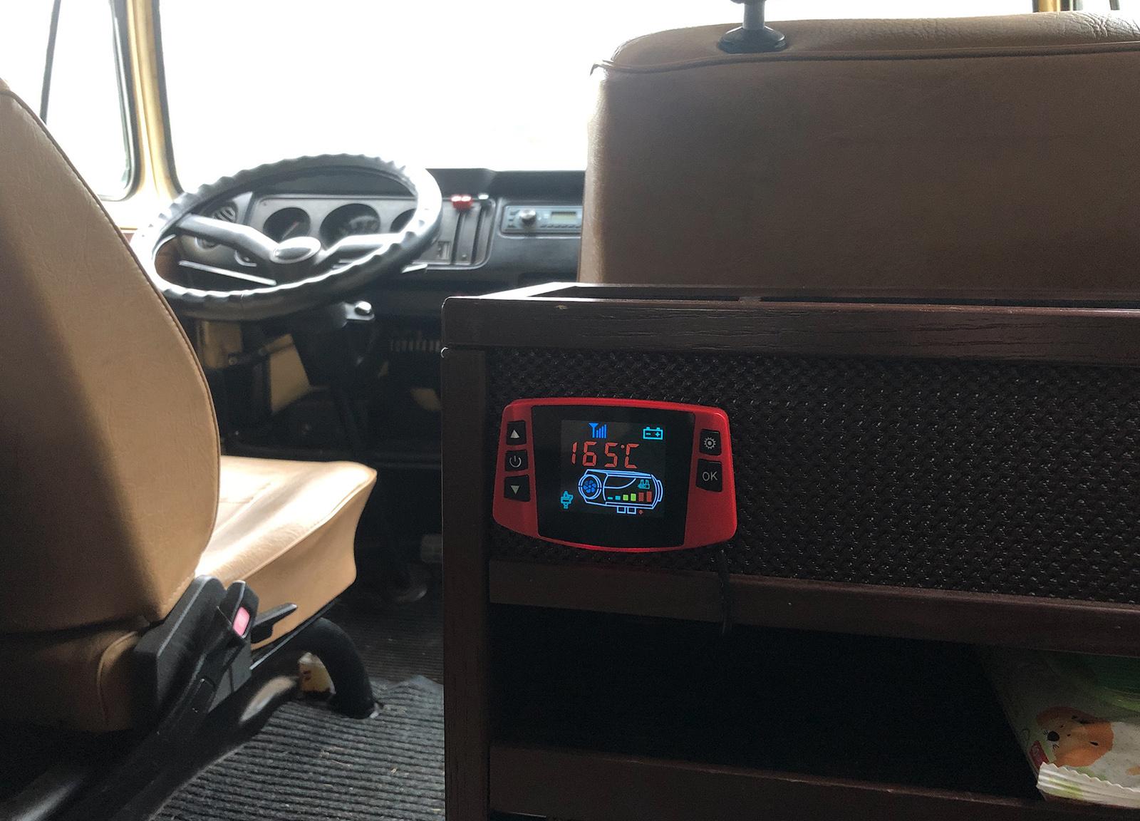

Good looking install. Regarding your LED controller. I purchased an identical controller separately for my 2kw. My question , does the backlight stay on after you shut your heater down like the older model controller. If not I was thinking of switching this out for the 5kw I have in my bus.
captincanuck
Joined: August 13, 2014
Posts: 730
Location: The Great White North
captincanuck is offline
PostPosted: Tue Nov 12, 2019 3:10 pm    Post subject: Re: Installing a Cheap Chinese Diesel Parking Heater Reply with quote
Yes the back light on this control does shut off once the heater has completed it shut down cycle. Apparently the newer ones with round buttons and timer functions as well as the even newer ones with altitude correction do not shut off

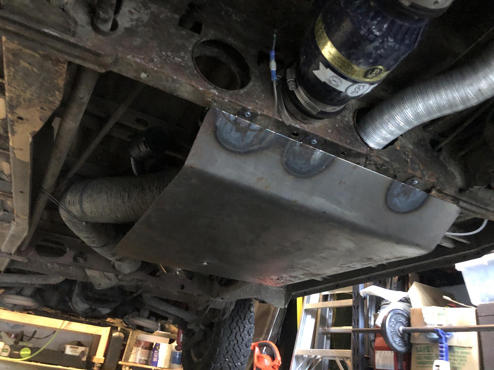

You guys have been busy while I have been out in the garage!

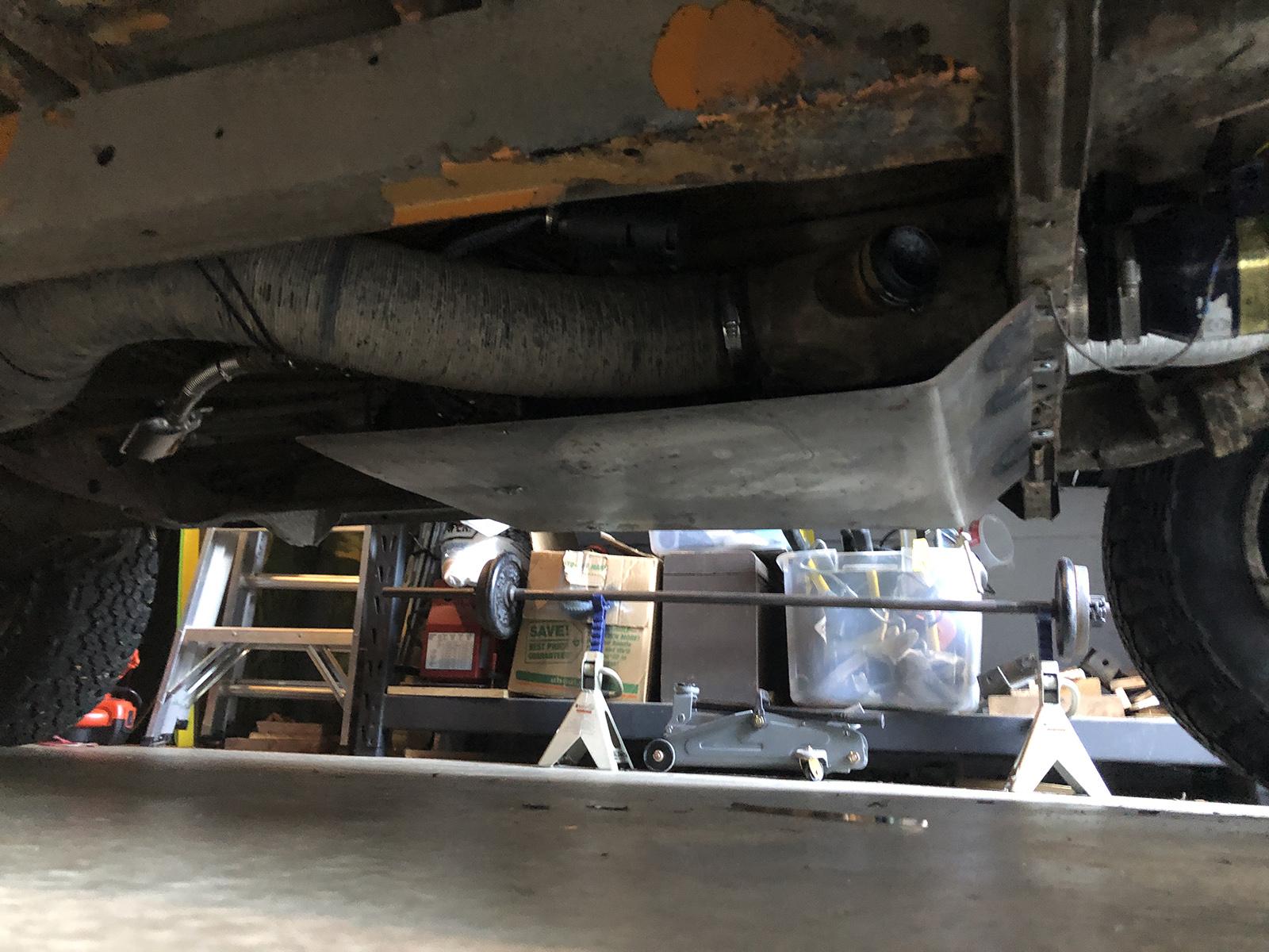

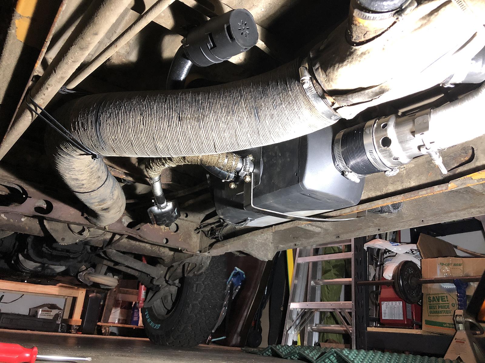

I finally got all the fiddly little parts and just got the thing fired up for the first time. It works! Hot, dry, odorless air in the bus for the first time ever, with the engine running or not! With thermostat and timer control for camping, etc. This is the dream.
I have SO MUCH to report back about this process, parts, installation etc. And I have a lot of work I need to do (like real, paying work), so I'm going to keep this short for now. More info and photos later.
For now, some big-picture thoughts on the location:

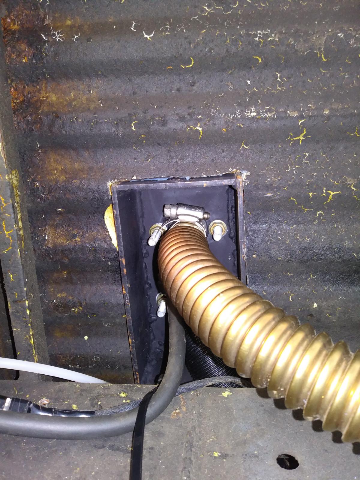

• I installed the unit under the floor, outside. It’s tucked up between the main frame rails as high as it can go. It hangs down maybe 1 inch below the rails. That’s fine. In 10 years, I’ve never hit my frame on anything - and that was with a 2.5 inch lower job. My bus (lifted back up to stock height and with bigger tires is now a solid 3 inches higher than before). So I’m content that it will never strike the ground or even come close. So it’s just about dead center on the floor any way you measure it, maybe slightly forward of that.
• I had to stretch my factory heat duct a bit and curve it to the side to make room for this, it was no problem. I clamped it to a pipe which was in my bench vise, pulled it a bit and re-installed it. Easy to do and I didn’t have to disconnect or take-over my factory defrosters which still work great while driving.
• I was adamant about ducting the warm cabin air output into one of the factory floor vents (the one between the seat, behind the walkthrough). There’s a nice 2.5-inch-or-so hole in the forward lateral frame brace, so I wanted to use that to put my duct right through there and into the factory vent. Not a fan of having my ducting dip below the frame at all.
• Finally, the combustion intake and exhaust ports on these things are situated at a 90-degree relationship to the glow plug (which is supposed to be located at the top of the heater) so all these things together presented a real puzzle with regard to where on/in the bus to locate the bugger and left me with no real alternatives that didn’t have their own problems. Oh and I didn’t want it in the engine cabin due to noise while sleeping. That’s right under the bed! So that’s why it is where it is.
• I should add that - after finally hearing it run for the first time - it might not have been that bad in the engine compartment. It's not very loud. The air coming out of the vent is the loudest part (WHOOSH!), so that's inside the bus no matter what you do, and that's a comforting white-noise kind of sound to me. You can barely hear the unit/heater/fan itself. Maybe that's because I put it outside! But I bet that the factory location inside the engine bay would be OK as well, even for an OCD person like myself who can't stand noises when I'm sleeping.
I’m happy with the location. You can’t see it AT ALL - not any part of it - from outside the vehicle, unless you get down on your hands and knees and stick your head under there. And it checks all the boxes above. Done.
More about the little challenges and solutions later.
And I’m just going to repeat this pretty much all day long… if you are installing one of these things, I HIGHLY recommend joining the facebook group and reading up. There is a LOT going on in these little units. No matter where you put it, it’s going to be a custom job and there’s a lot of opportunity to do something that won’t work well with regard to temperature, angles, backpressure, overheating, fault-codes, etc etc etc. Save yourself the trouble and read up a bit first. The kit looks pretty staright forward: wires, pipes, ducts, etc. But there’s more going on than you might at first realize.
Also, I realize that the exhaust and the fresh-air intake are too close together here in this photo. I've already added a longer exhaust pipe to move that a couple feet further back - it just wasn't done yet for the photo.
That reminds me, one final thought about this before I get back to work: The hardest part of this was twofold: 1, figuring out where to put it and 2. Having to order or go pickup lots and lots of little parts from the hardware store, eBay and Amazon. The kit was complete, but to do it the way I did it you need more ducting, clamps, reducers, fittings, bolts, couplings, pieces of steel, etc. Lots of little stuff, running back and forth, ordering, waiting, etc. That's what made this take 3+ weeks. Only working on it 15 minutes at a time and then waiting 4 days for a chance to go get a bigger clamp...

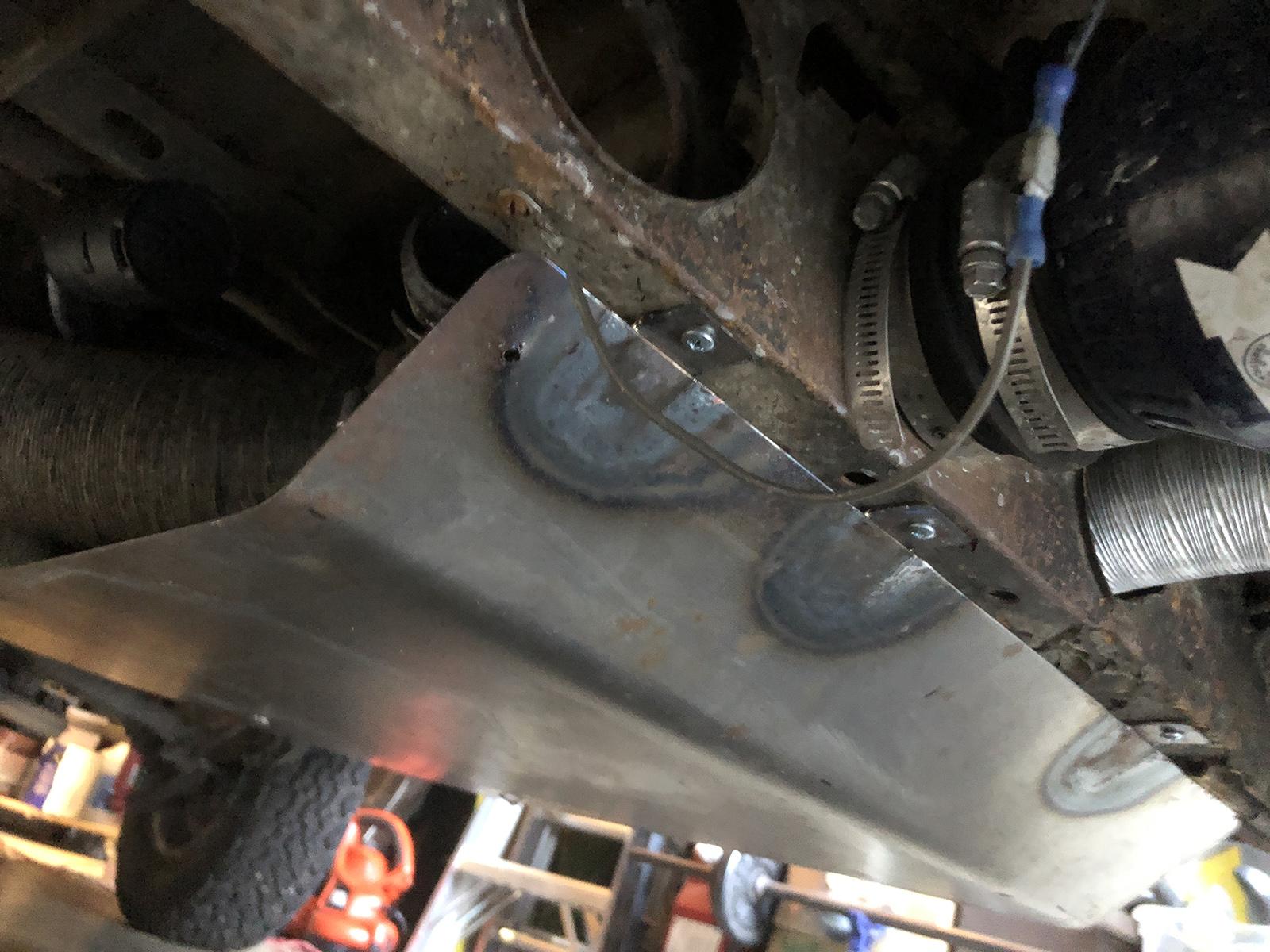

Yesterday I took the bus out for a few errands, test the heater etc. Great. All good. It got damn HOT in there. I had to open the front fresh-air vent.
It wasn't raining, but the roads were wet from an earlier rain. When I got back home, I peeked under there and saw some water spray on the heater unit, ducts, all around.
The instructions that come with the heater kit specify that it shouldn't be splashed with water, so I made a splash pan. I had intended to do this anyway, but the test drive made it more urgent.
I had a big sheet of steel laying around, so made it out of that. It was pretty darn easy, cut it, bend it, weld on some screw tabs. Great. I'll paint/undercoat it some other time.

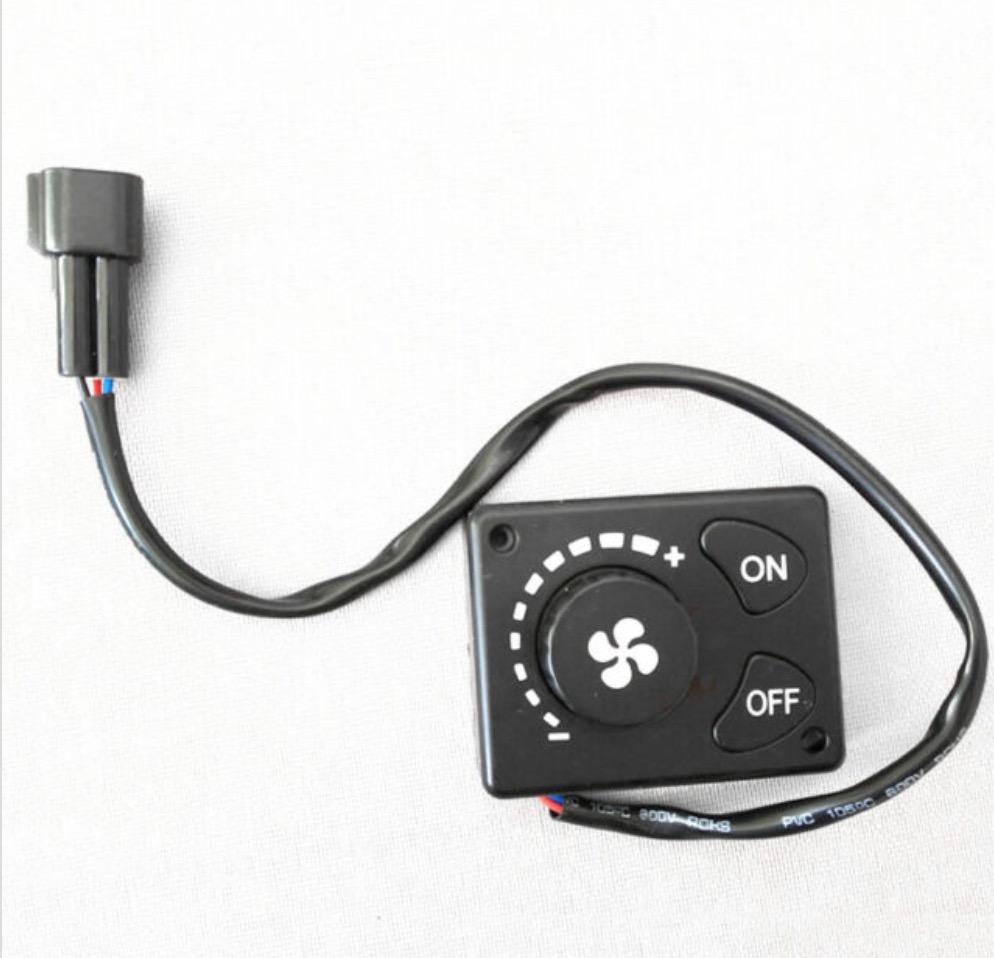

For the LCD controllers that stay on full time... Will simply unplugging the controller keep it from slowly draining the battery? I have a second battery, but I have not installed the aux battery relay yet. I'm plugging the second battery into a trickle charger at night.
'67 13 Window
'77 Westy
'69 Sunroof Beetle
'64 Chrysler Newport
'65 Honda Dream
Daverham
Joined: August 27, 2009
Posts: 1397
Location: USA
Daverham is offline
PostPosted: Fri Nov 22, 2019 4:39 pm    Post subject: Re: Installing a Cheap Chinese Diesel Parking Heater Reply with quote
Seems like that would do the trick. I also think it's a pretty minimal draw to power that tiny little console so you could probably just leave it on for a very long time without problems.
And there are also other controllers that you can get and interchange them, there's a knob-style one that would look good in an old bus.
I guess they have a sly little LED on the side that will blink error codes, etc. Pretty cool. I like the look a lot better than the big, light-up LCD console.
Check it out. Dirt cheap too:
I'm probably going to get one of those and I'm also going install a main/power shut-off toggle switch and just turn the whole thing off when I'm not using it.
