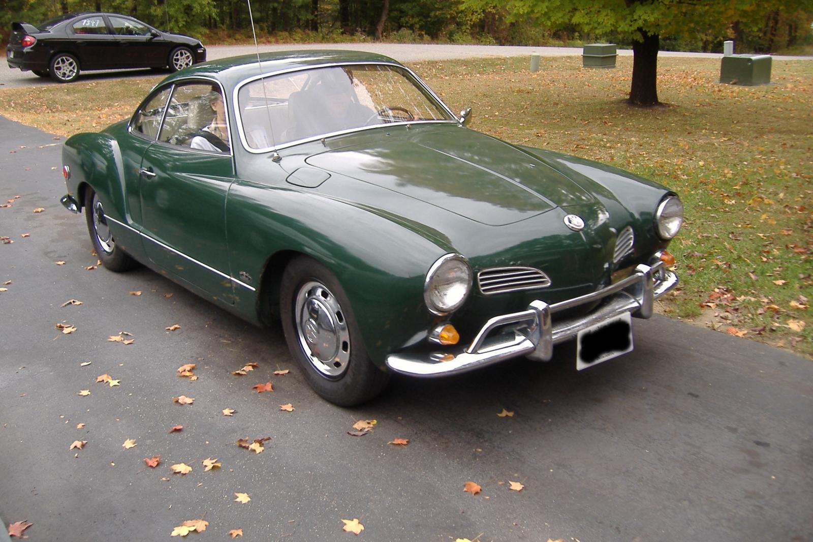

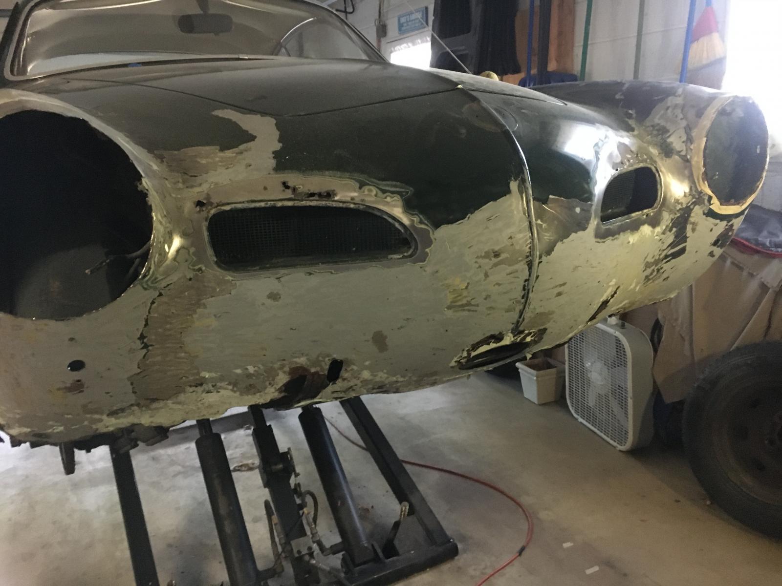

Started restoration on my wife’s 69 Karmann Ghia Auto Stick. We’ve had the car for around 10 years. The PO had it restored in 1995 but the guy who did the work didn’t do a very good restoration. Instead of cutting out and replacing any rusted panels the guy did half ass repairs by backing the rusted panel with flashing and then put fiberglass & bondo over the rust. In some spots the bondo was almost a ¼” thick.
When we first got the car, I restored the interior and did some engine work but since the car looked pretty good from 5 ft away, and I was in the middle of building my 32 Ford, I put off restoring the body until now.
Before start of restoration

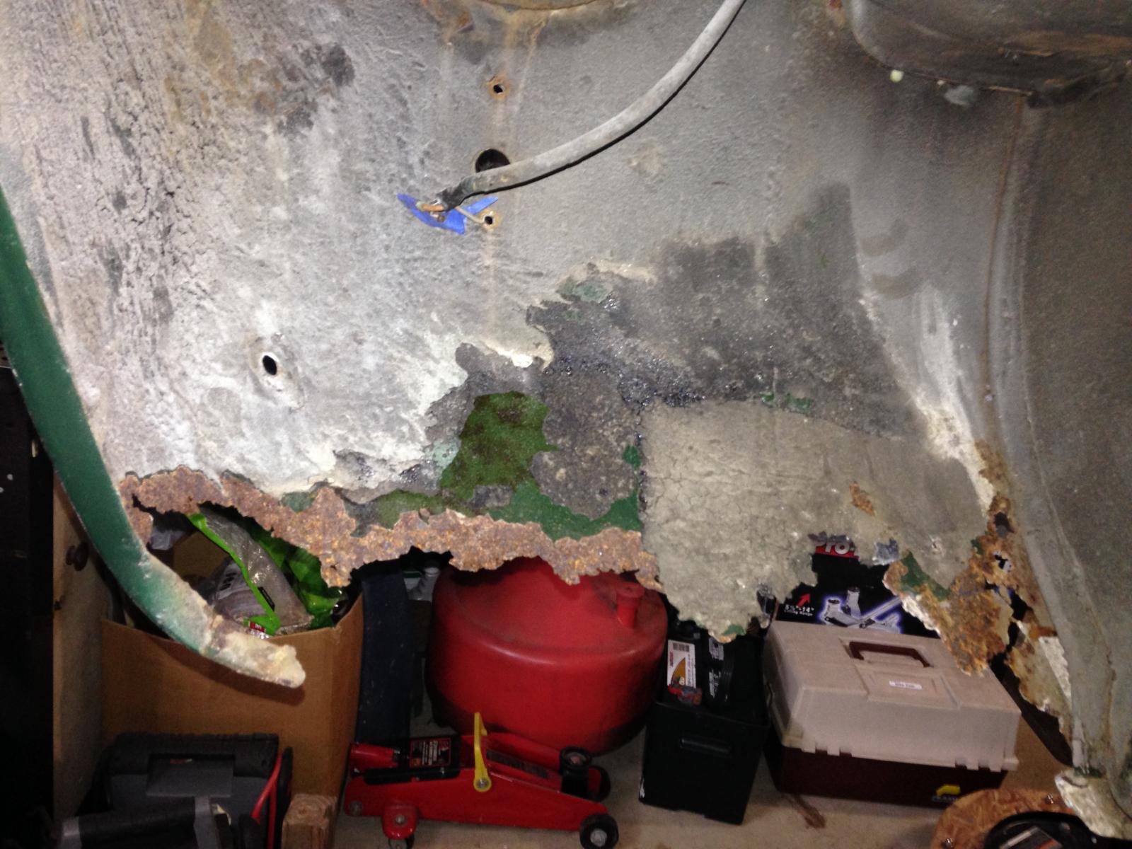

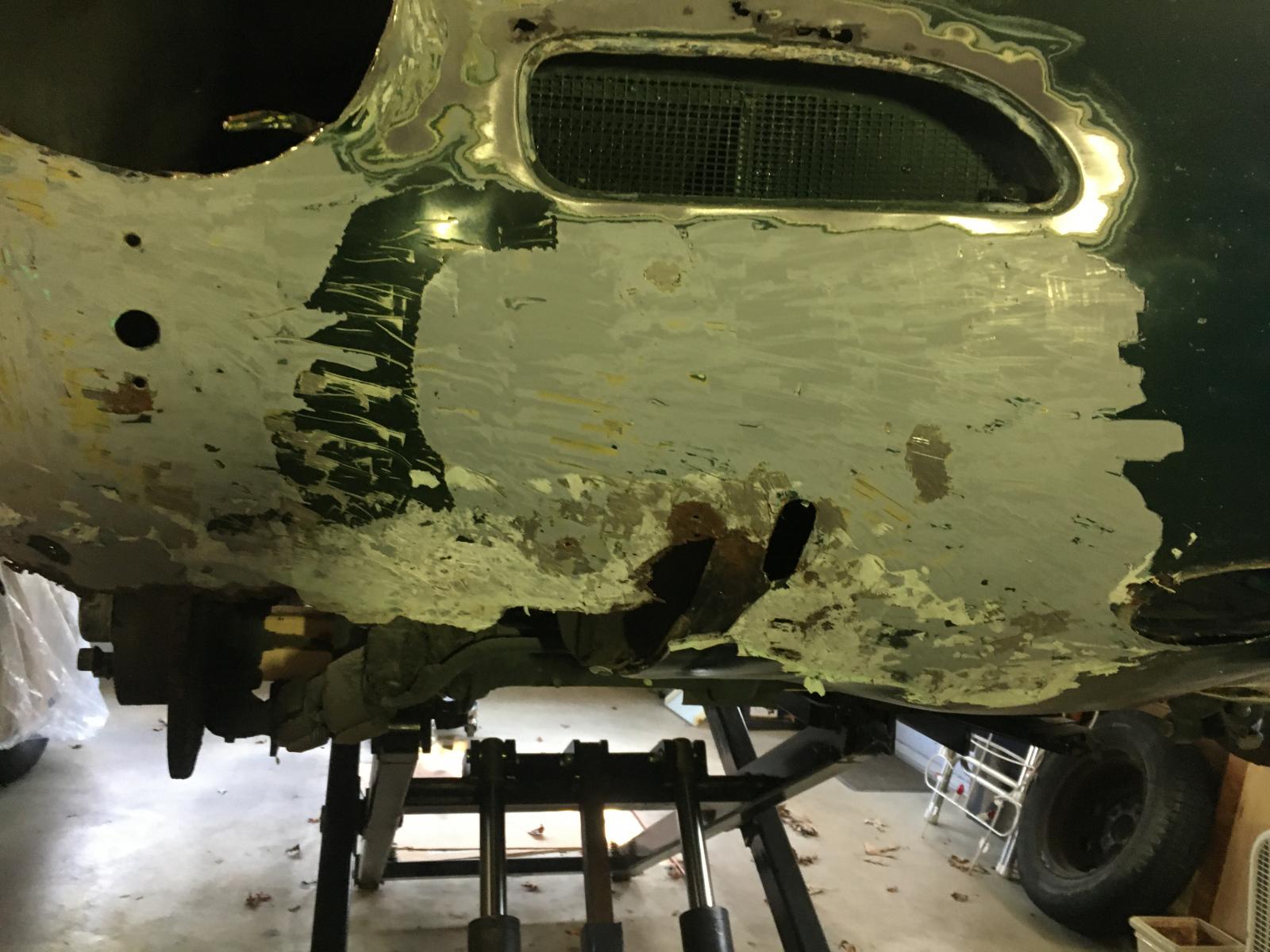

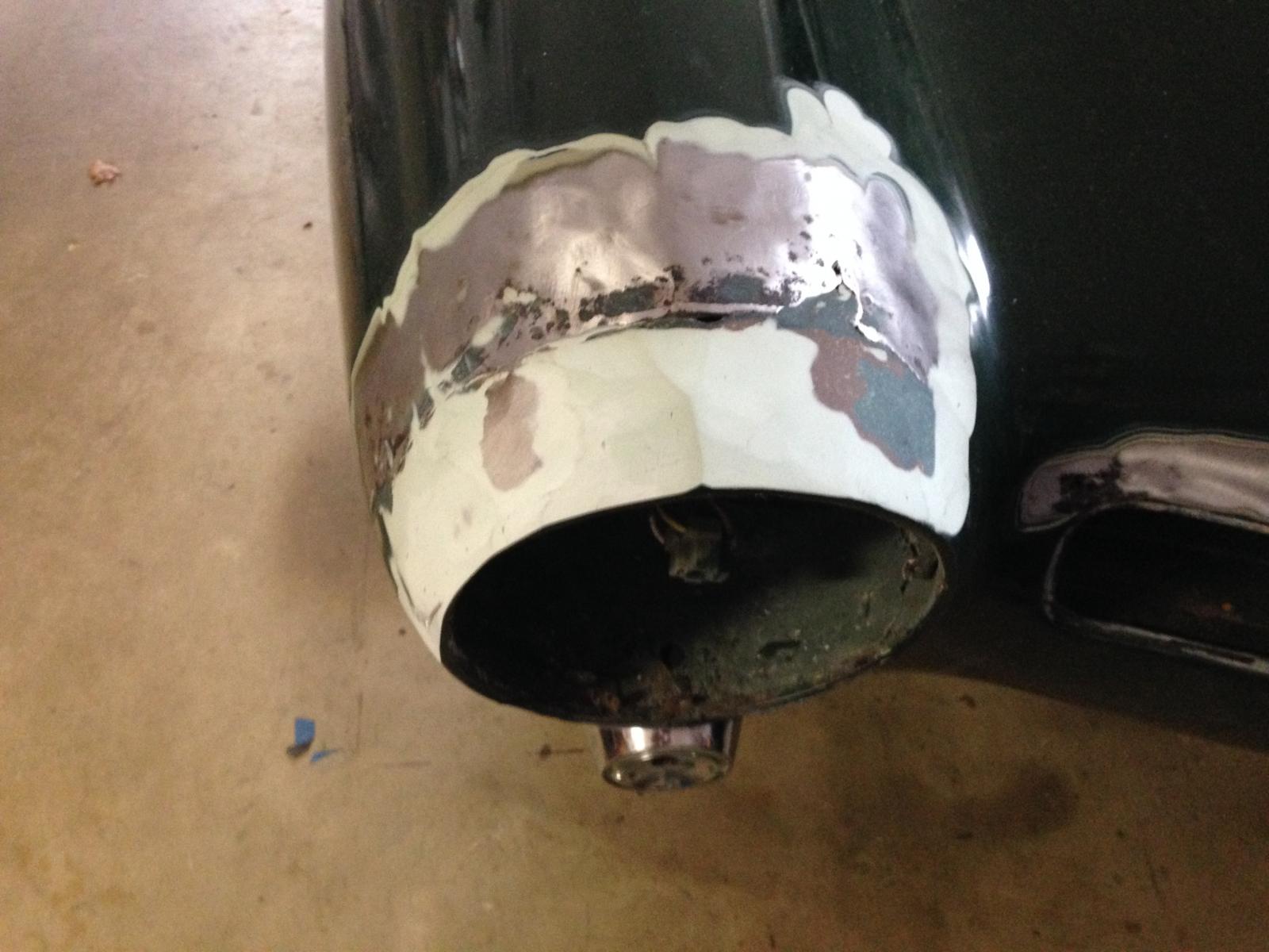

I just finished removing all the bondo and the top coat of paint. Car still needs to be sanded down to bare metal but since the sanding makes such a mess in the garage I removed the top coat of paint and in some cases got down to bare metal using a heat gun to soften the paint and then scraping it off with a wood chisel. Much better than trying to sand the bondo which just creates a white dust cloud in the garage.

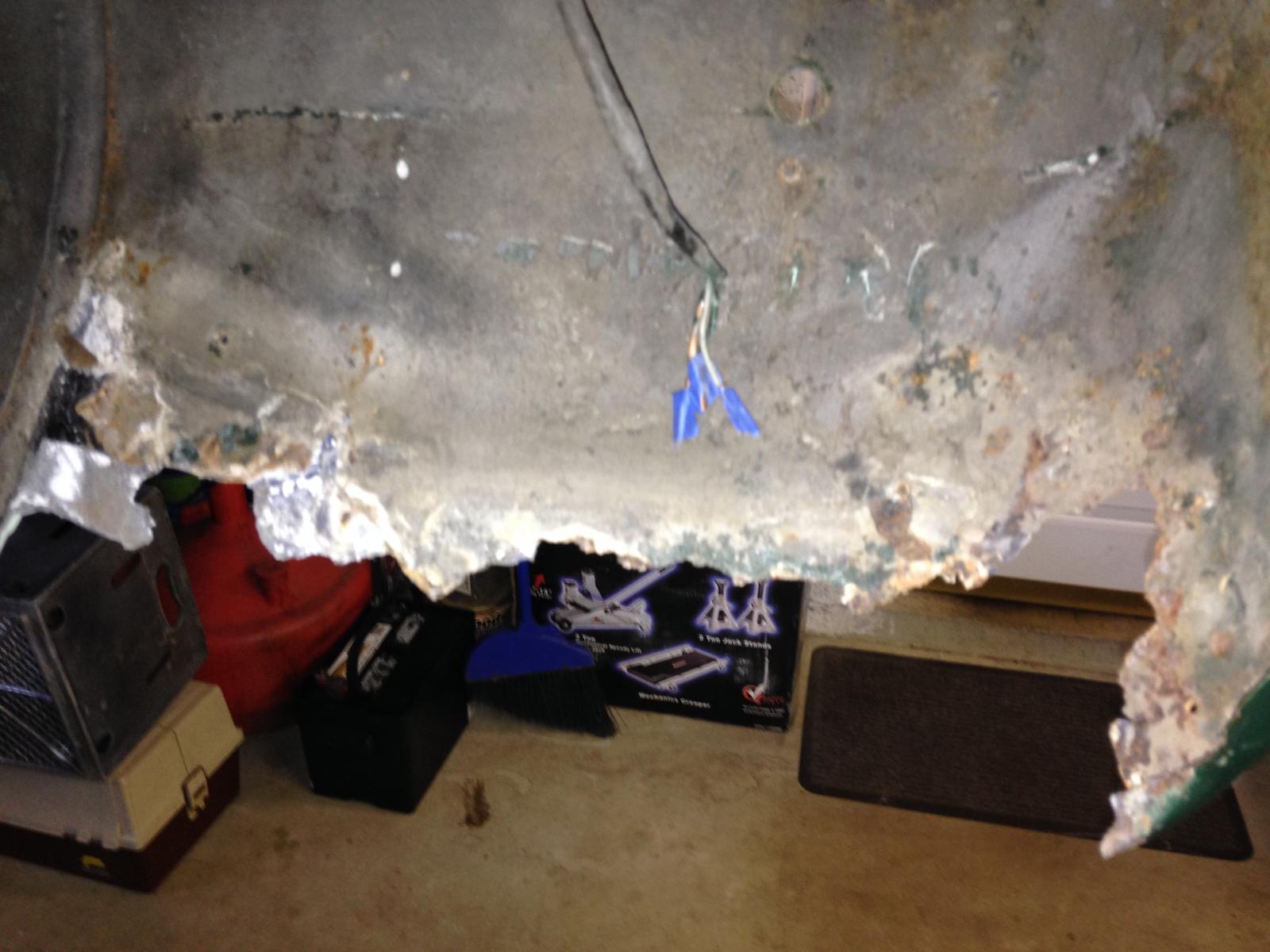

Nose section rust
Nose view from inside wheel wells
Poor headlight repairs

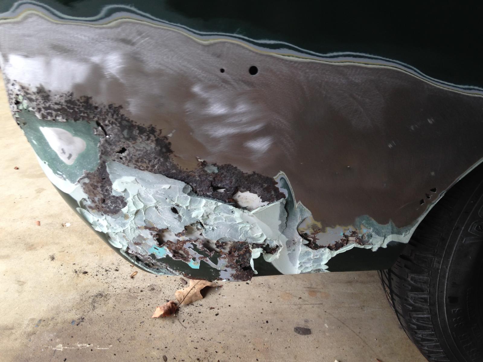

Rear fender rust

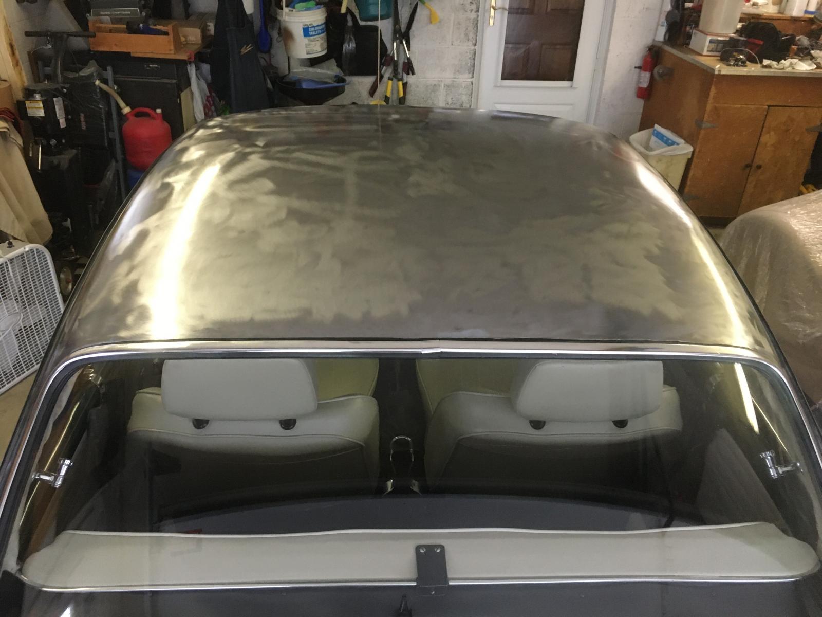

Top coat of paint removed
Next will be to remove the car from the lift, pull it outside, and finish taking it down to bare metal. After that, it will be time to start cutting out and replacing the rusted areas. Fortunately the pan is in good shape and shouldn’t require any major work so I plan to leave the body on the pan while doing the work.

It looks stately in the first "before" photo. Do you plan to remove the glass and otherwise block the openings from within to shield the interior when it's ready for paint?

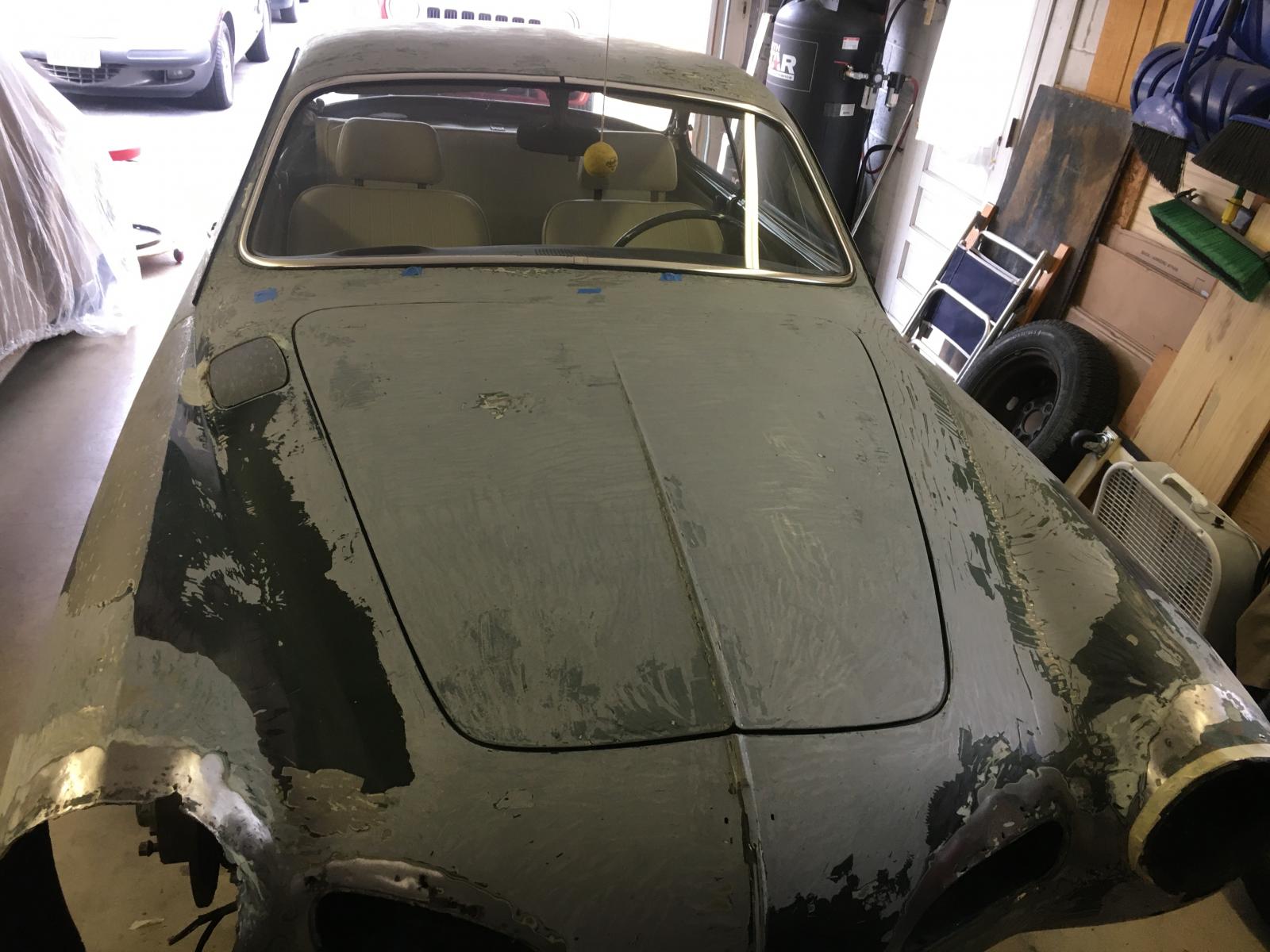

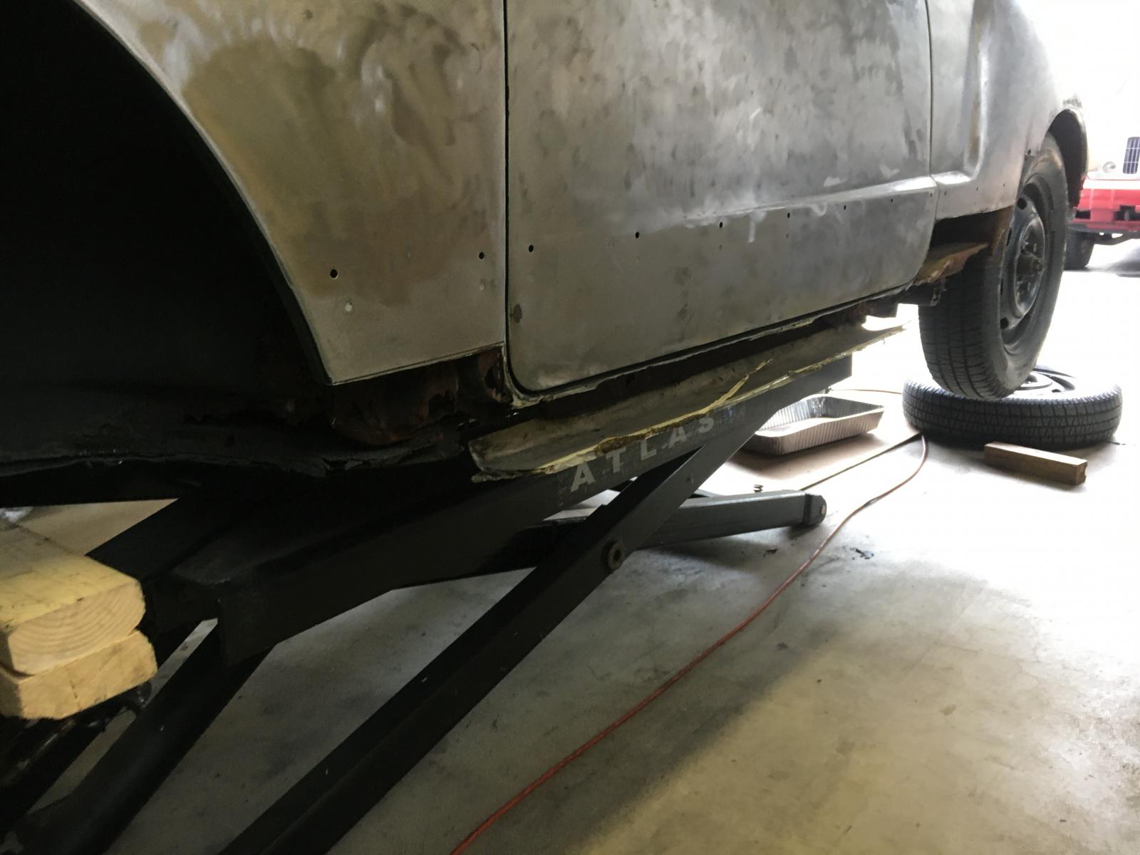

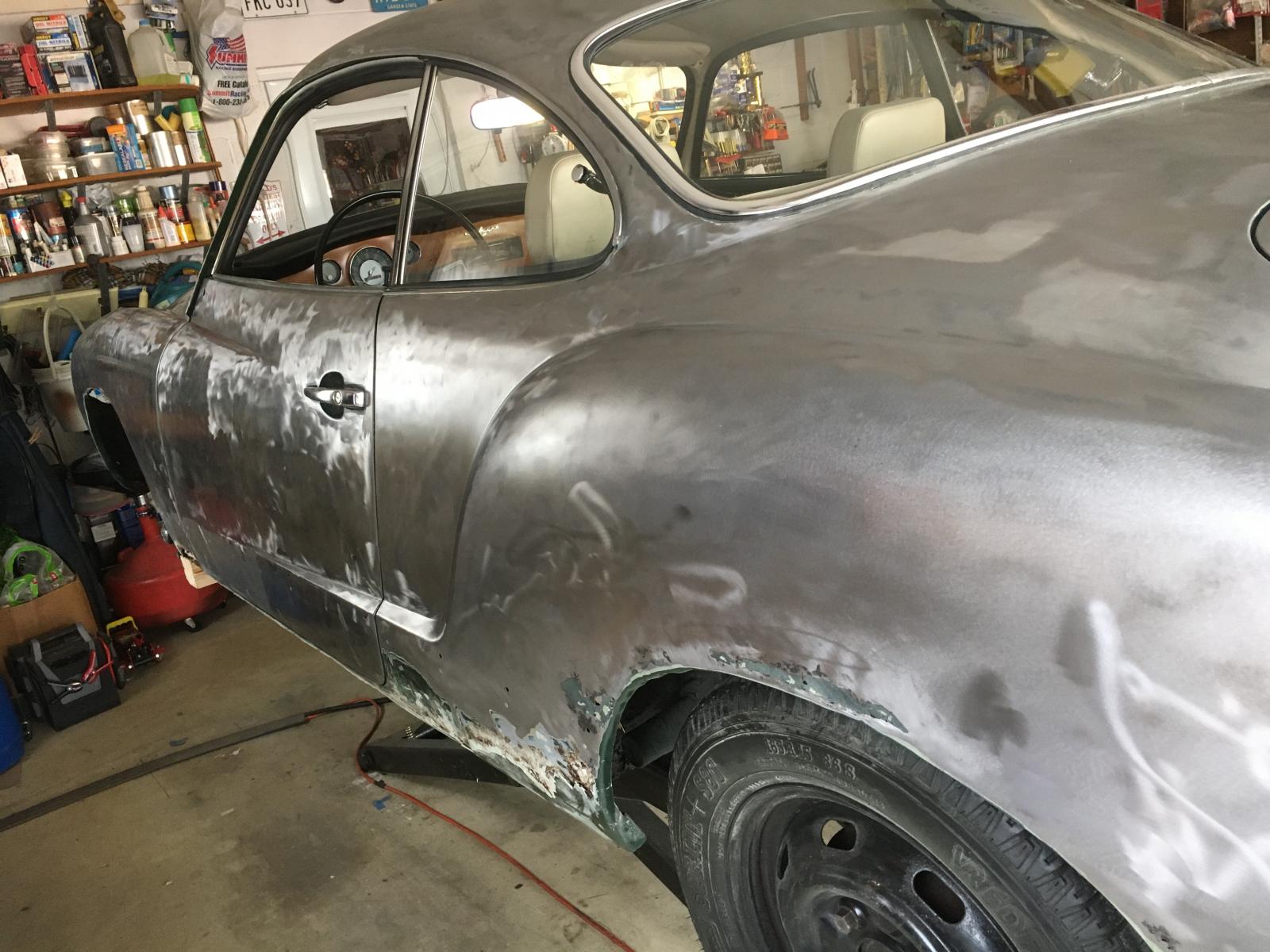

Finally finished taking the entire car down to bare metal. Used a combination of a DA sander, a 7” 3M stripping disc attached to my buffing machine, and a 4” stripping discs attached to my grinder. The positive aspect of the stripping disc is that it is much faster than the DA sander. The negative aspect of the stripping disc is I can’t hook up a vacuum like I can to the DA sander, so the stripping disc makes a cloud of dust. That is why whenever I was removing the paint from the car, I put it outside. Even would position a box fan blowing on my back to keep as much of the dust off me as possible. Its wintertime in MD so the fan just added to me feeling cold but being cold is better than having all the dust on me.
The car is back in the garage and on the lift. Now it is time to remove what I can from the interior (seats, door panels, carpet) and start cutting out all the rusted areas and weld in patch panels. Over the last couple of months, I’ve been accumulating repair panels for those sections I knew were bad. After getting the car down to bare metal I found some additional areas that need repair (not surprising). Most of the additional areas are relatively small and I should be able to fab up repair panels. I don’t consider myself as having metal working skills so it will be a learning process.
I should also mention that most of the patch panels I’ve accumulated were purchased from KGPR Airhead Parts. Jason at Airhead has been great to do business with and I certainly appreciate all his help and would recommend him to anyone needing parts.

PostPosted: Mon Feb 03, 2020 9:46 am    Post subject: Re: 1969 Karmann Ghia Auto Stick Restoration Reply with quote
Bro, you did a great job. What you have uncovered does not look as bad as many of us have seen or dealt with personally. Just look at all the work Antoine has had to do. You have a good base to start with, can't wait to see the progress.

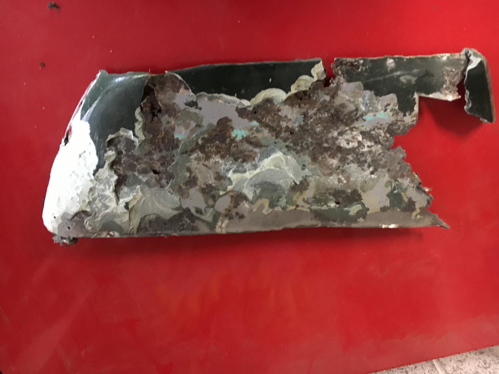

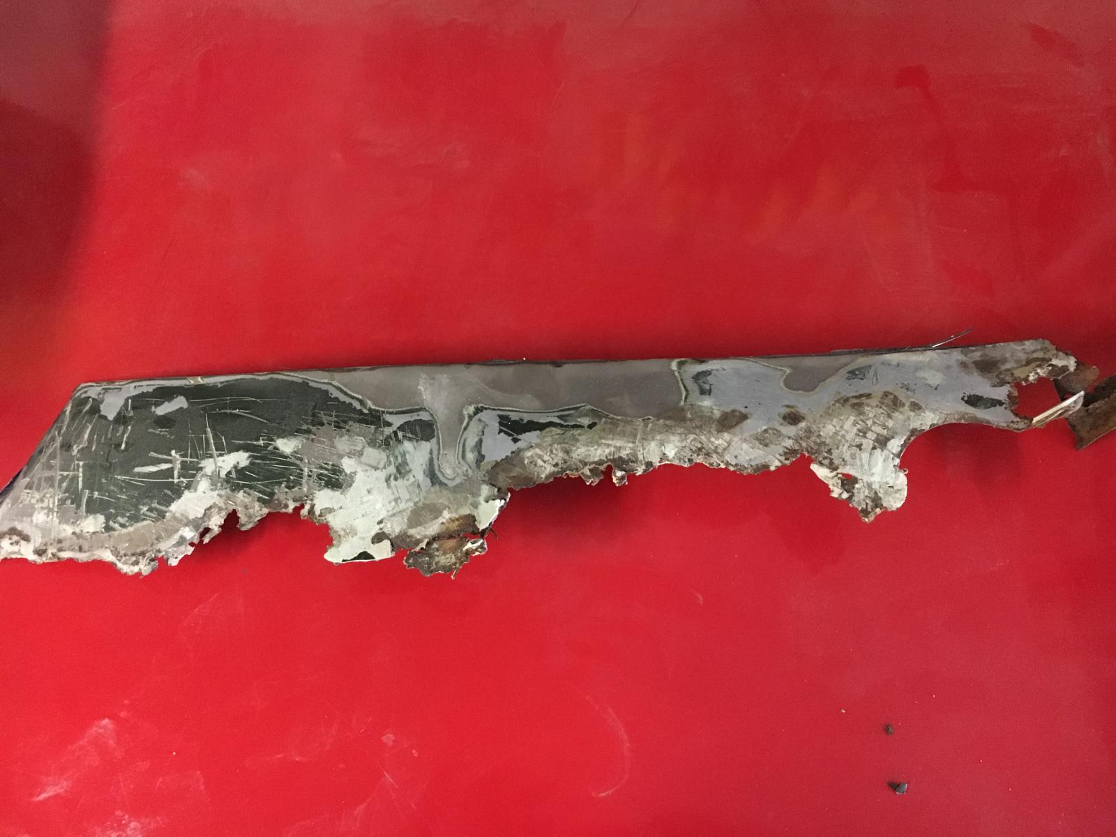

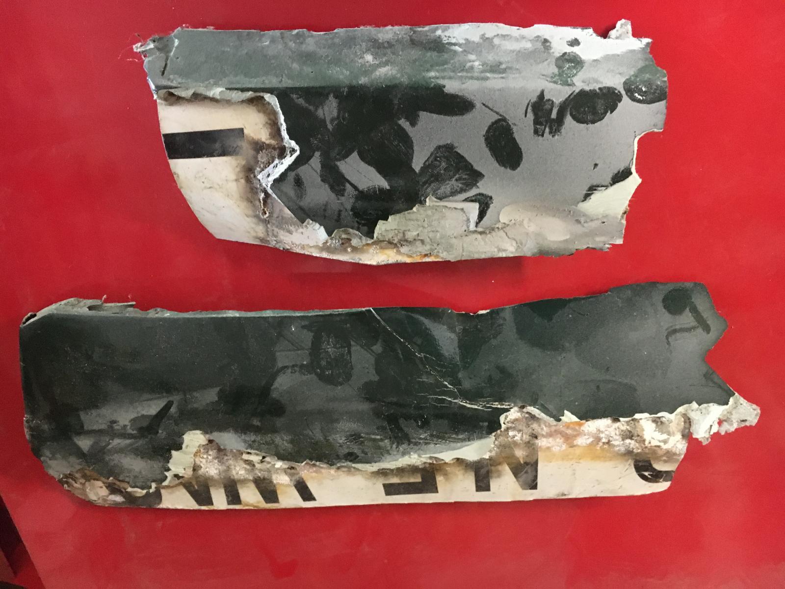

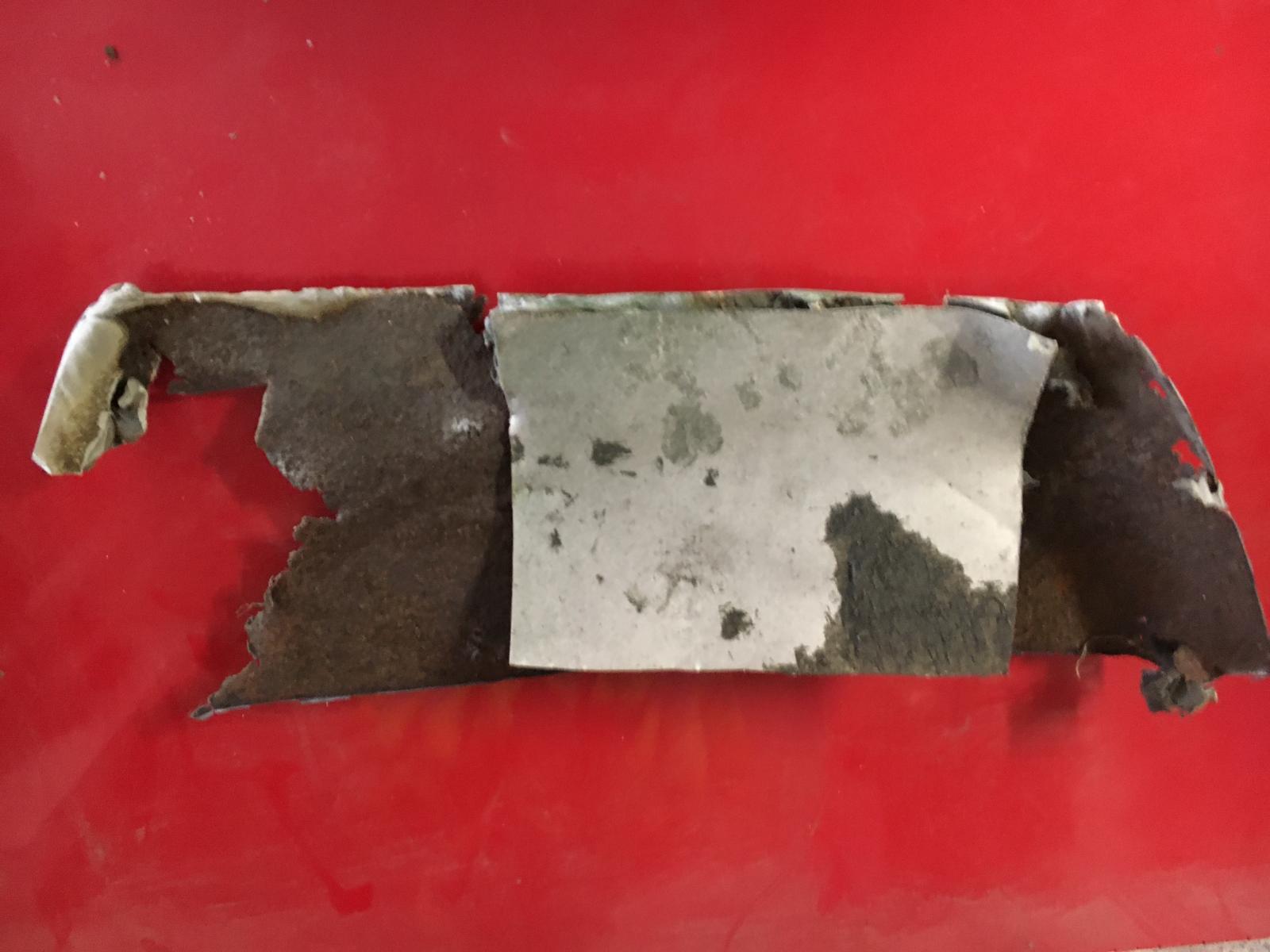

Started cutting out some of the rusted areas and previous restoration bad repairs. Here are some examples of what I found.
What was cut out
What was found
