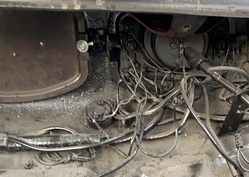

PostPosted: Tue Jun 30, 2020 5:19 pm    Post subject: Re: Earliest brown faced speedo? Reply with quote
… why do POs cut the wires of the harness, to the pods? I see lotza' Sinclair's cut also -The PO of my '50 cut mosta' the cloth-covered wires - I guess he thought that was easier and was gunna' replace the harness too - i'm not gunna replace, but will just splice in - just haffta' match the colors - since that car was mine, 40 years back, i know, it had a new harness, then - i'm sad he sorta' ruined a great harness...
… that car is in the Trust for our kid - he's not gunna' like my handiwork and will replace the harness again, i'll bet.
