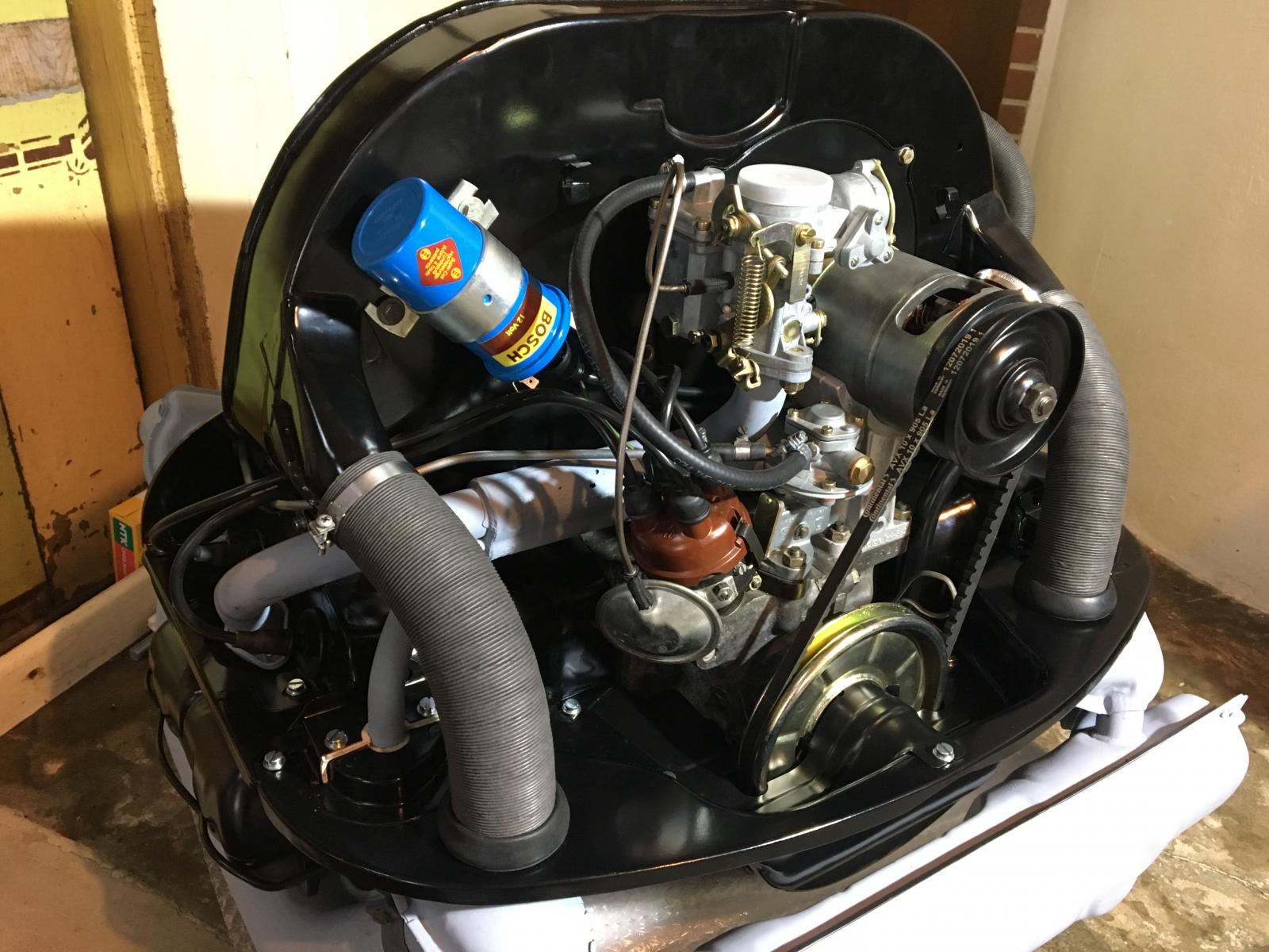

I would opt for the 1600sp.
In my opinion there is no better stock looking engine than this one plus you have the doghouse cooling shroud.
When it comes to more weight, you'll be happy with every extra hp. Especially when driving in mountain regions.
I built one myself from an industrial engine and I am pretty happy with it.
Looks pretty much stock (edit: on my 67):
I get something like 25 mpg currently. But I believe I can still improve a bit.

jacobcallaghan wrote:
CRANK: Forged Chromoly https://www.cbperformance.com/product-p/1105.htm?CartID=2
Might as well go up to a 74 or 76mm stroke for more torque.
Unless you are going with bigger carb/s, bigger muffler, and bigger valves, a performance cam is a waste of $$. Better to just go with stock or very close to it camshaft for most torque which is a must for the bus.
In Stereo, Where Available!

I had a 23 window Samba with a 40hp back in the mid-70s. MPG was about 25 but top speed was only 62 MPH and that was downhill. That same engine rebuilt and installed in a '65 Beetle netted me 34 MPG. That's quite a difference. I had a 1600 SP in a '79 Beetle and only got high 20s MPG. I do think the 40hp was a good motor.

Did some adjustments on carb and timing. Now I get 29 mpg with my 1600sp in my 67 deluxe. That‘s not too bad in my opinion…
What trans were you running in your 23 window? I’m running a 40hp in my ‘60 Kombi with a small nut, and not sure if I could get to 62 mph without something coming apart. Still getting used to driving it though (my first bus) so maybe it’s got more to give than I’m asking of it. Just been driving around town so far, and have only got up to the mid 40’s mph. Need to get used to engine sound vs. speed.
The trans was whatever came stock with the 1500 motor for 1963 which was the first year for the 1500 in the bus. I haven't had that 23 window for over 45 years.
