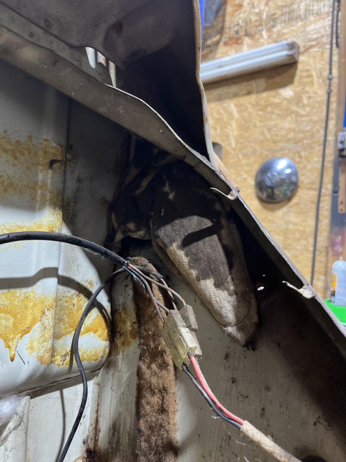

When you are stripping down the car, take extra, extra care to remove the engine compartment insulation panels. The one you see here- the factory original "knobby" type- is rare to find without tears. Repro panels are nowhere close to this design. I hope the right side panel, and the large one on the firewall are still usable. Once you have them off, you can gently clean them with a mist of SimpleGreen, let it run off, gentle mist of water, lay them down and let dry. I would first not scrub them; let the SG do its work.
Thanks for sharing that tid-bit on the engine panels. My 63 has this too and I’ve never noticed this on any other bugs I’ve owned so I sensed it was rare. Mine looks okay for the age. No tears. Dirty though and it looks stiff. I plan on painting the engine compartment so I hope it comes out intact.

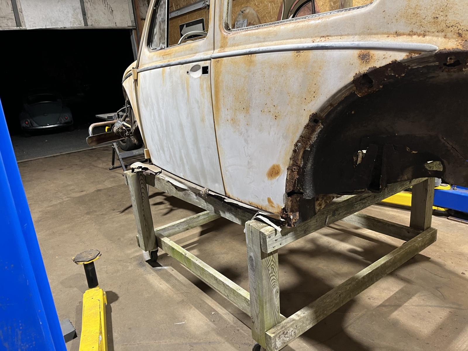

Got out today and got the car on a body dolly and removed those tar boards for safe keeping. No damage except for the drivers side triangle was stuck really well and a bit of it is stuck to the car still but you won’t be able to tell. Still has the pillows in the quarters.
