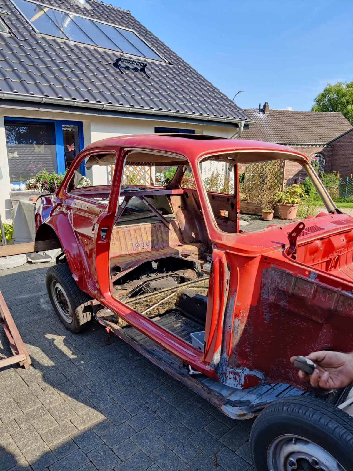

I have been plugging away on this car and I am slowly getting the body ready.
I have replaced both rockers. I was lucky to get my hands on a good used one for the left side. And I was able to make a mirror copy of that for the right side.
I still have two areas which are causing me a headache. The PO. replaced the rear corners including the bumper brackets. Unfortunately he did not manage to get it right, actually its way off. The parts were welded in about 1" to far forward and tilted the wrong way. But see for your self:
Unfortunately I have nothing to go by to get it right. I would be really happy if someone could help out with some good picture of this area on an original early notchback.
