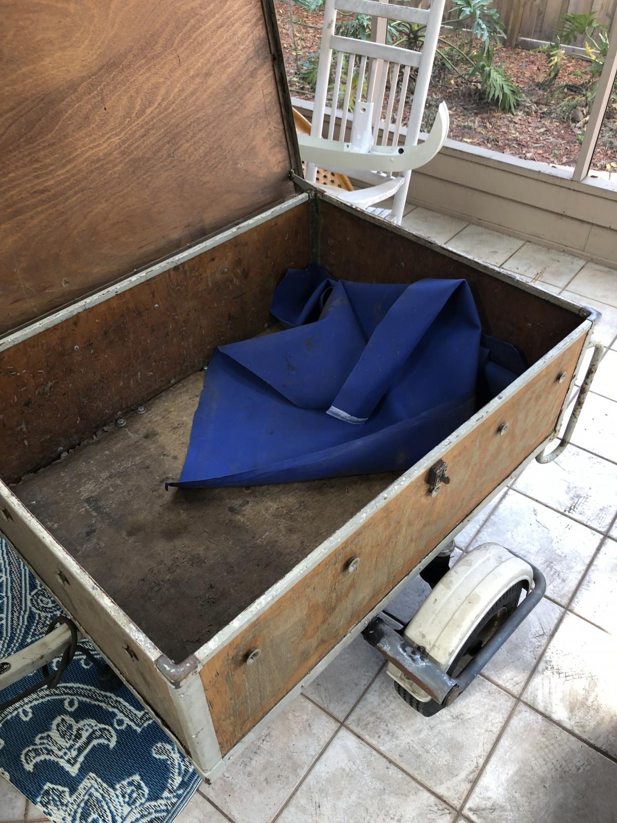

I'm in the final stages of restoring my old '74 Westy. As that is beginning to wind down, I have found a little bit of time to refurbish my '74 Essen trailer.
The story starts in England. Originally, I found a trailer that was in very good shape, on the internet. I purchased it and asked a family member if it would be alright to store it in their garage for a while, until I could figure out how to get it across the pond. Here it is being delivered:
As you can see, it was a beautiful trailer. However, I ran across another one, that happened to be year correct, shortly after I had purchased this one. I thought it would be nice to have a '74 trailer to pull behind the '74 westy. After some negotiations, I made a deal and purchased the second trailer. I had both of them shipped to my house. This is what it looked like, when they arrived:
A little tough to see, but they arrived, stacked one atop the other. Now, like most of us on this site, I was excited to get my hands on a new [to me] VW related toy. I couldn't wait to see what they looked like, so I set out to put them together:
A couple of years have passed since I received them. I sold the '78 and kept the '74. I knew it would need a ton of work, but figured it would be another fun project to tackle. Fast forward to the present time and now that I've started to get a handle on the bus, I figured it was time to start attacking the trailer. I've since started disassembling it and getting all the pieces and parts ready for powder coating:

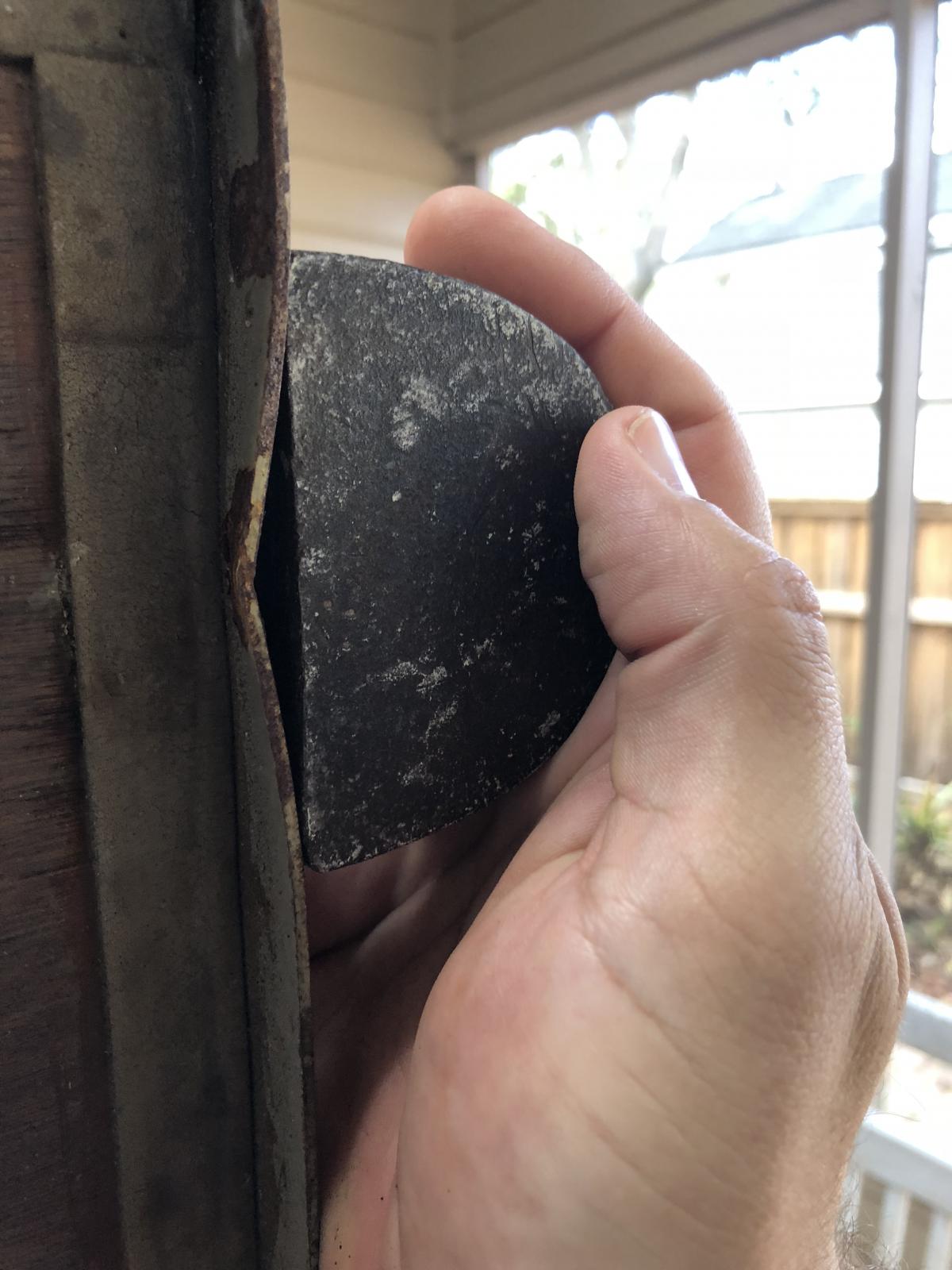

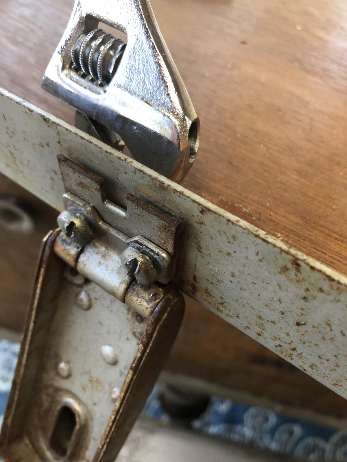

When the lid came off, it was time to take care of this little ding:

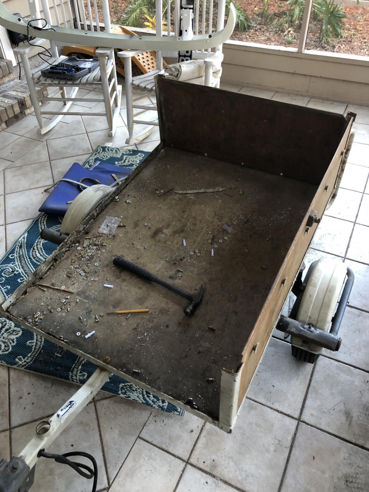

With that done, its time to start tearing it down:

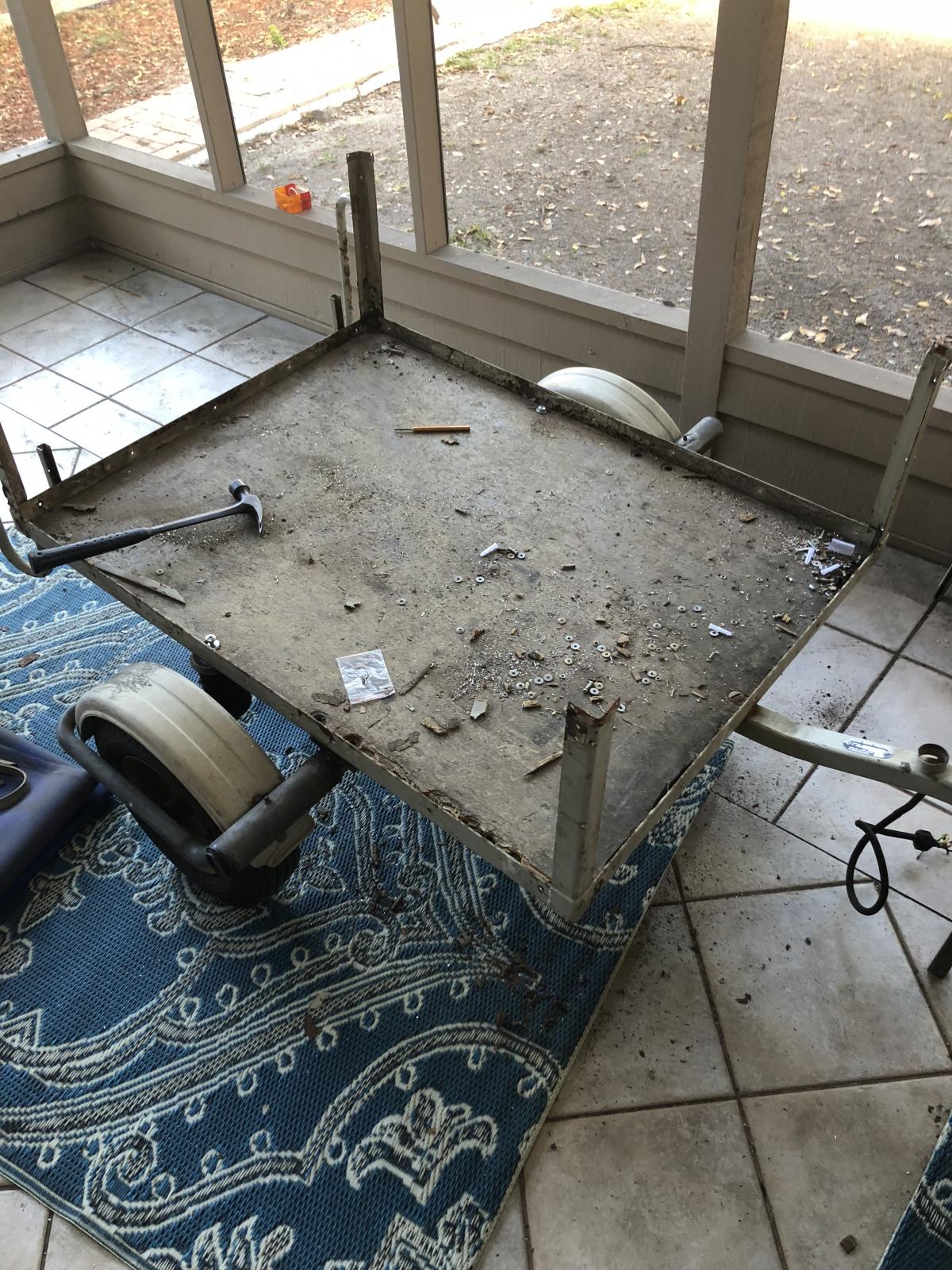

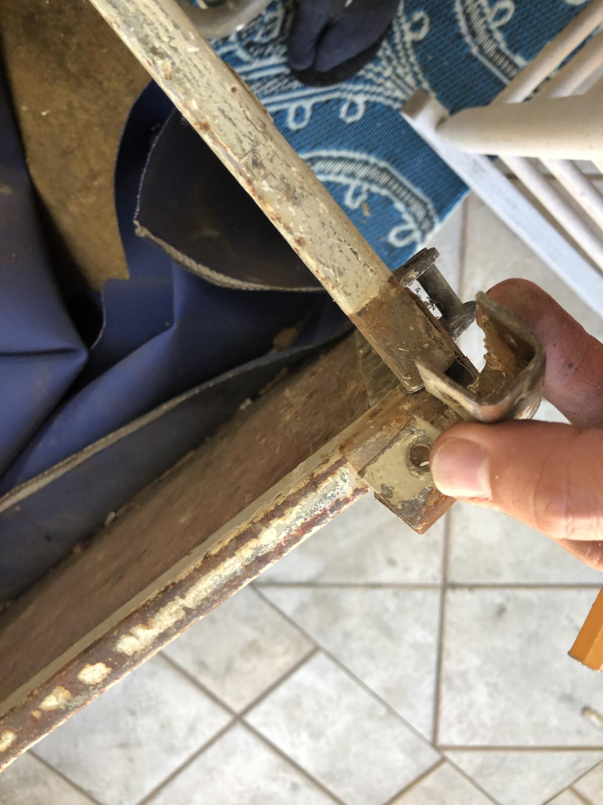

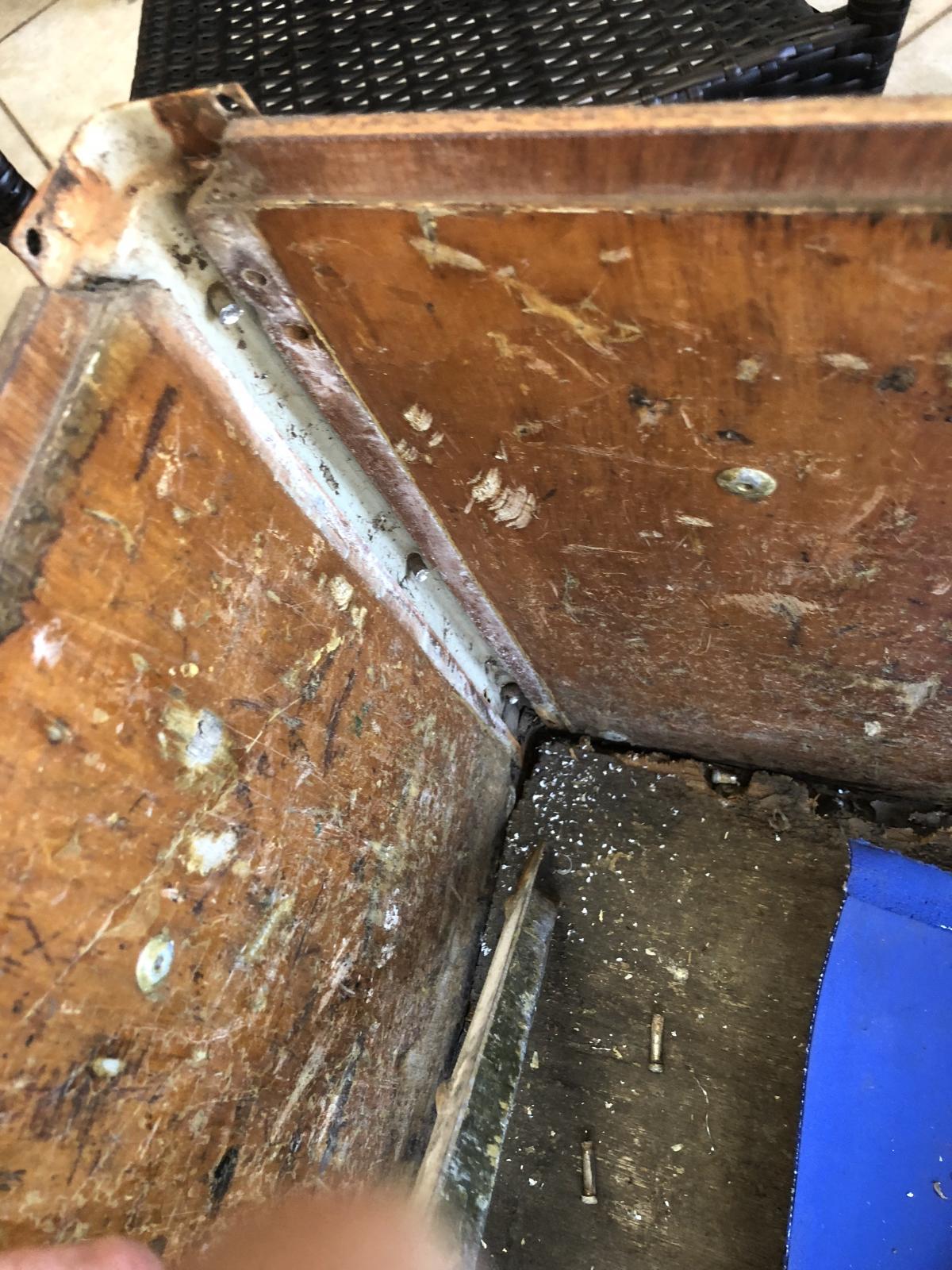

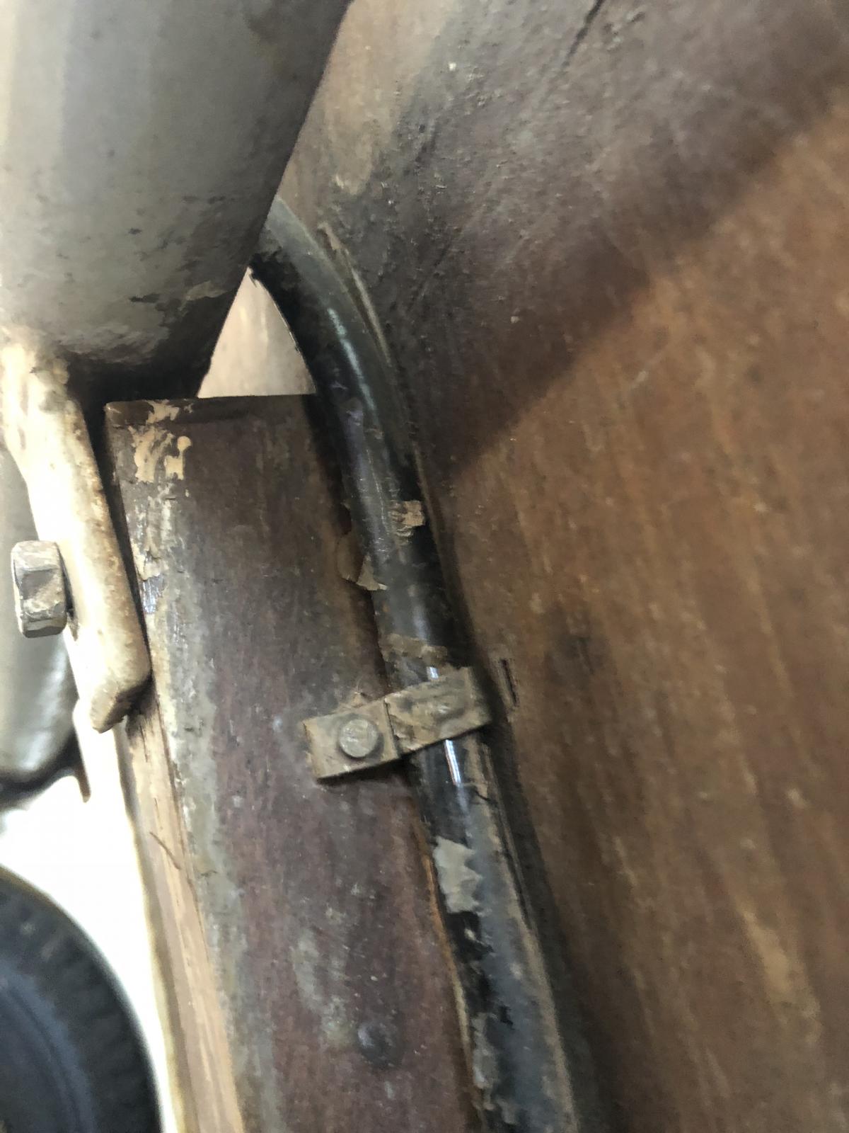

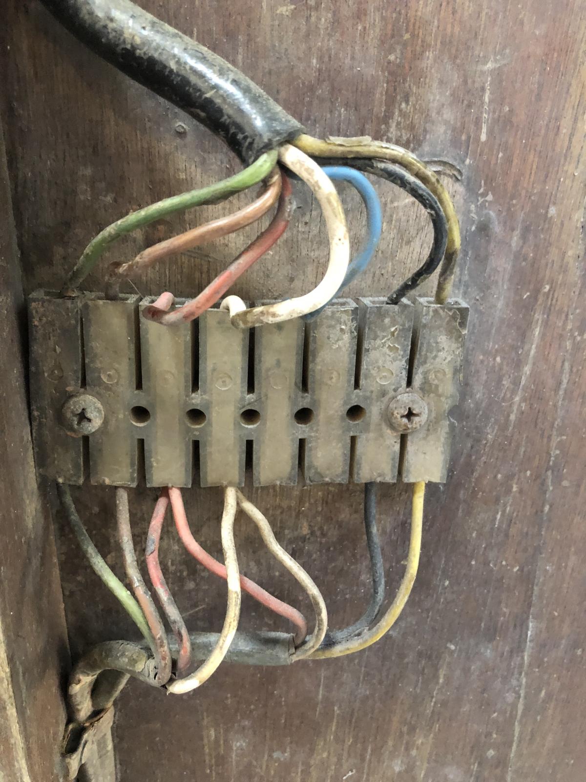

Some shots of the undercarriage, so I know how things go back together. Very Happy
Now we can start taking the sides off:
Time to disassemble the frame and axle:

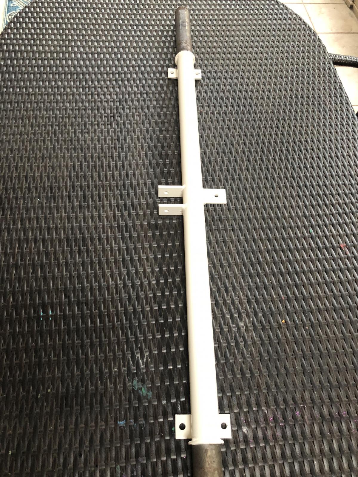

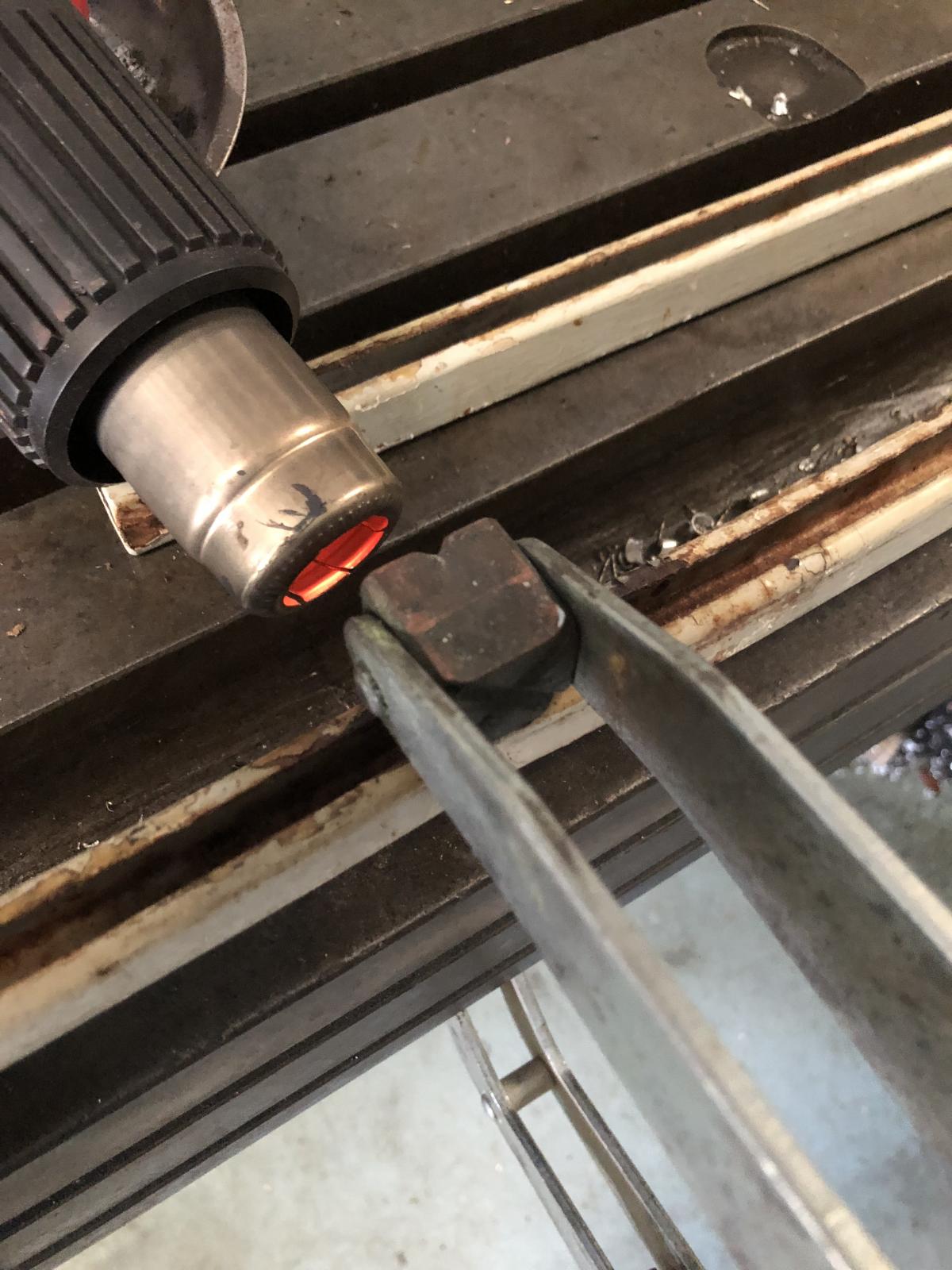

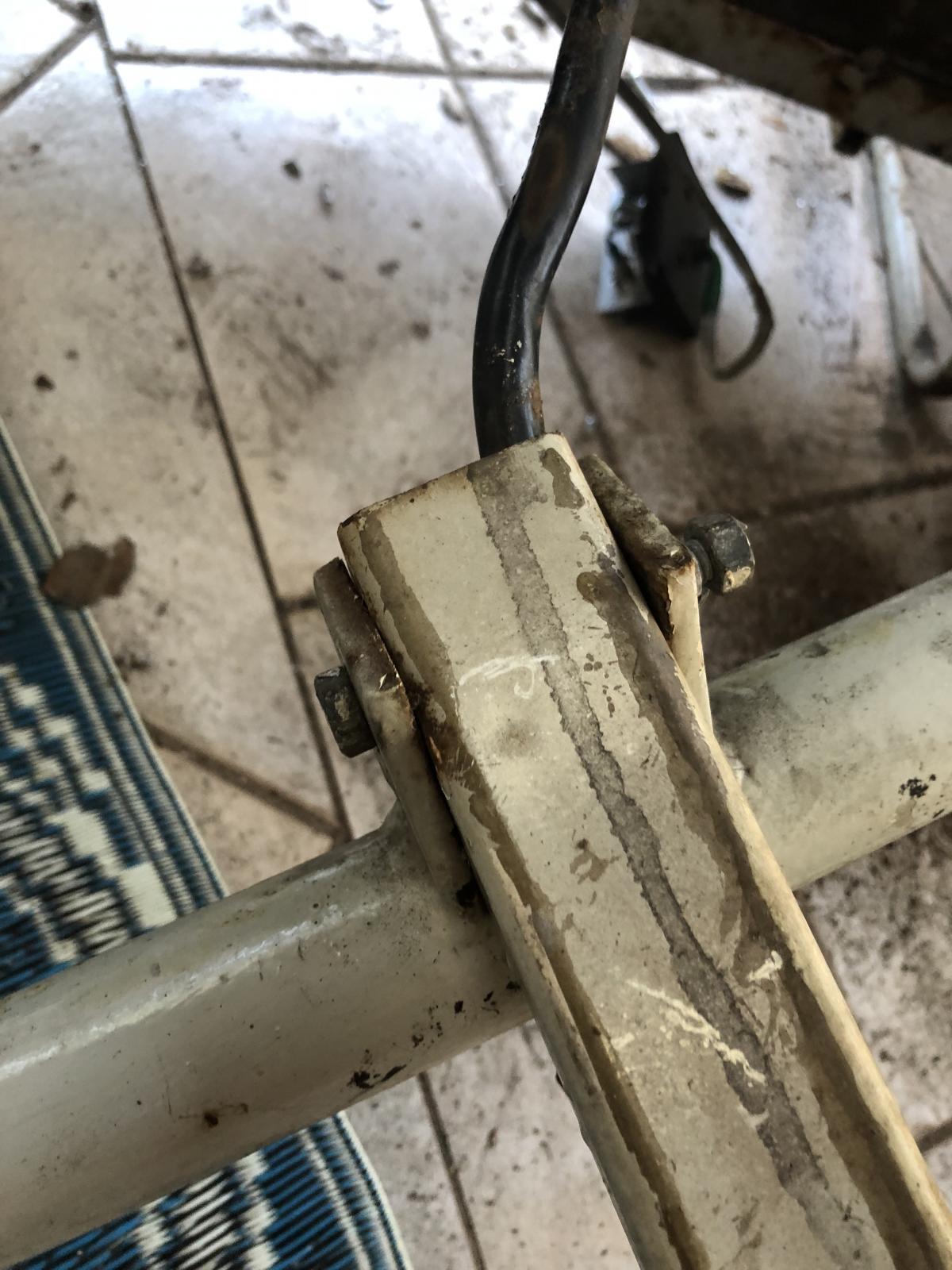

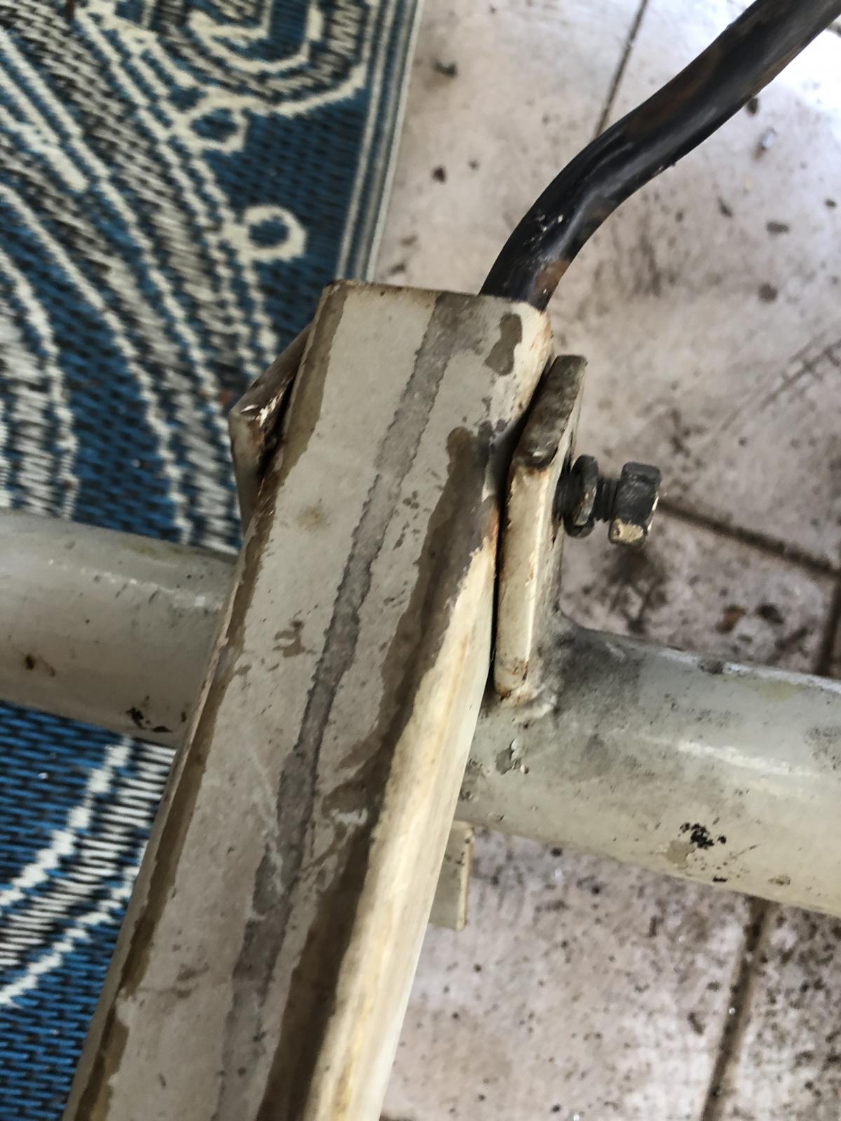

The top rail that was at the front of the trailer had taken a beating at some point and needed to be straightened out a bit. Applied some heat and reshaped the metal, so that the rail wouldn't be as wonky:

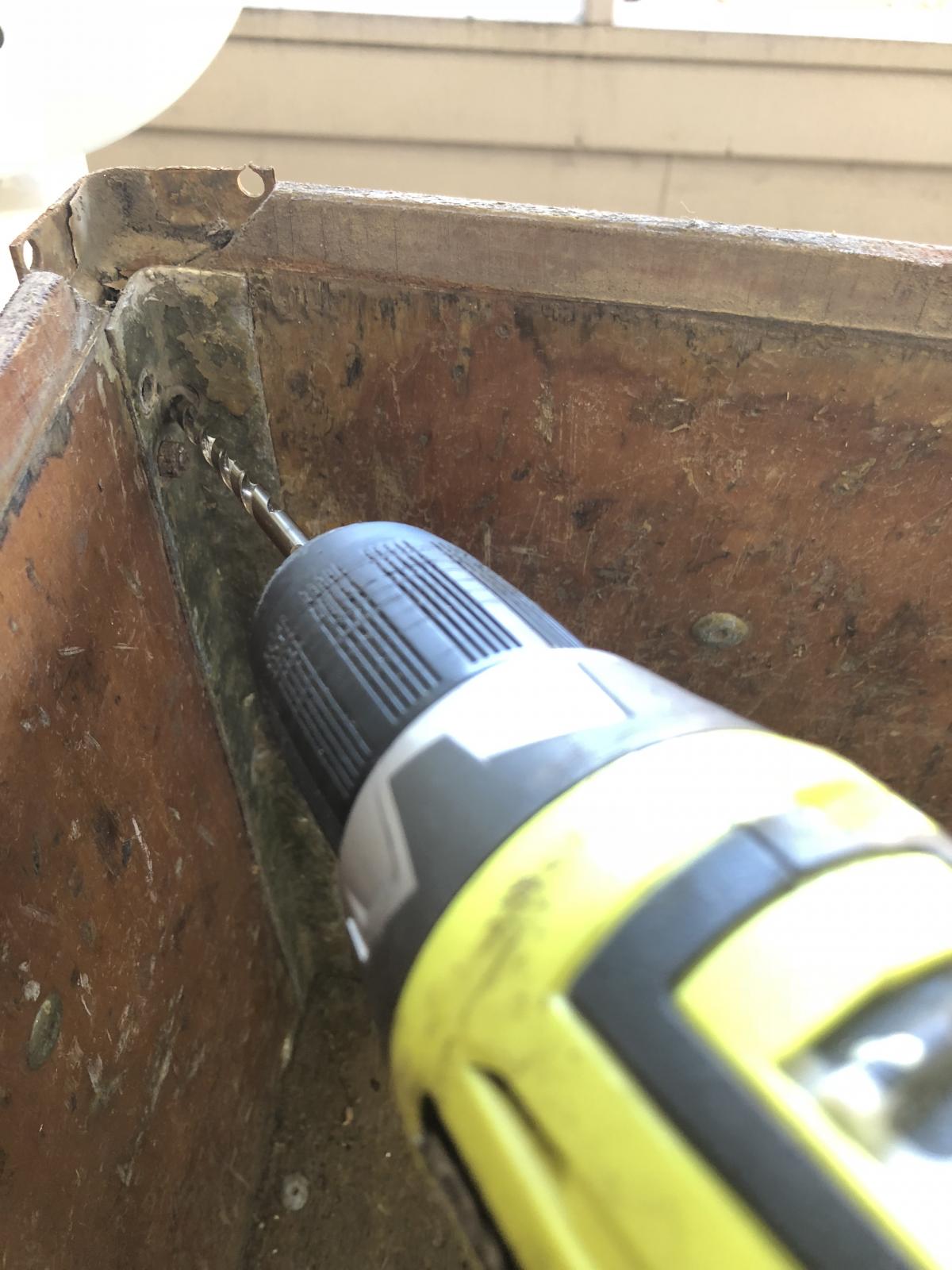

Also, the lid had a couple of holes that needed to be filled:

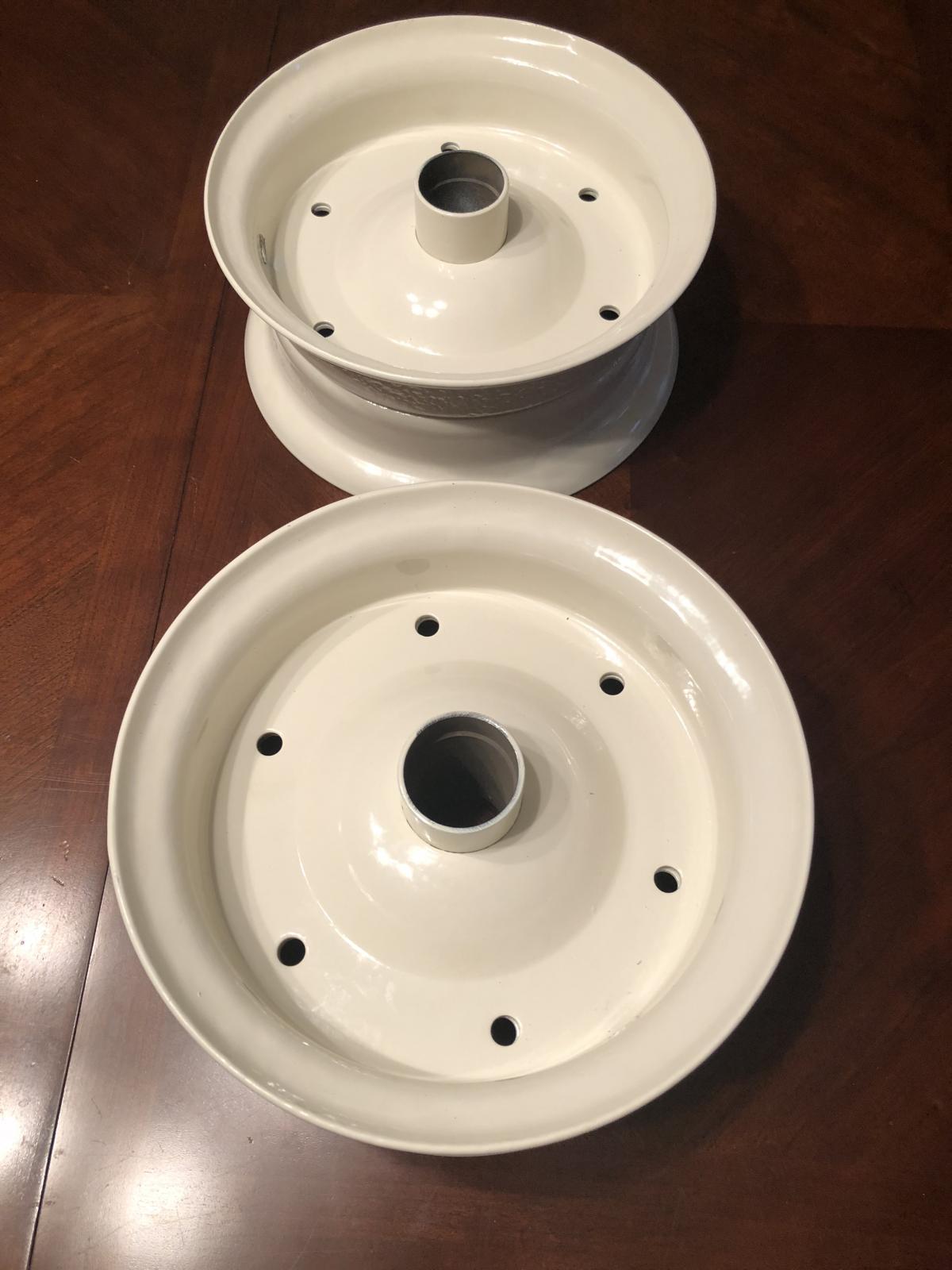

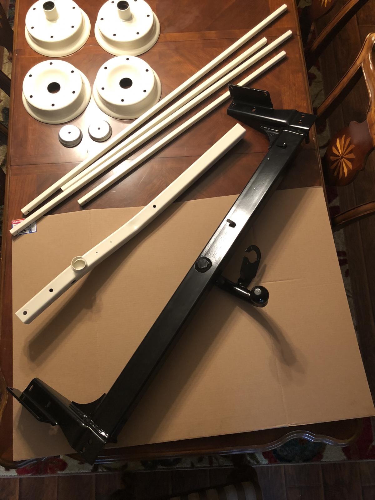

Fresh from the powder coater:
Rims:
Spare tire carrier:
Caps that go over the shock absorbers:
Axle:
As always, everything came back looking absolutely killer! Richard and his crew over at http://www.powdertechplus.com never disappoint! I can't wait to start putting it back together. I have a few things left to do before I get to reassembly.

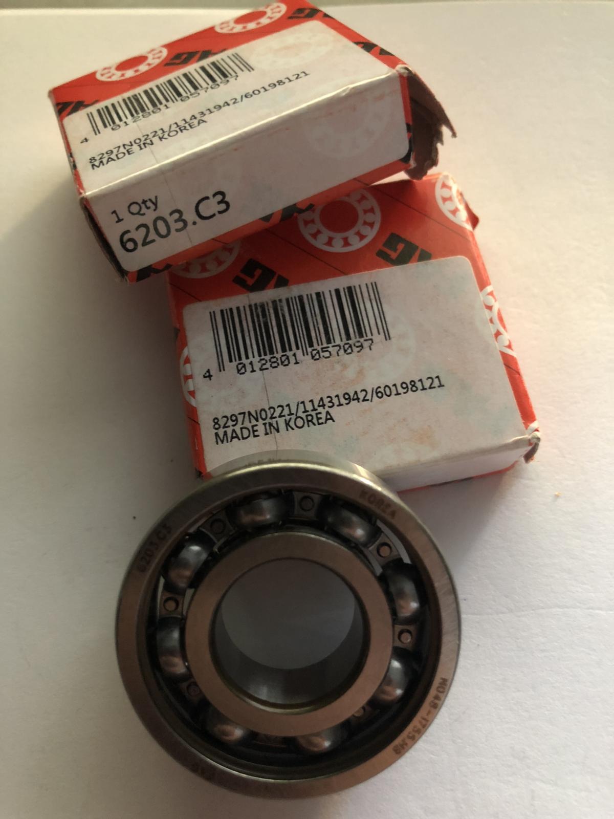

what wheel bearings are you using? (actually, what size are the Essen bearings?)
I have a 1966 ERKA and the bearings are hard to find. i am using ball bearings and i need to repack them every few 1000kms. i'd like to find roller bearings.
white74westy
Joined: May 02, 2011
Posts: 777
white74westy is offline
PostPosted: Fri Sep 07, 2018 4:54 am    Post subject: Re: 1974 Westfalia Essen Trailer Reply with quote
crofty wrote:
Nice!
Thank you! I'm slowly getting to a place, whereby I can begin to put some time and effort into the trailer - still a few other things that must be attended to first. I'm really excited to see her put back together!
white74westy
Posts: 777
PostPosted: Fri Sep 07, 2018 5:05 am    Post subject: Re: 1974 Westfalia Essen Trailer Reply with quote
Hey mango-smoothie! It has been a long time since I did the research, so the details are quite foggy. However, I bought FAG bearings:
I had good results with their products, when I changed the rear wheel bearings in the bus. I decided to give them a chance for the trailer too. If memory serves, they met all the criteria as far as RPM and load. I still have the originals, stuffed away somewhere. They are still covered in grease, so I haven't even had a chance to look them over. I figured if they managed to last a little better than 40+ years, why change the system? Of course, I would love to hear about anything different that you might come up with.
Just in case you wanted some more information:
https://www.amazon.com/FAG-6203-C3-Clearance-22000...ds=6203.c3
I hope that is of some use!
