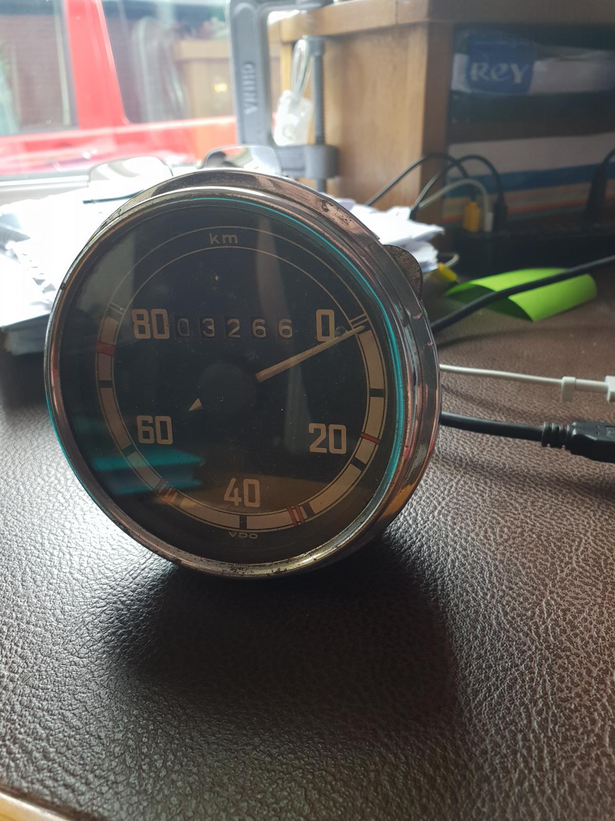

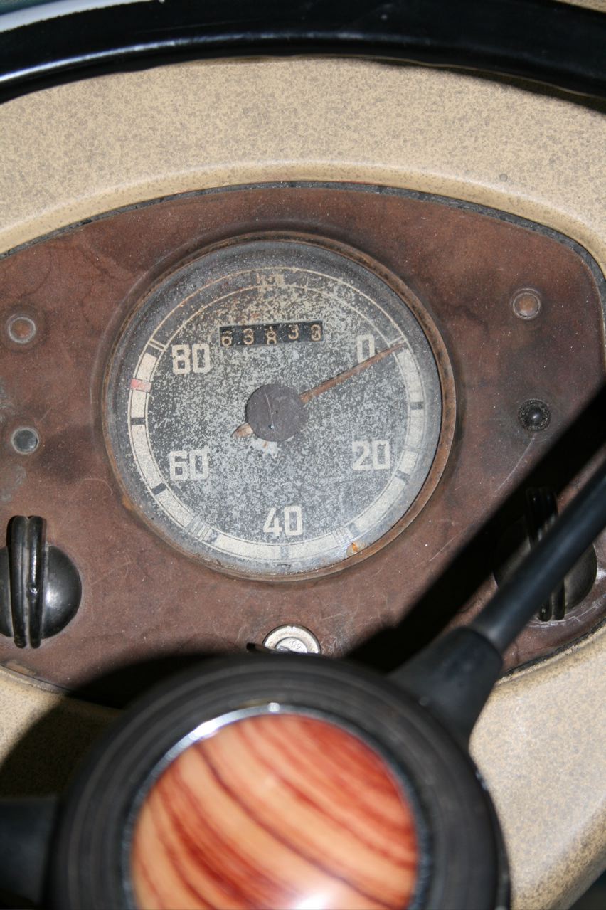

Having discussions with a hardcore early VW enthusiast/friend about early brown faced speedos. He has a May '49 split he is restoring (Well, that convertible 2 seater kind of split) and is looking for date coded correct parts for it. We recently found an April '49 brown faced speedo mounted in a Feb '49 brown pod. Seems a very rare part. I have a Sept '49 speedo with a "full circle" brown face also.
So when was the first brown faced speedo used? I we have seen many grey/blue faced ones in standards '49 and even '50, but it is observed that VW always used the nicest/newest parts in the deluxes, 'verts, etc, and kept using the older version in the std until they were used up, or for spare parts.
Anyone have data/images, etc on when the first brown face speedo came out. This April one clearly pre dates the first ivory bakelite pod...

First production Heb aside, then why would we have a brown faced speedo, with a VW part number dated April 1949?? What was that used in? Not a Heb, and not a deluxe split????

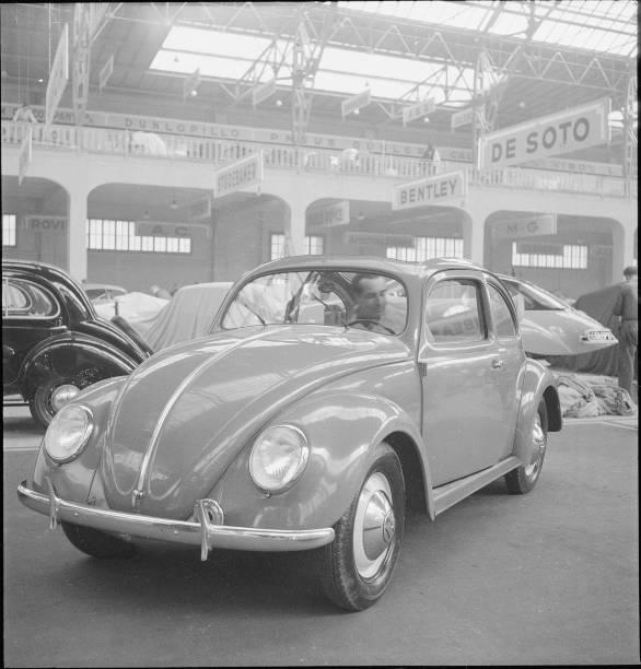

John, The deluxe was also in development early 49 as on the Geneva autoshow in march 49, a deluxe was shown next to the Hebmuller, rolling chassis with 3 spoke deluxe steering wheel and a Tuscher rollback
Cut away chassis
Hebmuller type 14a and on the right under a canvas, the deluxe, in the doorwindow from the heb is the white steering wheel visible.
Tuscher Rollback
Hebmuller type 14a with deluxe visible, the tuscher . Quality is not that good but clearly a deluxe trim on the sedan and the heb.
Note: The heb and the deluxe had already the small logo hubcaps.
So an april speedo was around.

I'll post a picture of it when I am back in my shop. Interesting about the March '40 autoshow pictures, thanks for sharing those....

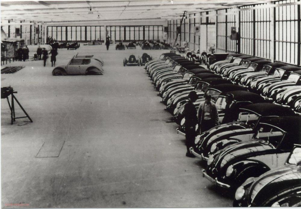

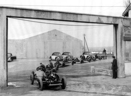

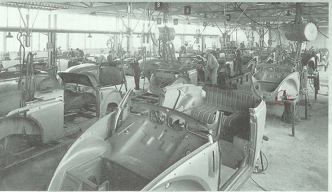

About Hebs, The body went from VW to Hebmuller factory by train, No roof on it, no front valance on it and heater channel bottom only spotwelded with 8 spots.
Pict from VW where you see probably a Karmann body( sema in the back)
THe chassis went also on train from vw to the factory. Rolling chassis, engine included. Parts were send in a different load. As Hebmuller was anoyed that the steering shafts, wheel and tube were shipped not with the chassis. This was hard to move them from train loading dock to the storage hall. It is seen on pict that the workers sitting in front of the chassis, steering by hand on the steering house. Note on the convoy. Plain black wheels, still need to be painted in second color.
No front valance visible here
Most parts went from VW to Heb but parts that vw bought out house, were also shipped from the supplier to Heb. No proof of that but whould make sence . I think on Hella, bosch, Swf, ... to name a few.
storage of chassis in the back of the hall. Pict from 1950.
I do not know how long it took from shipping a body to a finished Heb. I do konw that some chassis stood for over a 2 months in storage. For example, Heb nr 5 was finished end on 21 june, the chassis left Vw in april . it is not clear if the body went with the chassis as they had no nrs on it . Body nr was stamped at Hebmuller as far as I know. Chassisnr was stamped at VW.
