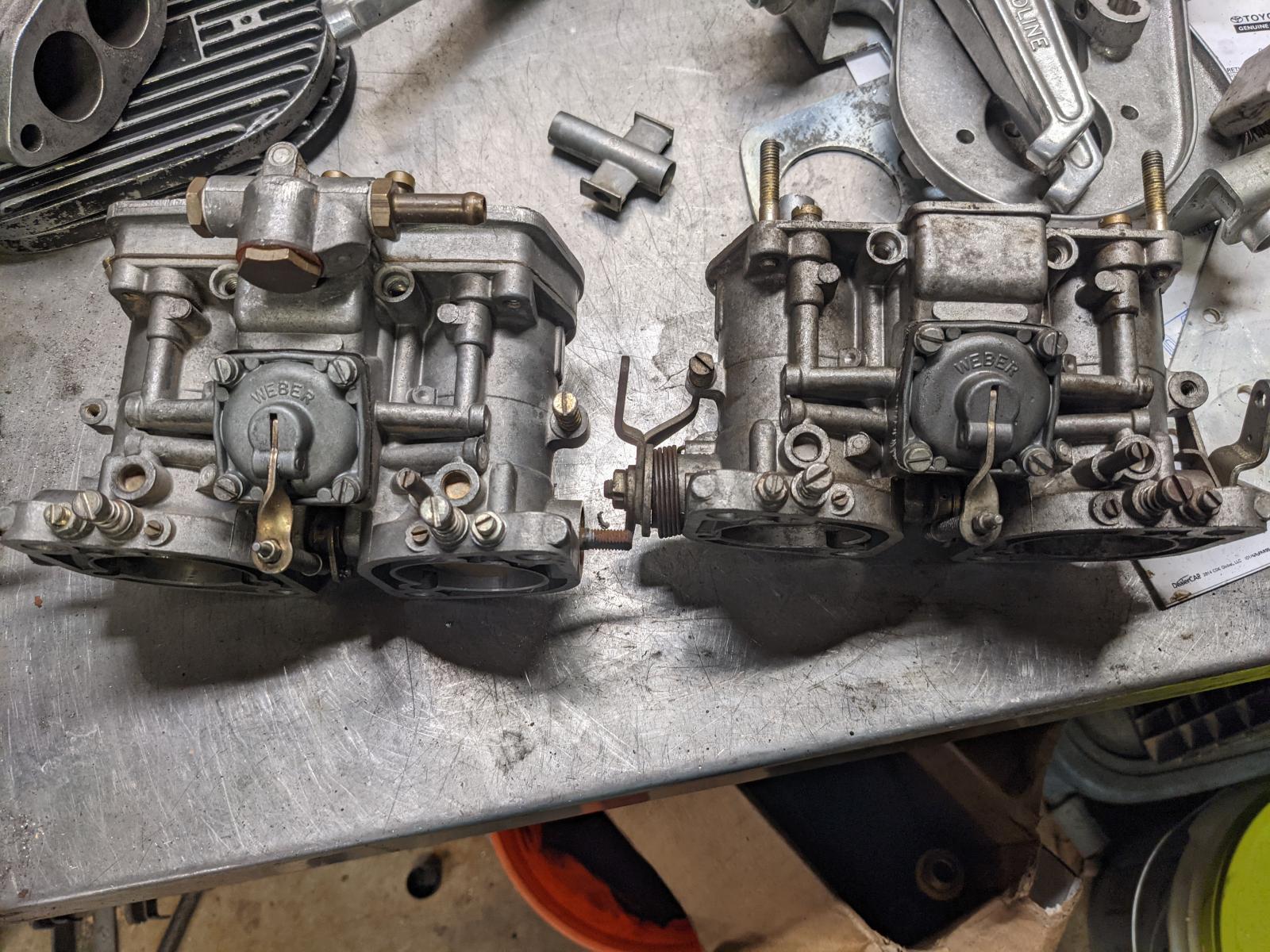

The plot was twisted slightly a few days ago when I got sent to San Diego on work, and checked two empty suitcases on the flight out, and then Southwest Airlines politely transported back 96.4lbs. of VW parts. I put all my clothes in my carry-on and threw away some of my undesirables at a hotel in Solana Beach.

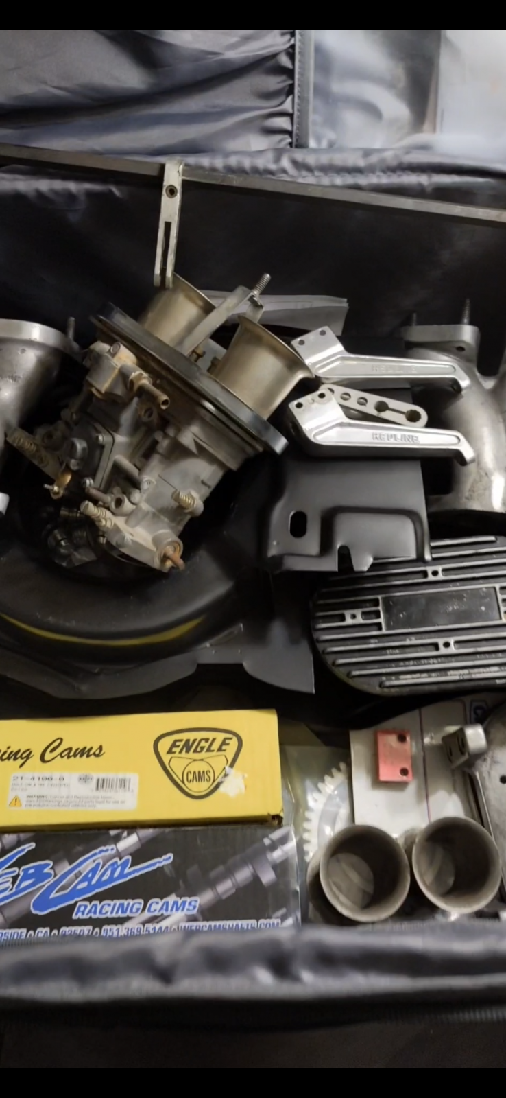

The loot? 2 rebuildable model-similar 44IDFs, Redline linkage, CB cast air filter bases, an Old School set of UMP intake boxes for dual IDFs, Redline offset IDF manifolds, a WEB 218 and an Engle 100 on EP12 blanks, a SCAT fan shroud, 2 cam gears, some CNC brake rebuild parts, 2 type 4 stock carbs for a buddy, some engine tin for Kangaboy on here, 2 stock DP heads for a spare build, and a cool old school ring spreader tool. Here is a fraction of that as I was packing. There was more but I forgot what. I kinda lost my mind a lil bit.
Here's my half disassembled IDFs. Throttle shaft bores are good, bearings crusty. No problemo!
I had it in my head (because of some old tall manifolds I had) that Dual IDFs wouldn't fit in my car, and that turned out to be a big fat lie. The San Diego offset manifolds simply marked "B" position the carb juuuuust so. I'll even be able to fit my airboxes. So now I can try both my Wensing big end casting setup and my duals with the greatest of ease. The dual IDF stuff I had arranged to pick up if I ever made it out there, and luckily I did! I committed to buying that setup based on a hunch that the manifolds that Redline says WILL NOT clear a stock fan shroud would result in the IDF bodies being closer to the shroud and clearing my rear cage bar. They do!

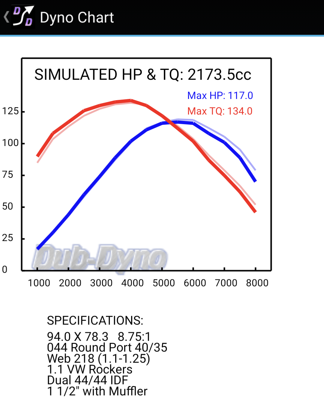

Regarding the WEB 218 vs. The FK-42 cam: It doesn't look like I'll be missing much. I have been running the 218/119 VERY reliably in another engine, hard off road as well as commuting, so I know the 218 to be quiet and reliable with 1.1:1 rockers and Porsche swivels.
DubDyno is of course a very rough estimate that leaves a lot of influential variables "out in the wind" but it is what I call directionally correct. If you under-head and over cam, it shows a very peaky engine that runs out of flow right as it comes on the cam. If you over-head and under-cam, it shows the torque loss. Exhaust way too big? torque loss. It's probably nowhere near accurate but it's fun to play with for $1.99 and would be great to teach a novice the basics. Gave me something to do on the plane.
218 with 1.1 versus (faded) fk42 setup
218 with 1.25 versus (faded) fk42 setup
So, I'm probably not missing much and it's a known quiet cam the way I have it set up. In addition, thanks to a lucky local purchase I now have a nice 1-5/8" Al's U-header, and a 1-1/2" tri-mil U-bend exhaust.

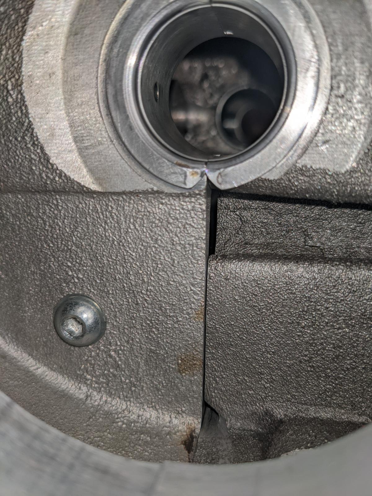

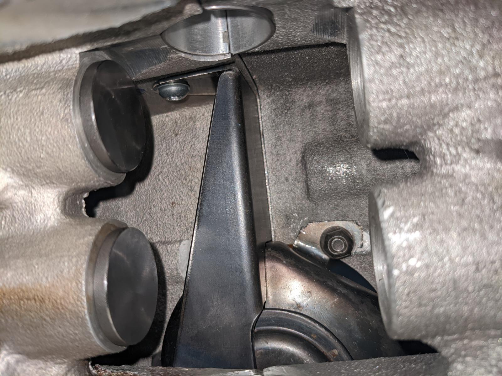

Next, after some careful cardboarding, I moved up to the 3D printer:
THEN, after printing and tweaking several times, it was time for some cold hard steel:
Bolt location on the cam gear "wall" to hold the sump baffle in place
I have the cam degreed in after a few mock-ups and all of the cool parts like the pulley and reinforced alternator stand stolen off my other engine, so it looks like sealing up the cases is next. I had the CB crank and a stock crank balanced, and the CB crank was actually further out of balance than my stocker for my buddy's engine. It needed 7 grams off on the pulley end, but the flywheel end was floating around +/- 1 gram so it was good. The stocker was out 3 grams on the pulley end and 2 on the flyweel side. Probably would have been good for its purpose but we got it below 1 on both ends because it was already on the balancer.

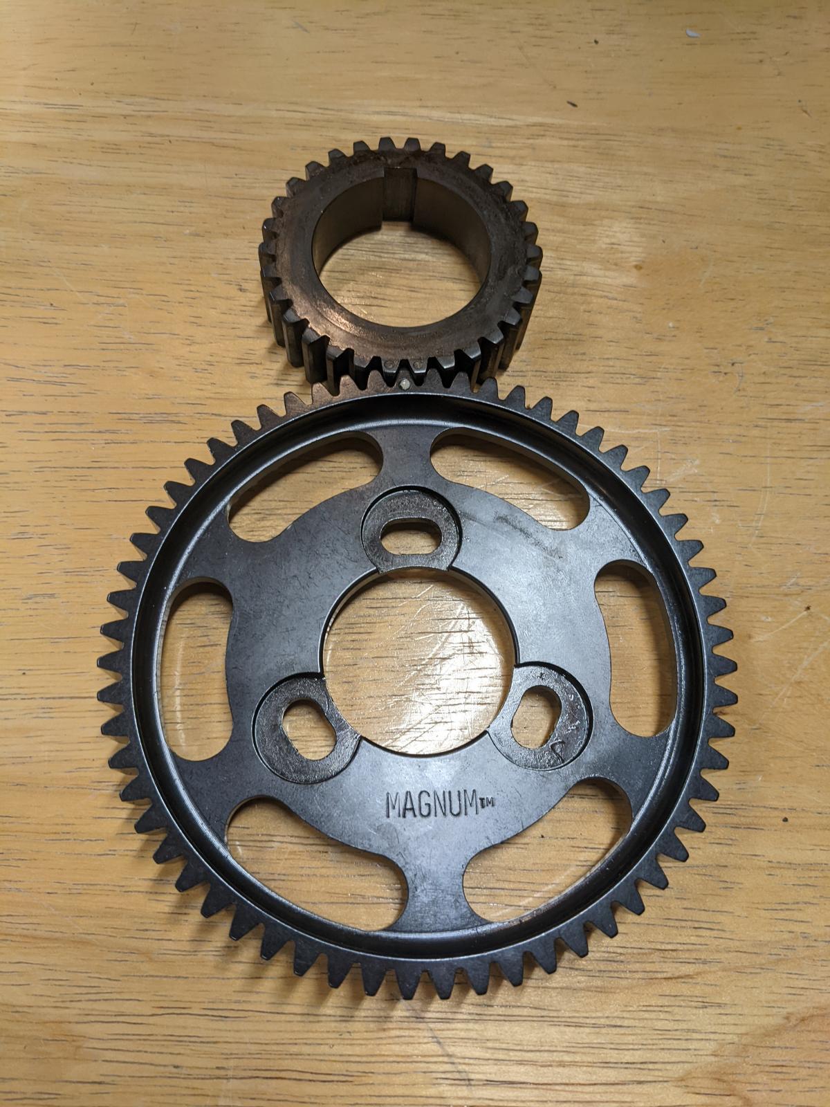

As for nifty parts, I have a nice low mileage set of Magnum straight-cuts I'll be running:

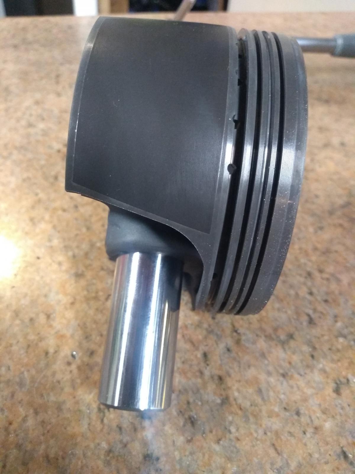

I also procured, from several sources, a full MSD setup with the medium/high power coil, and it came with the curve tuning kit. I have several RPM chips for the 6ALN unit.
I am giving the MAHLE North America forged coated pistons a shot. They seem very well made and I'm looking forward to fitting them.

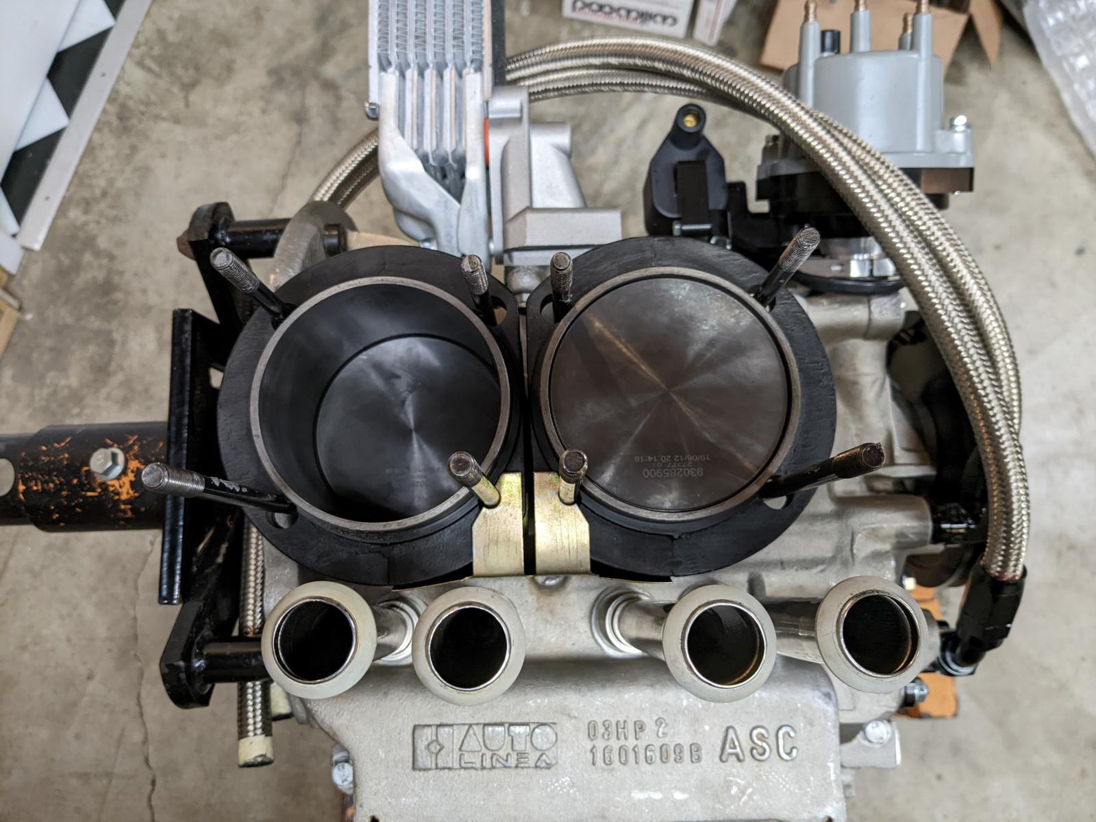

Wow, so that escalated. After a brief 6 month delay I am making good headway here. Aggressively so, I'd say. I ended up waiting a while on miscellaneous dumb pieces, and I was able to change heads to something new I wanted to try.
I worked with our very own Type E motorsports and am very fortunate to now own these AA502 heads, which Brian has flowing 172.9 CFM @ .500" and 179 @ .600" with a 70cc port volume. I think this was the biggest shift in the whole build. I'm lifting to .510" with my Web 218 and 1.2:1 stock style rockers with Mahle/Porsche swivels.
On to the top end: Unfortunately, since my rocker/cam combo is very much not "Dan Ruddock Approved" Twisted Evil I was unable to use his pushrods for this build, since the longest ones he offers are too short. No biggie at all, I needed a little more pushrod tube clearance and I'll use his VERY NICE BRICK SH!THOUSE pushrods on another build without a doubt. They only came up .125" short, but I ordered them before the head change and all that, so I'll transition them to another build. They looks extremely stout, stouter than the dual taper design for sure, particularly due to the side of the land of the tip. CB/Manton dual tapers it is for now, then! Cut and assembled them in my nice new mill in under 15 minutes. I started after my wife got in the shower and finished before she was out.
Now it was time for some top-end assembly and mock-up. This was all figured already, so it was a assemble-n-torque situation. I skim, very lightly, a coat of Permatex Right Stuff Gray on the cylinder base and shims, and then dab a mini-blob at the studs on larger bores. I'm careful to form the cylinder deflectors just so around the cylinder profile. I have a teflon bar I just roll up the side of the deflector to form it, takes a little under 5 seconds each.

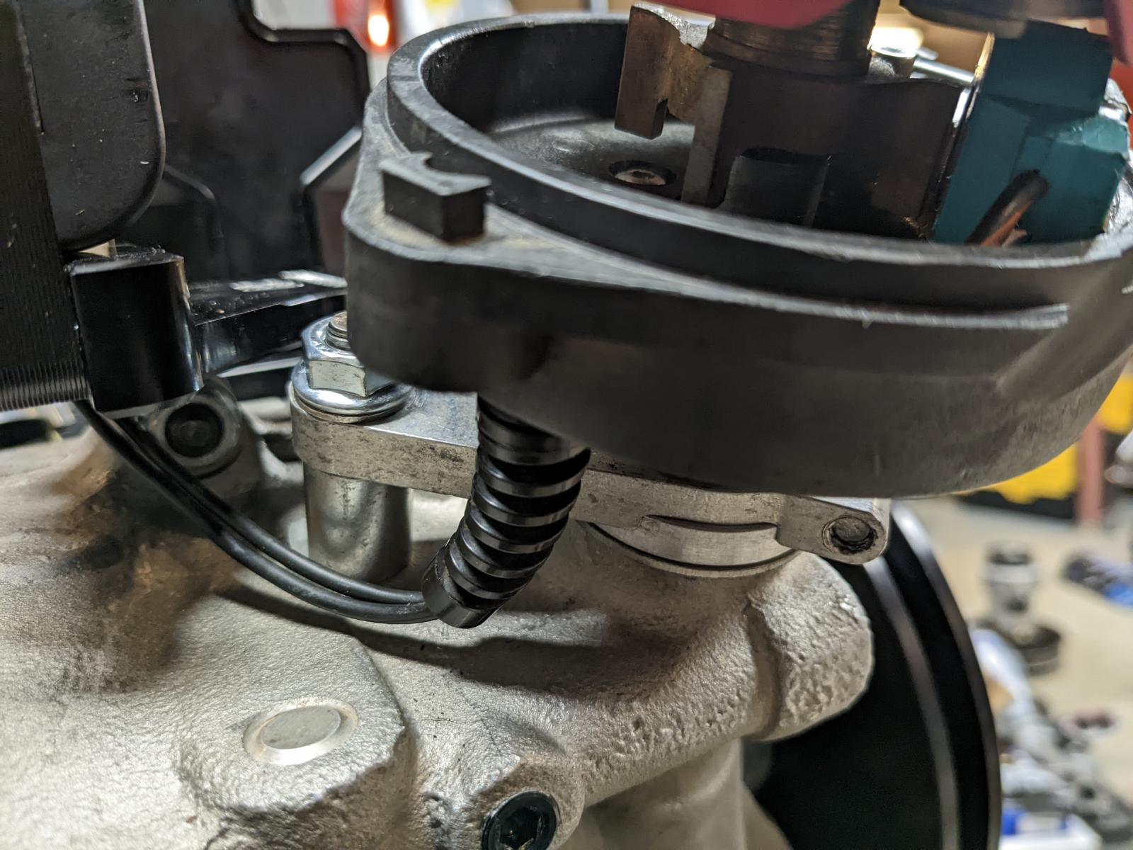

Next, I have two ignition systems I want to run, the MSD and my CB Magnaspark, and they both mount differently. I used a long distributor stud and then the spacer I machined from a bicycle axle spacer either serves as the standoff for the MSD straight clamp, or the spacer for the CB stepped clamp! YOU'RE A WIZARD, HARRY! Laughing

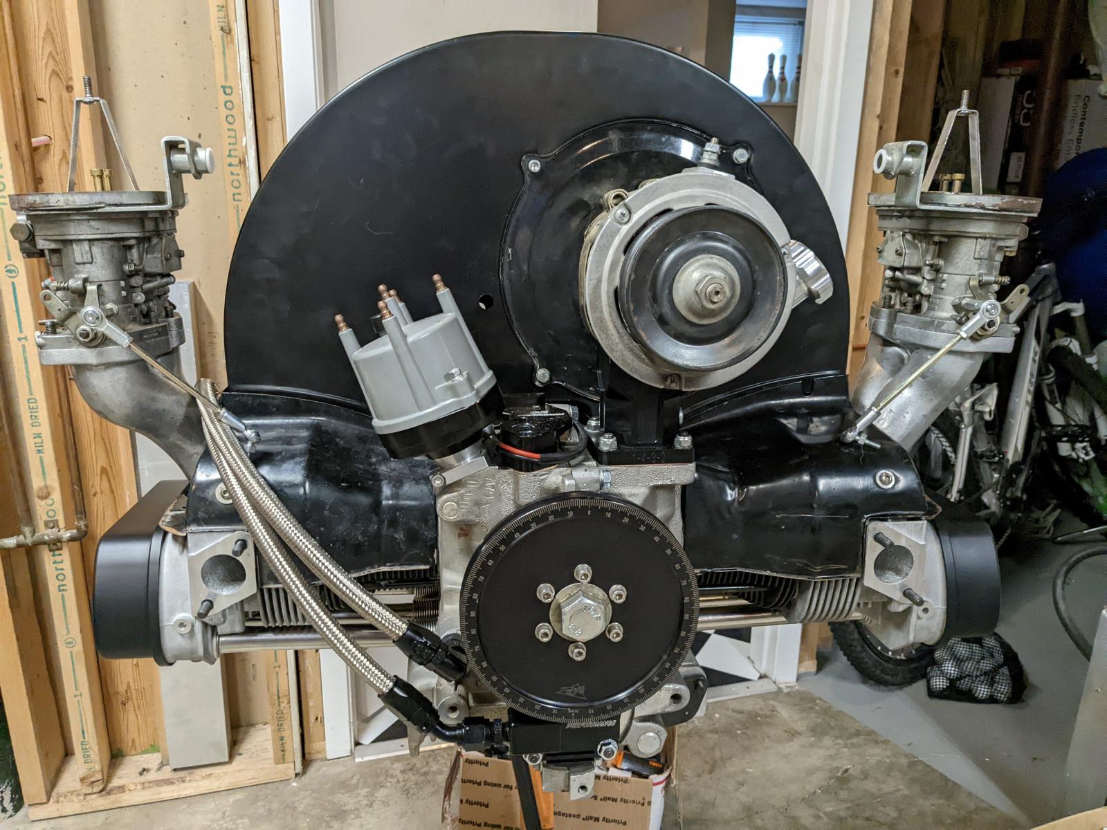

Moving along here, I got it pretty much good to break in except for wiring and some very miniscule plumbing. Ignition for break in will be the centrifugal CB Magnaspark with their wires and coil and plugs.
I got that mocked up enough to take it out of the basement, around the house, and up to the garage for install! That... was not straightforward since my usual "easy button" (my Bobcat) is out on loan to a good friend. Instead, I decided to push the sketchy button. I'm a good bit under 200lbs and it wanted to nose straight over if you touched the front brake.
Then I got it in the car, installed some plumbing and random sensors after I made my oil temp plate and the -8 AN hoses.

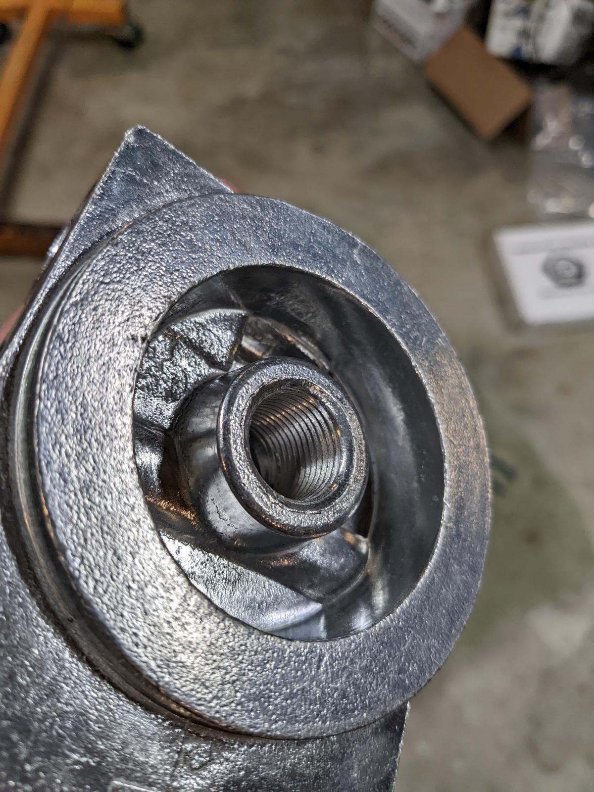

Frustration level is at an all-time high here - hoping to break this thing in tonight if all the stars align, which they almost certainly won't. Brick wall
First off, I went to plumb this filter up and it looked totally great. I was using a Derale brand remote filter mount. Maybe Chinese cast and U.S. finish machined? but more likely cast and machined in China. Spent forever porting and de-flashing it, plumbed it in and went to screw the filter on, and....
Well that's not gonna seal. Figures, the ONE TIME on this engine where I was like "whatever, I'll just get the China one it'll be fine I'll get a Setrab or something after break-in." Good news! I bought the CB performance branded equivalent for a customer engine, and BAM! Great news, it's also trash. It was tapped on an angle too! Laughing A-maazing surface finish! Embarassed
So, I got that figured out by re-machining the Derale one and making a custom nipple for the filter to thread onto and now no spark.... So... now I'm trying to figure that out. EVERY SINGLE problem I hit basically takes me a day to fix. It has got to be just a maximum pain experience trying to make money building these. Never have the words "Labor of Love" meant more to me. You gotta WANT IT if you're going to build performance VWs these days.

PostPosted: Wed Sep 21, 2022 5:59 am    Post subject: Re: Winter 2176cc Prerunner-Style Engine Build Reply with quote
What a POS!
The quality of that piece is embarrassing. Sorry man, that sucks
