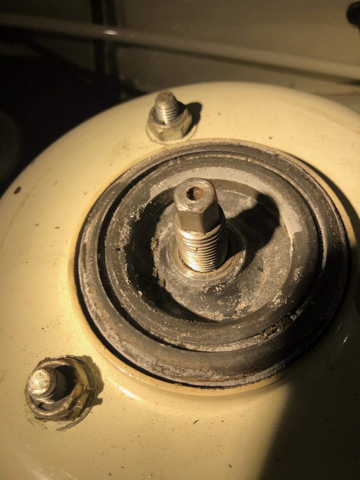

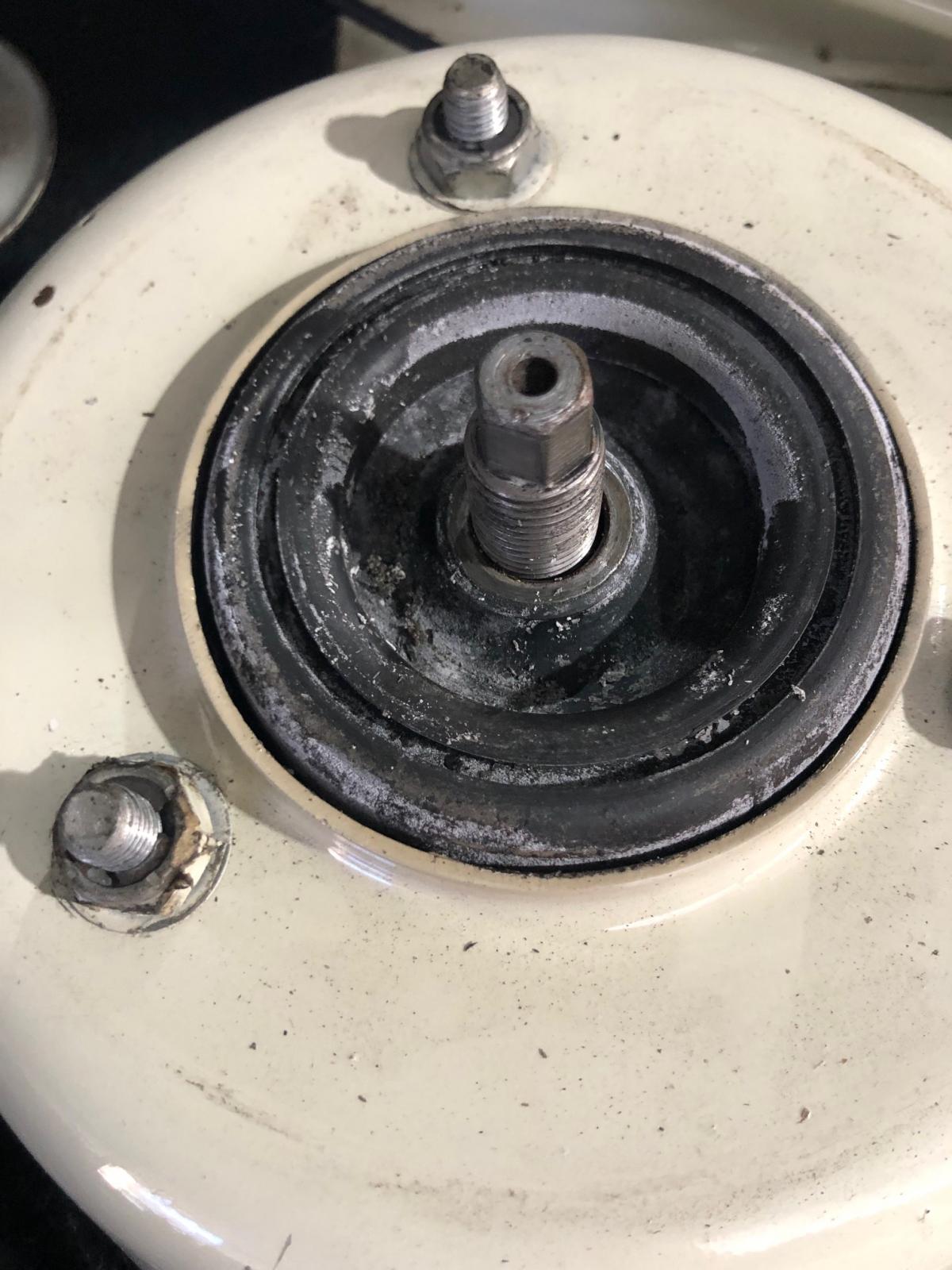

lateral
Joined: August 21, 2012
Posts: 94
Location: Sydney Australia
lateral is offline
PostPosted: Sat Sep 23, 2023 7:50 pm    Post subject: Re: Top Mounts (replacements) for my 1969 411 Reply with quote
Hi guys
Firstly, thanks for the quick replies.
As requested, here is the photo of the bolt pattern of the top mount. The bolts are symmetrical and 95mm apart.
raygreenwood
Joined: November 24, 2008
Posts: 23429
Location: Oklahoma City
raygreenwood is offline
PostPosted: Sat Sep 23, 2023 11:03 pm    Post subject: Re: Top Mounts (replacements) for my 1969 411 Reply with quote
lateral wrote:
Hi guys
Ok. So you have the VERY early "friction bearing" style mount. What 412sti is getting at is that your mounts have a very small hole. You would have to literally cut the hole larger to use either of the two later model strut mounts.
The nice thing about the early friction bearing is that if it wears out, its a simple bushing to be replaced. No ball bearings. However, if its the rubber bonded bushing thats shot....well thats another issue.
What you cando for better clarity...is with the car on the ground....remove the nut and upper dish shaped plate. With the car weight on the struts nothing will fly apart but you can inspect the bushing around the strut rod and we can go from there.
You can switch to either of the later bushings with a little work but lets see what is worn before we go there.
Ray

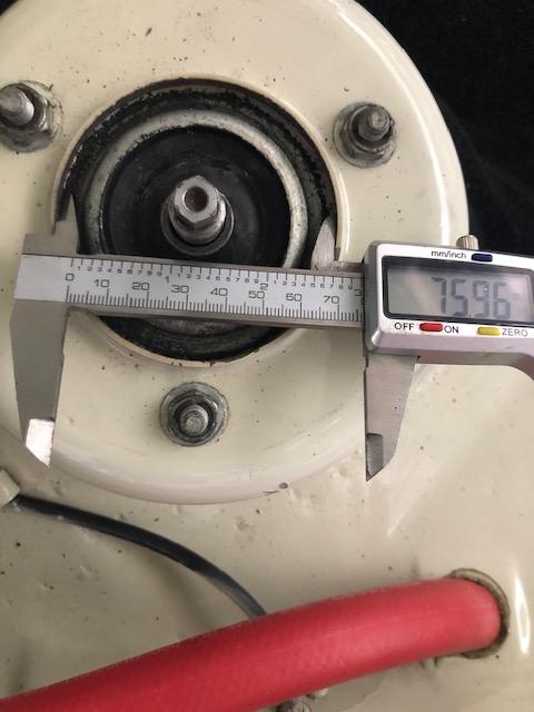

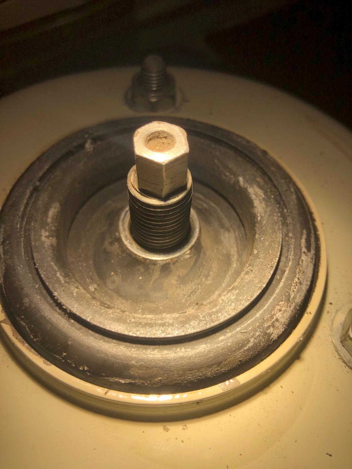

PostPosted: Sun Sep 24, 2023 9:21 pm    Post subject: Re: Top Mounts (replacements) for my 1969 411 Reply with quote
Hi guys
Here a a few pics of both the right hand and left hand side Top mounts.
Interesting to note that the mounts seem to still have the white waxy protective coating and I can't see any tears or damage.
Should I be looking for anything else?
Cheers
Greg
raygreenwood
Posts: 23429
PostPosted: Mon Sep 25, 2023 7:45 am    Post subject: Re: Top Mounts (replacements) for my 1969 411 Reply with quote
OK! Good pictures!

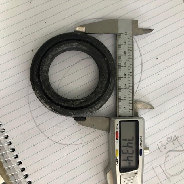

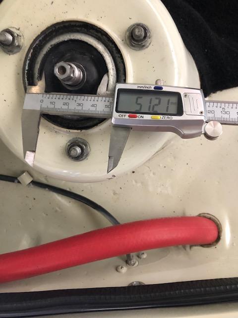

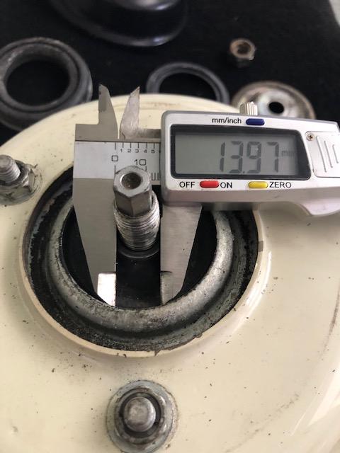

Could you please measure with a caliper .....the diameter of the rubber bushing you see at the hole and also the hole in the sheet metal as well.
And for God's sake....do not lift the car off the ground with the top nut off! Wink
Once you get the top nut back on, lift the front end up one side at a time and take the wheel off.
Get a stool and get comfortable next to the rotor. With a flashlight look upward. You may have to use a screwdriver and your ringers to pull the bump stop and the boot downward.
The way the upper mount and bushing assembly is made....you have a steel plate with a hole a 3.5" in diameter in it. The rubber is cast through that hole so that the part with the bearing or steel bushing....has about 4/5ths on top of the plate and 1/5th underneath. You can think of it a being made like a giant "grommet".
You are looking for very fine cracks in the rubber on the section on the underside. You can only see this when the car is off the ground and the combined weight of the strut, wheel casting and spring pressure....stretch the bonded rubber downward. A few very fine cracks is no big deal. Deep cracks or distortion or misshapen rubber under the plate or rubber peeling away from the plate means you need a new strut mount.
You have the very earliest design of strut mount. They are pretty rare anymore.
They are also the most bullet proof. They did have a tendency to wear out the center steel bushing that is around the strut rod....from the few I have actually seen. Take your hand and wiggle the strut rod while you have the top plate and nut off. If there is not significant play....maybe no more than about 0.025"....it should be fine.
The one in your second picture looks to have a little excessive slack but it could be the light. I will have to look in the parts diagram to see if there is a thin wall shim bushing between the strut rod and the bonded in steel bushing.
So....the reason why the changed from this simpler friction bushing to a later ball bearing in the middle years when it was otherwise the same rubber bushing and plate.....is because the small gap that wears between strut rod and steel bushing causes a little bit of rattle.
Cumulatively, along with other small tolerances in parts like the idler arm bushing....these small rattles can cause hard to diagnose vibrations are various speeds. Other than that it's not unsafe by any means.
In the middle years version, the went to an FAG ball bearing, swaged into a metal cup that was of almost ridiculously high quality for the near "0" rpm and load it would see. It also had a nylon center bushing to make a tighter fit on the strut rod with no wear.
If everything checks out...no cracks in the rubber underneath and no rubber separation from the plate....I would keep what you have. If the wear in the steel bushing is a little bit excessive, I would take the bushing unit off, sand the inside with a Dremel tool just enough oversize to install a thin wall nylon sleeve bearing and it will tighten that right up. Ray

PostPosted: Tue Sep 26, 2023 7:51 pm    Post subject: Re: Top Mounts (replacements) for my 1969 411 Reply with quote
Hi Ray,
I have checked the rubber from the top and it is all pliable and looks like new. No cracks or damage.
I replaced the nut and raised the car on a hoist and couldn't pull down the plastic cover to properly check from underneath.
I have attached the photos that show the dimensions.

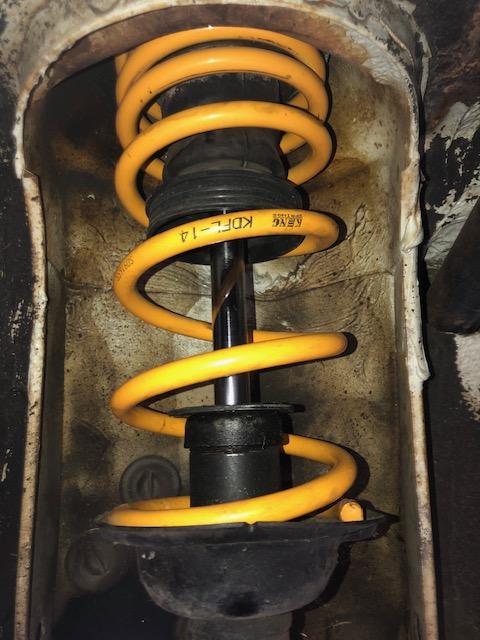

From the top, I checked where the shock chrome centre tube protrudes through the centre of the rubber mount (on both side) and there doesn't appear to be any excessive slack so I think it was just the light/shadow.
I have included a photo of the shock showing that the springs have been replaced with aftermarket springs at some stage.
I noted that the springs on both sides are positioned so that the "tight multi" coil is located at the top...is this an issue?

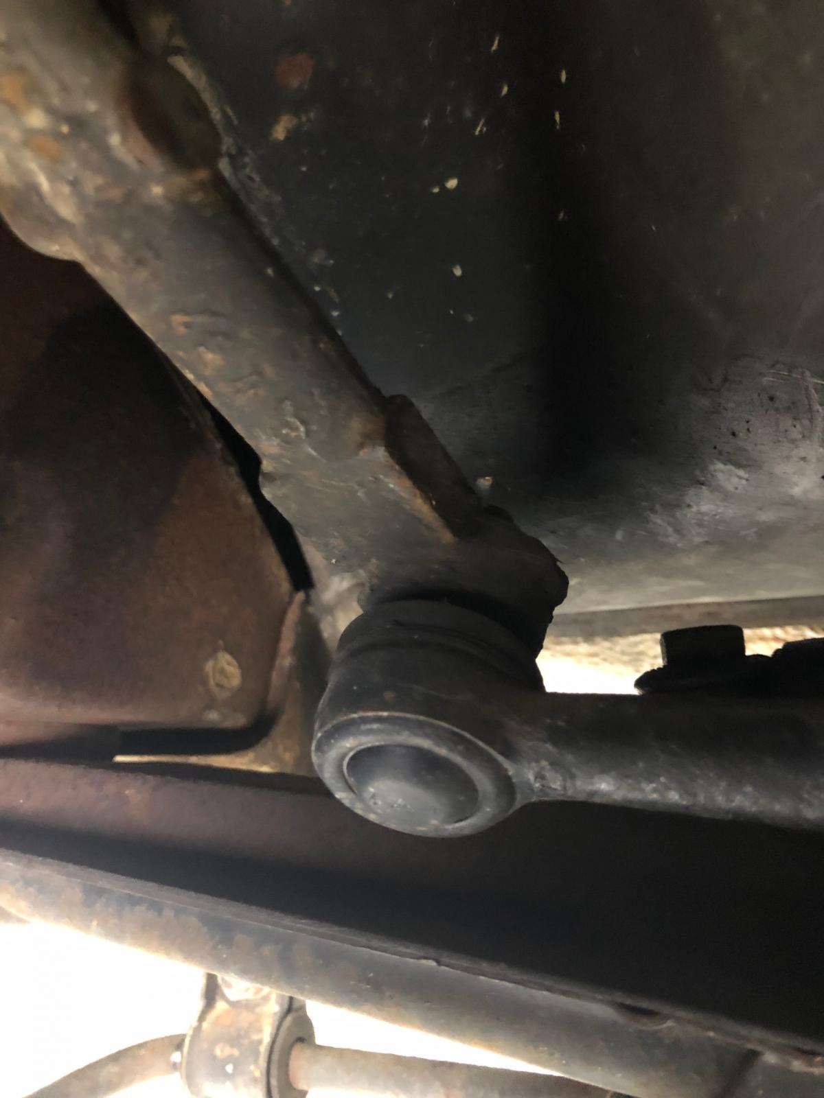

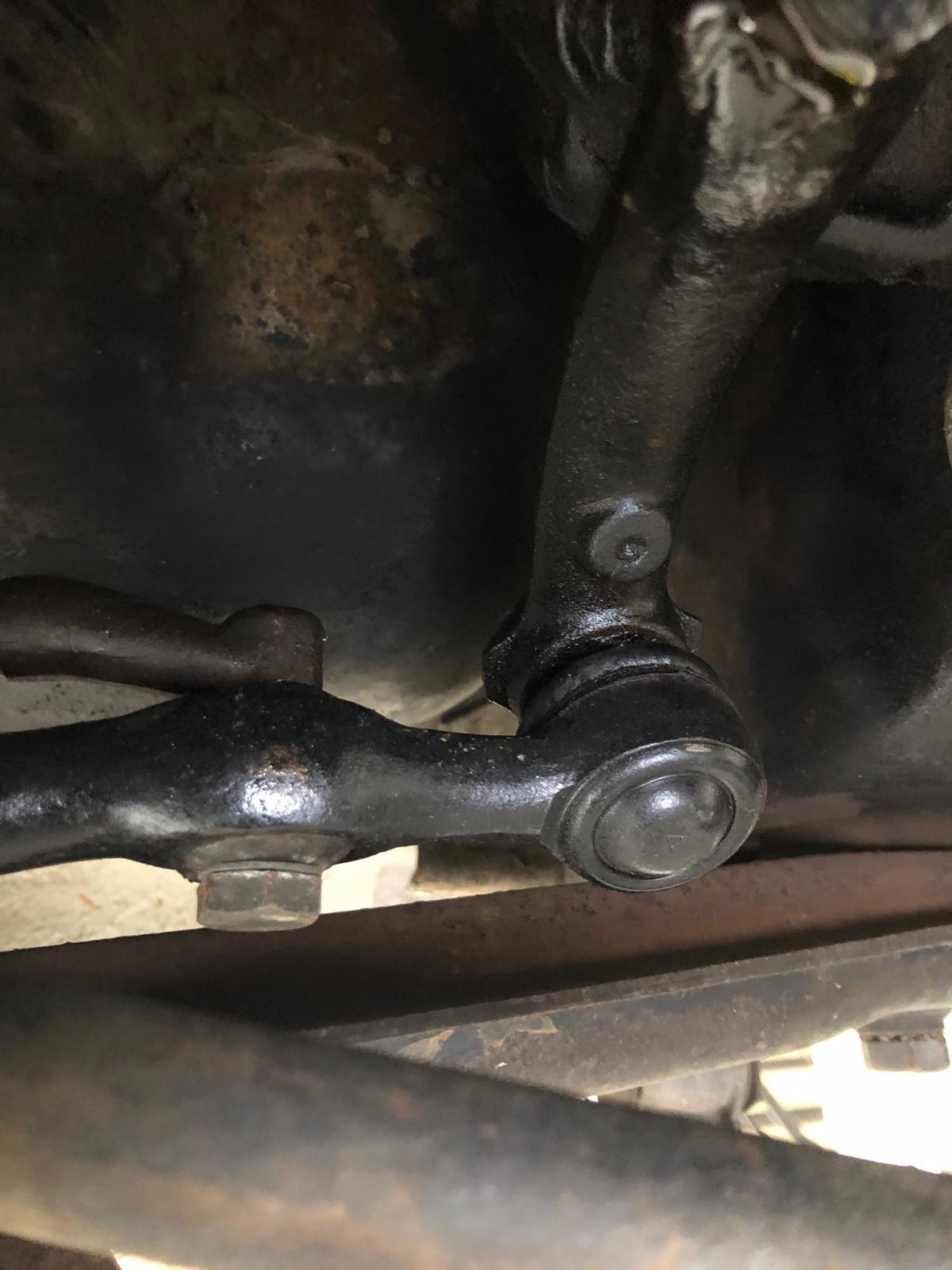

Whilst the car was up on the hoist, I checked out the Steering Idler bush and found that it has lots of play.
Here's a link to a video I took. I moved the wheel against the stop. Expand it so that you can see the amount of movement:
https://rodpenroseracing.com.au/blog/technical-articles/idler-arm-bush-movement

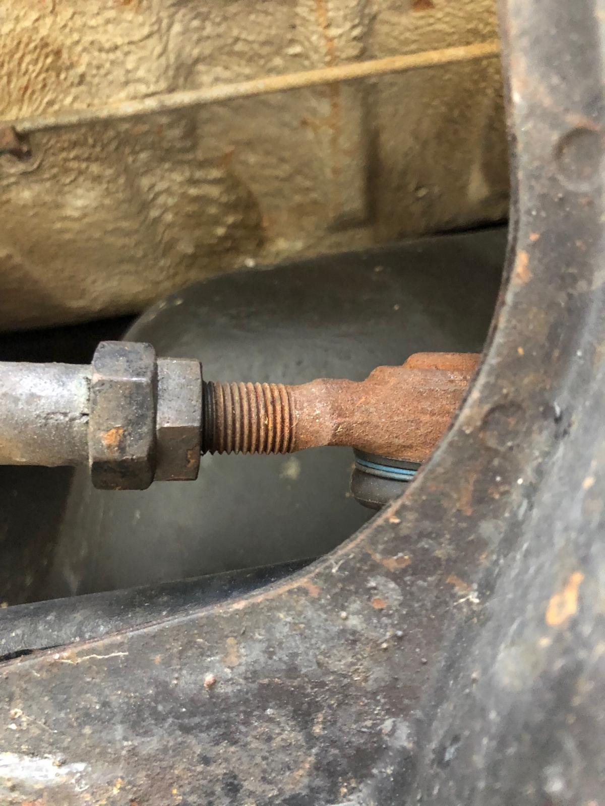

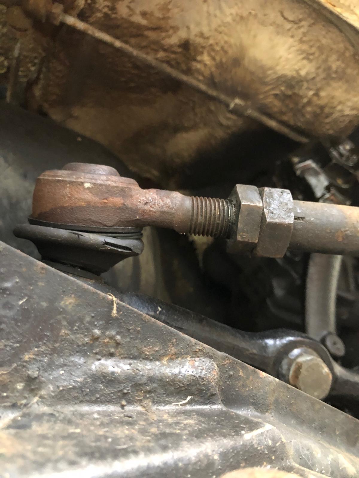

I also checked out the Lower Control Arm and the tie rod ends at each end look good. I have been told that there is only 1 Lower Control Arm for both RHD and LHD cars...can somebody please confirm this?
I then checked the other tie rods and I am a bit confused as the parts book I have says that the 2 inner tie rods should be 9 degree cranked (angled) the same as a Type 3 (311 415 818B).
Mine all look straight.
I checked the sway bar bushes and the sway bar has about 2-3mm movement in one of them as per the following photo:

Because of the springs:
So, for the function itself, it is quite irrelevant how a spring is mounted. (mostly)
But the manufacturer still thought of something, because normally a spring is correct installed in such a way that the labeling can be read correctly.
It also sits better in the spring plates at the bottom and top.
Here in our country you would fail the technical inspection with springs installed like this, because the inspector assumes that they are installed incorrectly. (regardless of whether that would be technically irrelevant)
Gerold

Technichally...as noted...those springs are upside down.
That does not mean that they are dangerous or will not work....but there are differences.
Notice that the coils at the top are closer together. Those are supposed to be at the bottom and are the "load" springs. Those that are spaced further apart are the "comfort" or flex springs.
The way they are now MIGHT better control the issues there were with the stock struts (weak rebound). It can also make for rough ride. Hard to say because I do not know what those came from.
The stock springs came in at least three variety. All were slightly progressive...similar to those. Some of the later ones un 412 had more coils and thicker wire.
I will take a few minutes in teh am to go over the rest of the details from your pictures. Ray
