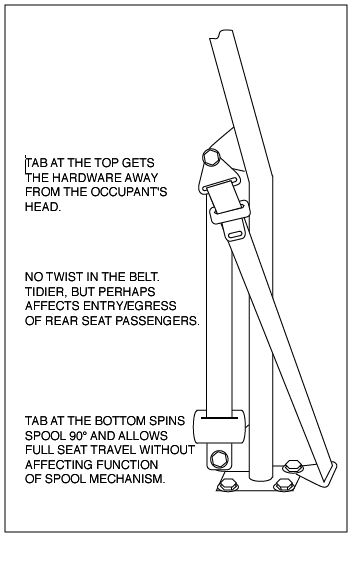

chinarider wrote:
Nice work! Did you do it in Illustrator too?
Yup, Illustrator. For "real" technical drawings requiring dimensioning, etc. I use Canvas. Here are my thoughts:
1) The shoulder point would probably work well, mounted on a welded tab like that - you'd probably have to mount it a little bit higher on the rollbar, though, since the same position mounted further back would create more of an accute angle over the shoulder.
I plan to go with the 4-point style roll bar rather than the Thing Shop 5 point style. I know that the 5-point is stronger, but I don't plan on rolling my Thing, just need a place to hang the shoulder belts. I'm debating whether or not to slant the upper portion of the vertical bar. I'm of average height myself, and I don't think overhead clearance is an issue. And the vertical looks better to me, aesthetically speaking. (Always the battle between form and function. I can never seem to concede everything to practicality.) If I go with the straight vs. slanted vertical bar, putting the mounting point higher won't place it further aft.
2) . . . My biggest concern, though, would be the spool's ability to attenuate in a head-on collision, when mounted sideways. I just have no idea if they're designed to do that.
I believe it is the speed with which the belt begins to spool out that triggers the locking mechanism, and that the orientation is moot. If anyone knows differently, please chime in!
3) I very much like the idea of mounting all of the parts on welded tabs, thereby eliminating the need to drill holes in your rollbar. . . . I was very careful to ensure that the holes I drilled were the smallest diameter possible to safely accommodate appropriate seat belt bolts, and I was very careful to make sure that there was zero-play between the bolts and the holes (idea being that a very tight fit would help cut down on the bar's ability to crush in a rollover). Also, these holes run from left to right (rather than front to back), so there's more metal where it counts in the event of a rollover. Bottom line is that it was a judgement call: am I more likely to need rollover protection, or seat belt stopping ability?
My suspicion about roll bars in a Thing is that in the event of a severe rollover, it's likely that the roll bar will pull out of the sheet metal it's mounted to before it would crush. Strictly speaking though, a tight fit of the bolts in the holes won't lessen the tendency of the tubing to bend at that weakened point. The textbook approach would be to weld crush sleeves into the holes. Probably overkill. I would make the same call you did regarding rollover protection vs. seatbelt stopping power.
4) Make sure the welds are done right. They have to stay intact in a crash. If possible, I would do a metal sleeve (fab one up like a large compression fitting, with metal tabs on the open end) around the rollbar, and weld it in place. It may be overengineering, but you can be pretty confident in it's ability to work.
Just 1/4" plate judiciously welded is enough to make me feel confident. I've done similar work in stunt cars that were subjected to the most severe punishment, and while I've seen the tabs bend, I've never seen a competent weld let go. If I were determined not to let the tab bend, I'd make it out of shallow C-channel to give the tab a little depth. I think of it this way: most upper seat belt mounting points are set into sheetmetal pillars. While I'm not an engineer, I have to believe that plate steel welded to 1/4" thick tubing is at least equal to what most passenger cars provide.
All this, of course, IMHO.
Thanks again for your posts. Please express any further thoughts . . .
— Spalding
Here are my thoughts on functionality:
1) The shoulder point would probably work well, mounted on a welded tab like that - you'd probably have to mount it a little bit higher on the rollbar, though, since the same position mounted further back would create more of an accute angle over the shoulder. I like it, though - I don't think it would get in the way of rear passengers' heads.
2) The spool, spun and mounted 90 degrees like that, should not take up any measurable difference in rear foot room (it's essentially the same dimensions front-to-back and side-to-side. My biggest concern, though, would be the spool's ability to attenuate in a head-on collision, when mounted sideways. I just have no idea if they're designed to do that.
3) I very much like the idea of mounting all of the parts on welded tabs, thereby eliminating the need to drill holes in your rollbar. This is something I stressed over when installing my own setup - I did not want to compromise the integrity of the rollbar. Still, I ended up doing it pretty much out of necessity; I had to take the Thing on a long trip, and couldn't possibly have any welding done beforehand. In fact, the only holes that would really compromise integrity are the upper ones; the lower holes are between the floor pan and the side member mounting points, so the side member essentially acts as a sister frame & shares the load in that area. That said, I was very careful to ensure that the holes I drilled were the smallest diameter possible to safely accommodate appropriate seat belt bolts, and I was very careful to make sure that there was zero-play between the bolts and the holes (idea being that a very tight fit would help cut down on the bar's ability to crush in a rollover). Also, these holes run from left to right (rather than front to back), so there's more metal where it counts in the event of a rollover. Bottom line is that it was a judgement call: am I more likely to need rollover protection, or seat belt stopping ability?
5) I don't think the vertical run would get in the way of back seat passengers, or the rear door opening.
What do you think?

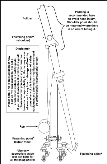

Nice whipping. Did some of my own:
Based on the comments you made regarding your own installation, I came up with this. Rather than bolting through the tubing, I thought it might be helpful to weld a couple of tabs onto the back edge of the bar to create mounting points for the belt hardware. The changes are obvious, and I hope address the issues you cited.
My questions: Do you think these modifications adequately address what you feel are the limitations of your current setup? With the seatbelt takeup spool spun 90 degrees, do you feel the problem with the seat/spool clearance would be solved? Based on my drawing, how much do you think the vertical run of the seat belt would intrude into the rear door opening? Do you forsee any other problems with this setup?
Thanks for posting your drawing, and for your input.

I don't have any photos right now, but I whipped up this illustration of the way I set mine up:
Of course, we're talking about safety here, and it should be noted that this is not a tested system, so use it at your own risk, and have anything inspected prior to use.
While I feel safer with this setup than with the stock lap belt, I did notice several potential problem areas, and I'm considering switching to non-retractable 3-point belts. Specifically, I noticed that if the seat is pushed back too far, and it comes in contact with the seat belt spool/reel, it affects the reel's ability to feed properly. This may also affect it's ability to lock when needed. Since I'm an average-size guy, I don't need to put my seat all the way back, and it does not come in contact with the reel. I also make sure that my passenger's seat is not too far back. Foot room in the rear is also slightly impacted by this setup. The shoulder point is not adjustable in this setup, so a comfortable location should be chosen carefully. Also, I'm not happy with the proximity of the shoulder mounting point to my head - would much prefer it to be outboard of the rollbar, but this affects it's ability to feed. These are the main reasons I'm considering switching to fixed (non-retractable) 3-point seat belts.
