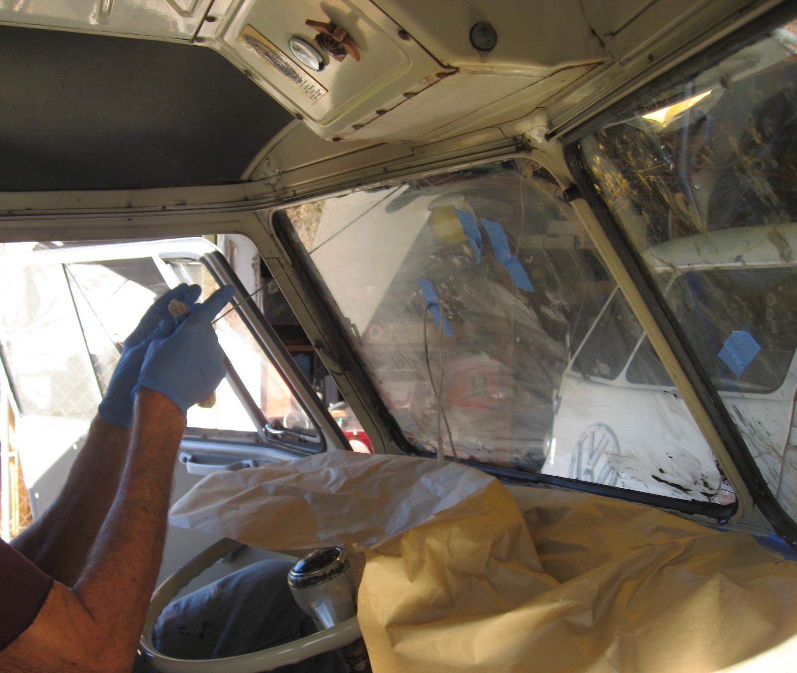

Do you have someone to help you? Do you have the string or fat insulated wire around the groove? Or do you mean putting the rubber on the glass?

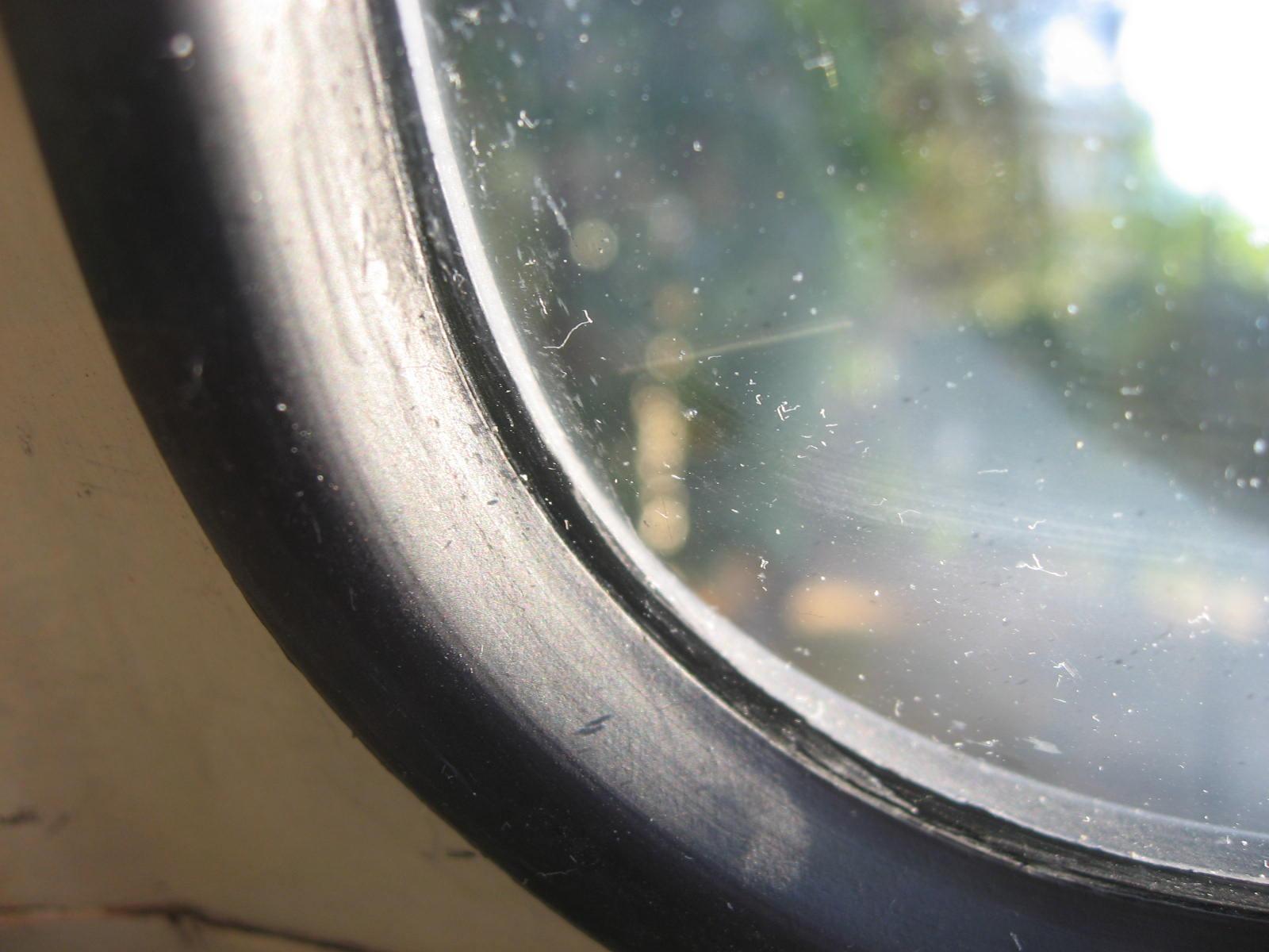

This photo has an optical illusion that the pulling cord is at the top of the window; it is not. The actual cord is about a half foot above the child-cot bracket. The rest of the string in that photo is a reflection of the real string.
