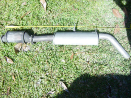

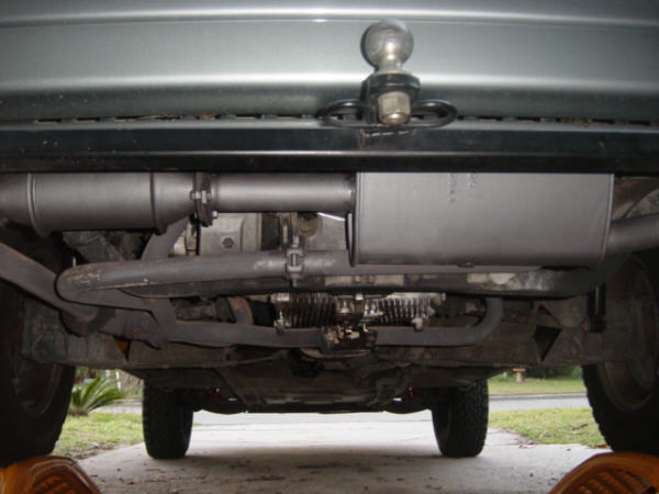

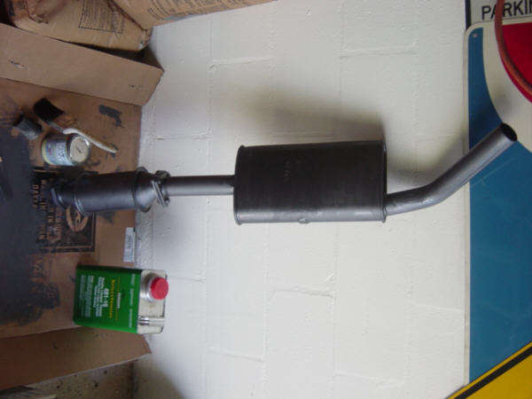

PostPosted: Wed Feb 08, 2006 10:16 pm    Post subject: POR15 exaust Reply with quote
Hey there lovedadubs, looking good so far. Hope this works out for everyone involved with this process. I scuffed up my exhaust and put one coat of POR15 on my Vannie and it lasted about 2 months befor heavy surface rust. I am trying it again following directions very closely:
Step 1: Sandblast entire surface of cat and muffler clean.
Step 2: Paint on one coat and wait 25 hours, I used heat gun at 800 degrees to bake on first coat. (notice in garage, not dining table Wink )
Step 3: Paint on second coat, waited about 6 hours and installed, we shall see? Between new Cat converter and S&S muffler over $250 invested, I want to keep it around a while!
1987 Wolfsburg T25 still riding out. A bunch of other VW's passed on...
