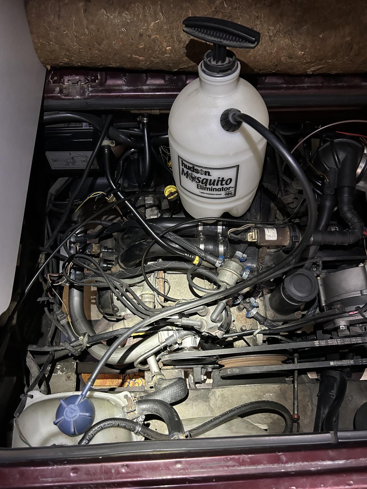

I modified my method the other day, since I wanted to pressure test it anyway.
And… we carry nothing we don’t routinely use, or need.
Pumped to 14, waited a half-hour to test, opened rad bleeder until coolant ran solid, closed bleeder, removed tester, topped off.
Two tasks done in one.

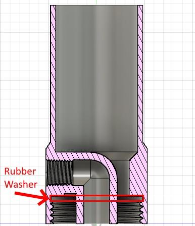

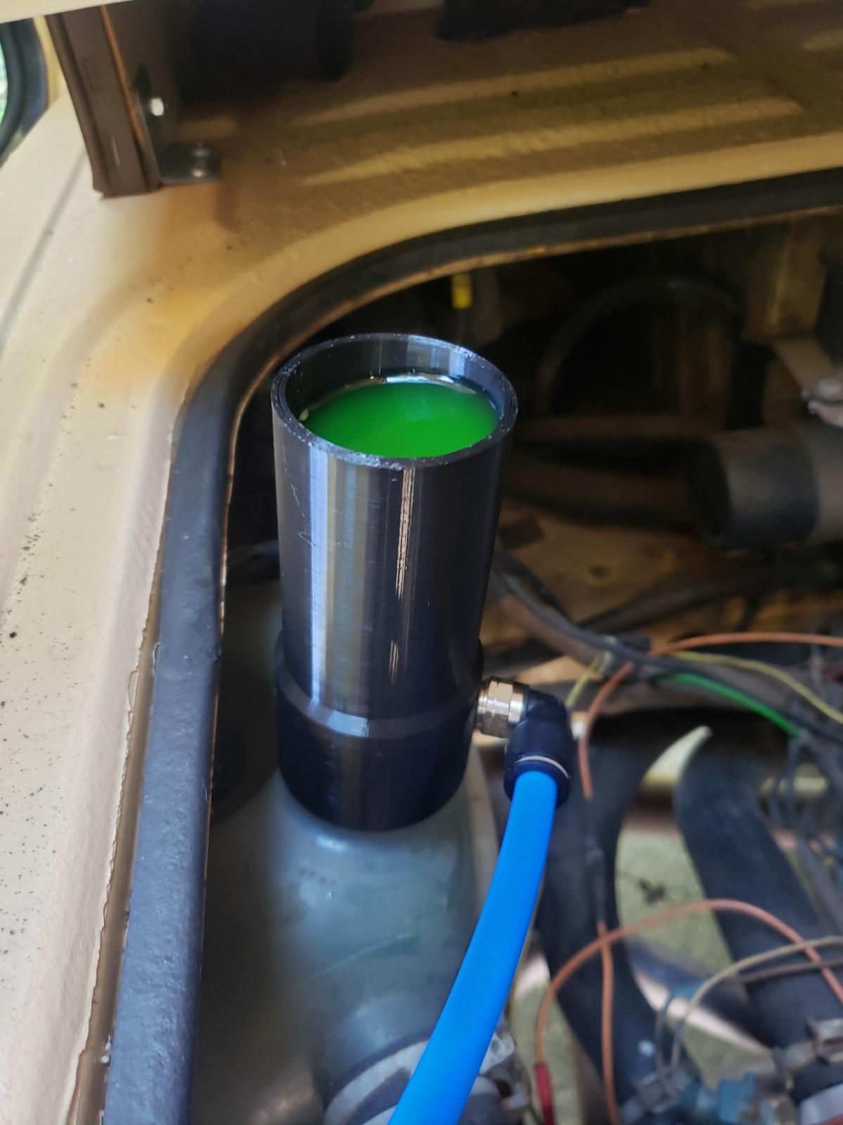

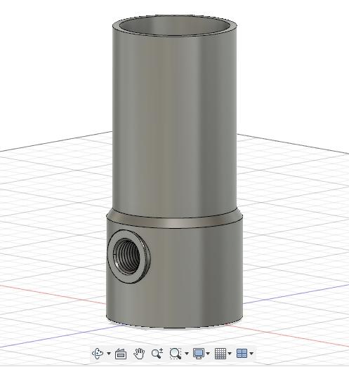

I was tired of trying to get the rubber coupler to seal on the threads of the coolant tank so I deigned and 3d printed this. It threads on uses the rubber washer out of a spare coolant cap to seal.
For future reference the threads of the coolant tank are M48x3
More info and print files here https://www.thingiverse.com/thing:5556688
I suggest you print it out of PETG

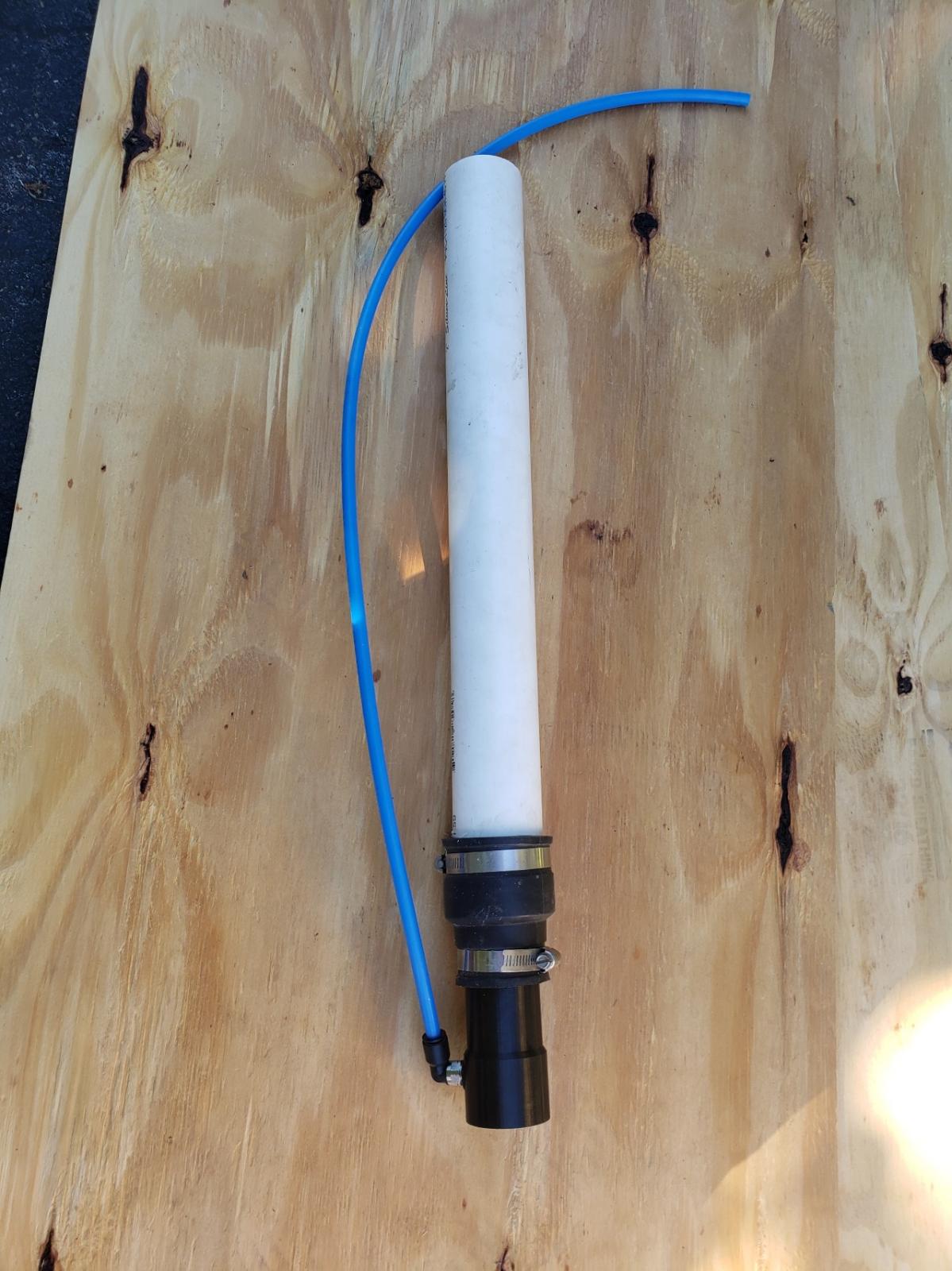

I know, you're thinking this post doesn't need one more reply, but in 9 pages of meandering, nobody mentioned how long the bong needs to be (you can guess from the photos, but still...) Here are my notes:
Measure up from the ground to your radiator bleeder screw. On my van it was 39 1/4" (I have slightly taller springs).
Now measure up that far in your engine bay and put a piece of blue painter's tape on the left cabinet. That's the level your coolant has to stay above. It's about 11" above the expansion tank. Later, transfer that measurement to the bong pipe. (There's two pieces of tape in my photo: my van's nose was 2" up in the front, so had to raise this level).
So: any pipe longer than that will work (assuming van is level: adjust accordingly for incline). I found at my store pre-cut pieces of ABS at 24". PVC is fine too. This worked great. If I had longer, I might have gone for 26", I would assume the taller the bong the faster the filling as there is more pressure. But, if you go for a 3' tall bong, you're making it harder to fill, and as in one picture if it leans over too much, you're putting unnecessary stress on those possibly old brittle tank caps, and might cause leaking. Thus the rope/bungee cord holding up strategies.
These pre-cut ABS pieces (and maybe your cutting) leaves little pieces of plastic static-clung to the inside of the pipe. Wash them out before they end up in your radiator.
Mr. Libby specs nylon tubing, which I think you'll have a hard time finding in your hardware store. I'm guessing he may have meant what I used: 3 feet of 1/2" OD polyethylene tubing. It's more rigid than vinyl, which keeps it from kinking, collapsing and reducing flow. It's tough to get it to make the turn inside the pipe, but doable. If I did it again, I would have warmed the tubing with a hair dryer or heat gun to make it more flexible.
I drilled the hole 2.5" from the bottom of the ABS pipe with a 31/64" drill bit. I first tried a 15/32", but couldn't get the tube in. This slightly smaller hole seals the polyethylene tube well. I had absolutely no leaking. If I didn't have that drill bit or used vinyl tubing, I'd probably put silicone around this hole. I left it sticking 2 1/2" out the bottom of the pipe before attaching the Plumb Qwik reducer.
I had no leaks from my PlumbQwik to the tank. I had teflon tape on hand just in case. Rubber bands are okay, but if you have any kind of strap, like a velcro strap, it's a bit easier.
Stop filling with coolant when the level is a couple inches below the top of the main pipe. It's easy to overfill and spill. Having the clear/translucent siphon tube to watch the level is very helpful.
Hope that helps.

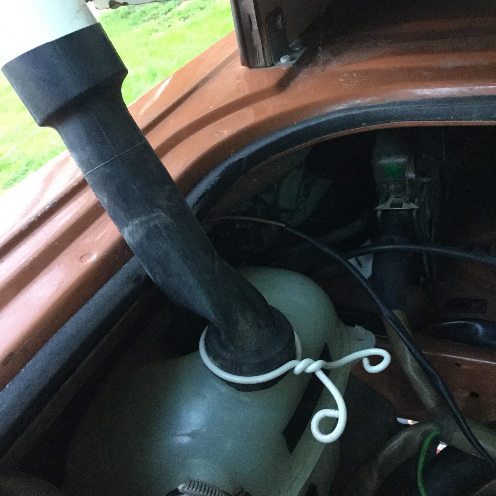

I wanted to add these pics of my Libby Bong adaptation. I read above about folks spilling, dumping and/or having to drain their bongs with difficulty so here s how mine works:
I guess the key is that your bong’s neck be made of 1 1/2 pipe I used PVC scraps i had. I think my inner tube was from a mt bike, probably 1.95 or something idk. Anyway i used a 3 inch diameter top half with a reducer to 1 1/2 so that it held plenty of antifreeze and had some pressure or head. A bigger diameter at the top also gives you a bigger target for pouring. The bicycle inner tube just stretches over the bong neck and then over the pressure tank cap’s threaded opening and the wire just improves the seal to the threads, but i usually still get a little drippage. The cool part is that you just twist the tube to retain the antifreeze in the bong once you’re done and the tube can then be stuffed in the antifreeze jug and returned to the jug with out too much mess.
However you may learn to store your Libby bong with the tube OFF the bong because the tube gets cut easily when banged around and you get a messier fill next time you want to use it. If you really want to get classy, buy a 3in PVC cap and store the tube and wires inside your bong. Enjoy

DJKeev ( Dave ),
I used your bug sprayer method and it worked flawlessly. Twice when my radiator was uphill ( couldn’t move the van ). Much simpler than any other method I saw. Thank you!
1. Get your bug/weed sprayer. Wash it out.
2. Fill sprayer with coolant. Fill pressure tank till it’s “full”
3. Take nozzle off sprayer hose, hook up to blue cap nipple. Pump.
4. Open radiator bleeder. Let bleed and walk back to pump sprayer a few times to keep pressure up. Close bleeder.
5. Uphook sprayer. Done.
