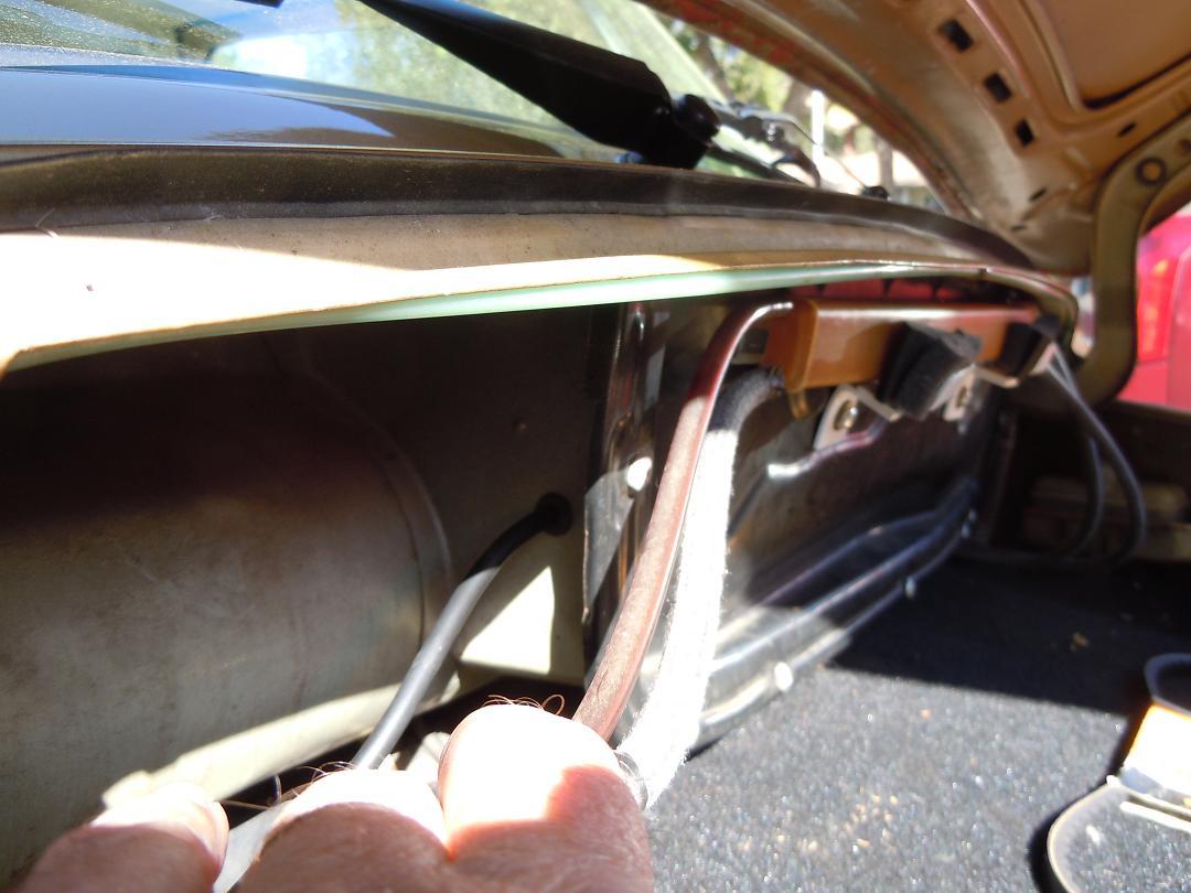

bikelash wrote:
I will try to find some pics but Joel did a write up on it. When you pull the washer stalk out some have a black wire that is attached to nothing.
If there is no black wire just look for the connection point at the same place as in the pic. It is simpler than it appears. When you pull the lever back it will energize that wire. Then use that to energize your pump. Been using a new for a couple of years now and it works great
BTW this pic is from Joel's write up.
Which wire would be the equivalent on the new stalk??

PostPosted: Thu Dec 24, 2015 3:39 pm    Post subject: Re: Windshield Washer '79 Super Beetle Reply with quote
