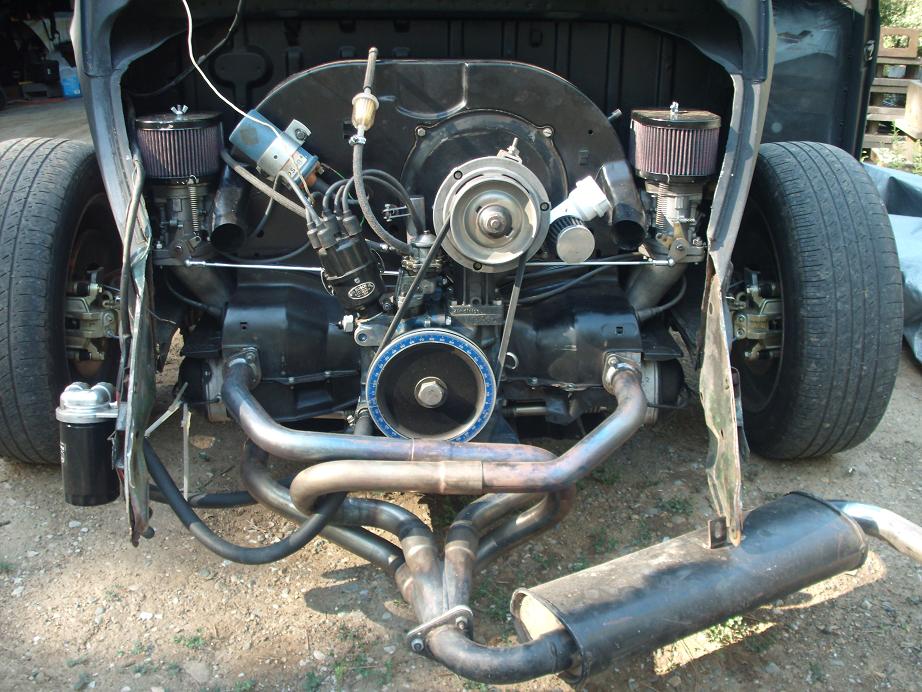

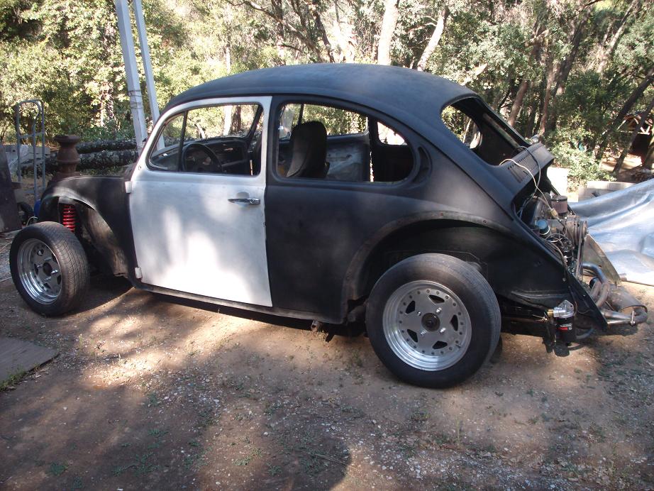

UPDATE
so now the engine is in my super beetle, 1.25 ratio rockers, manton chromoly pushrods, and CB merged 1.5" exhaust have all been added.
the thing just moves, I think part of that maybe the car but it is scary fast. (scary because there is nothing on the car) no windshield either!
