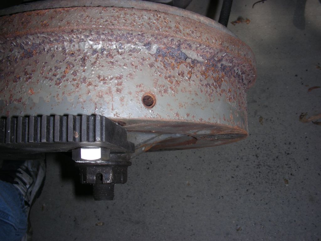

Yeah, the tube for the slinger is in the rim of the drum, and the hole goes all the way through the drum. Any oil that makes it that far gets slung onto the rim. Again, from the Gallery - this is of an early type 3 drum but it shows the slinger hole:

PostPosted: Tue Sep 02, 2008 12:23 pm    Post subject: Reply with quote
Thanks for the pics and replies! Maybe I'm thinking this through too much!! I have the holes in the drums for the clip to slide into...but where does the end of the tube go? It doesn't exit the drum, so the gear oil won't get onto the brake lining should there be a leak?
In the pictures (never thought of looking in the gallery, thanks!) it looks like the tube on the slinger just sits inside the brake drum?? Is this correct? Thanks!

Whenever I've put slingers into new drums, I've had to drill the exit hole for the slinger myself. I had to do it with the German drums I put on my 62 in the mid 1990s. (Then a few years later I put a later rear end in there that uses the weep-hole style... no more slingers)
Anyway, you wanted a pic, I'd seen one in the Gallery a while back, and here it is:

I figured it'd be easy too....but it doesn't want to line up...the hole in the new drum is alot smaller than the old drums. Is this a common problem with aftermarket stuff? I didn't want to start drilling on the new one without checking here. These are the good "german" ones....thanks!
