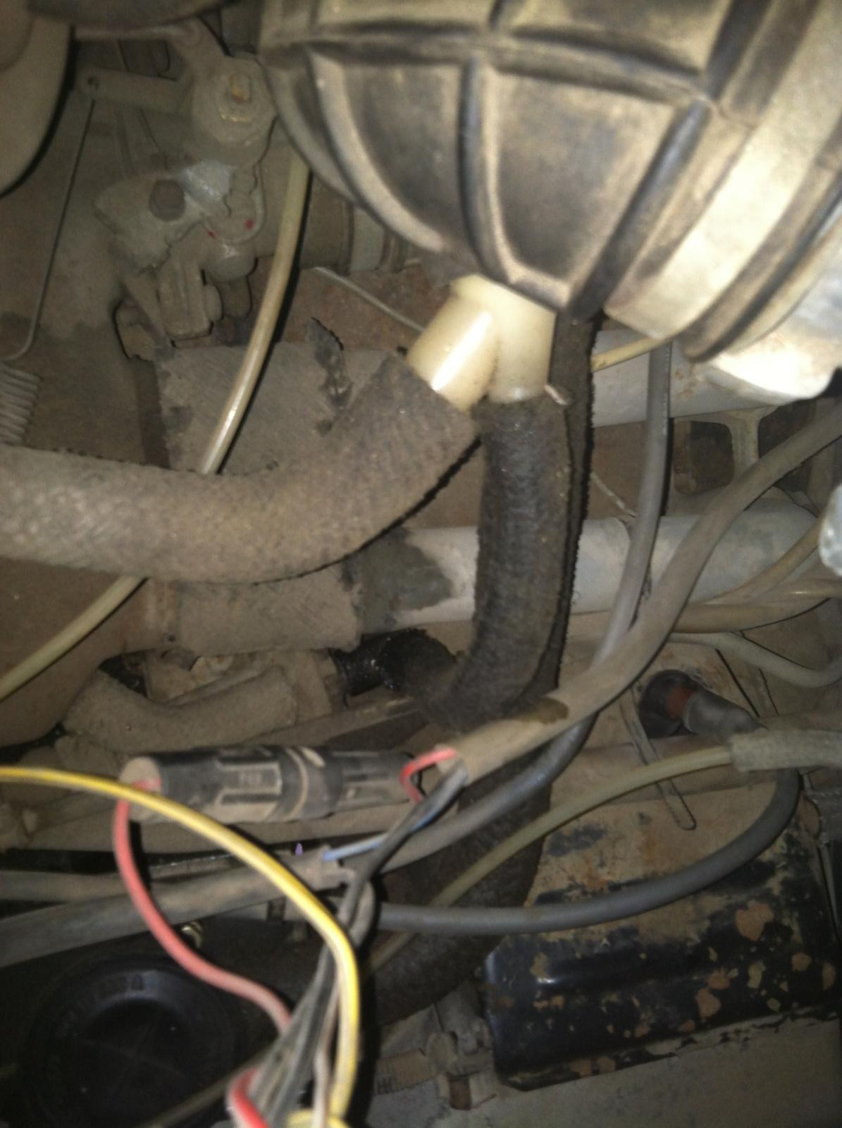

If that is indeed oil leaking there is some other problem to track down - I could be wrong but I doubt there should ever be anything other than air going through there.
Check the rubber elbow as well, it may be more to blame than the 13mm hose.

Im looking for the 13 mm ID hose that goes from the AAR to the Intake Plenium. Mine has succumn to age I believe, as its leaking some liquid (oil).
Bus idles a bit rough on cold start up and but once warmed after a minute or two is fine. Just want to fix the leaky hose. I noticed GS has them. http://www.germansupply.com/home/customer/product.php?productid=17684&cat=385&page=6
Curious if 1/2" fuel/vac hose would subside until my order would arrive from GS in the next 5-9 days most likely. Or a stateside vendor anyone can recommend, as I've found what seems to be the same hose through a Ferrari vendor online. http://www.italiancarparts.com/parts/250_275_330_365.html
Or is this a special molded hose? Maybe Samba user GeeBee has available or is producing?

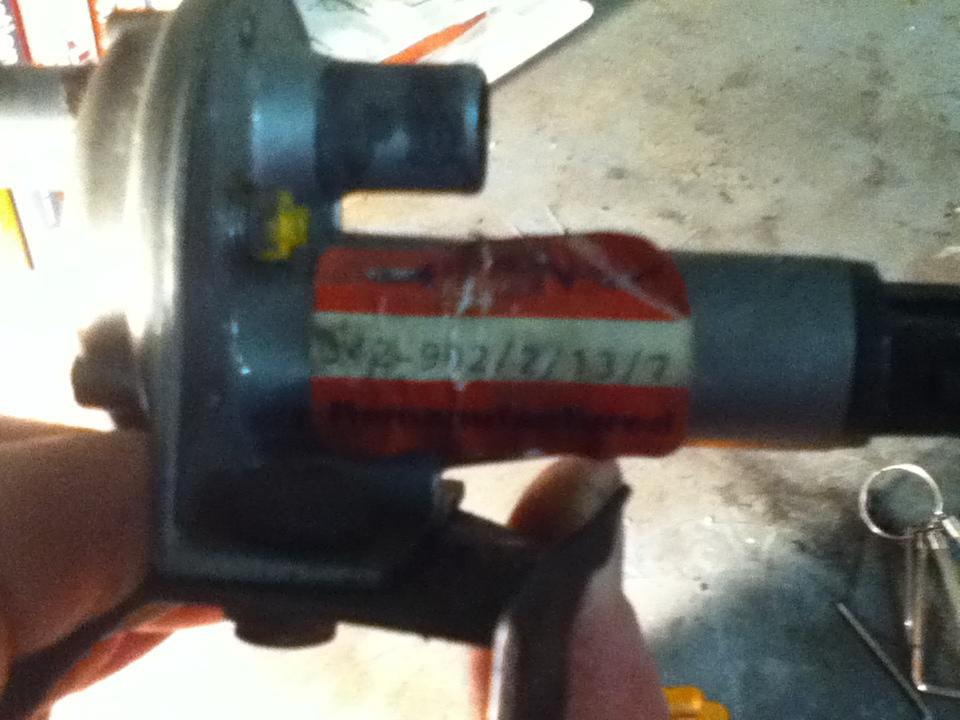

In 2007 I bought one of the remanufactured AARs from JC Whip-me. I don't know if I didn't see it back then or just that I didn't know any better, but the casing is all bent. Also the last number in the part number is scratched out so i wonder if this is a ...107 instead of a ...101. I don't want to put this back on after my rebuild. It looks like it will leak like a sieve.
