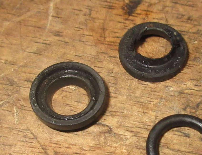

Hello all,
Dose anyone know where I can find 1 of these seals? I called Harwal and they are Out till July.
Thank you!

PostPosted: Thu Jul 23, 2015 9:02 am    Post subject: Reply with quote
Thrasher22 wrote:
Direct link to the product: http://harwal.com/product/15257
I can't find it listed on the Motion Industries website
EDIT: This looks like what we need.
http://www.ebay.com/itm/Metric-Oil-Shaft-Seal-7-x-...258324100f
Hmmm....looking at the cross section of that seal.....and it should work fine for a lightly loaded application like this.....but there are much better oil seal profiles that are less easily damaged. If course it begs the question of whether they have a better seal profile in the right size.....
Take a look here: http://www.alliedmetrics.com/seals/oil-seals/oil-seal-profiles.php
and scroll down styles TCG and SCG. Double lip, more vertical hold of the spring....and steel cap on the top side so you dont damage it pushing it in...and grip ridges around the sides.
Styles TBE and SBE may have a more precise fit if you can get them in the correct ID and OD. Allied Metrics is also a good company to shop seals from. Its where I had my caliper half seals made.
As far as the rubber type.....my earlier assessment for EPDM here is wrong. If you need better heat range than NBR...while EPDM would be awesome...its not good for a lot of aromatic hydrocarbons so any gasoline that got back to this or carb cleaner would not be good for EPDM. Use Viton.

PostPosted: Wed Jul 22, 2015 4:50 pm    Post subject: Reply with quote
Harwal (That's why I included the package in the photo, company ID and item description)
This office was in Vermont but they have others. You do need to purchase from a distributor.
In my case it was Motion Industries in Teterboro NJ.
Harwal will tell you who is nearby if you call them.
The OG VW/Audi product is single lipped too.
Fact is......
These are better, a single lip with a shaft tensioning spring.
Dave

PostPosted: Wed Jul 22, 2015 3:55 pm    Post subject: Throttle body shaft seals Reply with quote
Here you go, perfect fit!
Dave
Ghia
Vanagon
Beetle
