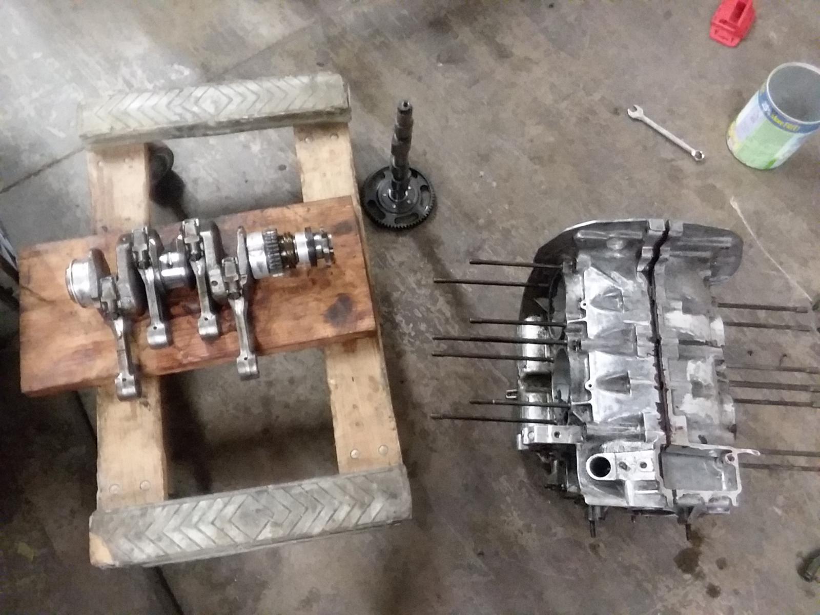

Here is my review of Rimco 2019.
I packaged a Type 4 case, a Type 4 crank, and a set of 2L rods and shipped to Rimco. I sent through USPS with insurance. Parts arrived at Rimco and they promptly inspected and called. I made arrangements with my customer to call in the payment to Don and get everything taken care of.
Don mentioned that the rods needed to be sent out to be reconditioned. OK.
We agreed on trying to polish the crank as it had a couple knicks in one of the journals, which did not work out, so the crank was sent off for grinding. OK.
Engine case needed oil galley plugs fixed and line bored. Don mentioned that he thought the case should be decked as well, so that was agreed to. Don also said that he would back cut a main bearing for the Type 4 case as .020" oversize with a standard thrust and a .010" crank isn't available. OK.
Machine work was completed to the tune of $1000 plus return shipping.
When the parts arrived, I noticed that a big chunk was literally broken off of the engine case. I called Rimco and was super duper polite, as I always am, and Don said that the case did not arrive broken when I shipped it, and he did not remember a piece being broken off of it. The missing piece was not in the return shipping box. Don agreed to send me a junk case half so I could have my buddy weld the missing piece back on.
I wanted to inspect the line bore and crank grind before messing with the welding, because after I read this review thread I noticed a couple people mentioning they had bad line bores. I opened up the box of main bearings and what do I see...a super squished main bearing. Then I tried to put the bearing that they back cut the thrust, onto the crankshaft, and it wouldn't fit. It had a flat spot from also getting squished. They charged $125 for the main bearings with the thrust cut.
After reading the reviews here, I decided to cut my losses with these guys and have my friend who is local weld the case and cut a main bearing for me. I had to order a complete new set of main bearings and pay to have the case welded and the thrust cut. Even though it was my friend I still pay for his work.
I was finally able to put the crankshaft in the case with the new main bearings and it spins smoothly.
The case is welded and the new bearing is fit, but the issue is that with a machine shop, you are expecting and paying for perfection. It literally is all that matters in machine work. It was quite obvious to me that the crankshaft was never fit to the engine case or the main bearings. If it was, then why are the main bearings all squished. I believe that Fat Performance bought RIMCO simply for the name and previous reputation of a good company. RIMCO as we used to know it does not exist anymore.
I speak the truth and don't make up stories. I wish I would have looked at this feedback thread first. I can't believe these guys build racing engines. Shocked
Engine upon teardown, note no case chip.
How I packaged the engine case, crank, and rods for shipping (socks not included).
Engine case returned to me with a piece missing.
Crooked oil galley plug.
Squished main bearing.
Backcut thrust bearing and squished main bearing (sharpie marks are mine)
Engine case with the repair piece welded on.
