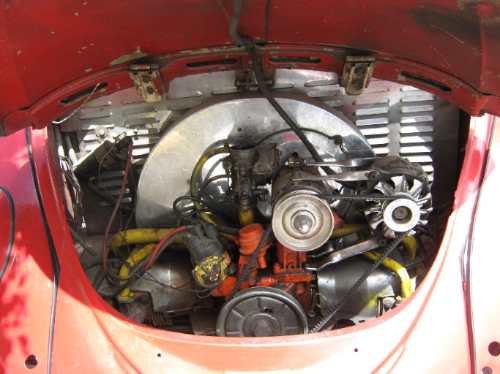

The only proper way to do it is with a double pulley. Both off one belt slips the belt and slows the fan causing overheating.

Now thats what i'm talking about. And in the perfect location, away from the turbo. i love it. Is that your car? if so, what did you make the mounts out of? in the pic it just looks like some bend flat bar, or angle iron. Did you just drill a hole in the generator, and tap it for the top mount? And yes, i'd prolly either buy, or make a double pulley for it.

68suprise wrote:
This does not work. The Fan just slips and the engine overheats. Mine was like that and it would overheat on the freeway everytime I drove it until I got rid of the second alternator.
I'd agree with that. tension / belt area on the fan pulley. Looks like you need a double pulley off the crank and space out the 2nd alt on a dedicated belt.

audp wrote:
take a look! maybe it helps
NICE!!!!

audp
Joined: August 19, 2008
Posts: 174
audp is offline
PostPosted: Sun Jul 05, 2009 5:55 pm    Post subject: Reply with quote
