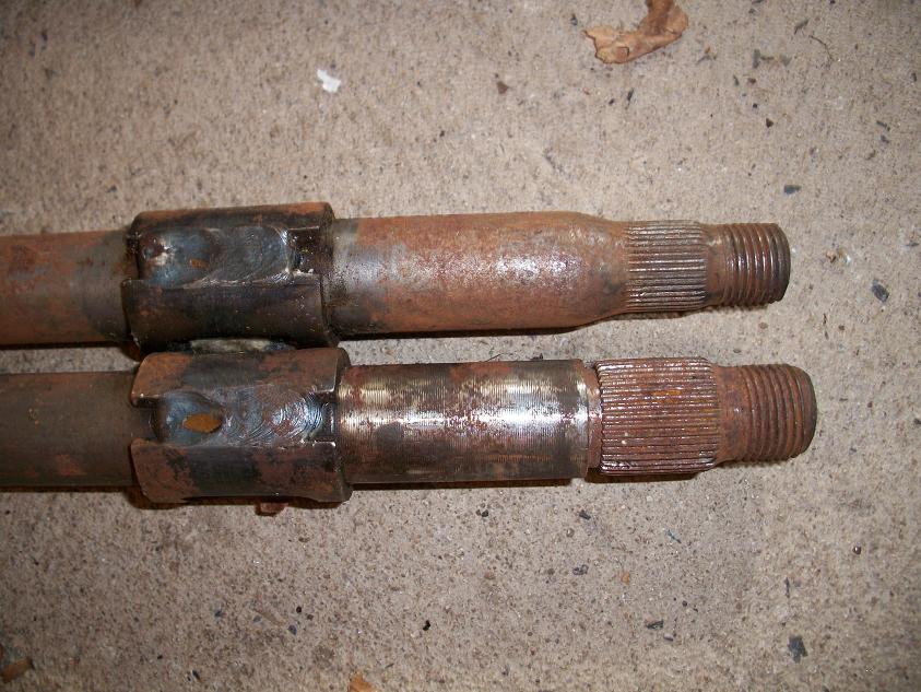

I'm missing this nut on my dune buggy and I think I have a Super Beetle column. Is it a 24mm fine thread or coarse thread?
24mm isn't the thread size, just the socket size and it depends on what year Super, that is only for 74 onwards, 71 to 73 its 27mm.
Which steering shaft do you have?

Airhead and bughaus say it's an 18mmx1.5
http://www.airheadparts.com/vintage-vw-parts/steering-wheel-br-complete-w-horn-ring-button
http://www.bughaus.com/steering12.htm

24mm and 27mm area the size of the socket needed to remove the late and early steering wheel nut. It is not the thread size. Sorry, but I don't know what size the thread is?
