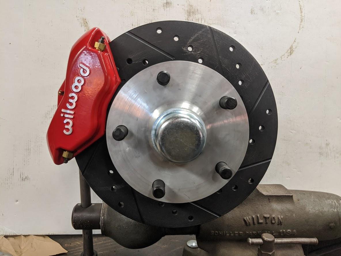

mr. warehouse wrote:
bally wrote:
What discs are people using with type 1 spindle conversions? Type 1 discs?
Many thanks,
Dave
Correct.
There are plenty of off-the-shelf 5x205 kits that work.
For 5x130 I use my own kit, as seen here.
Thanks Greg. I’m after 5x205 Smile
Many thanks,
Dave
Correct.

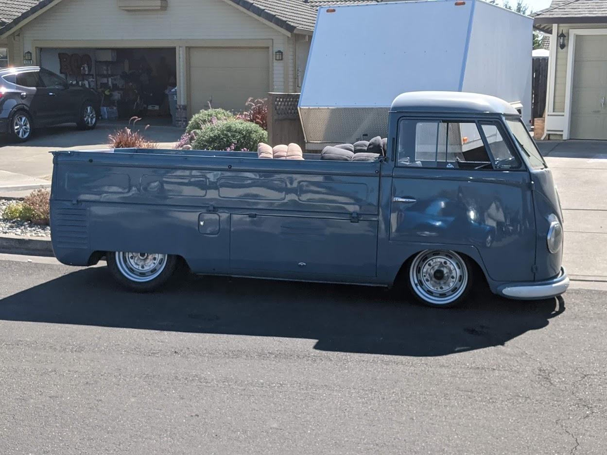

Last photos before tucking it away in storage and ultimately selling...
Dropped T1 spindles with a 4" narrowed/adjustable "stock" barndoor beam.
The new owner has since finished it off and has been cruising it with no issues. Plenty of photos and videos can be found on IG

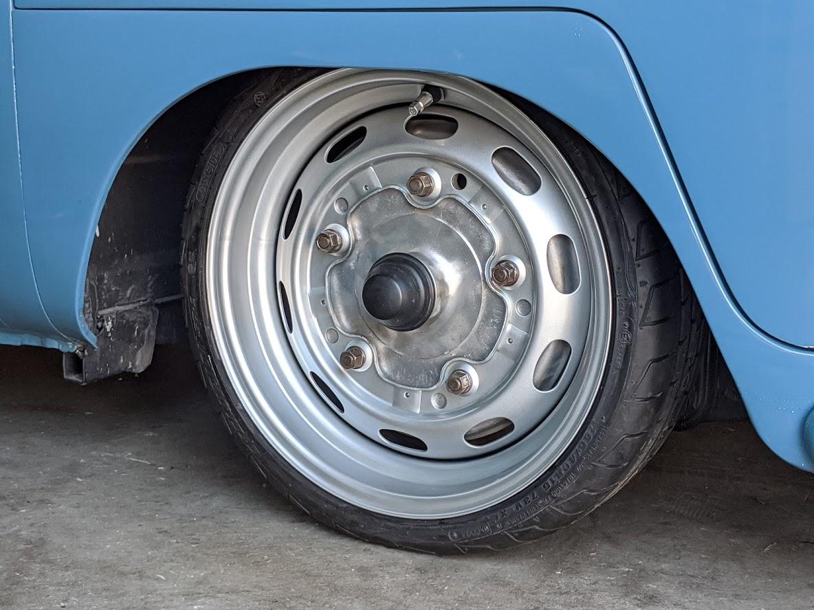

I run 356 spindles and brakes on this with a stock BD beam. No need to swap to a beetle beam.
Greg. Are those stock 15" rims with stock tyres? I like the look! I'm wondering if I can run stock 16s with stock tyres on a barndoor lowered with type 1 spindles and tubs? Has anyone done this? I'd live to see some pictures if they have please.
Cheers. Dave
They are stock 16's with stock tires in the rear and smaller tires in the front.
I've switched it up a bit since that photo. It's now running a hybrid dropped spinde setup with 16x5.5's and low profile radials.
I was waiting on tires when I took this photo
Fronts on, still tweaking the rear.
My point being, if you're looking for stock tires. I have the stock rears and smaller front that were on this single cab earlier. I may even have 4x stock sized tires available.
djfordmanjack wrote:
They are probably 4.50/4.75 -16 Also use them on hotrods and going to put on my Barndoor project. it is not easy to cope with the tall tires on a lowered bus.
Correct.

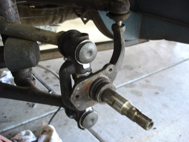

Terry Gaudet wrote:
Thanks for posting the picture Mr. Warehouse. It helps me see the mods.
So these will fit on 55-63 bus front beam arms?
They will work on early arms.
I have spindles ready to bolt on if you need/want a set that are done.
I have 356 and T1 beetle. Whichever suits your needs.
