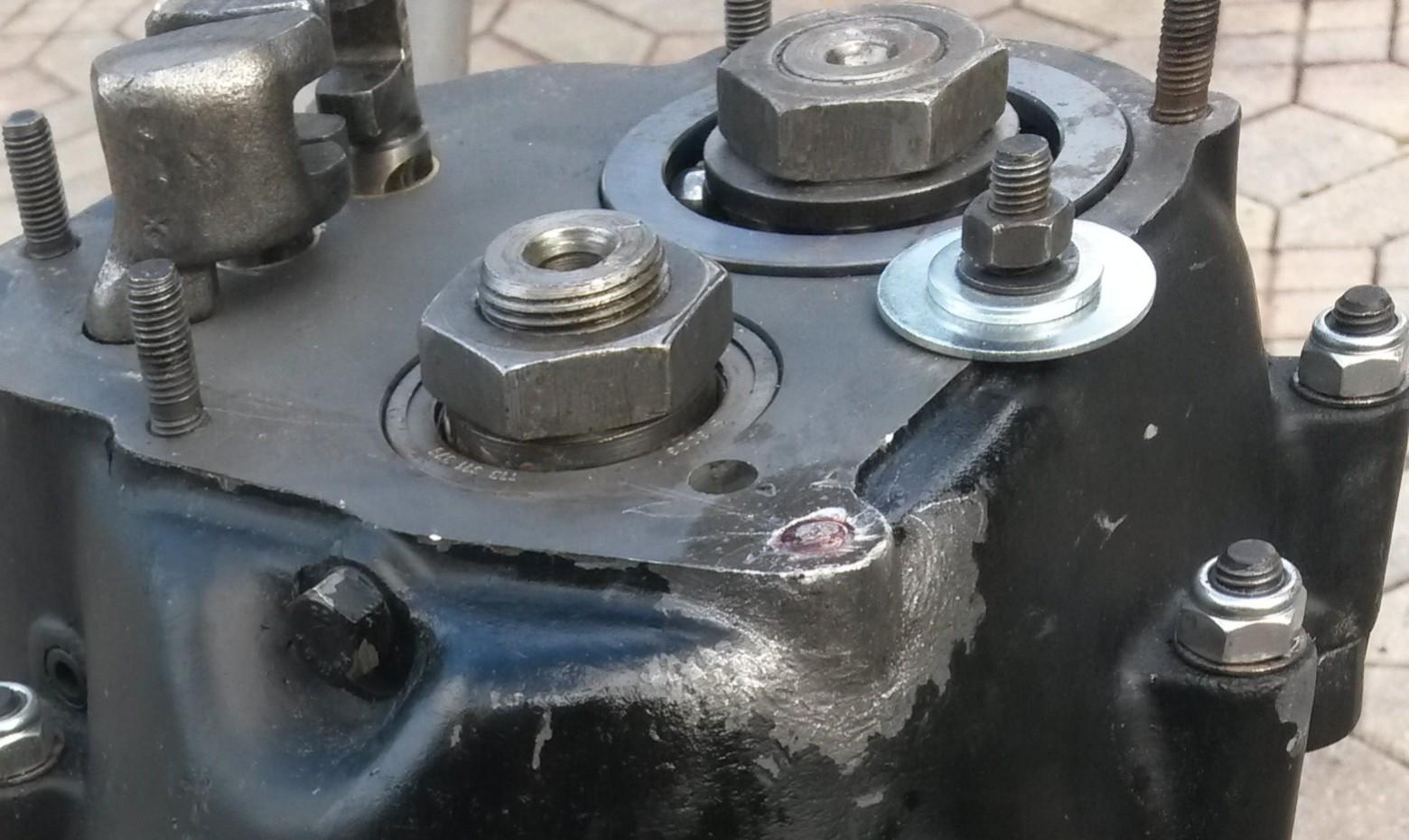

PostPosted: Fri Nov 22, 2024 6:49 pm    Post subject: Re: Removing broken studs & the ez-out conspiracy, epic Reply with quote
Gearbox arrived via UPS with broken nose cone stud, which I fix'd, thanks in no small way to this thread. Spent a week using Automatic Transmission Fluid mix'd with Acetone as a penitrant (note pink fluid on broken stud end), tapping with hammer (note chip'd off paint) while in hot Florida sun:
Built a jig to help guide drill concentrically, using tooth pick to make sure not to drill completely thru stud bottom, side view:
Looking down thru jig hole:
Almost got too carried away drilling wider & wider hole, became worried remaining sides would collapse or come out leaving part of stud behind; especially 'cuz the 1 extractor in the cheap set from Harbor Freight even close to a fit, bottom'd out without contacting. Extractor was too hard to hack saw or even dremmel; but brittle enough for me to clamp in vise, smack with sledge, break off its end, and leave me with success:

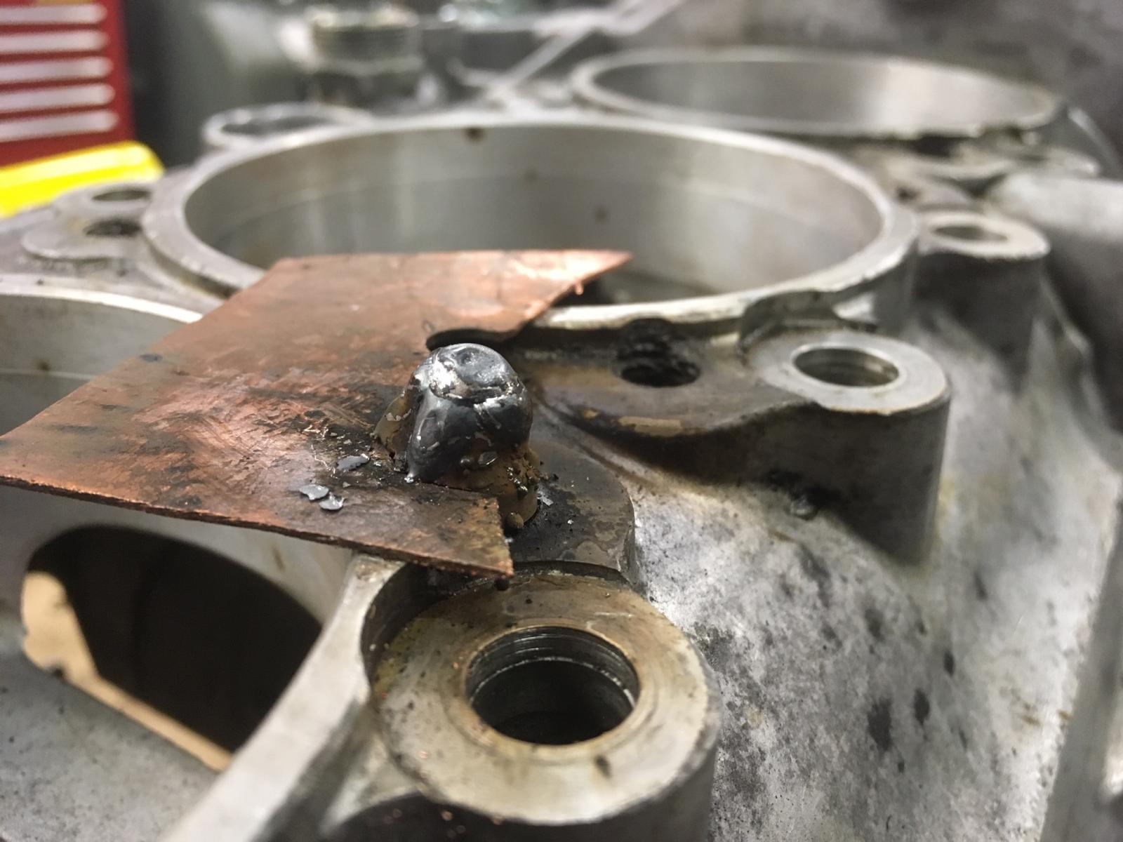

PostPosted: Fri Apr 02, 2021 2:50 am    Post subject: Re: Removing broken studs & the ez-out conspiracy, epic Reply with quote
TEN YEARS. not much has changed.
8mm and below, I still weld them up and "hot forge' it into a wing nut with vise-grips and that works most of the time.
Larger than 8mm broken bolts/studs it is usually necessary to weld something on the end to get enough grip.
I have a NEWish co-worker who has SOME interest in dabbling in the dark arts.
a few weeks ago I saw he was attempting the weld-a-nut idea.....and it broke off.
I explained that it works poorly because that design of joint results in a brittle stress point and ect ect....
I said sarcastically....
"maybe you should turn the nut 90 degrees and weld it on that way, it might work better"
AND IT DOES Shocked
Why the heck is that? yeah good question. I think it's because the root of the weld tends to be brittle.
Employing the weld-a-nut technique....normally, the root of the weld ends up the point of highest stress when you twist it....so it easily cracks off, BUT,
If you build it up a little, then introduce the nut while it's still glowing, and weld it on the wrong way, both sides......then the root of the weld is in the center, NOT a stress point.
And using a nut, which is hollow, tends to be a better thickness match than using a similarly sized solid object.
Seems to be 30-50% stronger on average.
So, NEW amendment.
weld-a-nut now FULLY endorsed, BUT you don't weld it on there the intuitive way, turn it 90 degrees Wink

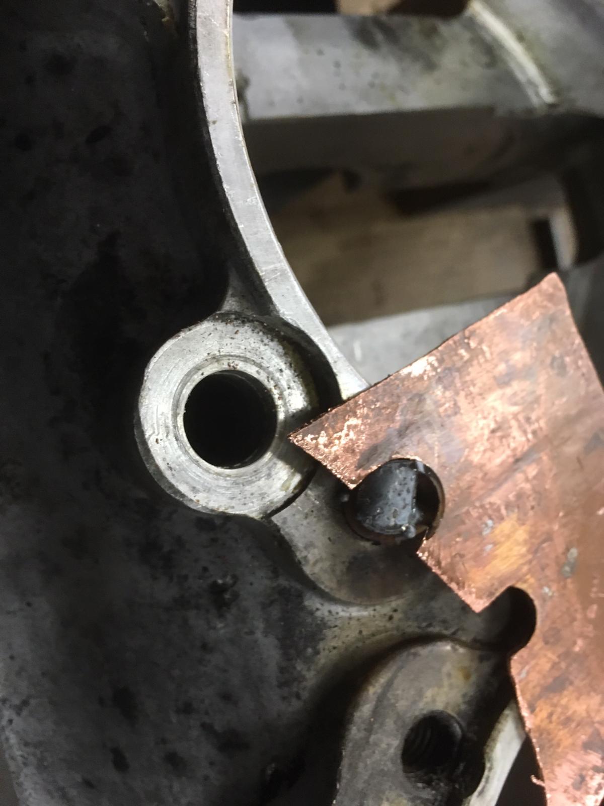

PostPosted: Thu May 16, 2019 9:47 pm    Post subject: Re: Removing broken studs & the ez-out conspiracy, epic Reply with quote
modok wrote:
I only get about 50% with weld a nut, but weld a blob is better, probably 75%
it breaks right at the weld, but the blob.....why, the blob has no sharp changes in section Wink
Improved blob welding technique has improved probability to over 90% for studs stuck in aluminum.
Weld-a-nut is OBSOLETE , BLOB far superior.
Why?
weld-a-nut has stresspoints, sharp change in section at the back side of the plug weld.
If I build up a blob, and clamp it with vise-grips while still glowing, I have FORGED a nut, and it's stronger. of course it takes some patience to build up a good size blob, have to weld, wait, weld so forth, but it sure saves on nuts.
Weld a blob, forge into nut,
THEN hit it with a hammer twice.
THEN try turning both directions. Get it to wiggle, then you've won.
For sizes larger than 10mm, the grip of the vise-grip on the blog may be not enough. My late friend mike had the idea, just weld the vise grips onto it. Laughing it worked

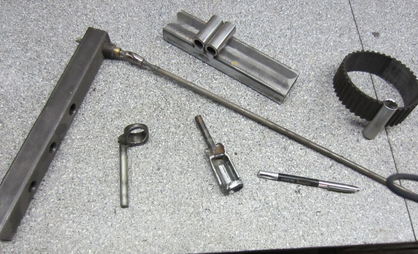

PostPosted: Tue Mar 14, 2017 7:40 pm    Post subject: Re: Removing broken studs & the ez-out conspiracy, epic Reply with quote
Modok - true that, a drill guide. The difference is that it is made from a large bolt, so that you can unthread the bolt/guide to see if you are centered and adjust accordingly, without disturbing the setup.

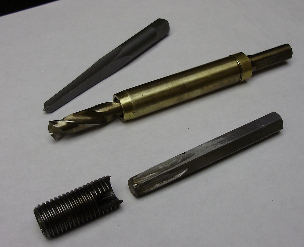

PostPosted: Tue Mar 14, 2017 4:41 pm    Post subject: Re: Removing broken studs & the ez-out conspiracy, epic Reply with quote
RolandD wrote:
please forgive me if this has been previously mentioned. It will be hard to explain.
On an exhaust stud, for example.
Crazy Roland
Gotcha. I'd call it "A drill guide"
For drilling exhaust studs on a chevy 4.3 or v8 I made this "drill guide". The drill has a u-joint because there was no space to do otherwise.
It worked, three times so far Very Happy

I love using start drive instead of ezouts for most situations. butt first!!! wack the crap out of the studs.if a nut is stuck if ypou can get a nut buster to it do that first. or if possiable a 1/16 drill drilled into the nut to releave a little pressure.Ive never seen anything vw that was hard so it should drill eazy...should. even vice grips used to squeezze the flats so the peneternt can seep in may help. Ive broken a very few ezouts. but Ive removed oh so many that were brought to me, dont know why somany people brought thier effed up stuff to me to fix....glad I no longer do it....I hope.
fes
Joined: January 26, 2011
Posts: 999
Location: Prince Edward Island
fes is offline
PostPosted: Sun Feb 12, 2017 1:29 pm    Post subject: Re: Removing broken studs & the ez-out conspiracy, epic Reply with quote
Yeah, I didn't have much faith in the EZ out either, ( had sheared one off with a broken exhaust stud on a head)
I figured if I had to apply much more than 40-50 foot pounds it wasn't going to turn out well...
Amazing how clean the rest of the threads are compared to the trouble first few.. Doesn't take much to ruin yer day does it? ..
And yes..these are very high tensile steel studs, cobalt bit is a must
