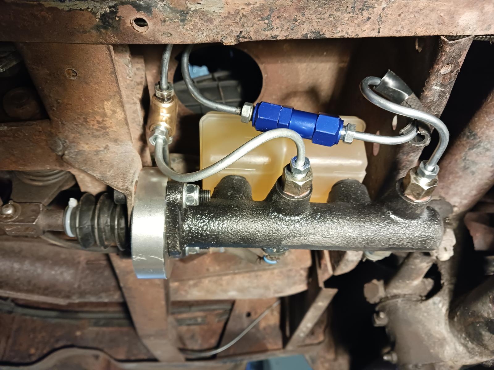

Yep. They do.

What does EMPI say?

This is the EMPI kit I put in my '58 bus. Kit came with the blue 2lb residual pressure valve.
67 only master cylinder, new.
Q1: Do I need to "gut" the front circuit valve, to the disc's?
Q2: is putting the blue RPV in the rear circuit redundant?
System seems to work fine as is, but could it be better dialed in?
Thanks All.

PostPosted: Mon Jul 26, 2021 6:33 pm    Post subject: Re: 67 master residual pressure valves with front discs? Reply with quote
vw nutter wrote:
any other options for a 67 master??
other than rebuilding an original, no.
only use the residual pressure valve in the rear circuit.
front discs/rear drums works wonderfully when everything is dialed in correctly.
drive your split.
