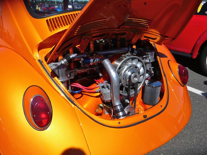

PostPosted: Sat Feb 02, 2013 9:25 am    Post subject: Reply with quote
@jhicken Thanks for those pics, that is exactly the color that I'm looking for. I went to talk to a PPG rep at T&H Paints in Carson City yesterday and he mixed me up a color to take home and spray on something to get an idea of what I picked.
Probably spray a motorcycle helmet to see what it is like. I'll post more pics as soon as I get it sprayed.

PostPosted: Fri Feb 01, 2013 10:43 am    Post subject: Reply with quote
Volkswagenaholic wrote:
Loving this build and the new color choice! How about adding a set of Airkewld wheels? They make some really awesome stuff.
I'd love to add a set of Airkewld Wheels, but for now that isn't in my budget. Those and disc brakes are definitely something that I plan to add in the future though.
Right now, I'm just going to use my stock 8 spoke's and powder coat the spokes orange, should look pretty good.
Update on the paint....$1800/Gallon. Looks like I'm going to find an alternate orange.
