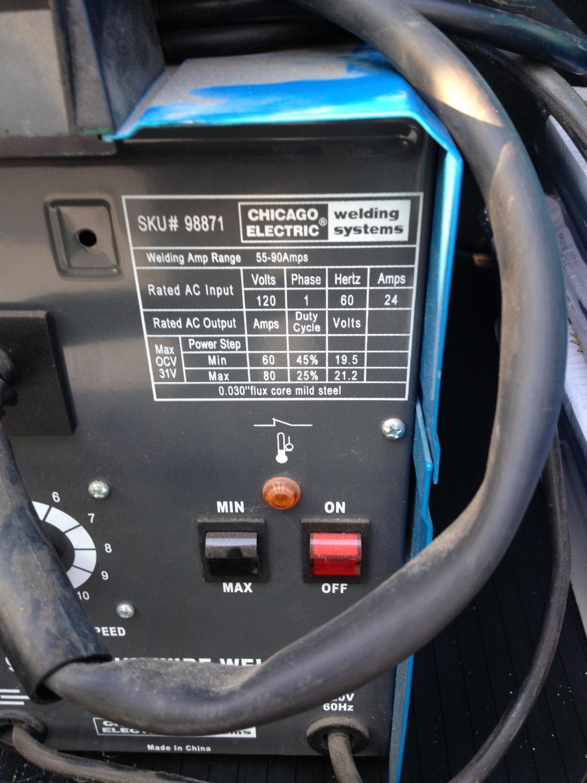

I hook my Brother up with a boat, he hooks me up with a welder and one of those auto darken helmets.
I know it's not the best equipment but, it should be good for the floors at least (for now)

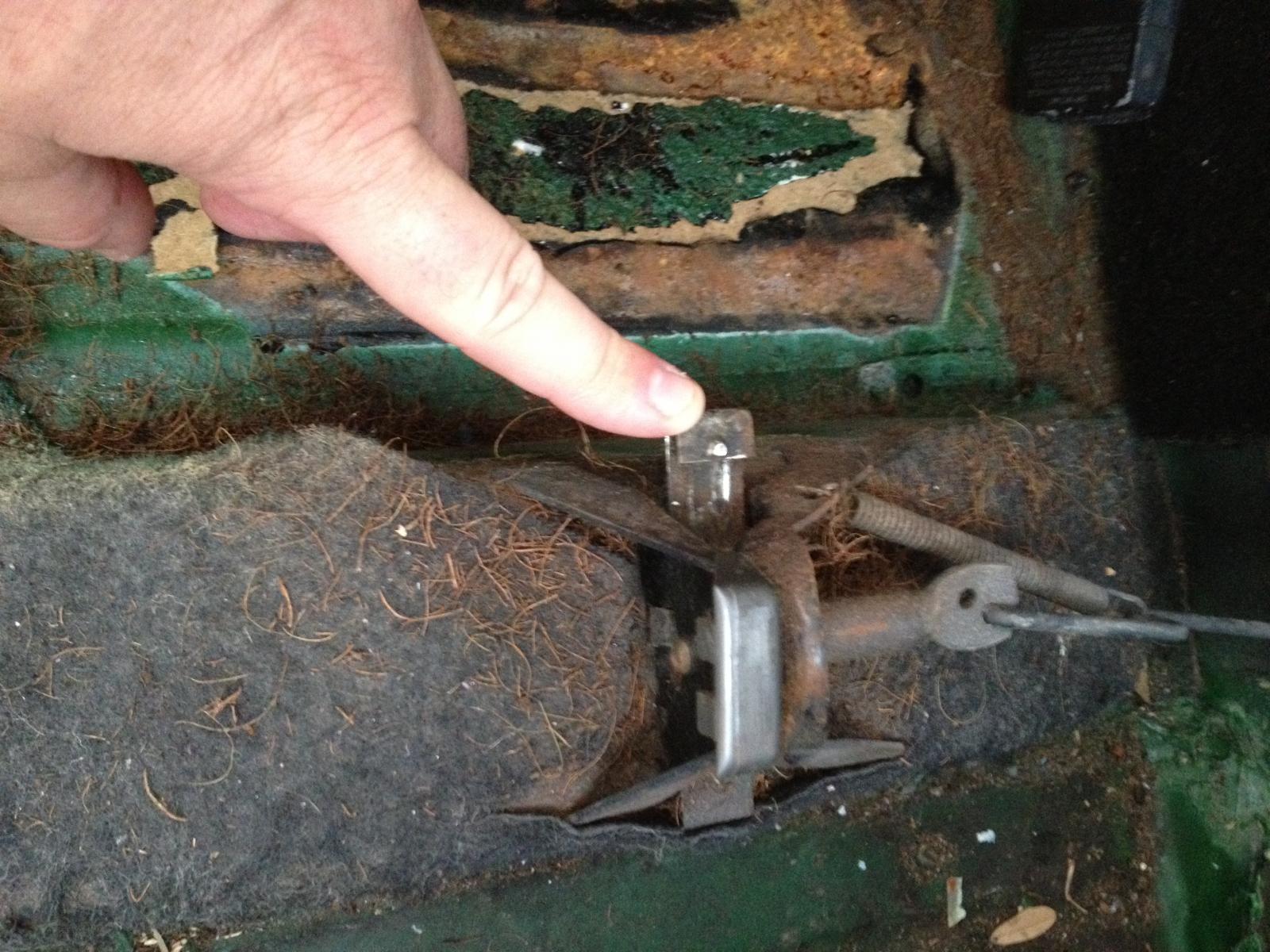

I had a heck of a time taking my front seats out so, I am hoping this helps.
I kept reading about a "tab"
I finally found it
This is a picture of the pass side (right side in America)
The picture is also kind of upside down so the tab is to the rear of the adjustment bolt.
In the picture, the top is the rear floor.
Here is how I did it.
1: Slide the front seat forward a little bit
2: Take off the spring that connects the seat frame to the slide adjuster thing
3: Take the rod that connects the slide adjuster handle to the pin off
4: Take the adjustment stop pin all the way out.
5: Slide the seat forward just a bit and, with some needle nose pliers, hold that little tab down and slide the seat back
6: Once the seat clears that little tab, the seat will slide all the way back and out of the car.

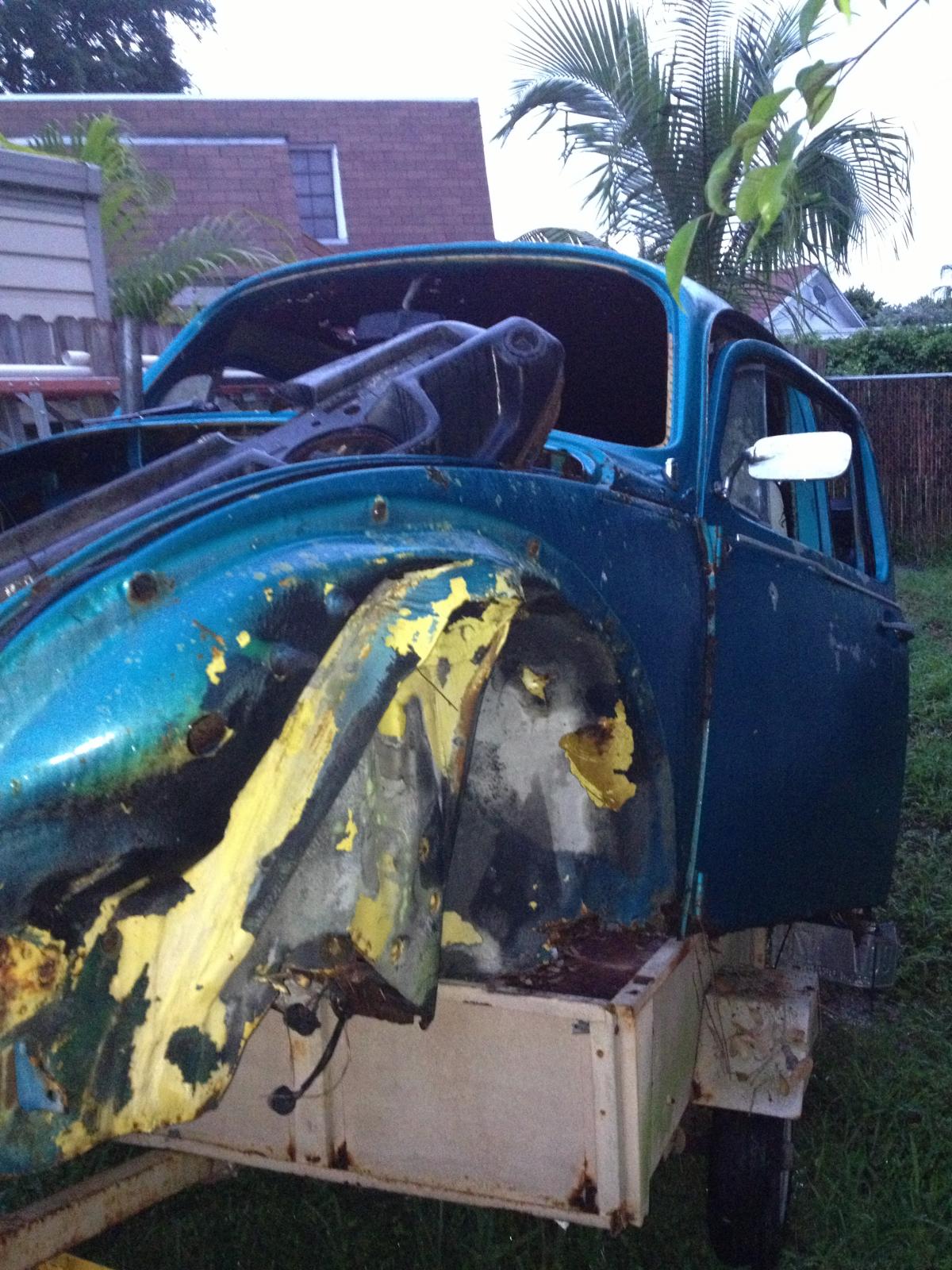

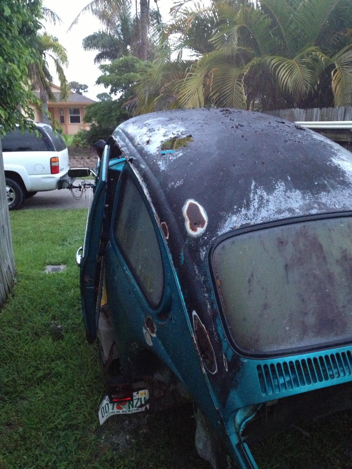

Volks Wagen wrote:
This is not negative towards you, I'm just shocked at the state of that - Jesus Christ! I've never seen a roof so badly savaged by tinworms. WTF happened to that? Hope the quarters are OK for you man. There's a few salvageable bits on there and with the wheels $75 brings you out ahead I'd say, but jeeeeez it's et by the bastards. Maybe you could sell the rest as art... like a big sieve?
Oh, the roof is destroyed.
I bought it for the rear quarters (which are almost perfect for some reason) and both doors are in really good shape.
there are also a few other little bits and pieces I can use.
Yeah, the rest will be sold for scrap.
From what I can tell, someone already cleared out the death foam.
As far as the roof goes, my best guess is that someone put a tarp on it to "protect" it and we all know how well water trapped against metal goes.

So, I got my parts car home last night. I will be taking off the rear quarters in the next few weeks and prepping them to install on my daily driver.
In addition, the front and rear window channels are rust free so I can use those also.
The guy tossed in a pair of (I think) centerlines and empi rims.

Yeah, still no new pictures but, I bought another 73 last night.
It is just a shell and in pretty rough shape but, the doors and, more importantly, the rear quarters are good so now I have parts so when I am ready to tackle the "death foam", I have good panels to weld back in.
$75.00 is totally worth it and, what I don't use will go to the recycle place.
Don't worry too much guys, I am not trashing a perfectly good body. The roof had a tree or something fall on it so it is destroyed and there is enough rust to make it not worth it.
