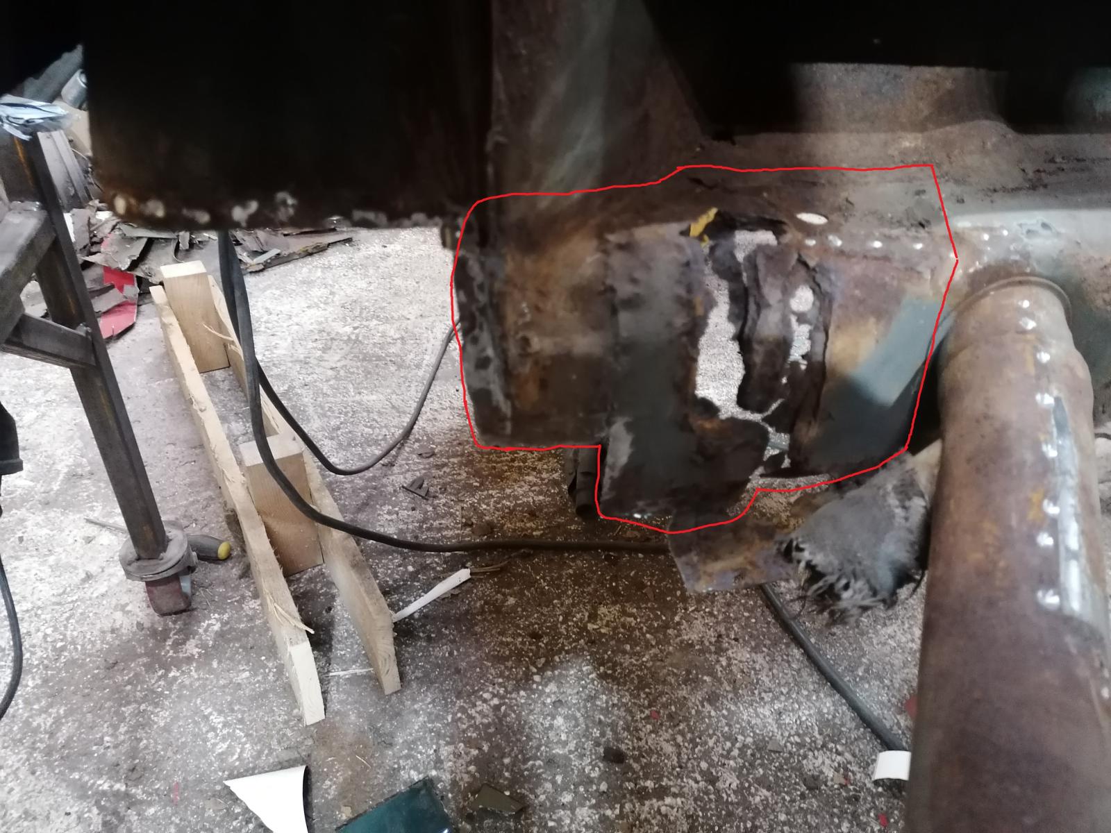

Beautiful job. I would like to do that too Smile I have a problem with making this section. Unfortunately, they are ready for expensive ..
I have this simple part

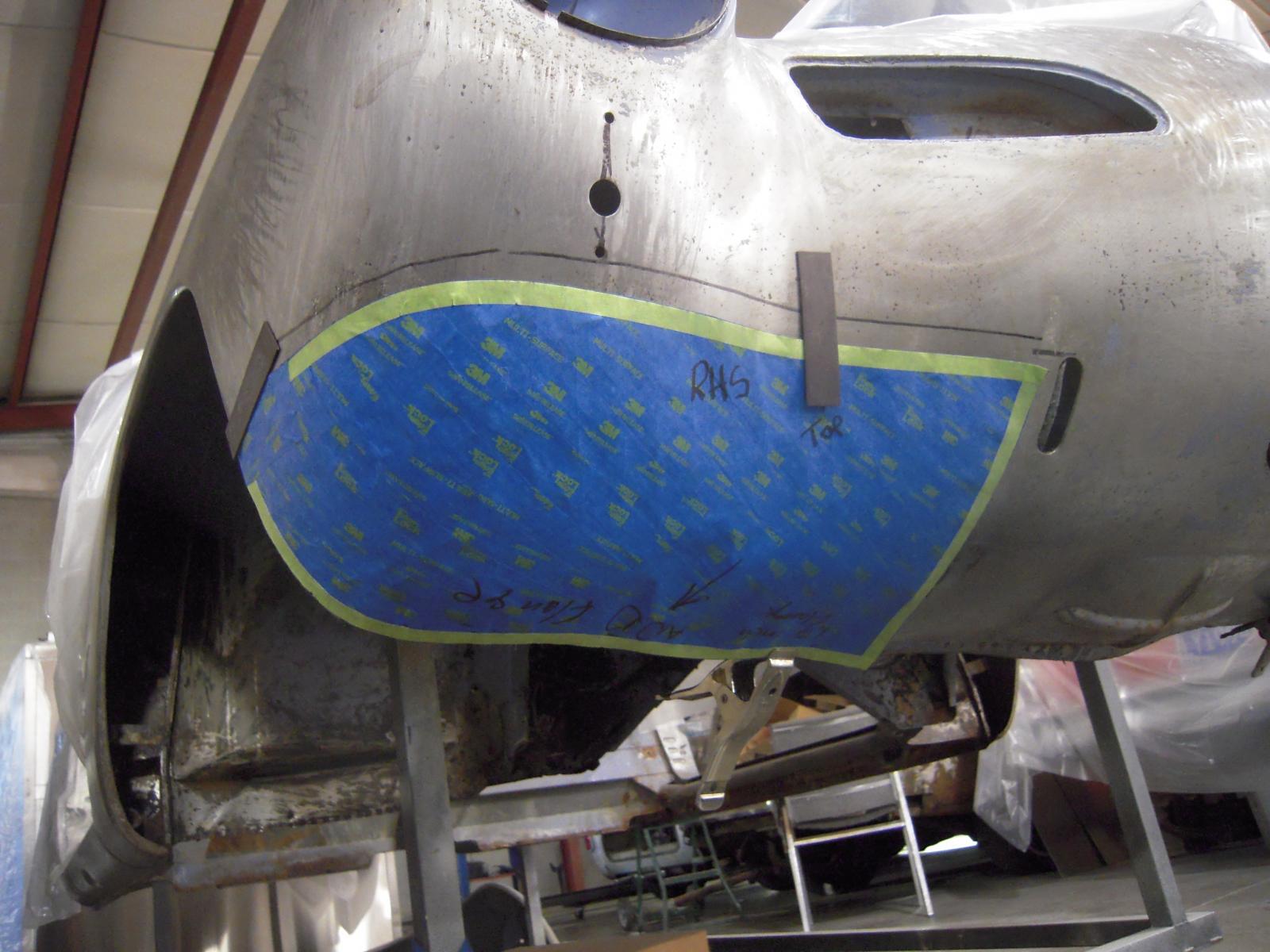

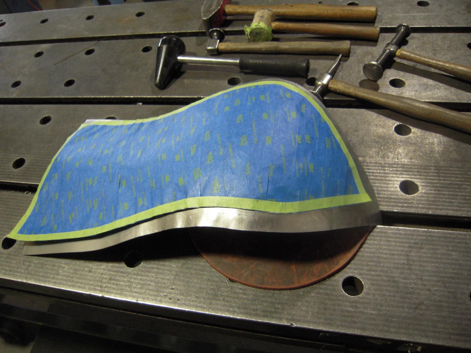

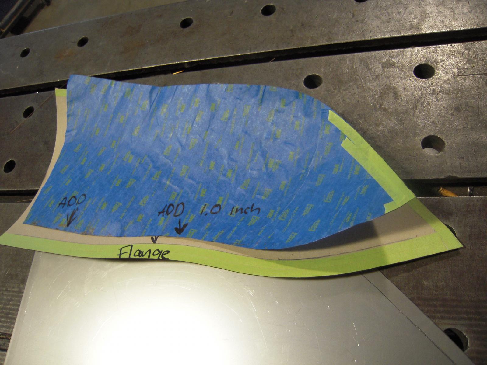

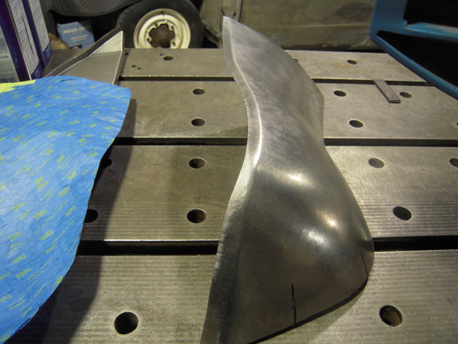

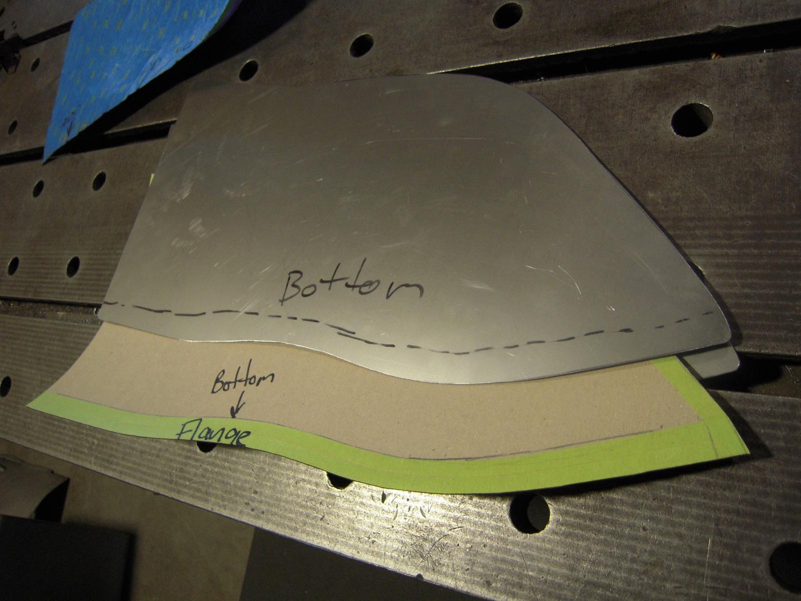

Its plain ole masking tape . First I spray area to copy with low tack contact adhesive. Then I lay down one layer of tape with sticky part of tape up , Then come back over with another layer of tape so that adhesive of tape down so its sticky to sticky of tape together and I change my pattern of overlapping in a cross direction. Hope that made since? LOL.
Shipping is NOT included in any of my products or parts. Just want to say thanks from GAB-FAB for any purchase!!

PostPosted: Wed Nov 18, 2015 12:43 pm    Post subject: Re: Karmann Ghia restoration and fabrication at GAB-FAB Reply with quote
Looks like painters tape.

danny gabbard wrote:
What is that blue material that holds the compound shape so well? Is it layers of some sort of tape or something else?
Air does not freeze. Air does not boil.

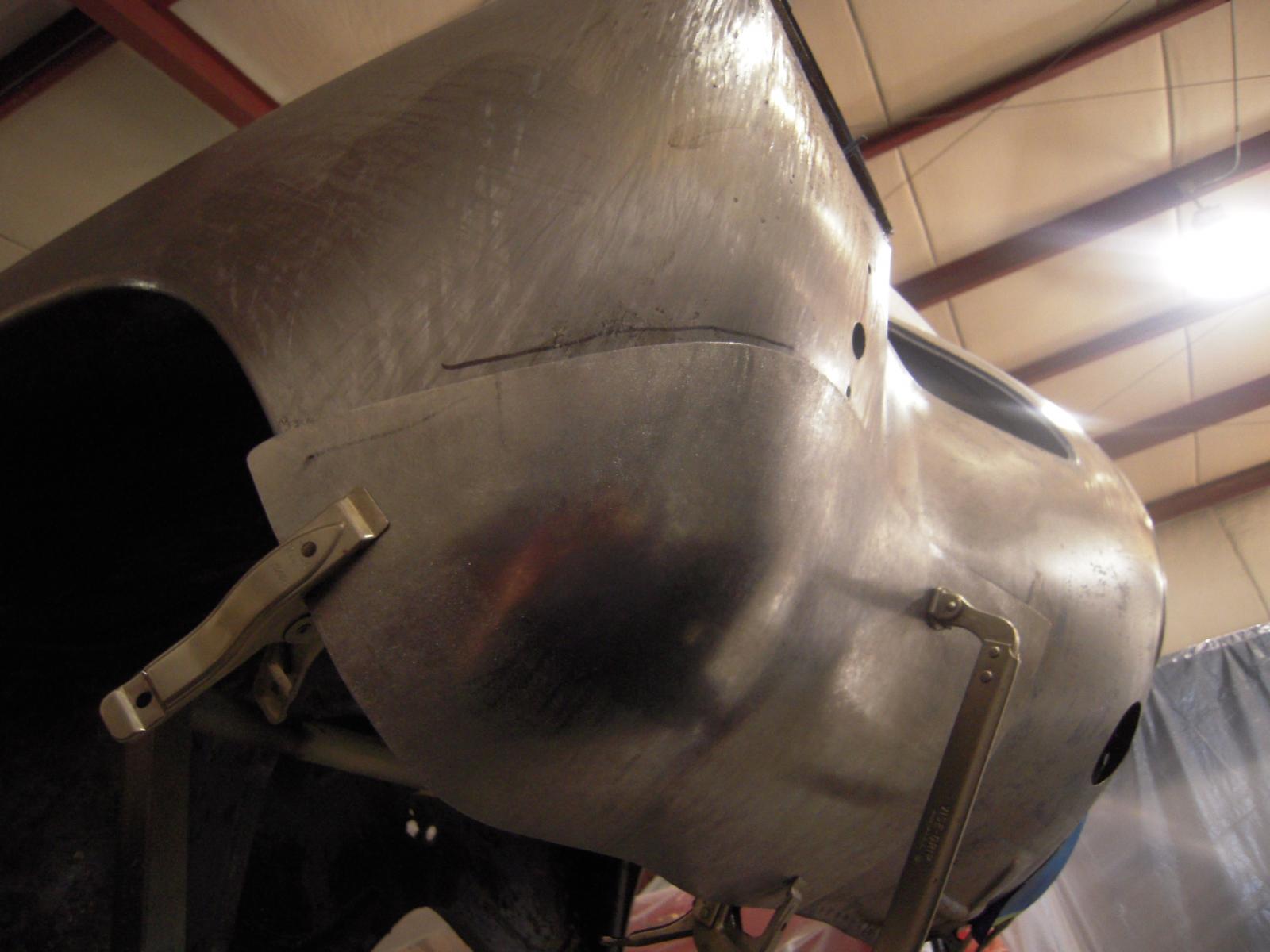

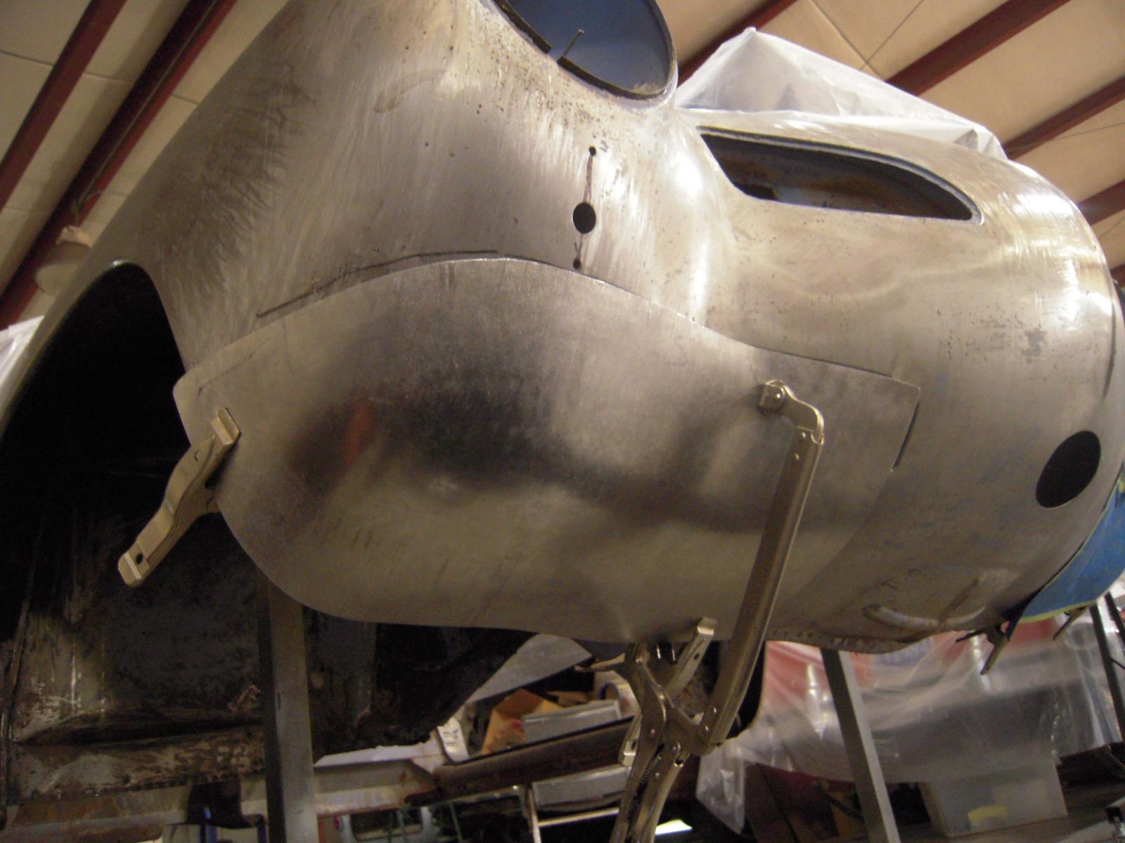

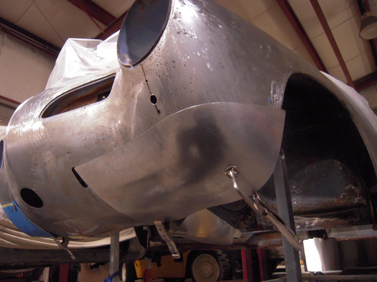

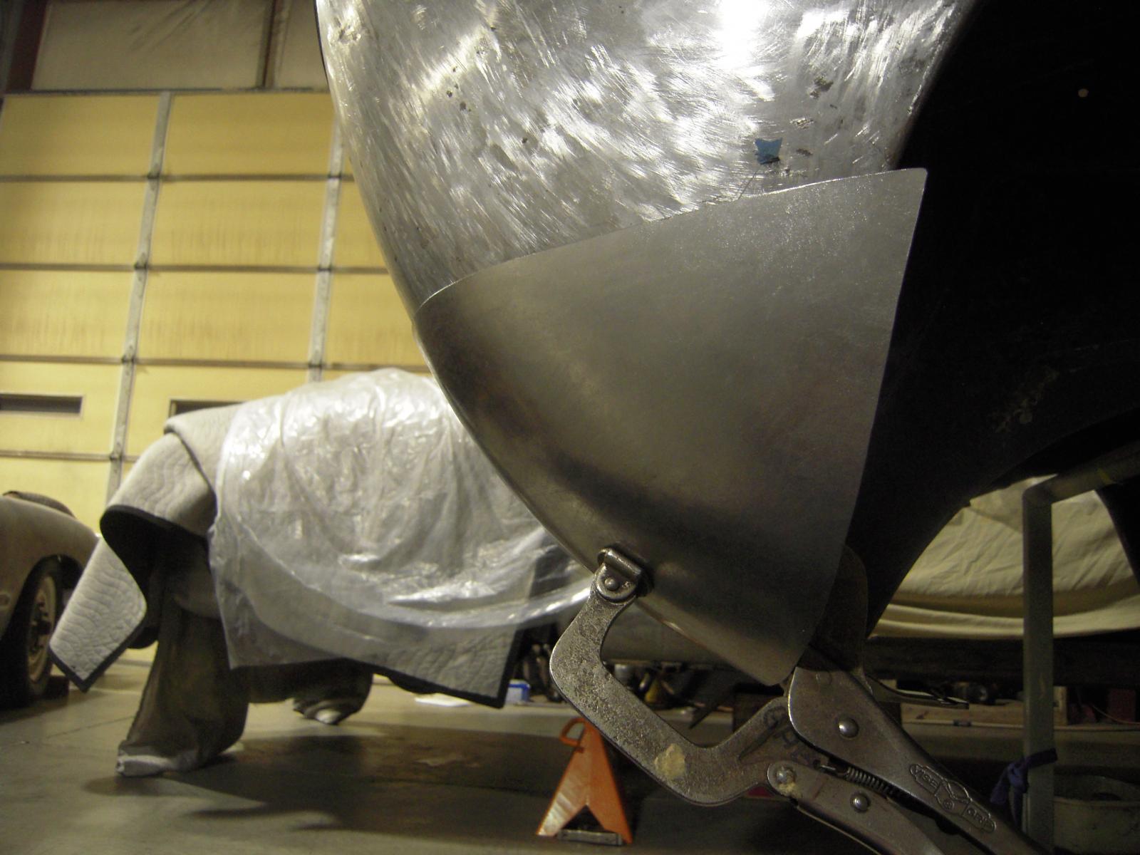

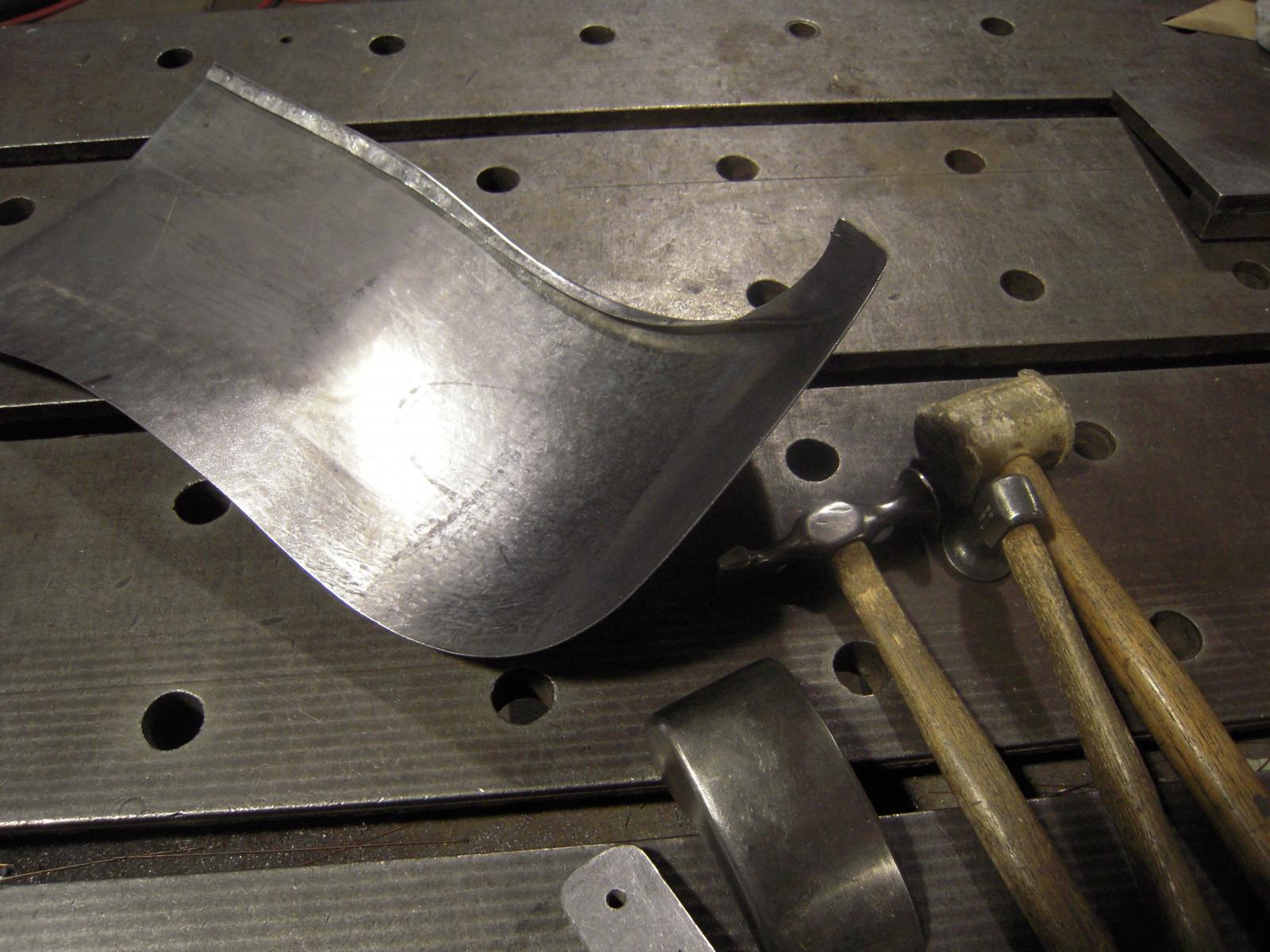

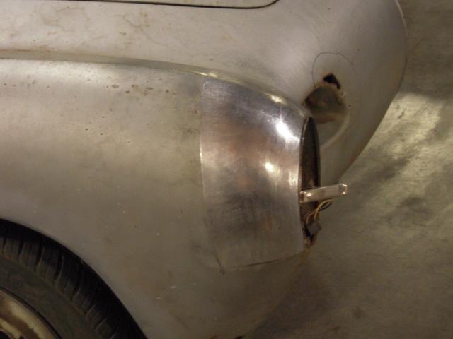

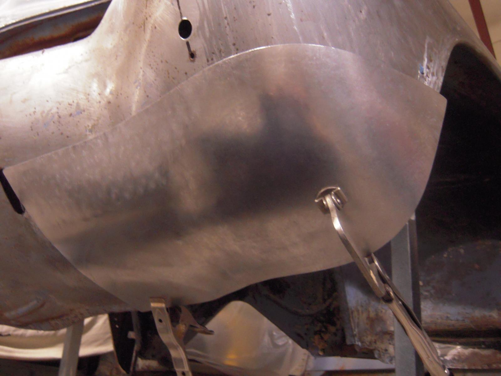

Couple patch panels I just finished for a customer . Started with a flexable pattern and transfered to flat piece of 20 gauge steel to shape . Used a rubber pad a E wheel and my Eckold , a power shrinker / stretcher.
Amazing work Danny! Any plans to start producing these lowlight headlight repair sections? I need a pair for my 58 coupe.
I would love to make them in some kind of production , But the dies would be insanely priced . So for now I can only make them by hand . But I did buy a 80 ton press and working on make'n the center section in the engine bay. And Thank You for the nice reply to the picture's
