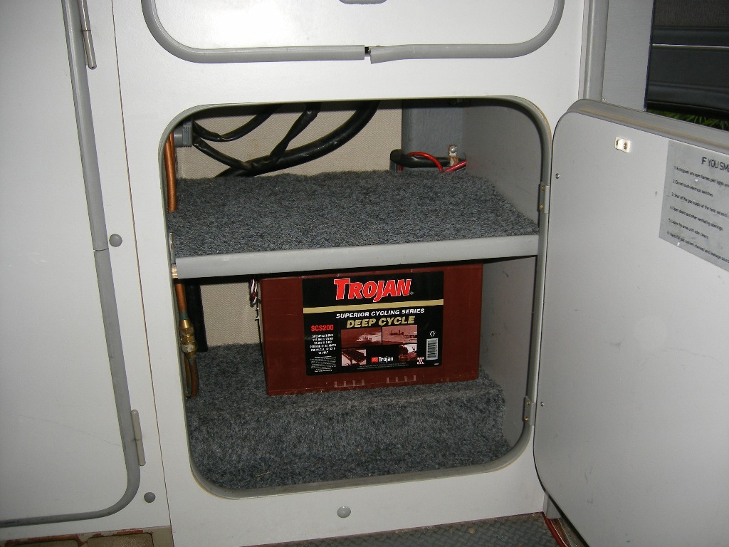

The Sun Xtender batteries seem quite expensive. I have a Trojan SCS200 under my sink. 115 amp/hrs rating for about $150.
http://www.trojanbattery.com/Products/SCS20012V.aspx
That does look like a great battery for the cost and capacity. I'm looking for a battery that won't need maintenance and so researching the AGM batteries.

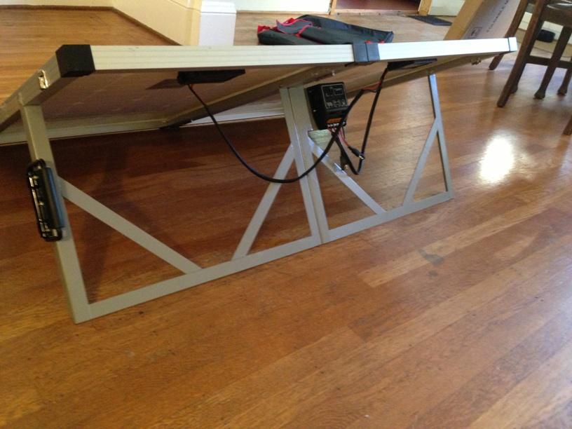

The literature says the panel assemblies are waterproof but the charge controller should be protected from splash and rain. It could be easily removed and remote mounted though. It might also be able to be remounted in a waterproof box in the same location. Climberjohn made a watertight relay box out of a Tupperware container in one post. You could probably do something similar.
Blue Bay Bus Just think I need to add to this. They do have water proof charge controllers but even with these they need air to move around them. Or they will get hot! When you charge batteries it will get warm when they are all charged up and it's day light all the solar has to go somewhere, HEAT out of the charge controller. So no I would not put it in a tupperware container. I have put then in a water tight box, but these controllers had fans, and I put holes in the box and then put filters over the holes. Very Happy

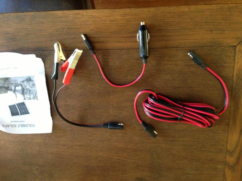

I dislike those clamps, they are going to be replaced by Anderson connectors or something similar in my setup.

Looks like a pretty decent set up. The panels look like they are Solar Cynergy, which is a Chinese company, but in my experience they seem to be pretty good.
I will say that you might want to add some better alligator clamps if you hook directly to the battery. Mine came with a set of the same ones you have and they aren't very good. Might be even better to set up a quick disconnect connection.

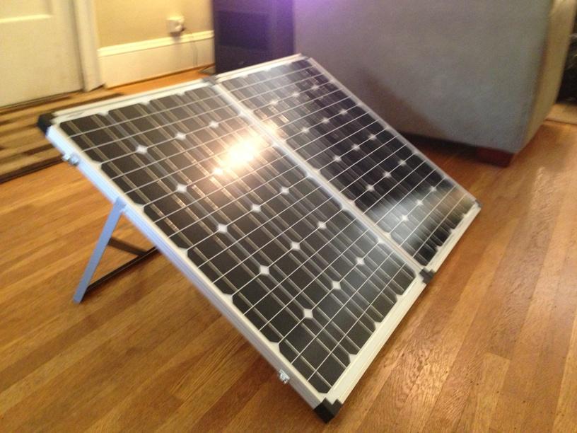

Wow, they are nicer than i thought they might be.
Thanks for the pix

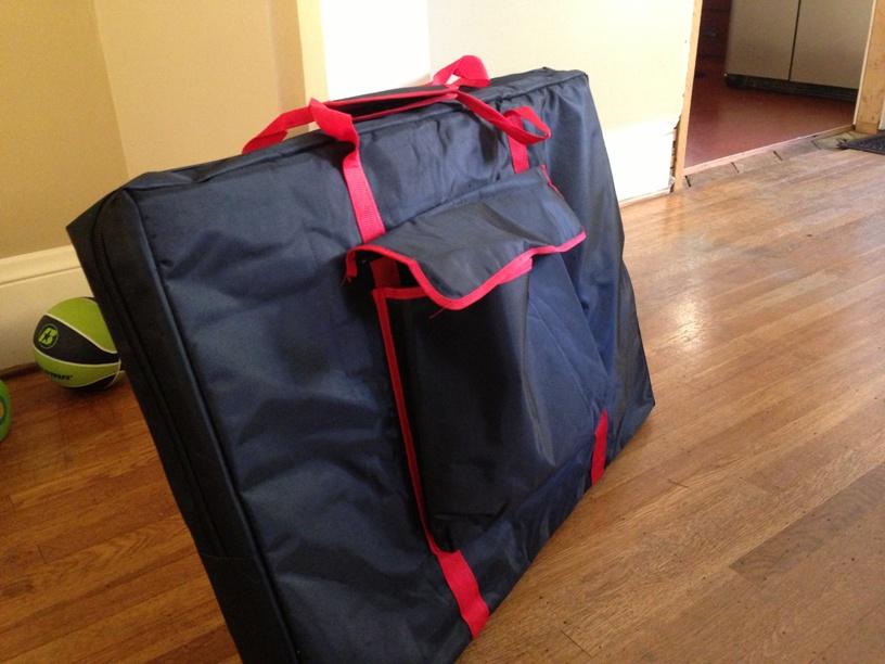

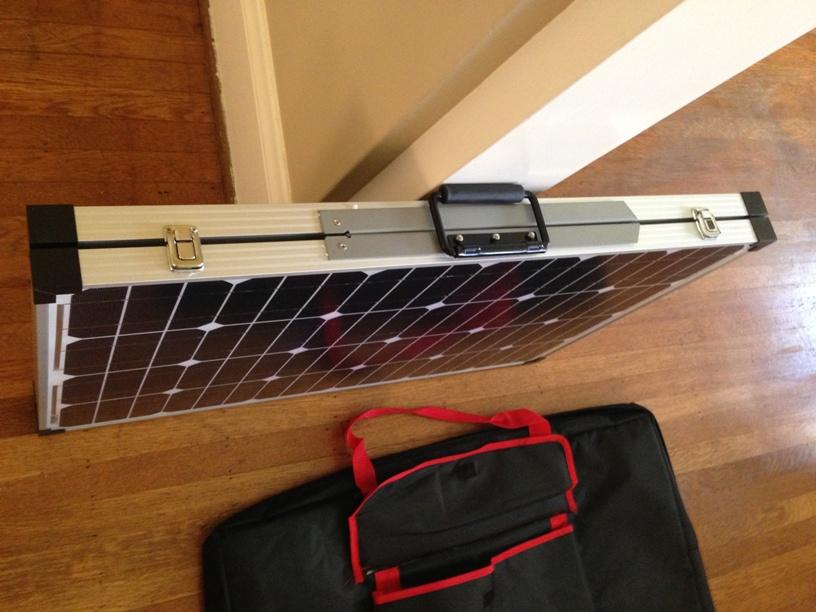

Yesterday I got the 120w Folding Solar Panel mentioned earlier in this thread. I was impressed with the quality and completeness of the package especially for the price. I have not tested the output yet, but here are the photos after unpacking.
Comes with a padded case.
Latches and spring loaded handle.
Pre-wired back of the panels.
Built in charge controller.
Integral stand.
Front of the panel.
Wiring accessories.
Size next to the van.
I will probably leave the charge controller mounted but disconnect the wires and connect them to my own system. It will be usefull to leave though in case anyone wants to borrow it or I have a different use other than the van. Overall I was pleased with the package I purchased and it arrived quickly. Get them before they sell out again!
http://www.solarblvd.com/Solar-Panels-&-System..._info.html
89 Westy 2.1 Auto
