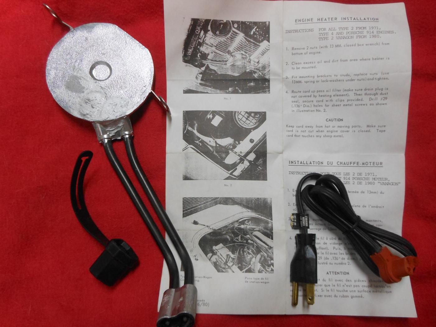

johnwan
Joined: February 14, 2010
Posts: 130
Location: Victoria
johnwan is offline
PostPosted: Fri Feb 06, 2015 2:45 pm    Post subject: Reply with quote
This is a 200watt VW type 4-engine oil heater made in Canada by Pryoil.
The instructions say to install on engine case studs and secure with new nuts.

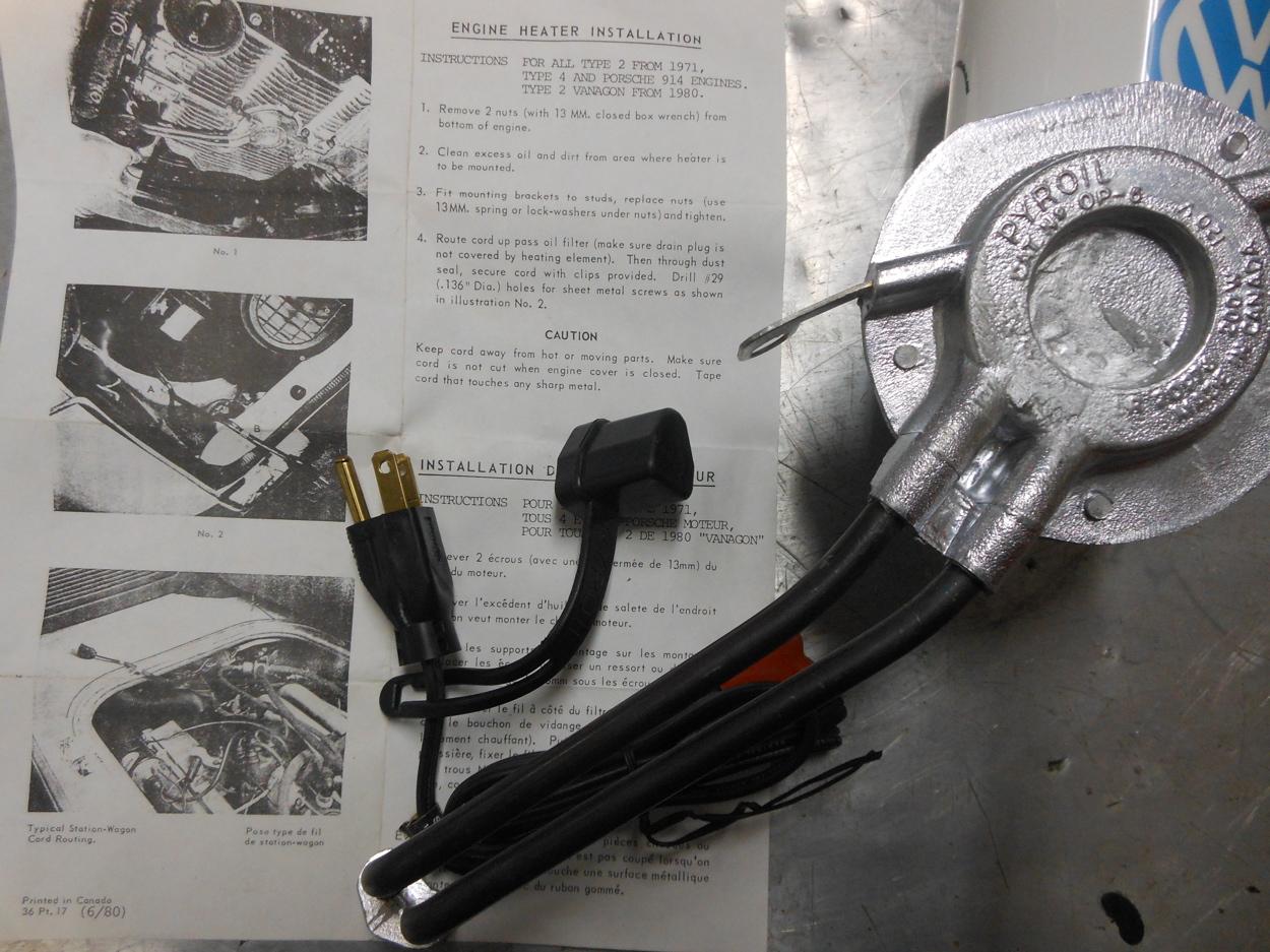

PostPosted: Fri Nov 28, 2014 8:20 pm    Post subject: Reply with quote
So I got to digging around in my parts and here's what I found. Top is a T4 heater made by Cdn Gen. Electric and bottom is a Pyroil heater made in Canada and sold through VW dealers. So if it gets really cold (unlikely here) I'm prepared.

I used sump heaters on several vw's back in the 60's and 70's. 6 volts, straight weight oil and -40`F were not a good mix. Never had one fail or get damaged. Oh yes and the in car 110 v heater was also standard equipment. Even the B2 would take a while to blow hot at -40. Don't miss that one bit.
