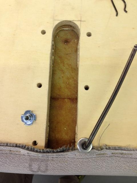

I finally got around to installing my headrests. I am very happy with the result.
I basically followed Kourt's instructions above. The only difference is that I elected to remove as few upholstery staples as possible on the top of the seat back, which did not allow me to install a "sacrificial" piece of plywood between the seat back and the foam padding. I drilled and cut very carefully without causing damage to the foam. I only removed upholstery staples at the top of the seat back at each backing plate location for the width of the plate.
I installed the backing plate machine screw nuts through the slot that I cut, slid them between the plywood and the foam, and imbedded them into the back of the plywood with my own machine screw. This embedded the nuts into the plywood and allowed me to install the plates with the supplied machine screws without access between the foam and the plywood seat back.
I also decided not to cut the plywood seat back deep enough to allow the head rests to retract all the way. I was worried that cutting the seat back that deep would weaken it too much. The headrests only retract as far as the picture above, but I am happy with that outcome.
[/img]

PostPosted: Thu Jun 18, 2015 4:07 pm    Post subject: Reply with quote
Howdy all,
I just finished this kit install. Here are my notes:
-the Vanagon rear seat back can be easily removed; simply remove the rear cushion, unscrew the two large exposed screws at the rear base of the seat back, pull the vinyl (with velcro backing) to expose the remaining five screws on each side, and remove those screws. Pull the seat back out and put it on your workbench.
-using a small seal pick or hook, remove the staples on the bottom of the seat back holding the vinyl in place.
-roll the vinyl up and remove the staples holding the vinyl to the top of the seat back.
-my goal was to remove as little upholstery as possible. I measured and marked my headrest plates on the exposed plywood. I believe the headrest legs are 9.5" apart, and you'll need to center them in the cushioned seat for which each headrest is assigned.
-I then slid a 3/4" sheet of plywood in between the seat back plywood and the foam. This small piece of plywood is a sacrificial piece of wood to accept the overruns of the hole saw, circular saw, and drill.
-once you are confident you have the openings marked properly, use a hole saw to cut the bottom end of the headrest channels, making sure to keep the sacrificial wood below your operations.
-I used compressed air to blow out all sawdust and wood waste while working.
-use a circular saw or shallow-run jigsaw to cut the edges of the channels from the top of the seat back plywood to the holes you just cut.
-use a chisel to remove any excess wood to make the channel clean.
-test fit the steel anchor plates--they should fit snug, with room for the pointed tip of the tube sleeves to come to rest at the bottom of the channel.
-drill holes for the anchor plate fasteners, stage the fasteners, and install the plates.
-double check that the plates are on 9.5" centers for each seat position.
-clean everything thoroughly with compressed air.
-roll the vinyl back into place and staple with a hand stapler (something heavier than your normal office stapler will be required)
-find the tops of the channels and cut small holes with snips; slip the tube sleeves into place; test fit your headrests.
-roll the rest of the vinyl down to the base of the seat back and staple it in place.
-reinstall the seat back and install your headrests. You're done.
The project took me about three hours.
