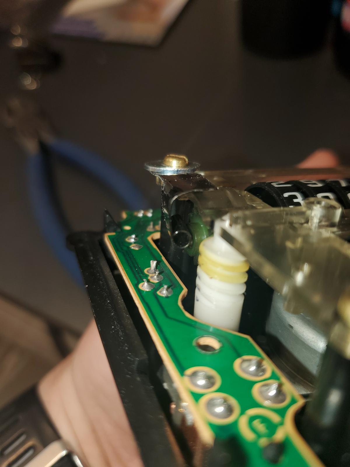

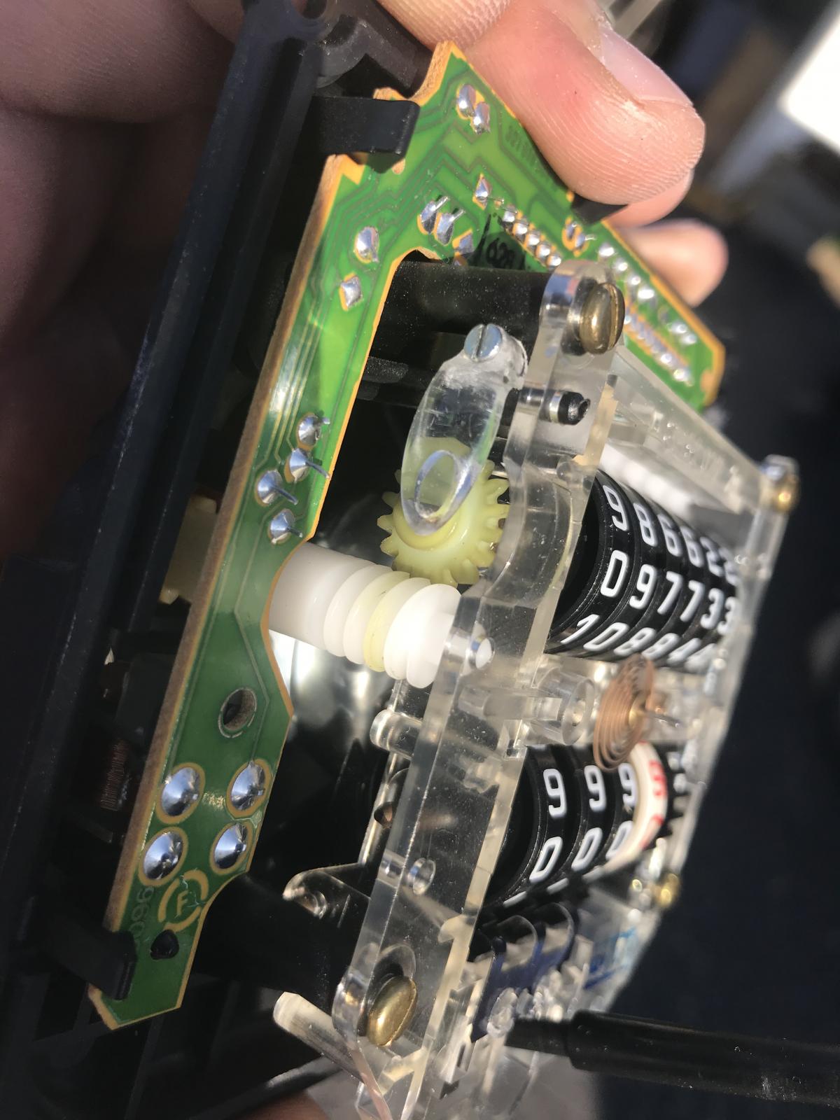

PostPosted: Wed Mar 31, 2021 2:25 pm    Post subject: Re: 11cent odometer fix Reply with quote
First post since I got back into the Westfalia life 3 weeks ago. Probably could have chronicled my trip home from Portland, OR to Indianapolis with the new Westy, but alas.
Because the eBay seller of this fine automobile was less than honest, I ended up with a van with (among multiple other things, of course) a non-operational odometer.
Anyway, throwing my hat in the ring with this odometer 'hack' and found a slightly more 'stable' bracket (hopefully) utilizing a 'command hook' bought at any walmart/hardware store/home good or office supply store.
My first idea was to use this style hook that the previous owner of my Westy had stuck to one of the cabinets
but i found it was severely lacking in 'support' to attach it to the main housing of the odometer.
i was RIGHT at the point of applying epoxy to it when i had a second thought about PERMANENTLY attaching what is essentially a 'ham & egg' repair to my new friend.
I decided to look at other options and found a hook that the wife had stashed away in a junk drawer
and I got an idea for a mo' betta bracket as seen earlier in this thread
It's lexan plastic and extremely tough for the size/stature...about 10-15 minutes of tedious sanding/test-fitting after I had cut it from the main hook backing, and it was really starting to look like something useable. I sanded both the area that will be making contact with the housing, as well as the area on the top of the 'bracket' so the screw would sit flat on top and not cause any odd torsion issues, and would also have a nice direct line of pressure around the attachment point so it didn't shift in the mounting location.
I utilized one of my 'spare' curtain rod track screws because it's (almost) the perfect length and had just enough bite.
Drilled out the end of the bracket with what I believe ended up being a 3/32" drill bit, and screwed the bracket to the housing. The screw was touching the housing when i put it in all the way, so I took it back out and ground down the tip (just the tip, hah).
And viola!
Ham and egg odometer operation was a success!
Onto the next project...but hopefully minimizing the ham and egg approach moving forward. But when it came down to trying this or spending $225 on a speedo rebuild, I opted to give it a whirl.

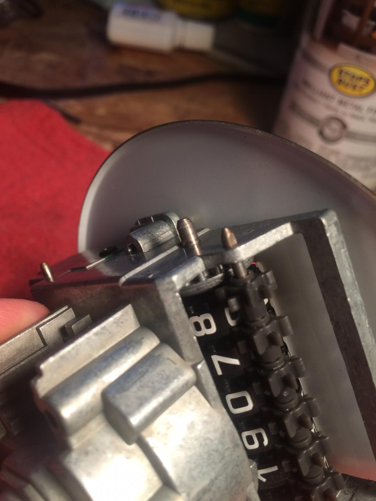

PostPosted: Wed Oct 18, 2017 7:48 am    Post subject: Re: 11cent odometer fix Reply with quote
Dikes is what I use to get the gear to hold. Again, making those marks in the wrong portion of the shaft will cause the plastic gears to stick, not good. Making the marks too deep also causes issues getting the shaft thru the gear.
There is no easy way to get the gears to move back to the right position. You're a tooth off and you just got to pull that shaft back out and realign them.

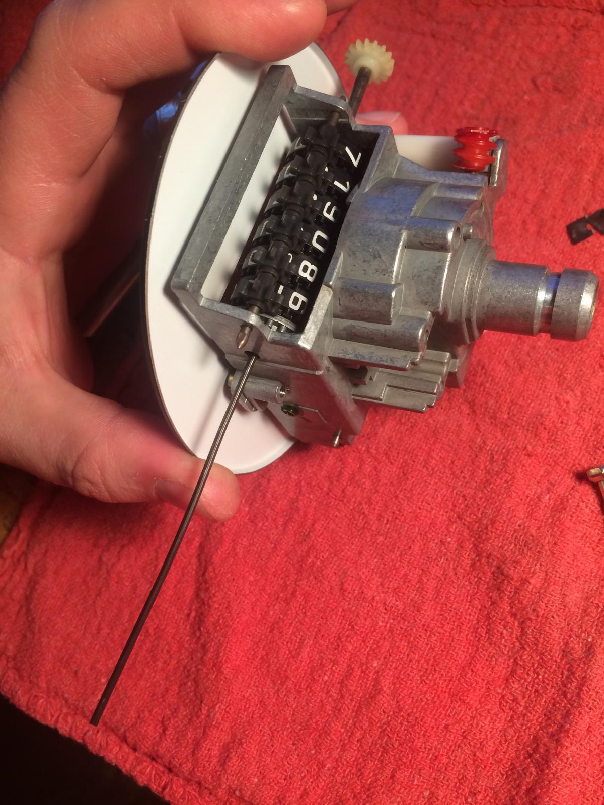

PostPosted: Tue Oct 17, 2017 1:48 pm    Post subject: Re: 11cent odometer fix Reply with quote
OK, pushed the shaft out with a drill bit, came out relatively easily. Put a small crimp, more like a blemish, on the end of the shaft. Upon putting it back in 2 of the numbers moved to halfway in the window.Is there an easy way to straighten the numbers back up? I have been trying for a while now and have no luck.

PostPosted: Tue Oct 17, 2017 11:34 am    Post subject: Re: 11cent odometer fix Reply with quote
So, more thought on this. I am assuming if I get a reasonably close diameter rod to push the working axle out of the odo from the GREY gear end, give it a squeeze with my jewelry dikes at point of contact with the gear and re-insert the axle, I will not have to do anything with the nylon gear at the other end as it seems snug right now.

PostPosted: Mon Oct 16, 2017 6:32 pm    Post subject: Re: 11cent odometer fix Reply with quote
There is an aluminum gear on the opposite side of the shaft. This gear holds everything in place. If this gear is loose on the shaft two things happen, one the odometer gears do not turn, two the shaft slides out.
It is comical of all the fixes on this shaft coming out issue, but none are fixing the real issue.
Peen the shaft at the location of the aluminum gear. Do not go further than that gear because you will cause the number gears to not to slide on the shaft.

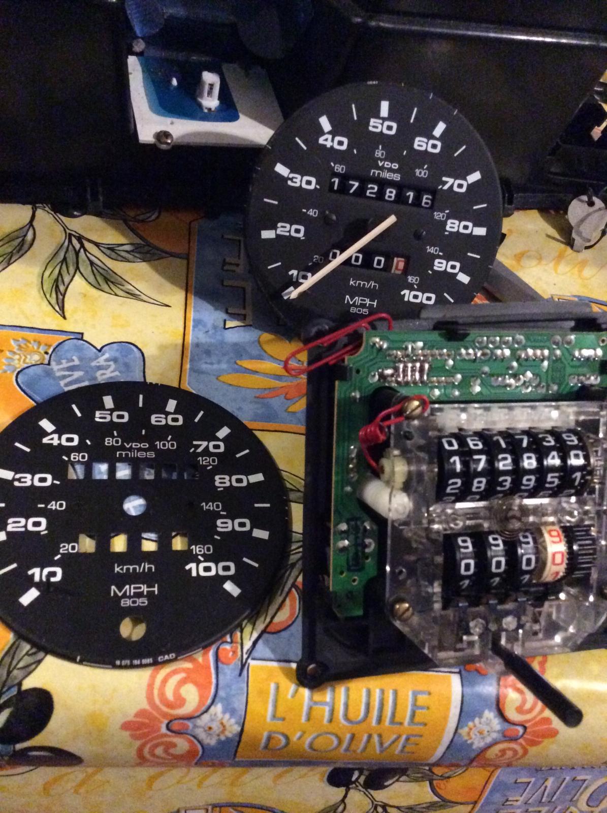

PostPosted: Sun Apr 02, 2017 10:00 pm    Post subject: odometer fix with paper clip Reply with quote
Here is the fix for later odometers Wink
Paper clip modified or whatever you want to achieve the same goal
