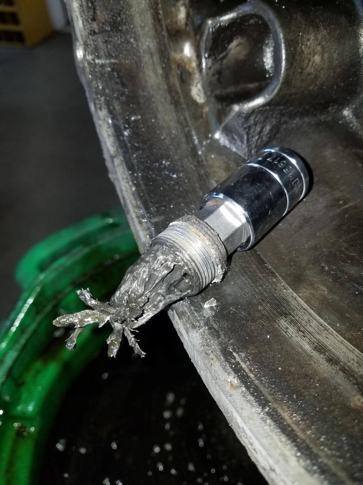

Sad gearbox. Time for a rebuild.
It made no noise or indication of trouble until it all quit, with no power transfer in one instant moment in 2nd gear. Coasted to the side and towed home. Here are the pics. I will pull the bell housing and inspect a bit further.

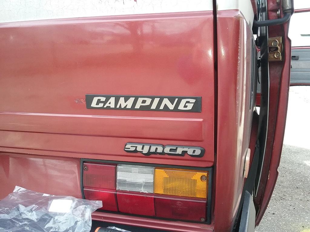

I installed new front turn signal lenses. The quality and fit is poor but they are still better than my cracked and broken originals.
Check this out. Got it from Van Cafe long with new mounting rubber inserts that fit the holes in the hatch.
Steve
