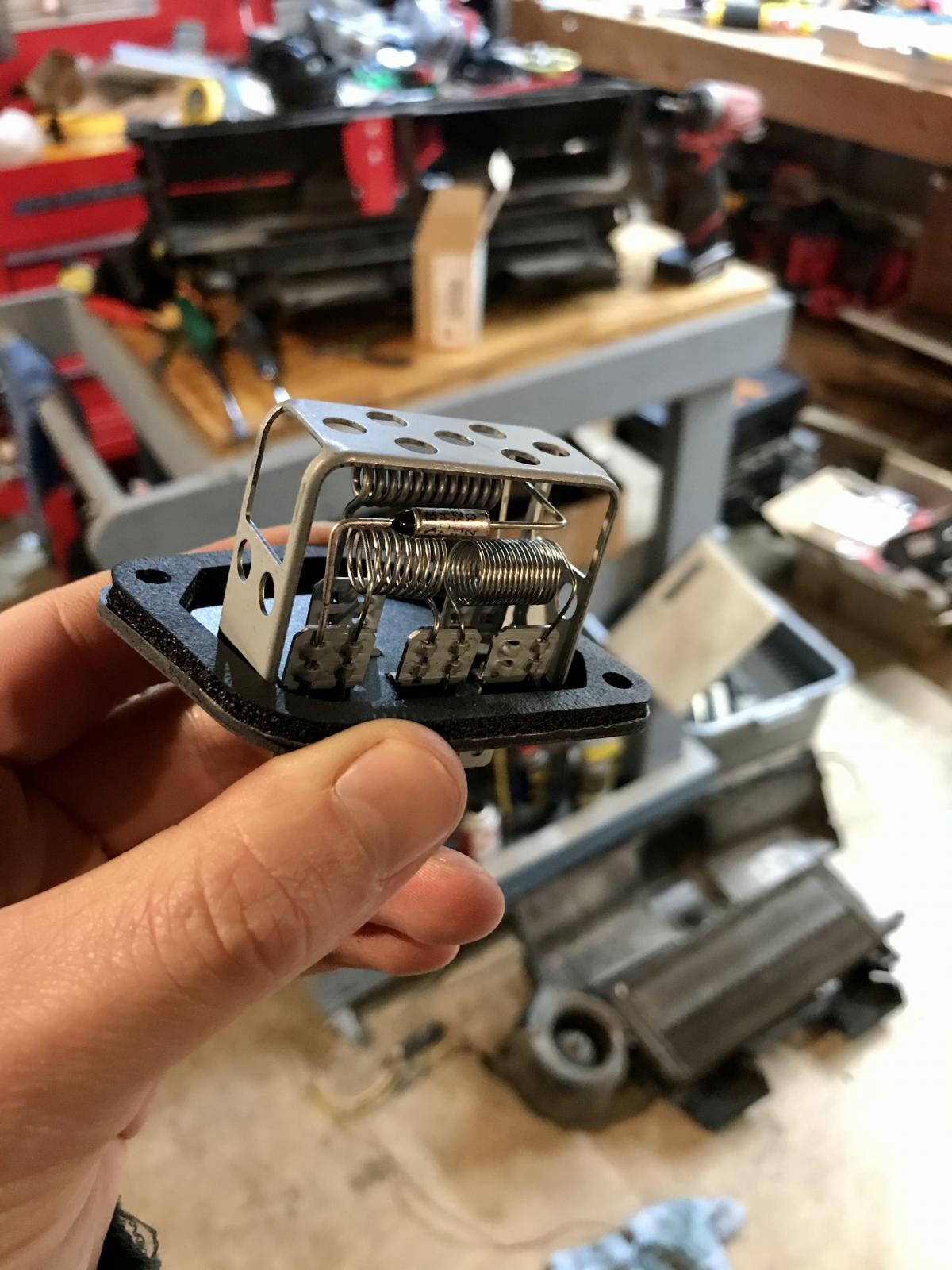

On my 86 I put the resistor on the right side. You can access it via the glove box door.
I don't recall adding any wire length? The factory resistor is on the right.

Ha! Timely suggestion, I just received the Jeep resistor today.
Though I’m still not 100% decided between that and a PWM system. Sounds attractive but also sounds like some people have problems with them.
I have also looked into that hole in the front but I’m going to be installing an air recirculating flap (from Vanistan) so it’s not ideal. I like the bottle cap idea, I think I could probably figure out a way to have to tube come up through the ashtray.
Also, people seem to put that Jeep resistor on the left side but I remember reading something from someone mentioning that the right side works better (just make longer wires). Any input on that?

We're definitely not getting that much heat in the front heater but the bigger problem right now is that the blower hasn't worked ever since we've owned the van.
Our next major project is cleaning up behind the dash. I have a spare heater box I can rebuild before starting so that part should be relatively quick.
While your rebuilding that heater box you can do the "Jeep Resistor Mod" that moves the Fan Resistor outside of the box so you can change without having to remove the box. Also figure out a way you can get lubricant to the Fan Motor bearing so that you can keep it quiet after the next ten years of use. There is the "Mullendore Port Mod" that makes a hole coming in through the front of the grill or you can do what I did and put a bottle cap over the end of the bearing with a tube running up to the defrost duct to squirt some Tri-Flow down into it. ( I do not like drilling holes in my Syncro!)
A last bit of info is that Brickwerks T3 in the UK sells the plastic tabs that hold the shaft for the vent flap in place. Sometimes they break! I order from Brickwerks on a Monday and the stuff is usually here by Friday of the same week.
https://www.brickwerks.co.uk/t3-parts/heating/heater-box-rod-retainer-t3-left.html

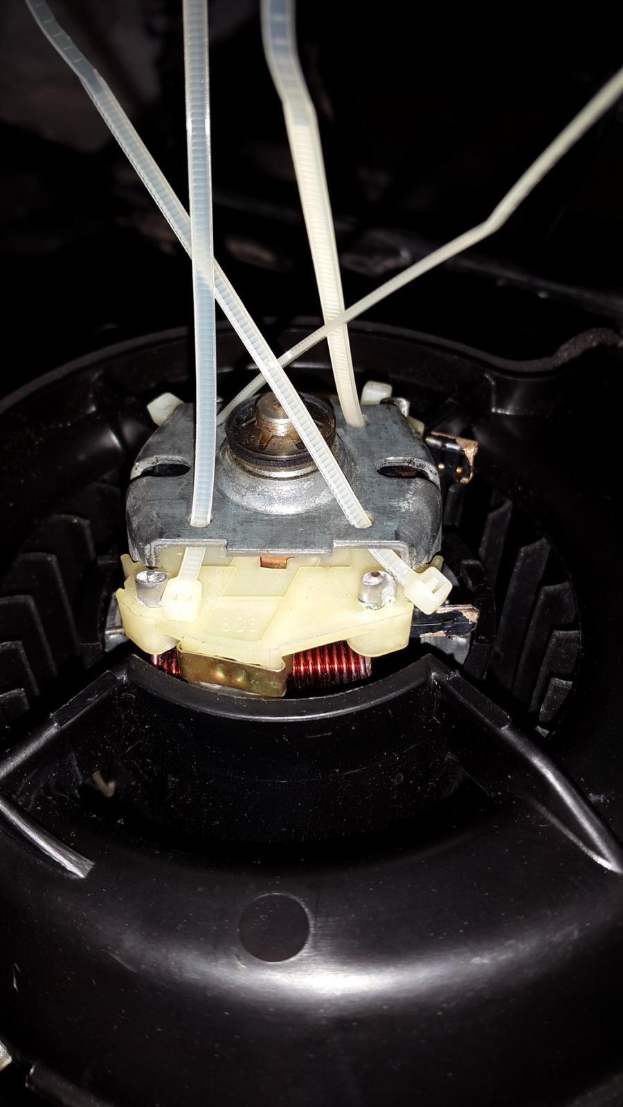

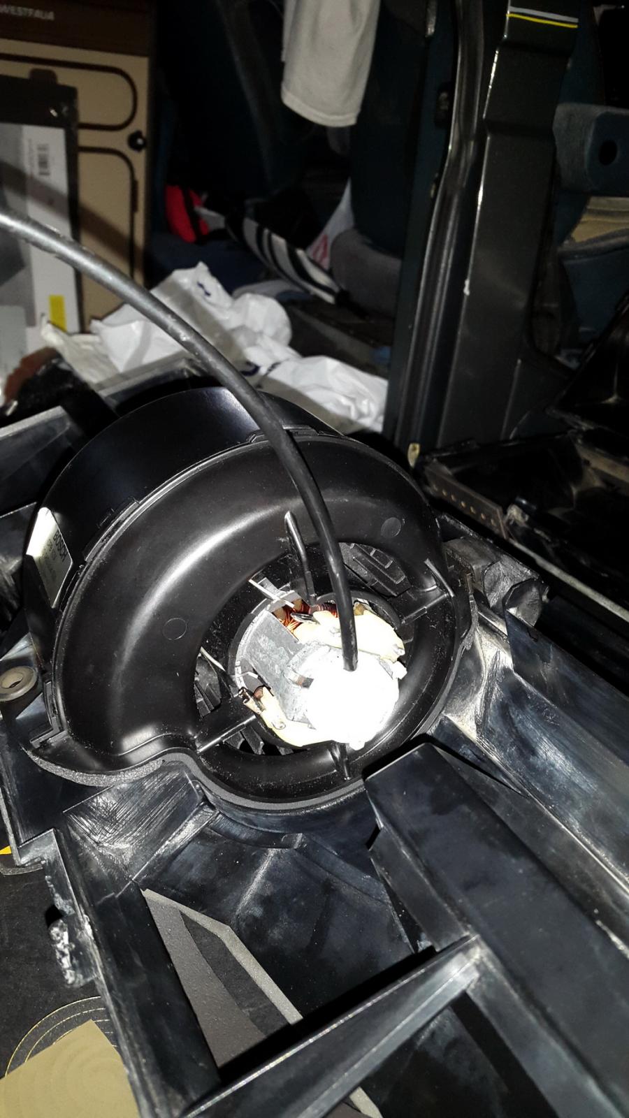

That's all good to know! By the way, we went off-roading again yesterday, in the snow! We wanted to do the exact same easy/moderate trails we did last summer, but see how it was with a few inches of snow. It was a blast and the van performed admirably well again!
Yep... still need to fix our front heater blower...
I still can't believe I did all this temperature tests and replaced wheel bearings between last weekend's off-roading trip and this weekend's. It was colder and more rainy of course but we did dozens of highway miles to get back home at about 38º, driving 55/60mph and using the brakes. I measured the front hubs right away and they were each at about 95º and so were the front outer CV cages. To me, the overpacked grease was undeniably the problem.
By the way, this has more to do with the front end rebuild thread but we couldn't figure out where this loud rattle was coming from on our front end last weekend. Turned out our driver side upper control arm nut was backing off despite tightening that thing down. Happened again this past weekend. I really cinched it down on the trails and it has stayed put but I'm guessing it's time for new hardware.
