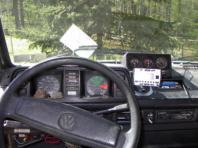

Here's my gauge pod in my '89...
Coolant Temperature / Clock / Oil Pressure
...some days it's not even worth chewing through the restraints...
