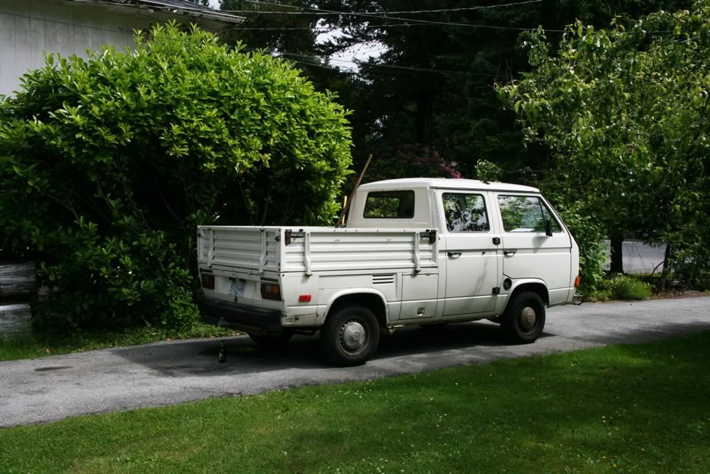

A local guy here runs those on a syncro doka
the adapters are fairly large
http://primafoundry.com/cars/Doka%20SVX.htm
but they seem to work OK...I've driven it. and it feels fine

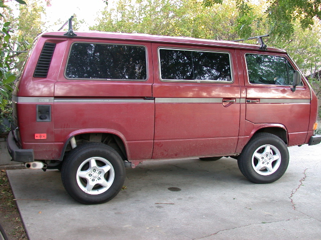

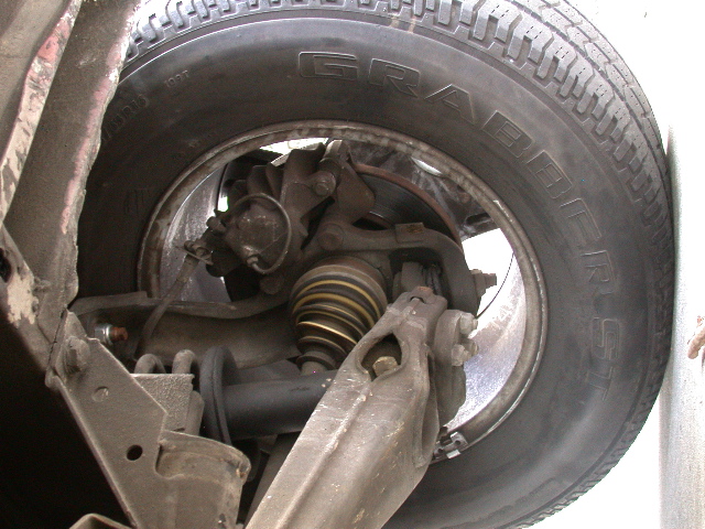

PostPosted: Thu Dec 27, 2007 5:50 pm    Post subject: Mounted not rubbing ! Reply with quote
Kevin at the adapter shop hooked me up . We ran a few test fittings and he made up four 1.5" adapters . About 3/8" space to the suspension and the door just clears . Well the door actually touches the tire but not enough to even mark . Thanks to all for the links and especially to Loogy for his profi advice . I had to go local because i was hoping to use the 255/65/16 that the rims came with . I will post an image when the van is shined up .

PostPosted: Fri Dec 28, 2007 9:59 am    Post subject: Reply with quote
I posted a few more clearance shots in the gallery . I must add that the adapter.com guys in Canoga Park did a stellar job on this . I was dreading the purchase of new rubber in a reduced profile but Kevin , the machinist , pretty much eyeballed it straight away at 1.5" . Then he got out the calipers and started a few test fittings . I am sure that Loogy would have done the same job for me but I couldn't drive that far in an afternoon . The front wheelwells were beaten back by a previous owner , a good thing because I wouldn't do it myself . Something rubs at stuff in the rear ... I believe it is the charcoal filter , I will relocate it . It may have been relocated already when the wbx was changed out to a 3.4 v6 .

ckissick wrote:
I like those wheels. Loogy, would those fit on my Tristar syncro from Sweden? As a Tristar, it has those plastic fender attachments, and it has Swedish front mud flaps that attach right onto the fender lip. If they fit, can you locate a set for me?
I like those wheels on Syncro's too. They seem to fit the T3 achitecture very well.
Will they fit on a Tri-Star with the fender flares? Yes, the wheels will fit just fine. You will have to be a little more careful with your tire selection though. You can see in the above photo that with 255/65's, the front fender opening had to be modified to clear the tire while turning. I would venture to say that if you chose a 225/65, you wouldn't have this problem. I would also stick with the 30mm adapter instead of the 38mm adapter that Patna chose. He chose that thickness simply to be able to run that large tire size. With a narrower tire, you don't need the additional clearance to the suspension. Using the thinner adapter gives you maximum clearance to the fenders.
