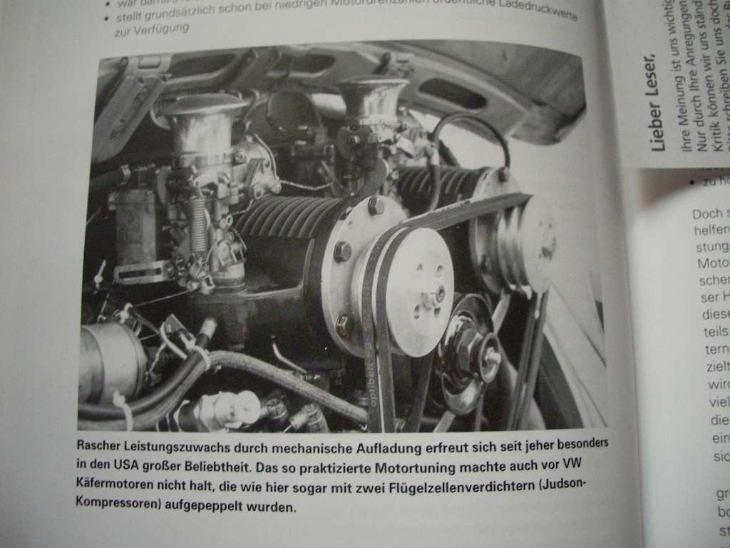

Hi yall. I remember a pic floating around here somewhere about a motor that had twin judson superchargers on it (can't remember if it was a 40 horse, or a 36 horse). I can't seem to find the pic, but it was an old black and white pic (i'm guessing from the 50's or 60's). I was just wondering if anyone seems to have any more info about it, or if anyone had done, or even attempted this mod before?
I've heard that with a judson, you are pretty much limited to a stock motor, or else you'll surpass what the blower is capable of. But if you were to add two of them, i would think this would open up possibilites to larger heads, better cam, larger displacement, etc. Thanks in advance

It's been asked many times here on The Samba...the picture's in the Samba Gallery:
...every time someone has asked for more info on this set-up there has been no response.
That set-up is not from back in the day...zip ties have been around for 30 years but it's not '60s or '70s.

The late David Mayes was working on twin Pepcos for his Type 2 DC but sadly cut short.

Thanks so much. But whats with the generator nuts? it seems the shaft is so long, that one of those early big nuts are installed, as well as a later model cap (the piece that holds the extra shims), is backwards, and a regular nut over. whats the deal with that?
Anyhoo. It seems that now you have double the airflow, that would open up possibilities to larger heads, and other things.

Perhaps he had to backspace the fanbelt pulleys to allow room for the dual belts for the Judsons?
You wouldn´t necessarily need the biggest valves or wildest cam with a blower(s) as there is already a pressurised fuel/air charge building up in the inlet, just waiting for the valve to open. Big valves couldn´t hurt though, I suppose... Twisted Evil

at first..twice the parasitic power makes no sense with judson also double bad in fact of the fan cantact to the housing. at the end this all is more stress to the crank + thermal overkill in compare to the power it gives.
but it looks cool for sure!
big valves are the supercharger's best friend.
for example: my 1200cc 36er and 17psi of boost the same power i could build with a 40hp 1200cc and 1300dp heads(35,5x32mm valves) and half of boost at same rpm.

Seriously though, the parasitic losses would be a major problem like stated by grueni; twice the friction, twice the strain on the crank and bearings. You could reduce the strain by using a single serpentine cogged belt with cogged pulleys, and just line up all the pulleys. But, there is no way to reduce the internal friction of the Judsons unless you coat the internal housing surface, vanes, and vane slots. The cogged belt would kind of ruin any hopes of appearing vintage though.

I mean if one judson increases power, its also taking away from the motor a little. But with two, sure you have twice the parasitic loss, but then again, you have twice the gain. Can anyone give an approxamate HP on a motor like this? if i an hearing this right, a judson on a stock 36hp motor gives about 57 to the wheels. so with two and maybe some big valves, you might be around 80hp?

Nope, doesn't work that way.
There is a limit to the amount of air you can cram into the engine without bad effects. To use some round numbers, consider that your compression ratio is 8:1. If you run 7PSI of boost (1/2 atmosphere) you will get an effective CR of 12:1 which is getting into detonation territory.
The only purpose to running two S/Cs is if one S/C cannot supply the flow you want at the boost you want. That would imply that you either have greatly increased displacement or are running at much higher RPMs.
So, you might want to run dual Judsons on a large type IV where the increased displacement might require more flow.
I think in this case the goal is more aesthetic than practical. Two Judsons makes someone the Alpha Dog of the show from the moment their car rolls out of the trailer until they push it back into the trailer.

well the idea would be to increase displacement, as well as use larger valves. if one jusdon was good for 1200cc's, wouldn't 2 be good for 2000-2400cc's, if airflow was the main issue here? perhaps this could be used on a late model 1600 increased to 2000cc's (perhaps a 2074cc, or 2110) i would think this could be made to be streetable. just a thought

That's why I mentioned the type IV engine. However, going that way kinds of corrupts the whole Judson vintage speed mystique.

All I can see you getting from Twin Judsons is a BIG headache. If you know how tight it is under the decklid with one Judson just imagine the problems with two. At least it will be a quick way to fry an engine.
If you want more flow get a bigger Supercharger not two small ones. If it has to be vintage use a Shorrock C142, you'll have to fabricate an intake manifold but the C142 worked very well on The Inch Pincher.
