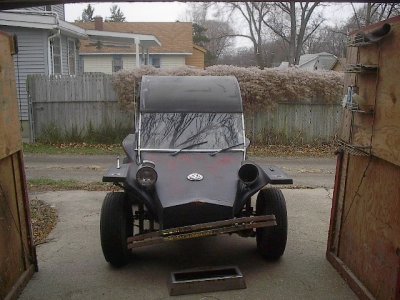

PostPosted: Wed Sep 28, 2011 2:29 pm    Post subject: Barris T Buggy "the Project" Reply with quote
First, Let me say Hello !
This has been an ongoing project of mine for the last 10 years.
I found it at a used car lot, $350, in 2002
Had no idea what it was, just liked it.
so now that I'm back at it, I decided to start a build thead
I Hope everyone enjoys,
Bill

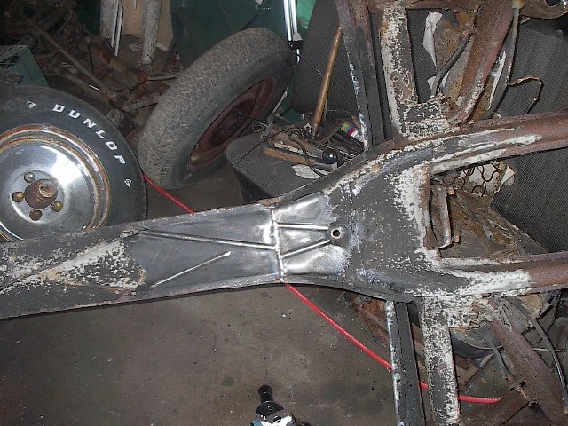

PostPosted: Wed Sep 28, 2011 6:34 pm    Post subject: How NOT to shorten a pan Reply with quote
Here's the first problem I found
Don't believe anyone thought this was safe
There was one on the bottom also, I didn't bother with a pic
I Just hope someone learns from this Shocked
The bad part is, the pan was actually in good shape,exept for the torch cut

PostPosted: Wed Sep 28, 2011 9:00 pm    Post subject: Reply with quote
Looks like they may have drilled holes through the chassis number. I'm sure they actually thought that would suffice in place of welding the shortened chassis back together? Sadly, work like that really isn't that unusual on dune buggies. It probably has something to do with getting it for $300. Have you considered a Berrien or Barrett chassis?

PostPosted: Wed Sep 28, 2011 11:22 pm    Post subject: Reply with quote
Shocked WOW!!!!!!!!! thats scary as hell.......

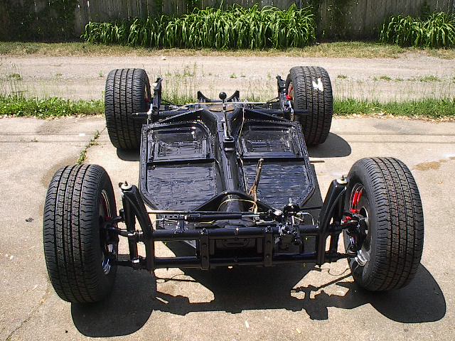

PostPosted: Fri Sep 30, 2011 3:06 pm    Post subject: frame shortening Reply with quote
Far from perfect, but I like it better than the bumper brackets. Smile
I did found out that I have lost all my pics of the frame build. Mad
I will say that i boxed in the pan with 1 1/4" including welded in nuts.
As I said, I had to reuse the frame head from the original frame.
Then off to the sand blaster.......
Primer, paint, and bed liner on the bottom.
4" drop and discs all the way around
And OLD cragars, from E-Bay
Almost caught up to date, some more to come.

PostPosted: Fri Sep 30, 2011 3:12 pm    Post subject: Reply with quote
I was going to say...wow, you work quick!
Looks good! Keep the updates coming!

vw_hank
Joined: February 07, 2001
Posts: 5371
Location: Everett WA
vw_hank is offline
PostPosted: Fri Sep 30, 2011 5:41 pm    Post subject: Reply with quote
the pan looks good enough to drive around,, who needs the body Laughing Love the wheels!!

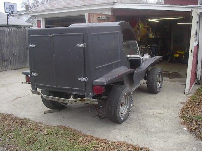

PostPosted: Mon Oct 03, 2011 6:58 am    Post subject: Reply with quote
I really like the body shape, what does it look like inside the box? Are there shelves, seats, or nothing?

PostPosted: Mon Oct 03, 2011 8:53 am    Post subject: Reply with quote
I'd like to see what it looks like inside the back too. Nice job.

PostPosted: Mon Oct 03, 2011 1:58 pm    Post subject: Reply with quote
Good questions about the back. Let me bounce these ideas around out there.
Yes, it is just a square box in the back. I'm thinking stained wood floor, (i.e., old pickup) and just doing headliner material on the rest.
Also, just for thought, I’m thinking of glassing some steel in the sides. Just enough, to hold a magnetic sign. Just incase I would like to whore it out on the weekends.It might look nice sitting in front of a new restaurant or liquor store Laughing
And YES there will be an 8-track,,,,anyone have some Beach boy tapes?
Thanks Again for any, and all ideas,
