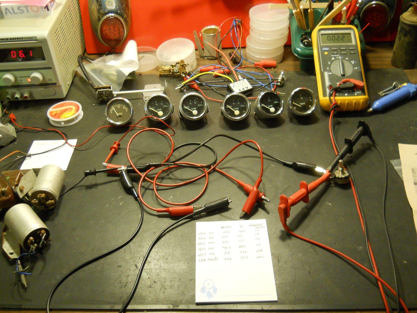

I found this old discussion on fuel gauges and saw that Suboval was testing the gauge to determine its ohm range?
I have s basic idea of how to test a random SENDER on a multimeter so it shows ohm range, but how do you test the FUEL GAUGE itself when you just have a random one out of a parts bin that you want to use in your car but no idea of the sender required for it? Would like to know how to test the gauge or where to finder a marker on/in the gauge that would indicate the ohm range for appropriate sender selection?
Many thanks for your help!
Regards,
Jason |
| Back to top |
j-dub Samba Member
Joined: November 09, 2003 Posts: 870 Location: Phoenix, AZ
Posted: Tue Aug 09, 2016 8:18 am Post subject: Re: Coverting a 6V VDO Fuel Gauge to 12V |
Jason,
In the picture above for testing the gauges Suboval was using a potentiometer which is an adjustable resistor to find out what what resistance range it requires for the gauge to sweep from full to empty. You can see in his notes that each gauge varied a bit but they trended the same.
The gas gauge is based on a simple voltage divider circuit, there is a fixed resistance and a variable resistance, sending unit. The needle indicated the proportion of each.

Suboval Samba Member
Joined: September 15, 2003 Posts: 825
Posted: Tue Aug 09, 2016 11:31 am Post subject: Re: Coverting a 6V VDO Fuel Gauge to 12V |
| j-dub wrote: |
Jason,
Jeremy |
Jeremy's response is correct. I connect a potentiometer, as the fuel sender, to the gas gauge and apply the correct voltage. I then adjust the potentiometer until the gas gauge indicates EMPTY. Disconnect the potentiometer and measure it with an ohmmeter. I then repeat these steps for the FULL indication. _________________ It all works on paper.

jwr! Samba Member
Joined: May 15, 2004 Posts: 20
Posted: Tue Aug 09, 2016 10:24 pm Post subject: Re: Coverting a 6V VDO Fuel Gauge to 12V |
Thanks Jeremy..
Thanks Kurt...
Much appreciated for the response. I thought/hoped maybe that there was something additional used in testing, that would remove the back and forth multimeter measurement process with the potentiometer.
I have seen 'Ohm Wheels' that have all of the ohm ranges marked so you could 'dial in' and record, but they are rated only up to a few watts when in actual fact I imagine that one would required one rated up to about 500ohms and 100 watts to cover the range of 6v & 12v fuel gauges?
My electrical knowledge is limited and is took some research to just get to this stage! Ha!
Thanks again!
Jason |

jwr! Samba Member
Posted: Thu Aug 11, 2016 7:07 am Post subject: Re: Coverting a 6V VDO Fuel Gauge to 12V |
Hi again guys...
I'm not great with electronics, wondering if you can help?
I tried to test a bunch of early VW 6v fuel gauges using a 500 ohm potentiometer but they all read the same.
Using a small 6v plug in wall transformer...
Potentiometer is connected in line with the +ve line of the 6v feed.
This connects thru to +ve terminal on the fuel gauge.
-ve from the 6v power feed connects thru to the -ve terminal on the fuel gauge
At 0 ohms the gauge reads on full & then I turn to 500 ohms & the gauge drops to about 3/4 of a tank. I assume that I am just not doing something right?
I imagined that the fuel gauge indicator should change incrementally with the rotation of the potentiometer? Can you shed some light on what I a screwing up?
Many thanks!
Jason |

j-dub Samba Member
Posted: Thu Aug 11, 2016 6:51 pm Post subject: Re: Coverting a 6V VDO Fuel Gauge to 12V |
Look again at the diagram that Kurt provided.
Based on your previous post you were using the potentiometer on the 6 volt feed, that is incorrect.
The potentiometer is supposed to replace the sender in the diagram.
Is that clear? All the sender is at the end of the day is a potentiometer, variable resistor.
